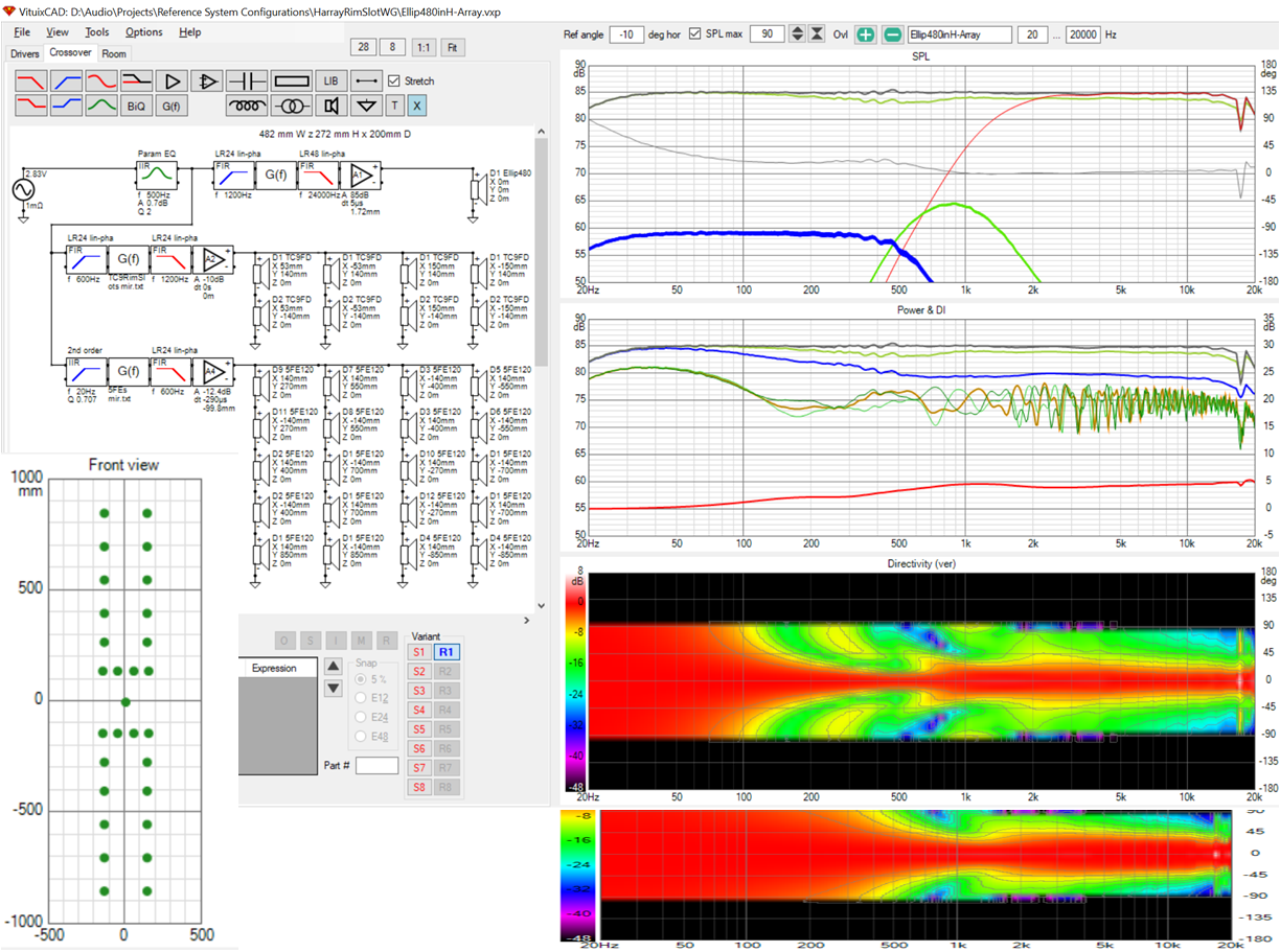

I spruced up my H-array simulation to use as a reference for comparison.
attachment.php
Its a lot of drivers (20x5FE120) so its understandable why I would want something simpler but power response and DI are good and the vertical pattern control is almost line array like. At center height, the peaks and valleys due to floor and ceiling are less than +/- 2db below 1 khz. The overlay traces in the center graph are for +/- 200mm vertical offset from center and are impressively close together below 600 Hz and +/-3db near 1 khz.
This sim was based on a 482 x 272 elliptical waveguide I did early in April as I was learning ATH and ABEC. I see this waveguide has less of a hump in its DI, which might allow it to integrate better in the simpler system configurations I've been looking at recently.

Main null? Not sure what null you are talking about. Due to arraying? I doubt due to CTC between array elements. I tried twice as many drivers at half the spacing and saw no change other than SPL.
I mean this, it looks to me like the black area comes from the rim array side of the crossover which I took to be the narrowing of directivity from cancellations of the arrayed drivers at that frequency.

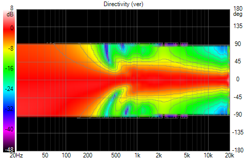

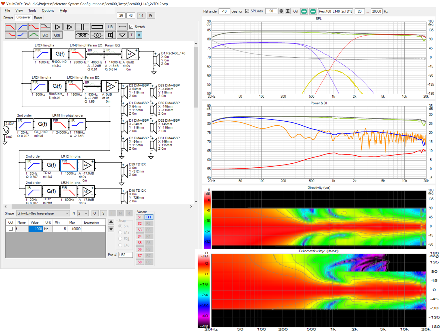

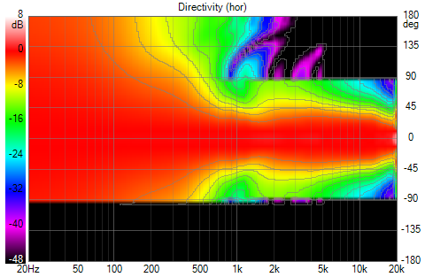

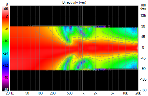

It struck me that the waveguide I've designed is about the same shape as those SEOS18s I have in storage next to my TD12Xs. It was an easy manner to spin a version of the RimSlot 3-way to use the 465mm x 213mm SEOS18 instead of the 400mm x225mm ATH waveguide. The results were surprising because per its spec, the SEOS18 starts losing V control near 2 khz.
attachment.php
attachment.php
Axial, power response and DI after optimization are very similar to the ATH WG. The SEOS18 system has the same belly in the power response around 1 khz as the other. Optimizing it made clear that it was due to H directivity mismatch in this region. It was reduced first by reducing XO as low as I dared, next by making the XO asymmetrical and finally by a couple of PEQs. I ended up with CD high pass 862 Hz LR48 and RimSlot low pass 1000 Hz LR24.
Comparing vertical directivities:
SEOS18 system
attachment.php
Rect400_140 system
attachment.php

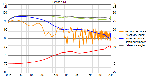

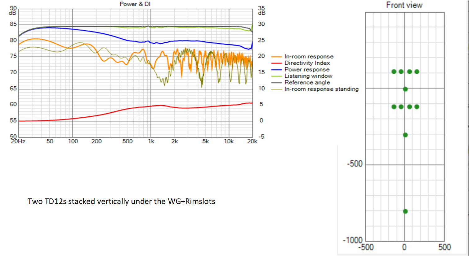

Going back to Genelec for a moment - the first thing I did after reading the manual was to try an independent filter/amplifier channel for each woofer. I was not impressed with the results. I got better results with the woofers in parallel. Perhaps independent channels would help with a wall null that necessitated a compromise. My hat is off to Genelec if their integrated speaker management software does this correctly automatically.
Regardless, I will use a 4-pole Speakon for the woofers to preserve the option. I actually need separate amp channels for these woofers as my fanless amps have the same maximum power output with 4 and 8 ohm loads.

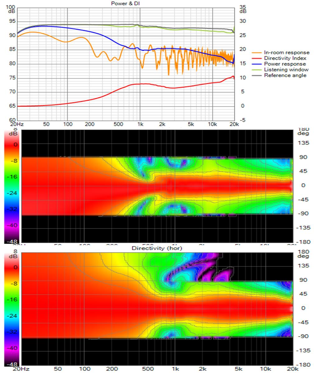

Now I have a more compelling justification for that additional amp channel. By extending the cutoff of the upper woofer to 1 khz and using a low slope filter, I got improved vertical response above 1 khz, due to the woofer overlapping the DMA45s above 600 Hz.
attachment.php
The power response has a small rise in the 2-5 khz region that has been mitigated by tiling the axial response down. The predicted in room response is flat though so perhaps that axial tilt is a good thing. Ultimately it will be tilted to taste.
This hump in the power response has plagued me through multiple waveguide variations and innumerable equalization iterations. I believe its due to the waveguide vertical response widening. That widening is counteracted by overlap from the DMA45 array, low passed at 1500Hz, and upper woofer on the slopes of their low pass filters. If I got the slope of that decreasing overlap exactly right, the power response might flatten out completely.

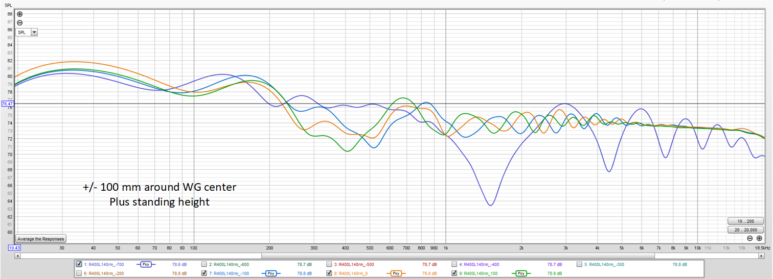

The response variation with vertical offset is impressively low:
attachment.php
(that is 2 db per major division in the REW screenshot)
The variation maximum at just under +/-2 db around 300 Hz and better that +/-1.5 db elsewhere for waveguide center at 900 mm +/-100mm. The standing response looks good if the large flooe combing nulls above 1khz are ignored.
