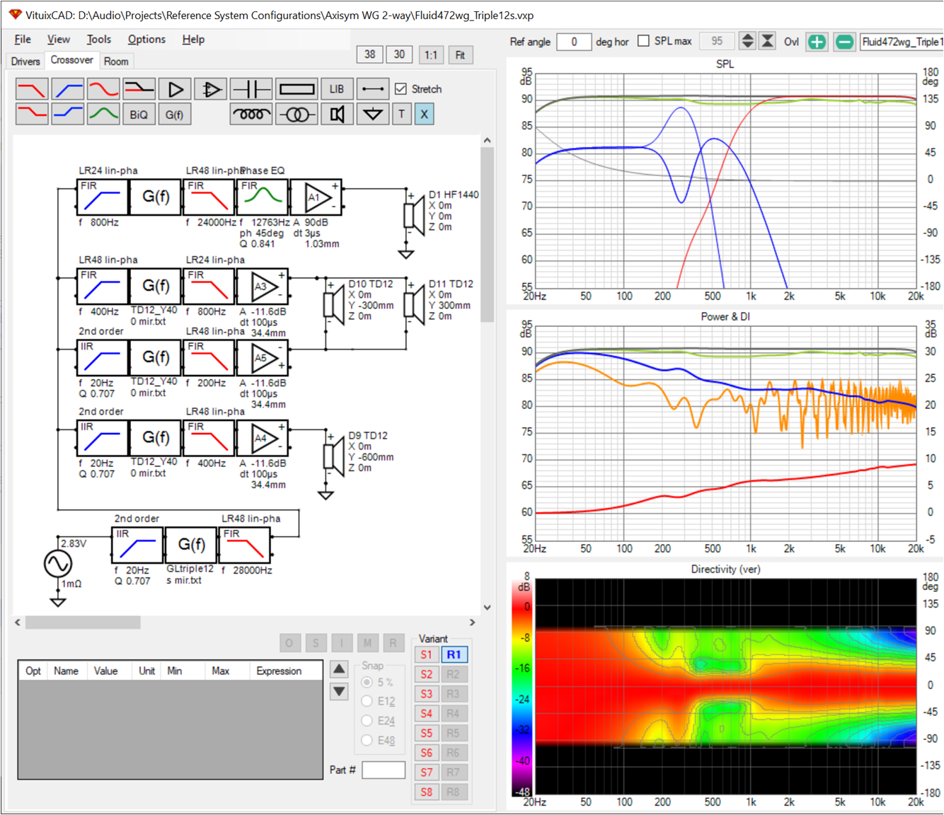

I tried the triple 12s and its not bad. The response suffers between 500 Hz and 1.2 kHz because of the CTC of the 12's flanking the waveguide. With rim slots flanking the waveguide CTC for the bridge drivers playing perhaps 400 Hz to 800 Hz is 145 mm, which should be even better...

You can see what I meant by more complex XO summing in the lowest octaves to the upper woofers.
Wesayso's complementary peak/dips over the notch band are the blue traces in the top graph. After capturing the screen, I raised the XO between upper pair and lower woofer from 400 Hz to 500 Hz and verified floor null mitigation out to 6m listening distance,

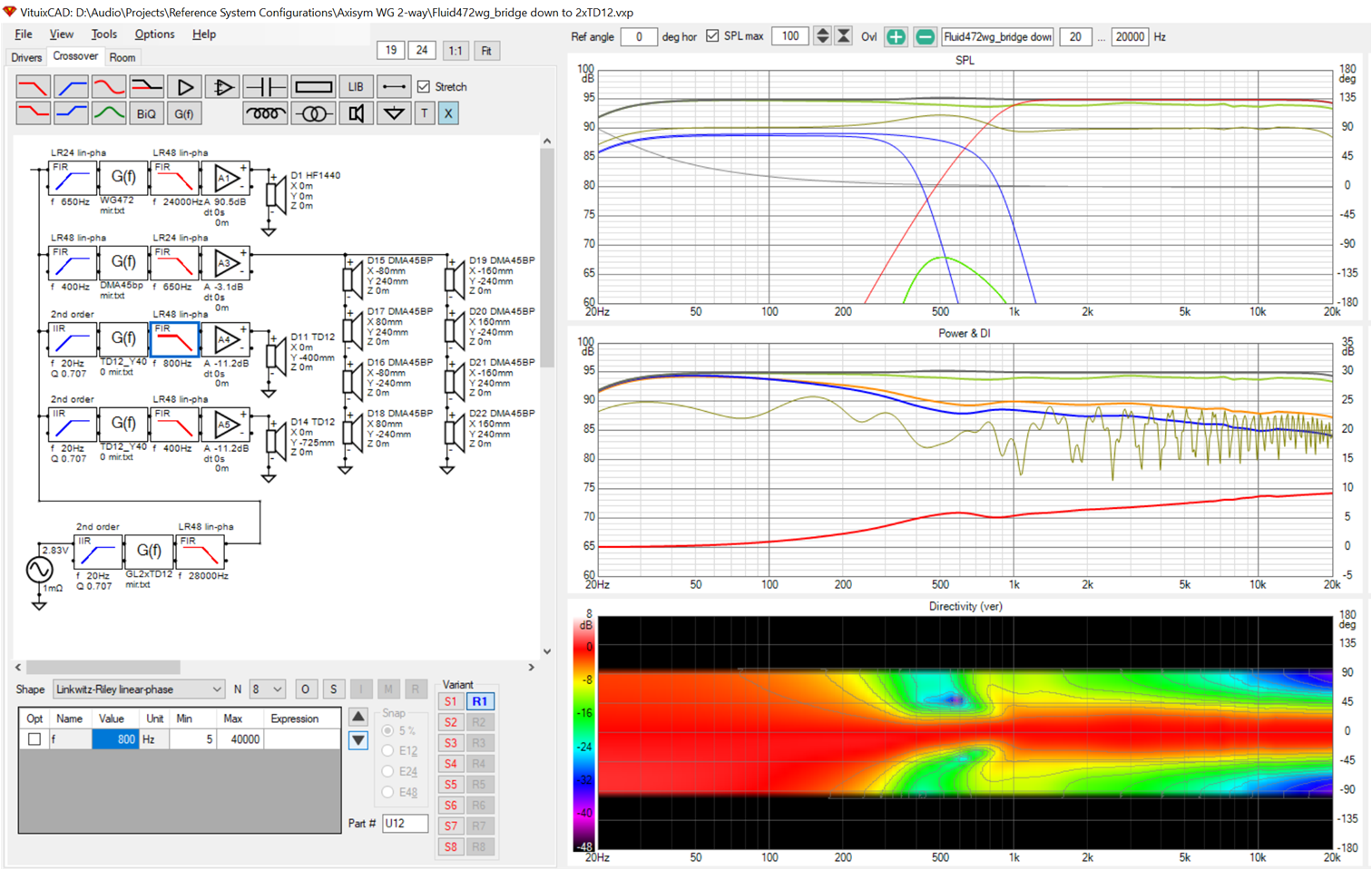

This seeming tail chasing exercise has circled back to the 2xTD12 stacked below the waveguide with rim slots - except I am making progress. I found a way to adjust the power response in the crossover region
The the upper woofer is overlapped with both the rim slots and the waveguide up to 800. Trimming the rim slot drive level trims the power response/DI in the problematic area. I have equalized flat and have just 1 db or so belly in the power response. If I were to split the difference between it and the axial response, I doubt it would be audible.

The light grey trace in the top graph is the axial with the global eq off. It shows the overlap. The light grey trace in the middle graph is the in-room response with floor and ceiling reflections enabled.

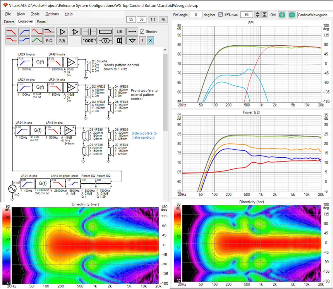

New waveguide, new bridge/rim approach, cardioid bottom
I've been working on several fronts trying to produce a system with flat axial response and smooth monotonically falling power response of course with good polars and minimal boundary interference.
Cardioid with small side woofers is a worthwhile addition to the mix because it makes the result relatively location insensitive.
A new waveguide was in order because (I eventually realized) it was its slightly rising off axis response in the upper midrange that resulted in the small belly in the power response I had been unable to eliminate. I finally found the knob to twist in the ATH script and made progress there. With axisymm waveguide I could do an ATH/ABEC iteration about every 5 minutes.
The horizontal rim drivers weren't working optimally. CTC was too great to allow the response to extend high enough to meet the waveguide. It was a problem with both HF1440 round and my Rect400.
The new waveguide/CD reduced/eliminated the belly in the PR but needed something to bridge the gap to the woofer, even assuming a 1/4"CD. The key change was to put the bridge drives on +/- 45 degree diagonals around the axisymmetrical waveguide where they extended both H and V pattern control.
Finally, this emerged:
attachment.php
The new waveguide is 414 mm diameter and has 4 4" drives just outside its rim on diagonals. These extend both horizontal and vertical directivity to better meet with the 15" woofer near floor level. There are 5" woofers on the cabinet sides at woofer height with DSP filters creating an active cardioid response above 100Hz or so. The 100 Hz high pass filter in this chain makes the response omni below its cutoff and allows those 5" woofers to suffice. Omni below 100 Hz preserves the front woofer's displacement for reproducing low notes.

Here is what the response would look like with the 100 Hz high pass in the filter chain for the side woofers disabled:
attachment.php
But of course you can't disable the high pass filter because that would over-work the 5" side drivers. The slide makes clear the cost of extending the cardioid response all the way down. Better to keep the system close enough to walls to avoid boundary nulls. That isn't hard cardioid down to 150 Hz or so.

There are still several things to do before declaring victory. The primary thing though is to model the full cabinet in ABEC which will no doubt lead to a number of waveguide and cabinet iterations.
This simulation was done in free standing mode for the waveguide with its mouth rolled back 180 degrees. A waveguide modelled free standing shows extended pattern control compared to one modelled infinite baffle, even a waveguide without a mouth rollback. This latter part is surprising because my initial thought was it was the rollback that was responsible for the added pattern control. I also thought a large baffle would support the response at the low end as in baffle step. Regardless, I need to model this waveguide plus actual baffle and cabinet free standing to trust the simulation results as any more than an indication that the concept is sound.

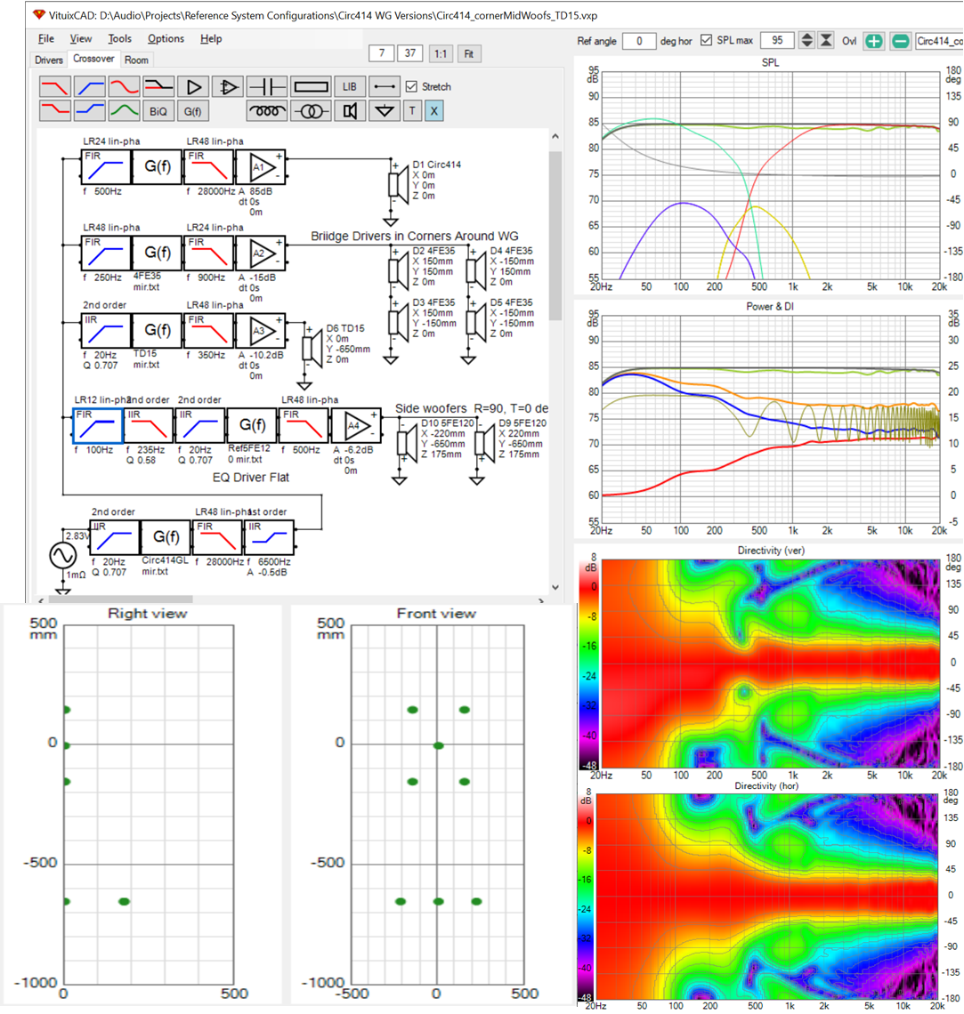

This is similar to what I was going to try to simulate myself.
The small drivers on the side just so happens to fit nicely with the Sica woofers I bought. I was thinking the 15 up high with the side woofers and the sub driver on the back at the bottom.
Did you just use the diffraction tool to model the baffle sides on the 5 inch woofers?
Is there a reason you chose Linear phase crossovers for the side drivers?
I haven't paid much attention to the schematics before is there a reason for all the 20Hz high pass blocks?

We've both been talking to Kimmo about cardioid. And your Sica's are comparable to my 5FE120s although the 5FEs have a bit more excursion and I've only bought 2 so far.
I used Vituix SPL trace and diffraction tools to create the directivity files for the side woofers. For the next step, I should redo that and model the actual side baffle dimensions, which I don't yet know.
I used linear phase filters for the side drivers with one exception - the low pass filter that creates the delay needed to get a cardioid response. The reason being so that their delay wouldn't contribute to that delay. My other reason for doing that is habit. Mark100 endorses the process (described below).
My approach to flattening a driver's response for a crossover is to use Vituix's mirror function, which is equivalent to impulse response inversion. Flanking each mirror filter are high pass and low pass filters that apply the slopes at each end. At the very low end, 20 Hz, I want a 2nd order roll off like a sealed woofer would have so I use a 20 Hz IIR filter. That expresses my intention to equalize flat to 20 Hz in the so called real world, if I ever get there :)

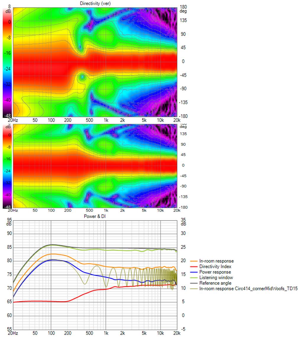

swapping in two TD12s below the waveguide for the single TD15, I get an improved vertical response - less narrowing at the crossover which translates to good standing response even at 3m listening distance
attachment.php
Notice also that pattern control is extended down almost to 60 Hz with the side woofers. It looks also like 4FE35s are a viable choice for side woofers and easier to fit in the space.
