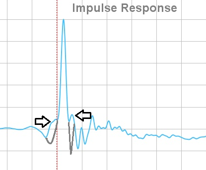

This train of impulses thing is the least of my concerns. I brought up the ringing in my IR, which doesn't look anything like a chain of impulses, thinking it might imply something wrong with my equipment or methodology. Seeing how flattening the FR cleaned it right up, at least at the measurement spot was an aha moment for me as previously I'd only looked in the IR for evidence of reflections.

Not for me, sorry. What do we see in an IR predominantly? The high frequency info, that's the train of impulses we see in a raw impuls from the array with a limited number of sources. An infinite array would have an infinite trace of these and still need work too, to get it back in shape for listening. As the pulse shown is the example of that theoretical infinite line source and it is clearly showing a tail. (It's not a STEP shown)

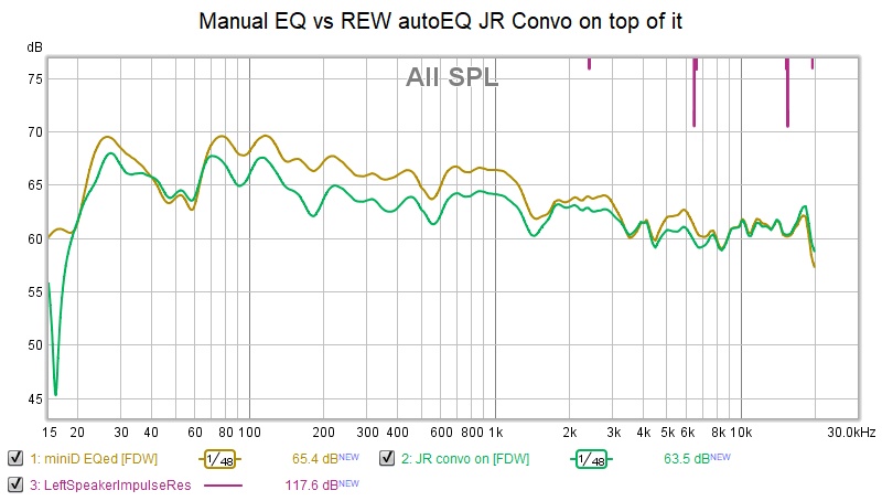

Took another pass thru MiniDSP and REW auto EQ => JR convo
and did some more listening. I'm getting the feeling that this might become a very special speaker. However REW auto EQ is disappoining. It was only a marginal improvement to my manual EQ, which I did quickly, thinking REW would refine it.
So time to move on to DRC!
I got DRC to run with little trouble. I exported my miniDSP eq measurement as wav from REW, changing its file type to .PCM as required by DRC. DRC ran with no error messages and produced a result. I imported the result back into REW.

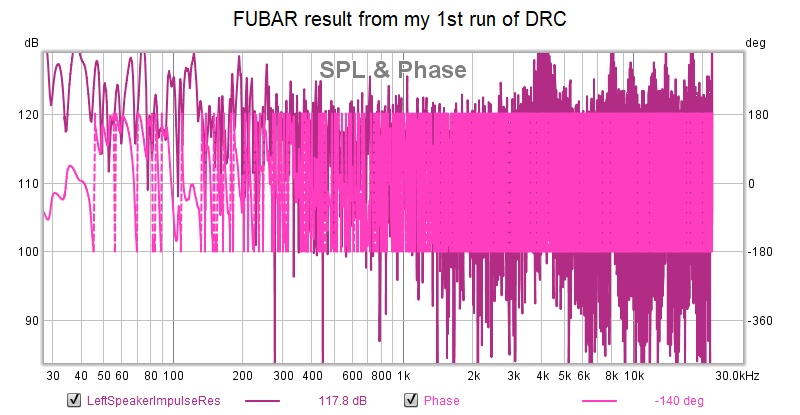

This is what I got (you guys need a laugh)
I'm sure I'm making a rookie error. In fact, looks like a GIGO problem, garbage in- garbage out.
Very little guidance is provided. I just dropped my IRs into the samples folder and clicked on Normalxx.bat.
I did notice DRC seems to produce result for 44.1 khz sampling rate whereas I am set up for 96 khz. I'm not sure what to do about that.
Help appreciated.

Oh. Didn't see errors in the bat but there is a warning I overlooked
!!Warning: input signal too short for correct signal prewindowing, spurious spikes may be generated.
Boy, I'll say. Maybe be I should read the guidance on how to produce an IR for DRC; thought I already knew that...
... oops ...
there is a prep step in Audacity I need to do
Yes, that is apparent but not how to fix it. My first attempt at hacking the bat file resulted in a file not found error. Does it care about the sample rate of the input?
No, but one should use the template that belongs to that sample rate. Have you looked at the available templates? If it (the template) does not exist one should be created with the proper variables.
Look at Greg's (gmad) thread and sample templates. I only have 44100 in use myself.
You could start with one of his samples.
He provided a complete package with his own batch files etc. It would be a good start.
