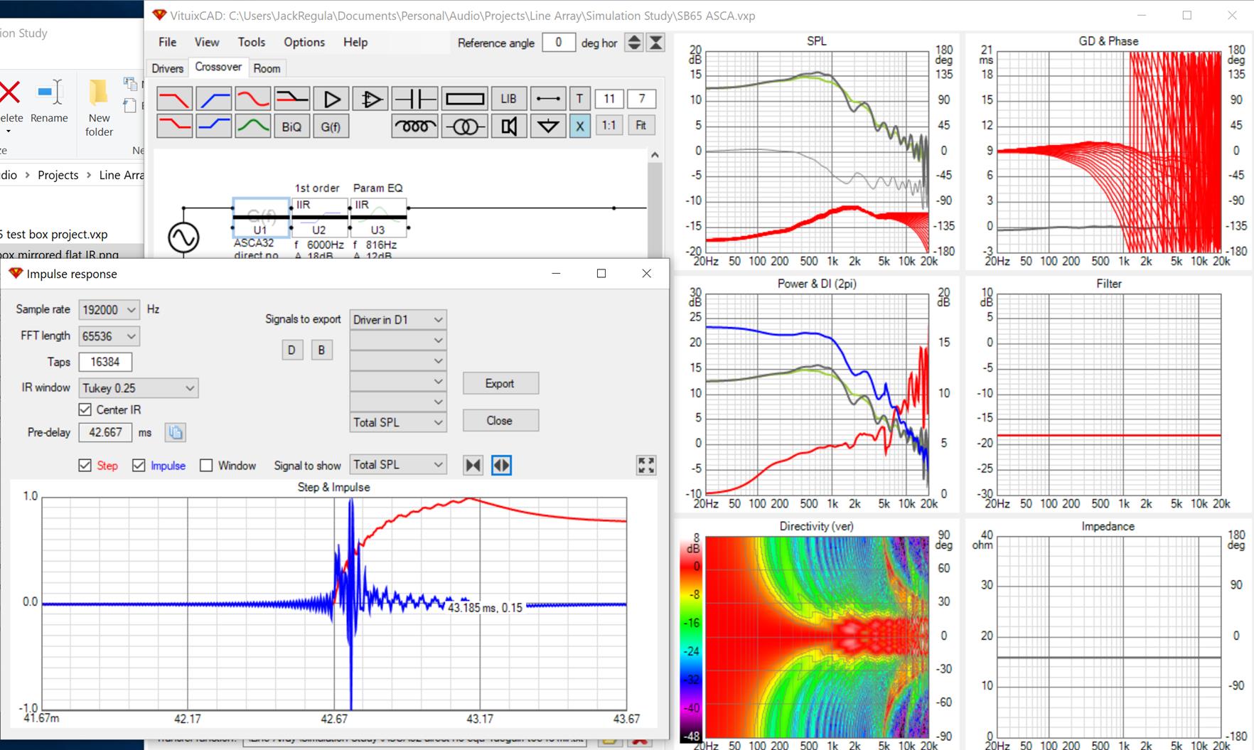

Simulation results are interesting.
First the unequalized array and its IR on axis:

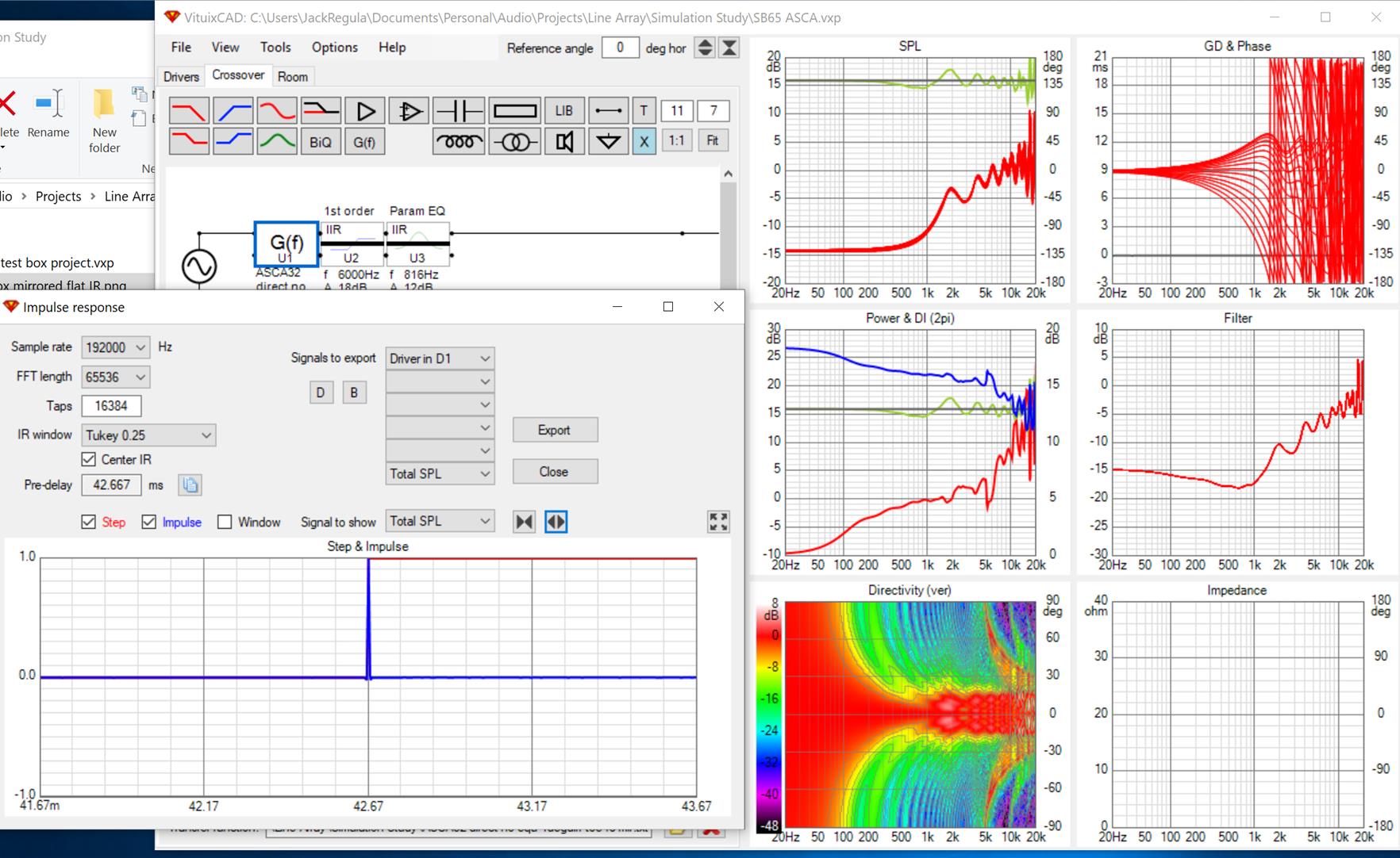

Next the "perfectly" equalized array and its IR on axis:
perfect at one spot

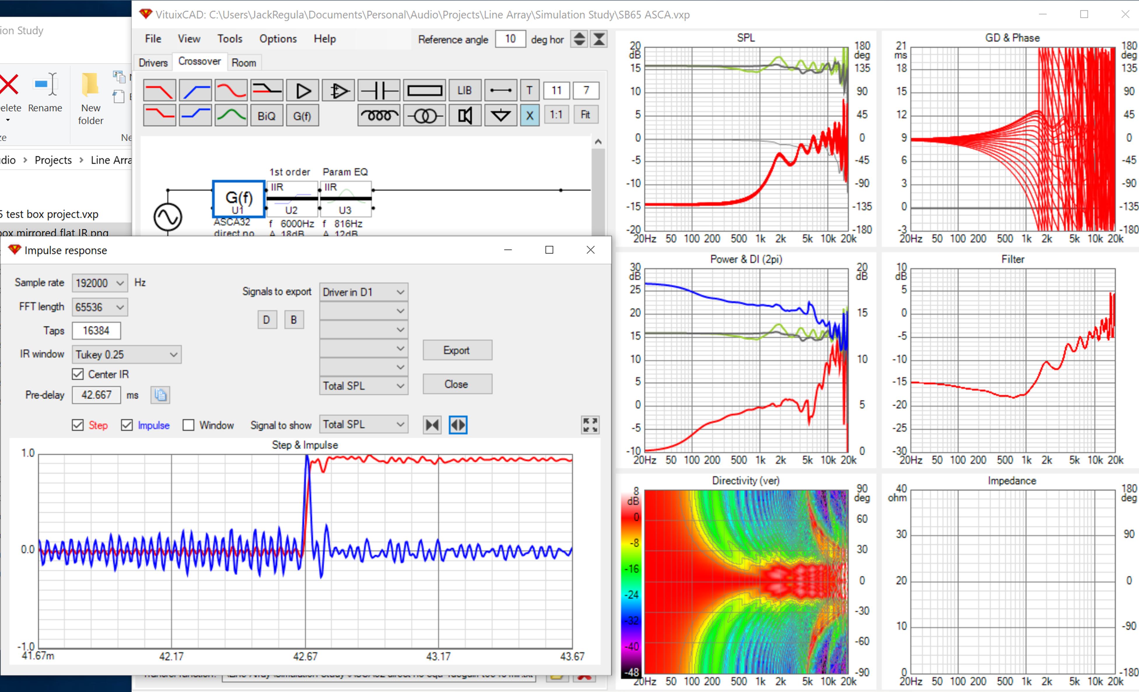

Lastly, the "perfectly" equalized array and its IR 10 degrees off axis:

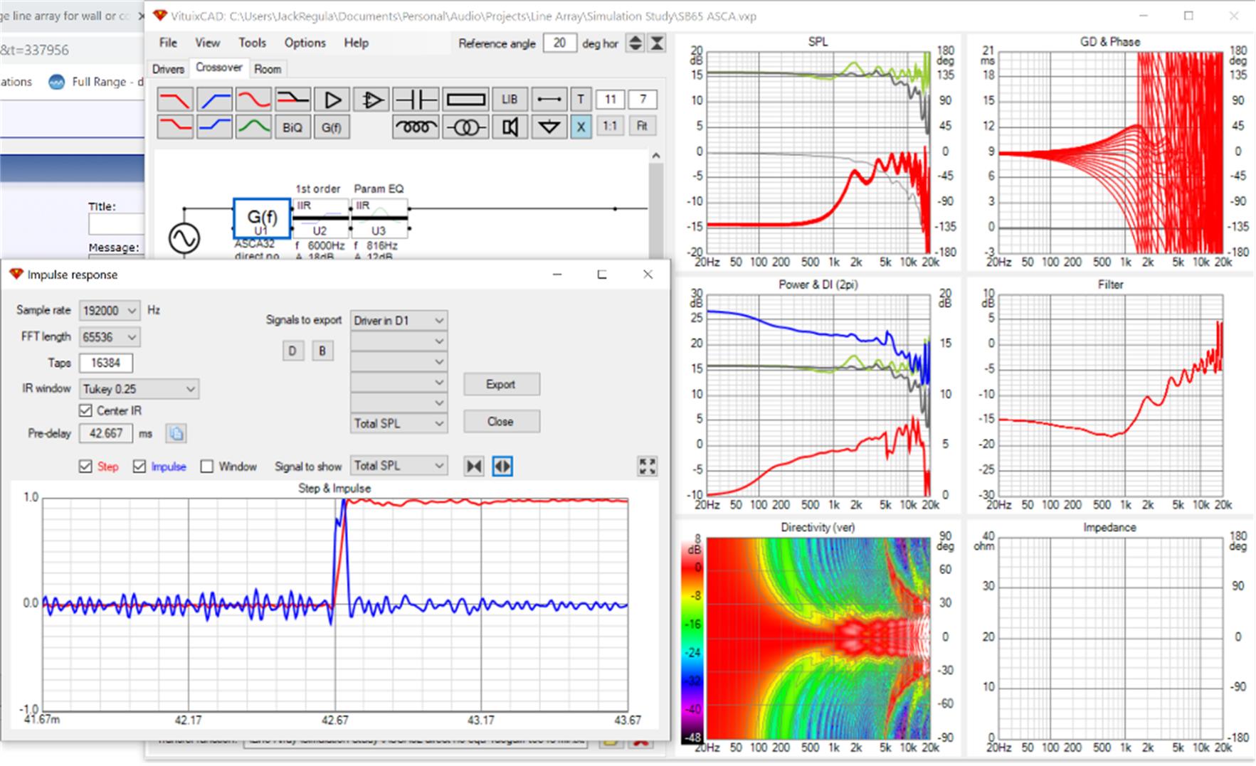

Still pretty good 10 degrees off axis....what about 20?
response suffers 20 degrees off axis because of beaming

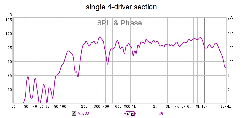

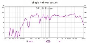

In the meantime, here are the freq response from the array impulses previously show. Pls remember these measurements are only 'halfway' reflection reduced.
1 section
2 sections
4 sections
6 sections
As you can see, freq response starts breaking up in the top end as more sections are added.
I think the high end freq breakup is what is also being seem in the impulse squiggles.
Thx for listening 🙂 Mark

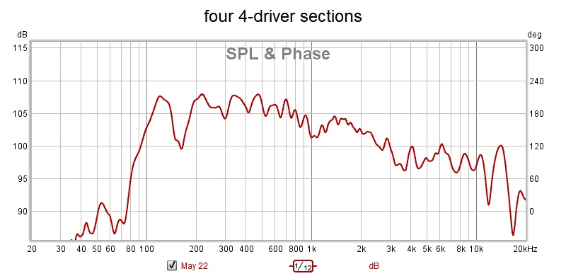

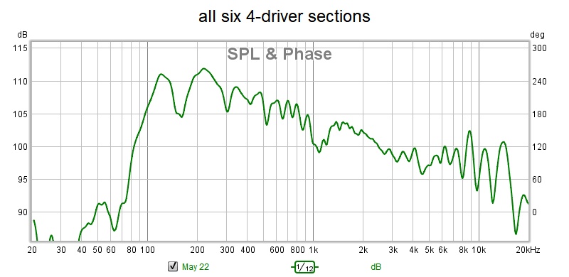

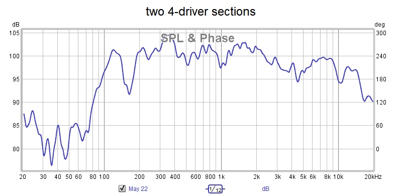

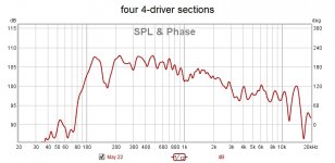

1 section
2 sections
4 sections
6 sections

re' the FRs.
I see the same/similar thing in Vituix model of my array. More "breakup" or general unsmoothness also when floor and ceiling reflections are included (but reflections only appear in the separate room response curve) . As you add sections it starts looking more like combing. In mine this starts at 5 khz whose wavelength happens to be the spacing.
Due to the geometry and the driver's beaming, you get less and less contribution from the drivers at HF from drivers further from the center of the array. As a result, the array is frequency tapered by default. Interesting to see what results from further tapering

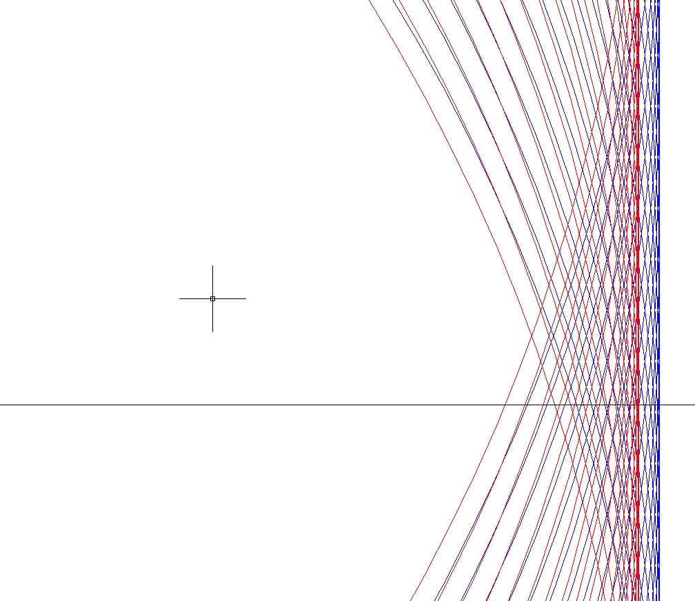

Just be sure to use varying distance from the array as another variable. As it will surely influence where the combing seems to start. Try to measure up close and far away and tell me if the 1/2 wavelength rule still makes any sense.
You've got to start thinking distance to microphone from each separate component in the array for it to start making sense. Which isn't different from any other multiway. Except here we have many more sources. When that sinks in you'll start to see why more than one driver still sums positively at reasonable distances and where and why the combing starts (at varying distances from the array).
Next figure out the same for a CBT. Hopefully that will help for it to start making sense.
By the way, look up the measured impulse of the focussed array, which can be found somewhere in my thread. Do you figure it matters how far apart those drivers are in that focussed array? A CBT is bent the other way, which makes a straight array fall in between these two.
With perfect point sources when in a standard Stereo triangle, the combing from those two perfectly adjusted speakers at your ear will start somewhere at ~1750-1850 Hz. Yet that is what most people strive for and listen to. No doubt there will be combing though! Ever changing if you move position. Have you heard it? No doubt you have listened to it. Have you ever wondered about it? I know I have.

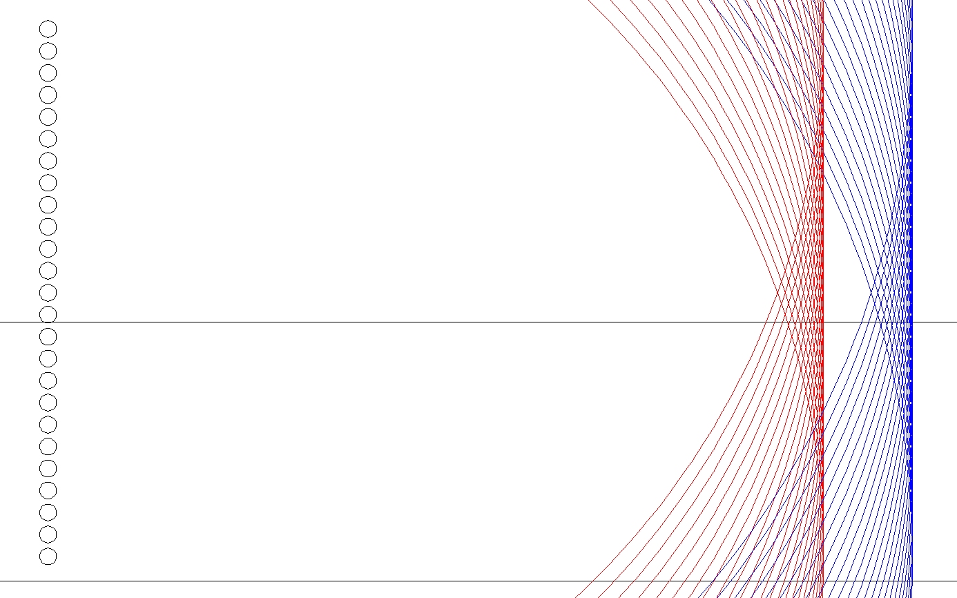

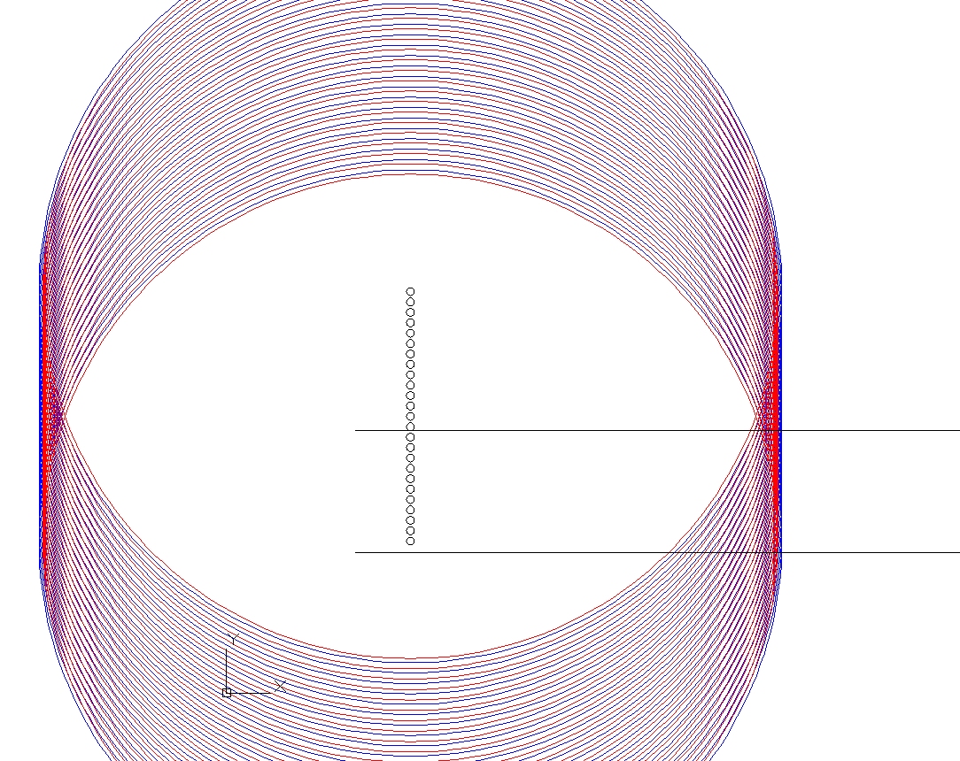

Remember that for line arrays you won't get combing predicted by simple path length difference calculations. That is because one driver placed closely to another alters the local pressure gradient and alters wavefront shape from what an isolated driver produces. Close enough, and you get a cylindrical wavefront launch (for straight array) with single peak in IR. That's what all the 1/4, 1/2, 1 wavelength rules of thumb are trying to achieve.
But it isn't an all or nothing. Even if cylindrical wavefront isn't achieved at the speaker surface, there is still alteration of pressure gradients which expands as the field propagates and at some distance simply merges with an adjacent wavefront instead of interfering with it. That takes a lot of distance in conventional designs... not so much in line arrays with close spacing.

Two additional pictures might explain what I'm getting at...
Seen it done once in a JBL graph to show/explain a horn speaker and it's design axis.
An array of 25 drivers, driver to driver distance is 85 mm. The bottom horizontal line is the floor, the one above that is about 1 meter up from the floor representing an ear or a microphone.
The red circles have a radius of 3 meter, equaling a listening distance of 3 meter. The blue circles are 34.34 mm larger, half wave space of a 5 KHz tone.
Now how many blue lines are in front of the red? That's how many drivers don't yet subtract from the total output. The blue lines that don't make it out before the clear red front, will either subtract or still sum but be a cycle (or more) behind. More circles each at half a wavelength at the listening height would show us exactly what they'd do for our situation.
Let's look at it a little closer:
How many blue lines are in front of that red front? That's how many drivers still sum. The ones that fall behind create the combing pattern as perceived/measured.
Changing the (listening) distance will change the number of drivers that sum.
Changing the inter driver distance will also change the number of drivers that sum favorably, but it can't prevent others that will either sum or subtract, no matter how close you space them. Their output at an angle or beaming behavior does alter the results somewhat.
Repeating this for a lower frequency will start to show why one would/could assume a circular wave front looks like. Feel free to make the graphs of that, and see where all drivers still sum. Or in other words, form a 'cylindrical' wave front.
I did one more at 500 Hz, see how there aren't any drivers yet that subtract from our wave front?
For ease of reading I've left out any floor/ceiling reflection 😱.
