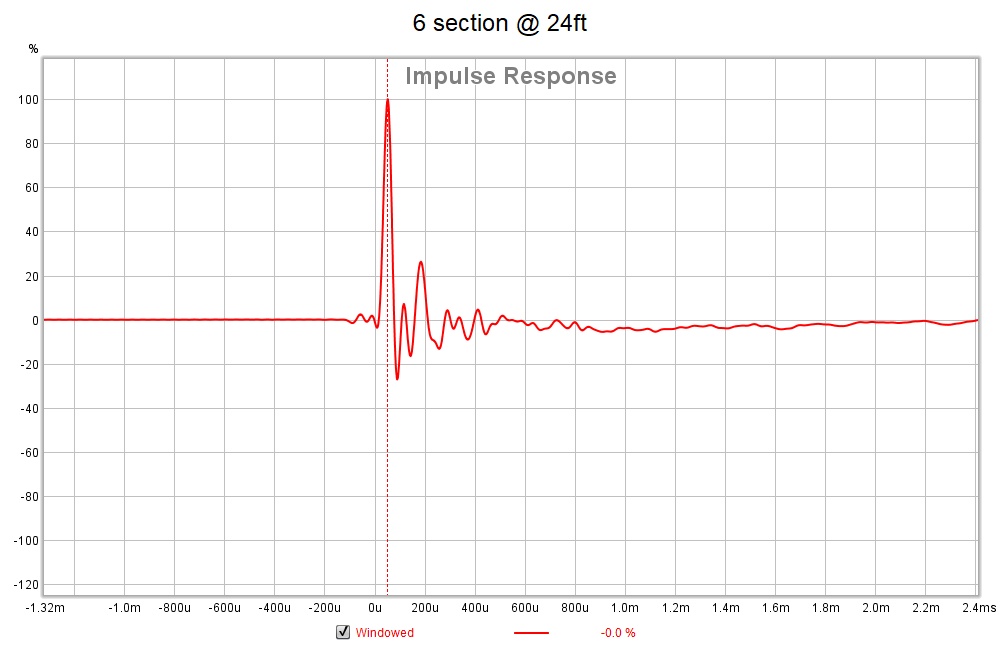

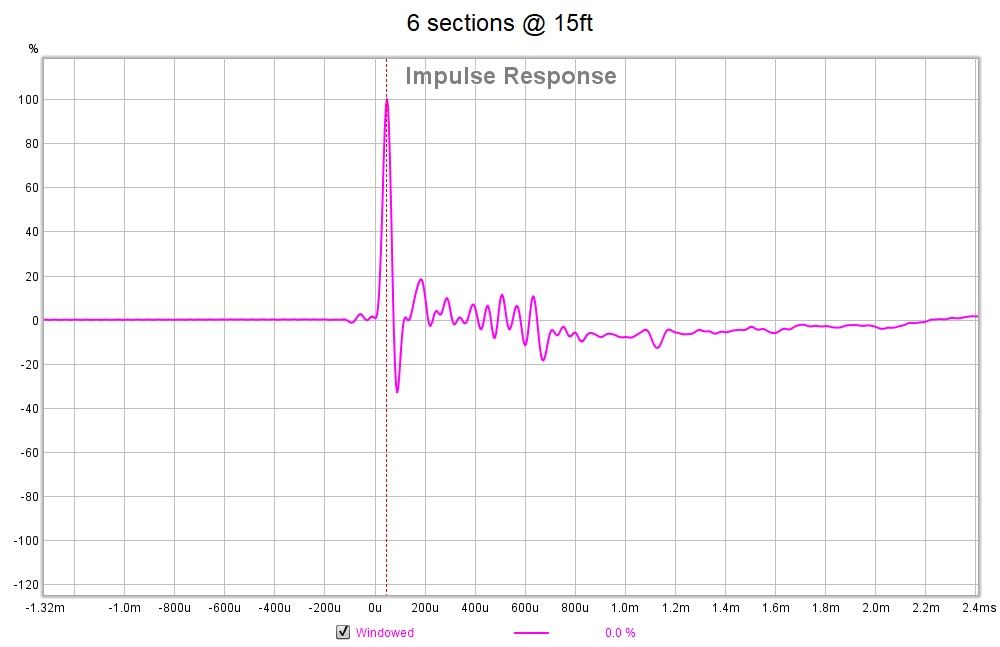

OK, got in some outdoor testing despite lawn movers, a computer crash that lost nearly 20 REW measurements, and a bird perched on the array, probably pooping 🙄
No real surprises or revelations regarding distance to mic...simply more confirmation of what we've all been discussing.
Impulse squiggles diminish with distance to mic, and/or with reduced number of sections. High end freq response oscillations showed same patterns.
It's all totally consistent with multi-arrivals in my casual assessment.
I measured at two distances, 15 and 24 ft. Full array impulses are below.
Not gonna bother with posting reduced sections again, as it repeats the same pattern as previously posted.

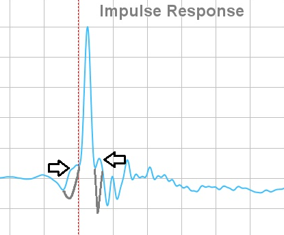

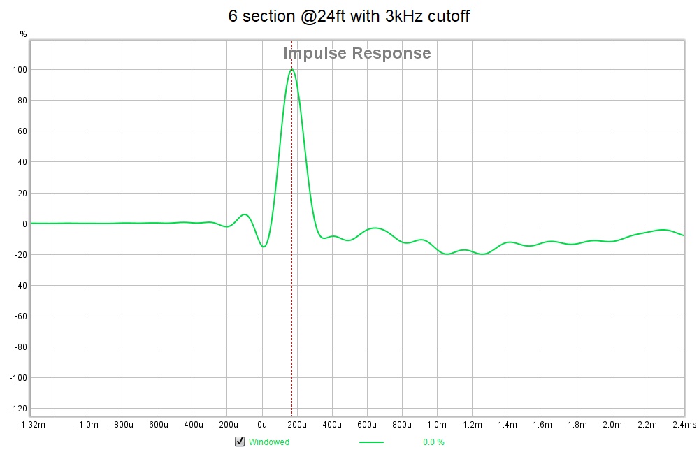

What was fun, and new for me, was looking at impulse with HF/VHF truncation. I started with a 5kHz cutoff as it seemed that's where freq response breakup begins. But then I said heck, why not do it by wavelengths..
So I simply stopped the REW sine sweeps at various wavelength intervals using a TC9 center to center of 3.06". Impulse got progressively cleaner with a march down thru 4, 2, 1, 3/4, 1/2, and 1/4 W/L's.
Best looking impulses were in the 1/2 to 3/4 WL range. 3kHz is shown below for full array at 24ft.

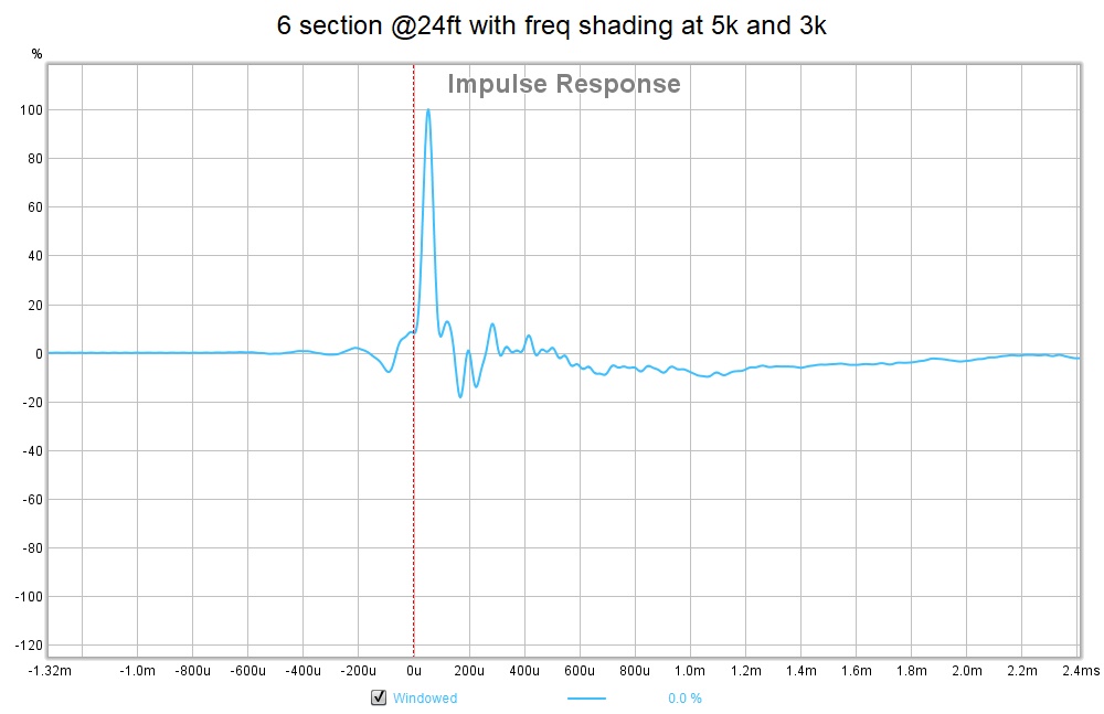

Last, I used the truncated impulse info gathered, to attempt a first stab at frequency shading.
The center two sections stayed full range. The next two were low-passed at 5kHz.
The top and bottom sections were low-passed at 3kHz. LPF were 100 dB/oct linear phase. Delays were set to bring the line back to straight-line timing. Shown below, last plot.
For me, looking at these impulse plots is a must to help decide what to tune and what not. It's time domain info that appears to matter much more than what I'm used to with multi-ways....
I mean Ron, if distance to array is the most import thing, it tells me that multi-arrivals exist big time....and makes me wonder why I even pay attention to infinite line theory.
It seems like I'm throwing away more valid instruction by disregarding 1/2 to 1 W/L spacing, than I am by disregarding infinite line theory.
But it does appear that line theory may work really well down low, particularity with floor-to-ceiling.
I guess a big part of the education here, is learning how full-range drivers fit or don't fit the whole line idea. So on I trudge 🙂

Really cool Mark, you are making me a believer. It wouldn't be that hard to rewire mine for tapering.

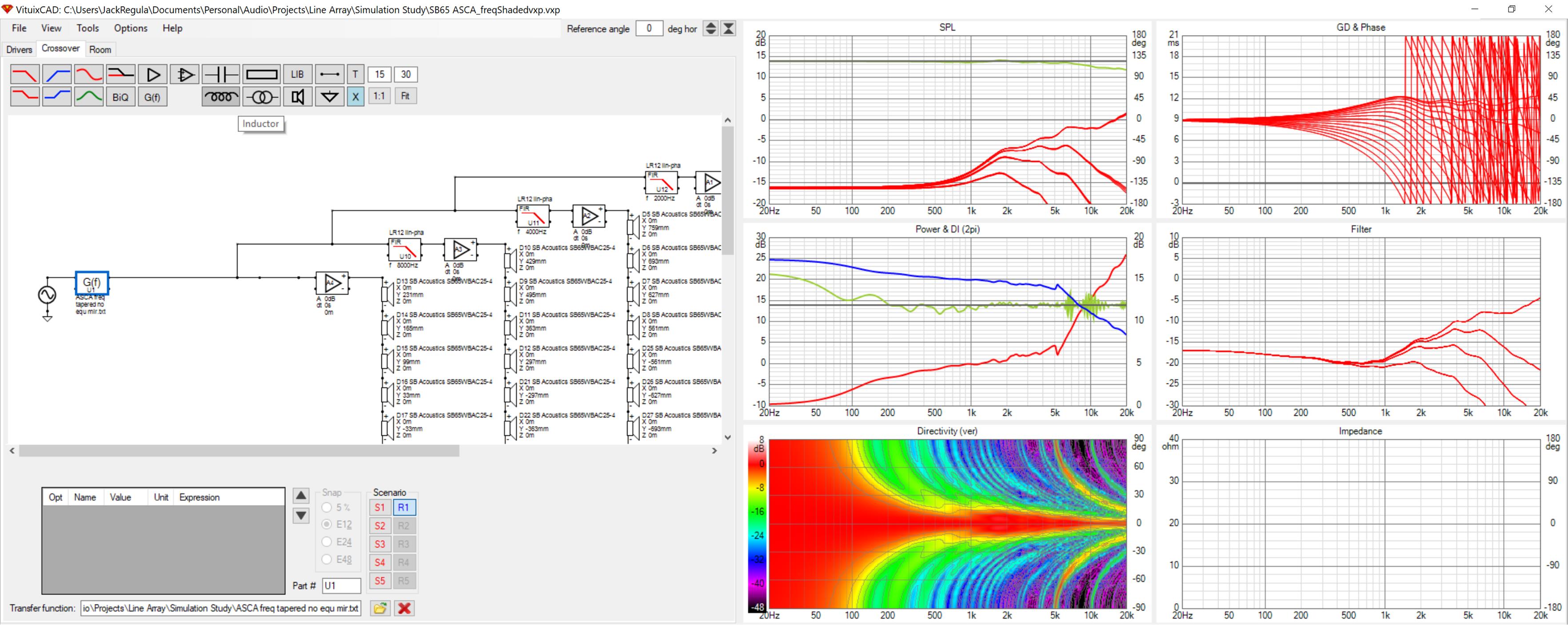

I now have a Vituix simulation of a frequency tapered array following your pattern.
I have the array divided into 4 groups of 8. The 8 center most first, then successively add 4 drivers to the ends until you run out of drivers.
I am using linear phase LR2 low pass filters rather than brickwall. When I tried brickwall each filter gave a spike at its XO frequency. The XOs I used were 8k, 4k and 2k. Little attempt at optimization.
attachment.php
Note how the vertical directivity narrows in the frequency tapered region. That might not be a problem because out at 4m listening distance, _/-5 degree vertical window is 700mm tall. We should make sure the untapered part of the array starts below seated ear height and extends beyond standing ear height.
The flat grey lines in the top graph are the freq and phase directly on axis. The light green line there is the listening window average, which is set to only 5 degrees vertically. With the window set to 10 degrees, the average is worst case -4db where its 2 db for a 5 degree vertical window.
The green line in the middle graph is the room response including floor and ceiling reflections. There are +/-3db squiggles in it. The way to frequency taper floor and ceiling reflections would be with thin treatments.
I love having a simulation that can fill in for a limited set of measurements.

I know your comment is directed at Mark, nevertheless I've been pondering the issue myself.
The way Vituix works I'm simulating a finite line but I can get a room response that includes floor and ceiling reflections, which gives a result equivalent to a 3x longer line but only at a reference angle. It doesn't show me what happens to the vertical directivity. It does show increased "squiggles" on axis due to the reflections.
Combine driver beaming at HF with the increased angle to higher order reflections and frequency tapering definitely occurs in real systems regardless by default. I have to review werewolf's thread but I think the derivation was from omni-direction point sources.
What someone needs to do is bring the frequency tapered array indoors and measure there. That might even be me after I build the 2nd array. Meanwhile I'll be doing more sims.

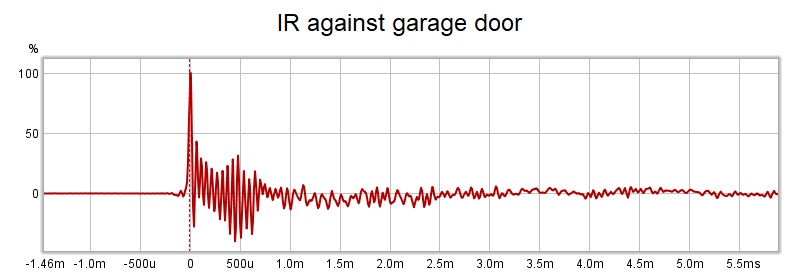

Let's see that horrible raw pulse again from the supposed infinite line:
757684d1558281985-range-line-array-wall-corner-placement-ir-garage-door-jpg

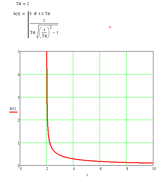

Now let's look at what the true infinite line is supposed to look like:
656847d1515958284t-infinite-line-source-analysis-capture-png
Source: https://www.diyaudio.com/forums/multi-way/314917-infinite-line-source-analysis-19.html#post5308524
Anybody dare to guess about the reasons for the differences here?
The true infinite line has unlimited sources and bandwidth. Hence the shape of it's impulse. However our "as build" line array does not feature an unlimited number of drivers and has a limited bandwidth. This is exactly what the IR shows with that series of impulses. (it's how the IR shows it)

Which is what I have been trying to get across. I'm sorry to see that the fear of raw impulses have led you guys away from the 'infinite goal'. DRC-FIR isn't that hard guys... and it's free... In other words, like I've said before, it is supposed to look like a train of impulses arriving at the listening (or mic) position before EQ. That is the theory we should have taken/learned from the infinite line source thread.
Heck, email me (PM for details) the impulse and I'll show you what it looks like after DRC...
