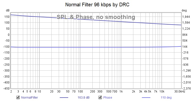

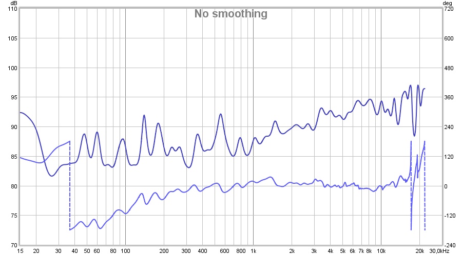

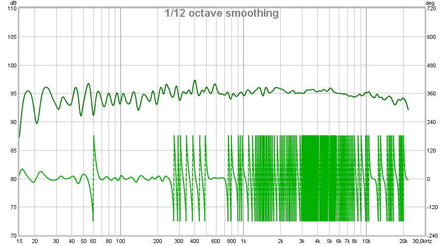

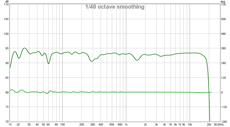

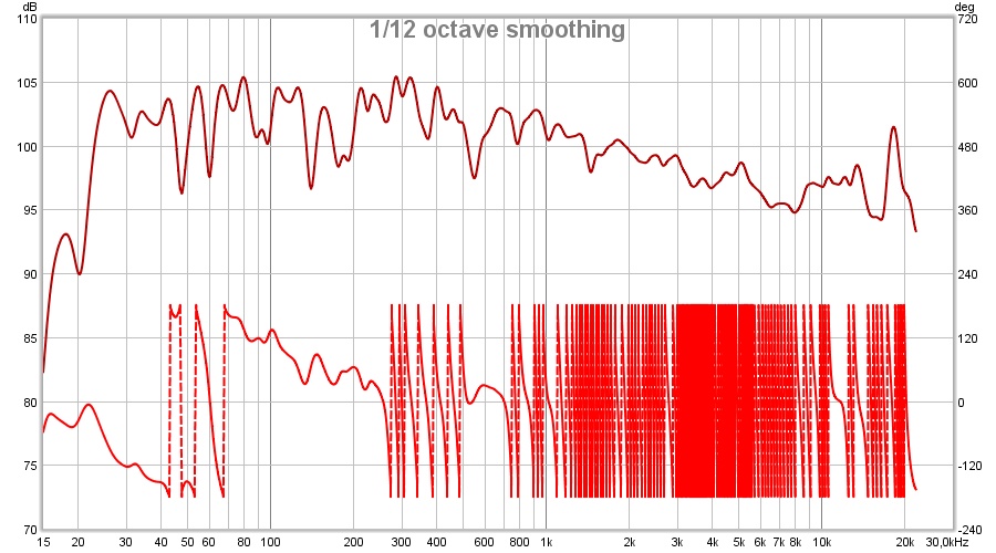

Here is what I get from the Normal96000.drc. Is that what you expected?
As you implied, its not doing any room correction, seems to be just applying a target file and flattening the phase (lower trace).
It looks like what I was getting last night with my hacks, although I may have missed something.

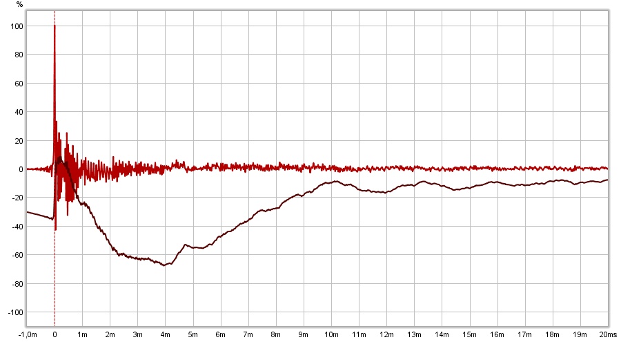

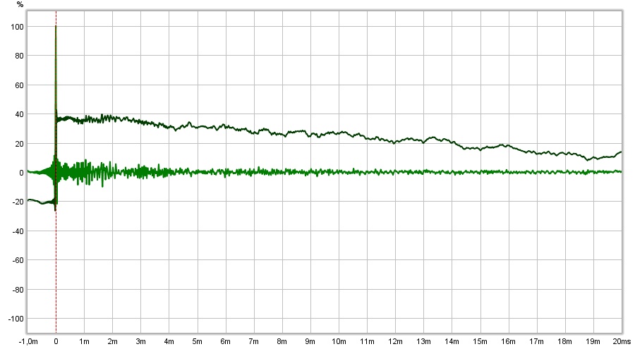

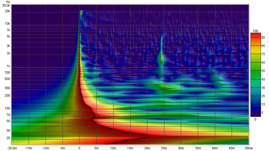

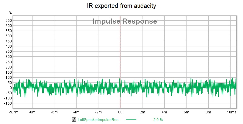

I've got it working, I think, but I've still got a GIGO problem. It looks like I really butchered my IR when I ran it through Audacity. DRC_Designer doesn't ask me to do that so I think I will try with my un-Audacious IRs.
I notice DRC_D uses a painfully long sweep whereas I've got REW set for a chirp 256K sweep. Should I lengthen my sweep?
No idea what kind of an impulse you have used as input, because I never saw a correction being this flat from DC up to 30 KHz+ .

DRC has a few mechanisms going that determine it's output. The NormalXX.drc is an example template and inside of that there will be choices that determine the processing and thus it's outcome.
However it is quite impossible to get the straight (but declining) line you show as an outcome if the input was a real measurement. Still, the outcome is largely depending on the choices made within the template, the microphone calibration you've applied and the template which was chosen. (PSPointsFile)
Within either the template or the batchfile a target is chosen for the total outcome. If I look in my Normal48000.drc template this file points at "pa-48.0.txt"

I'm curious to find out what the input IR was like. It should be something like a 500 ms length IR that has the speaker playing at a reasonable volume to play above noise levels. Personally I use an SPL meter to find out true SPL level by using the Full range calibration sound from REW, so I know the measurements have somewhat of a fixed "real world" reference to them.
The declining frequency response (which just cannot be right) may be caused by internal choices made within this template.

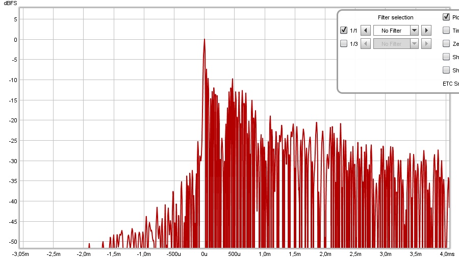

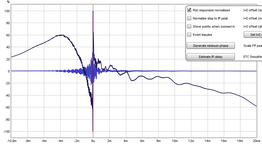

What the .... are we looking at, from where did you get that graph you posted? What is it? What did you feed into DRC to get it? It does not make any real sense to me.
I don't use Audacity, for the longest time I have been using a program called "Cool Edit Pro". It is an old version but allows me to do quick conversions and edits. The PCM file you store for use within DRC needs to be in the right format. I export my full measurement from REW to a 32 bit wave file, no gating or other things applied, then convert it within Cool Edit to the PCM format for DRC_FIR to do it's thing. The tutorial from gmad (Greg) or perceval should explain how that's done within Audacity.
as the target. Opening this target (found in the sample directory) we see this:

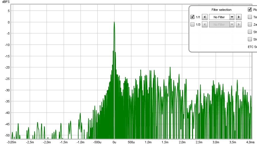

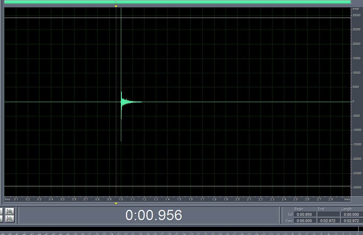

REW exports IR's with the peak centered at 1 second, if it is at t=0 in the IR graph. This is why my "BCImpulseCenterMode" is set to "M" (for manual control) and parameter "BCImpulseCenter=44100" Which means my REW export should have the peak of the impulse centered exactly at 1 second. Let's check that...
Here is my REW measurement, exported the IR to a 32 bit file, imported into Cool Edit it shows the impulse peak centered at 1 second exactly.
This REW export is now saved within the program of my choice to a 32-bit IEEE Float (16.8) PCM file for further processing within DRC.
Now to get back from the DRC template number: 71040 to it's real length in (milli)seconds (should be about 370 ms) we can do as follows:
71040/2= 35520. (dividing the file into a pre and post window on both sides of the IR peak).

Ok, I did see a zipfile with your impulse included. As I'm not set to do 96000 sample rate, I converted the file to a sample rate of 44100 (not ideal but fun for a few tests).
First the raw impulse as uploaded (and converted to 44100) into REW:

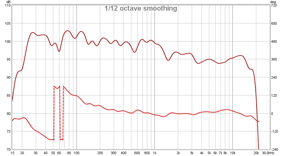

Smoothed 1/12, you should see something similar to this, right?
Next the same data but with a 6 cycle window:
The IR you've uploaded:

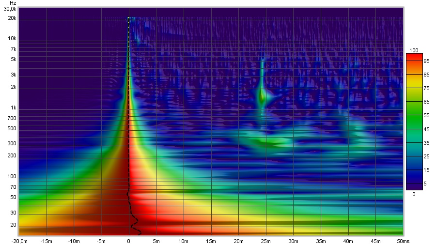

And finally what it looks like in a wavelet, set to show timing (comparable to what APL_TDA shows us)
As I now had acces to the file, I ran it trough my settings. Let's see the results, I used a flat target (flat.txt) for these.
First the corrected frequency response:
The same view, but this time with a 6 cycle window:
The resulting IR after correction:
See how the STEP keeps flying with this flat target? Quite close to what a Dirac pulse would do.
And how it looks in the wavelet:
If this IR is something you've measured indoors in your home, and the other side is acting similar you're in for a treat . Not bad at all, but how is this array of even smaller drivers than the TC9 doing at 20 Hz distortion wise? Is this with a sub running or an array by itself? Do check distortion graphs with correction applied, this looks quite nice though as a prediction!
Your IR looks quite clean for the first few miliseconds! It looks clean overall and only shows something happening at 24 ms (nice as a Haas kicker (lol)).
If you can get both arrays to perform like this, you're in for a big big smile once you find your specific room curve/target and variables within DRC.

Low frustration tolerance is more of a problem than intimidation. I never hesitate to jump in.
But I've traced the problem. Stage by stage results are good until I export from Audacity as instructed in the guide.
There is the garbage going into DRC.
I import the wav from REW to Audacity, normalize, split stereo, rename tracks to left and right speaker impulse response, export multiple, click OK
after normailization, I can see the impulse peak right in the center at 1 second.
exported format is WAV (microsoft) 32 bit float PCM
I don't see any room to go wrong there but something did. Note also that REW has to ask what the bit rate of the audacity output is. Might be a clue there ...
Awesome work.
Yes those FRs look familiar, same as I see on my workstation
And I do have sub in there, not quite time aligned perhaps. I'm doing XO with sub and pre-eq in miniDSP, at least for now, so I have something to listen to while I'm working my way up the learning curve.
Measurement done out in my 25'x26' garage with car evicted

Here is the correction file, that DRC generated with my specific template:
As an IR, it looks ugly, but it won't be what you're listening to:
Let's dig a little deeper into what it does for your array,
showing the filtered IR of the RAW IR we've put in:
And how it looks after the correction:
The file you've uploaded in post 111 is all you need to play with DRCDesigner. It should work with the 96000 sample rate templates.
I don't quite understand what you were talking about here. All you need is the left IR in PCM format, just like the one you've uploaded.
DRCDesigner probably needs a right side file too, as you still have only one array up and running (I assume), just make a copy of the left for the right impulse and start playing.
The resulting FIR filter can be loaded into JRiver. Pick a template you want to try within that custom tab and make sure you put a file name after that "TCOutFile" parameter to get predictions. You probably need to convert that result from PCM to WAV to be able to read it with REW though.
The wavy line you've shown can simply mean you've picked the wrong type of PCM file.
As input for DRC I use 32-bit IEEE Float (16.8) (mono) but some output files from DRC can have a 32-bit IEEE Float (24,0) format. I don't know why, that's beyond my knowledge of floating point 32-bit files. It's what I see with Cool Edit Pro (and why I love that old trusty tool, the date stamp on it is 2002!).
