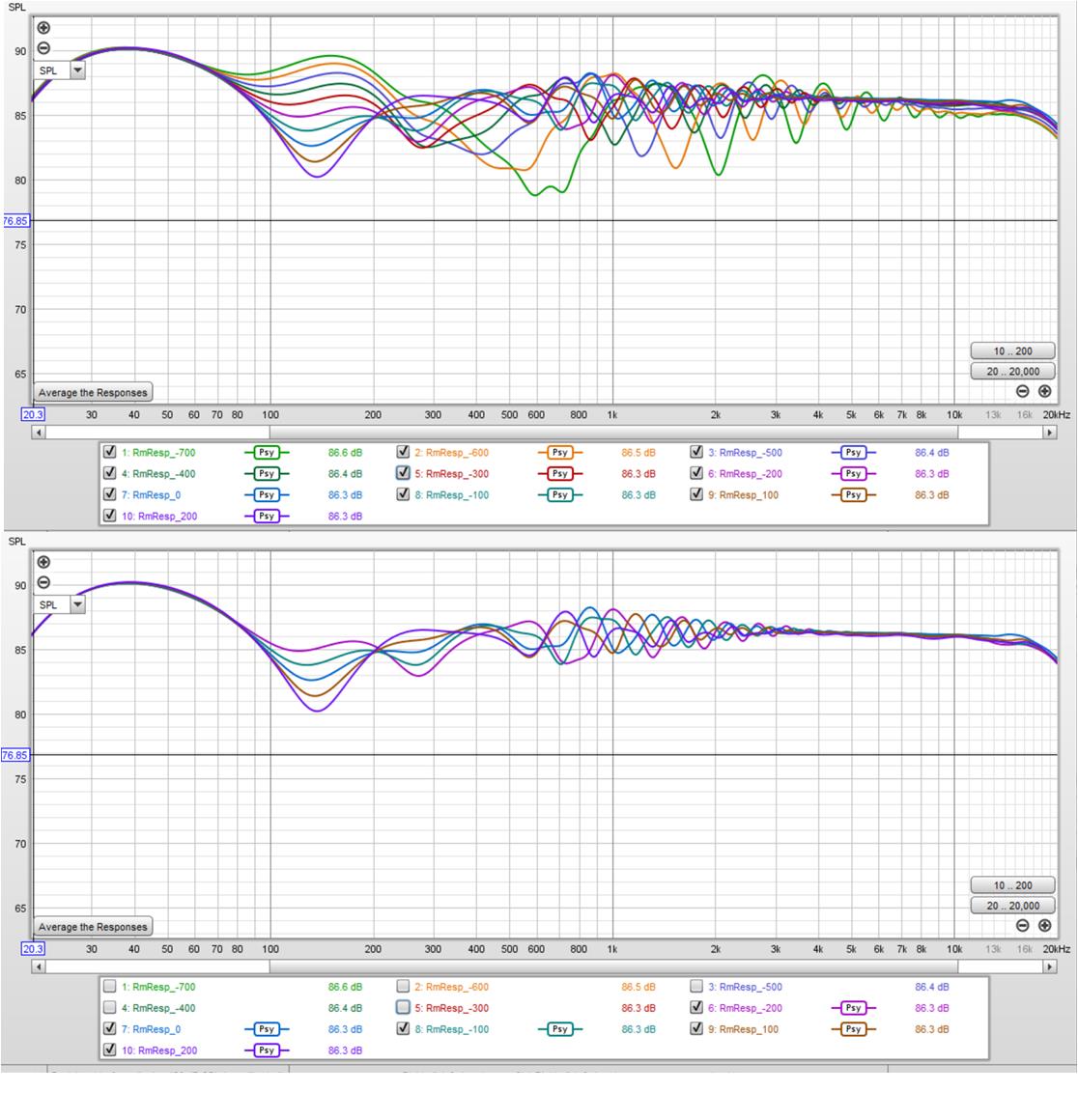

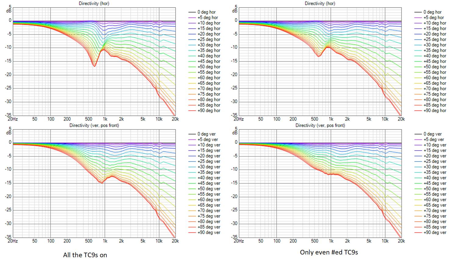

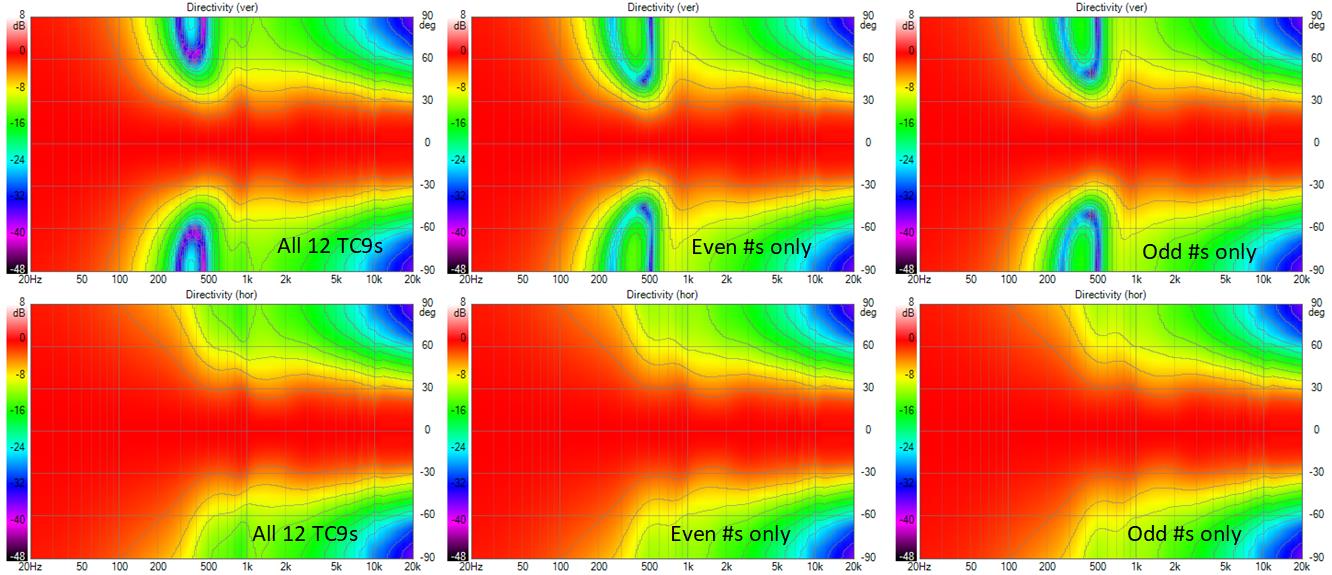

I compared normalized line charts with half the TC9s muted vs all of them on. Normalizing meant I didn't need to change equalization. I was surprised to find that its smoother with half the drivers, with the difference being larger the further off axis one goes. With odd numbered drivers muted, horizontal polars are affected differently than vertical; a reduced number of drivers could be repositioned (rotated 15 degrees) to keep the array symmetrical with respect to the axes.

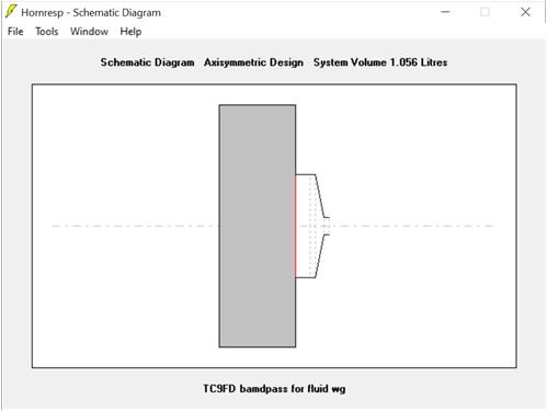

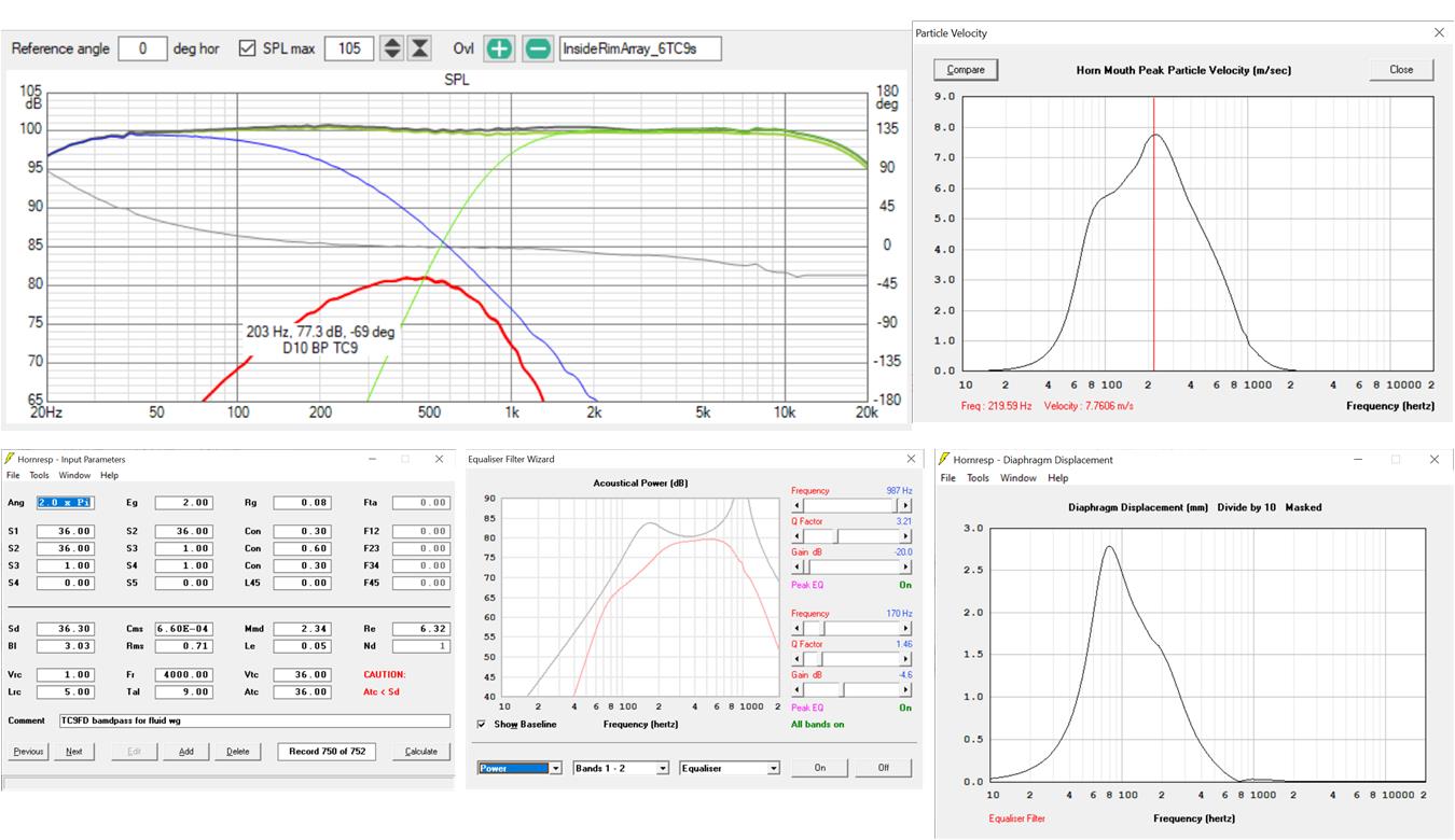

I took another look at the HR sim of a BP TC9. In HR, I used a hole area of 4 cm2. When I did the Vituix model, I used an area of 10 cm2. At the limit, limited by particle velocity in the hole/slot, it appears that 1 cm2 is sufficient.
I've got an air cushion in front of the cone and am allowing a total horn wall thickness of .9 cm. This doesn't appear to be especially critical but I will be happy to adjust based on anticipated construction details.

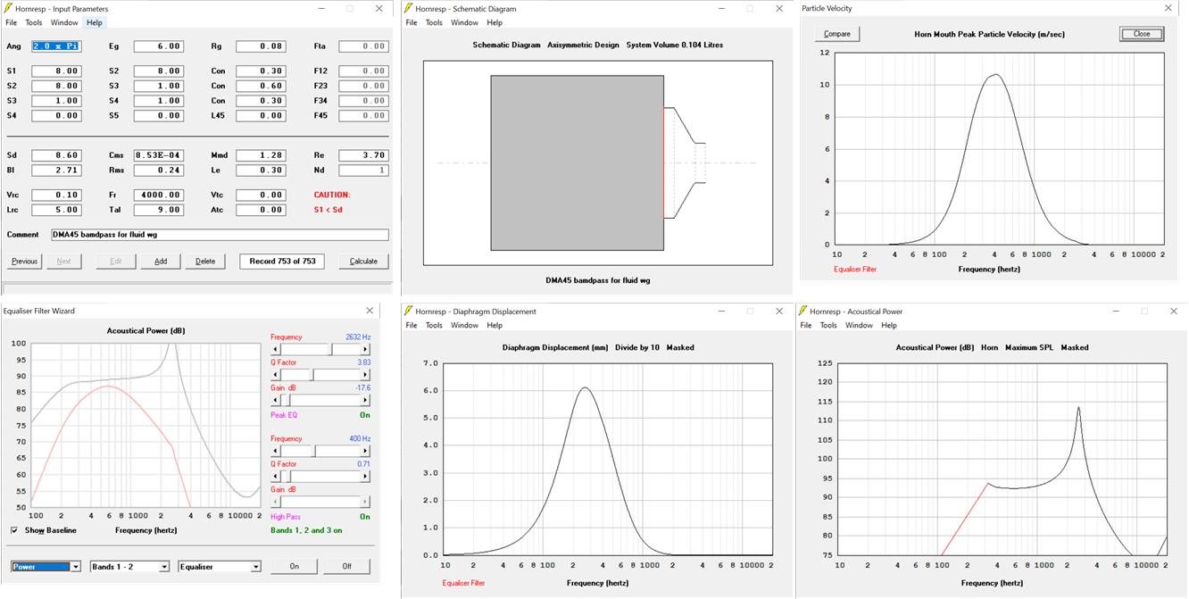

Here are the HR sim details and the correlation with the Vituix sim
The HR sim level is above the Vituix TC9 spl level at and near the particle velocity peak.
I will get a much better correlation by exporting the raw bandpass response from HR and do the filtering in Vituix. I'll do this at the same time as reducing the port hole size (diaphragm size) in the Vituix model. This will make the array look very much like an array of point sources ...

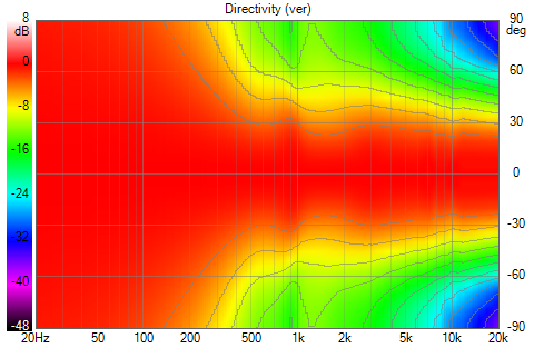

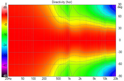

Notice that as good as these polars are in other respects, they show pattern control "only" down to 400 Hz or so. That shows up as a problem when I look at room response vs offset. They will need additional drivers outside the wg to get back to the vertical control of rim arrays. Fortunately, it seems from these sims that 6 drivers per ring is sufficien.
yeah, almost

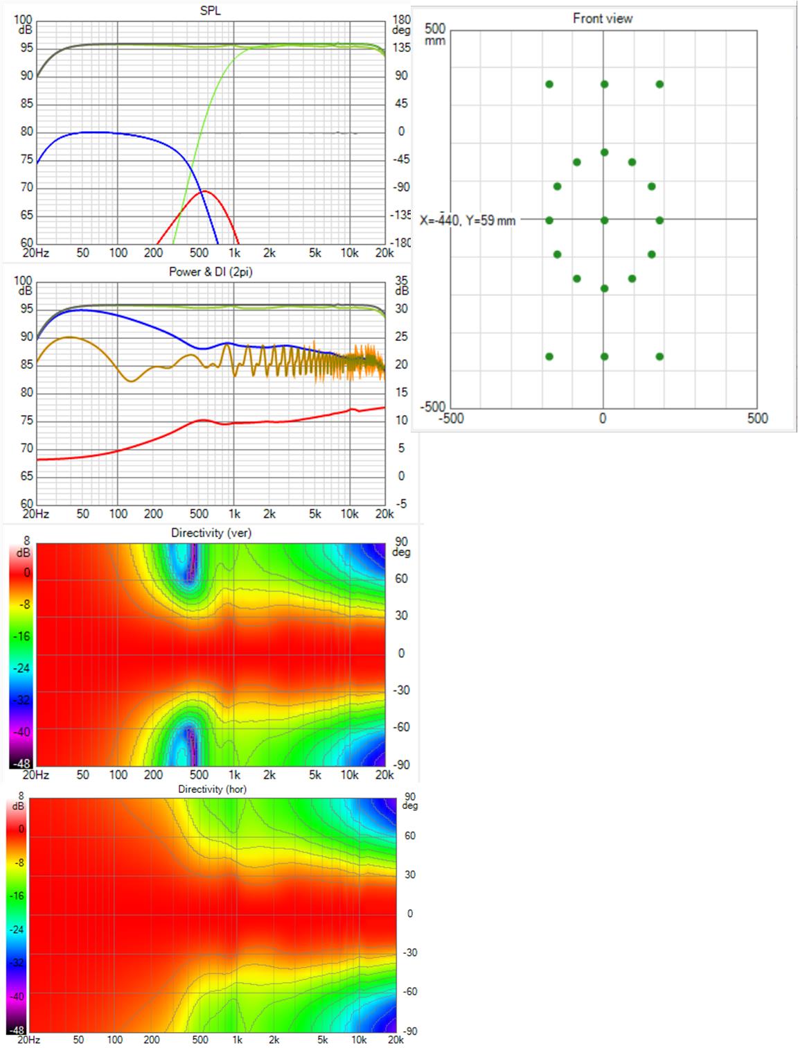

Yesterday's question was how to increase the vertical directivity. The first answer that came to mind was to add rows of drivers at +/- 360 mm, twice the distance of those in the ring.
That was encouraging so I took a closer look
I think the response above 400 Hz is as good as can be expected with a 60V waveguide, without floor and ceiling absorption. Below 200 Hz, the variation could be improved with more drivers at even greater vertical separation but the room is going to dictate what is needed there.

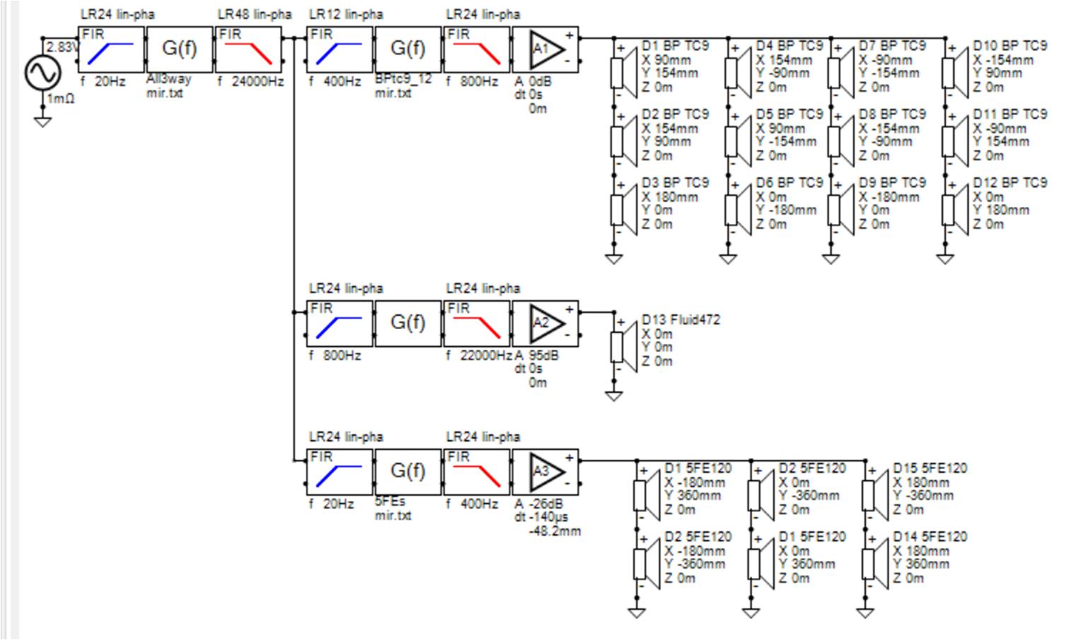

Here is the crossover screenshot:
there is a level of global eq that eventually would be used for voicing. right now all it corrects is 1-1.5 db dips near the crossover points.
Note that there is no overlap in this XO. The TC9s play 400 to 800 Hz. Limited to that range, smaller, lighter drivers may be more appropriate. The <$8 Dayton DMA45, which was one of my original line array candidates comes to mind.

the DMA45 HR sim looks good; better than that of the TC9. The bandpass peak is well outside the passband and only simple HP and LP filters are needed to shape the response. Its 1/4th the compression necking down from an SD of 9 to an aperture of 1 cm2. The drawback is the DMA45 is only 80 db sensitive. In the current sim we are driving each of 6 TC9s to an 80 db level to get 103 db total SPL. The HR sim below shows the individual max output is 93 db
