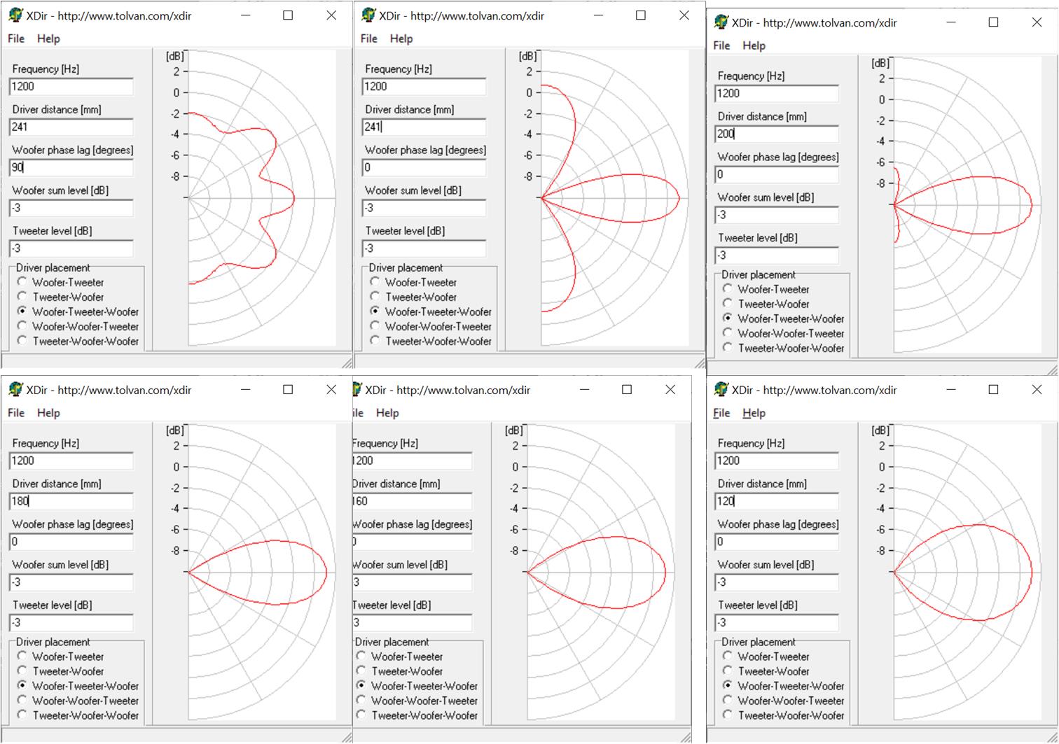

I don't have a handy rule of thumb for ring radiator pattern but of course it scales with diameter. The question is how wide must it be half the wg dia,? 3/4?

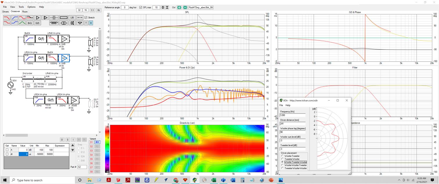

Somehow this train of thought reminded me that an MTM has a wider pattern with a 90 degreee crossover so I tried one:
that is a 4th order IIR Butterworth at 1 khz, just the wg and rim array. It has the narrowing but the room response below XO has entirely different character and is much better behaved for large offsets

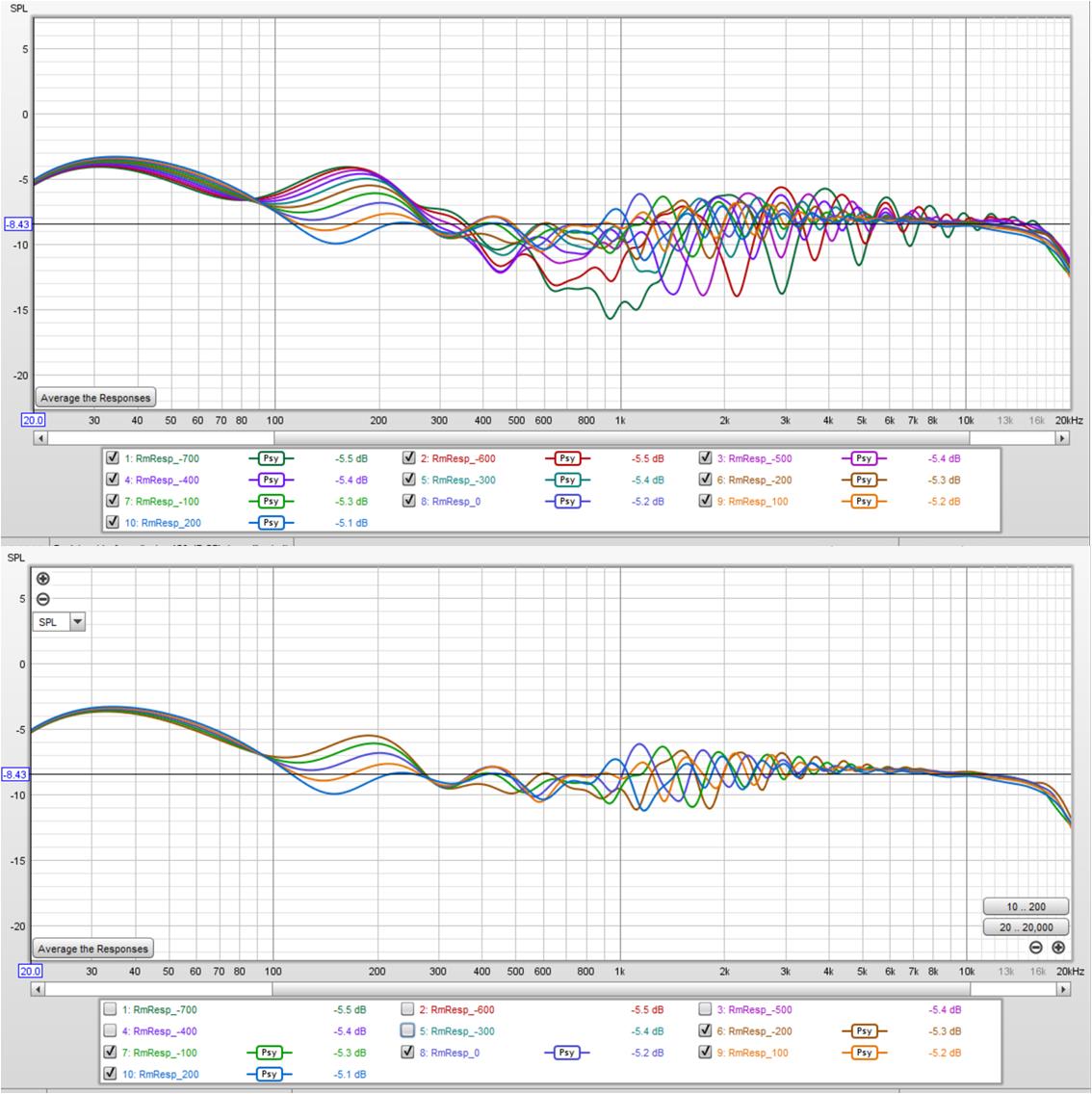

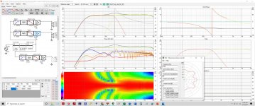

taking a moment to add and dial in the td15 at floor level:
The global eq I did to flatten the overlap between TD15 playing up to 275 Hz and TC9s playing 100 Hz++ also flattened the rise at 1khz from the BW4 XO and flattened the phase full range. The listening window RMS, green line below, is +/- 15H, 20V
There is now a 3 db dip 10 degrees off axis
what I would like to do is make 5 degrees off axis my eq reference to split the difference across that 10 degree window but Vituix apparently only does 10 degree steps

here is the horizontal line chart again, this time with 5 degree steps and using 5 degrees as the reference angle.
that looks more than good enough to cover the width of a couch
I noticed the in phase XO also has a dip below XO, but its half the depth or less...
I suspect this dip is due to the mid array narrowing too soon

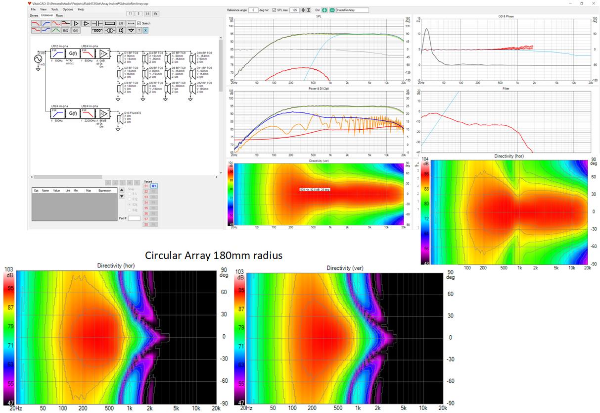

taking the hint, I created model for a circle of BP TC9s with 180 mm radius and simulated that with the fluid472 waveguide. this is what we might get if we did the MEH thing and cancelled the reflection of the mids from the CD's phase plug.

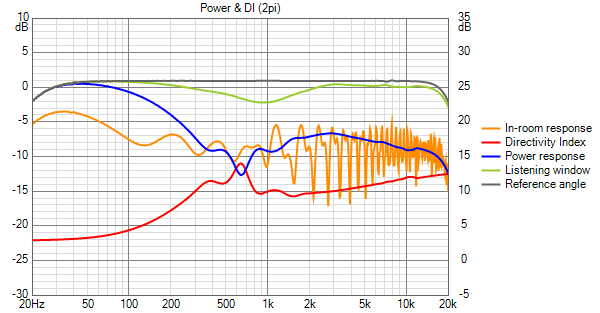

The power response dip vs in room response variation is an interesting point too.
I've had a couple of lightbulbs come on due to reading this Genelec paper, nothing concrete yet but I see possibilities there.

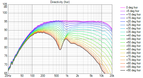

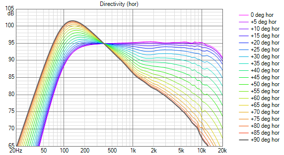

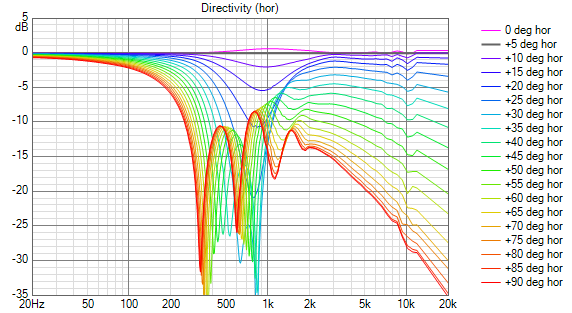

Here is horizontal line chart for wg+ring. Its flat on axis and progressively unflat as you go further off axis. I think that the valley below 1 khz that deepens as we go off axis is due to the ring combing with itself
Here is the wg only, assumed to be synergized so plays from 100 Hz up. Don't ask me to explain response below 400 Hz, but above it, response is not exactly flat but doesn't have that ripple we saw in prior chart for all off axis angles. After equalizing the CD, the only change in FR with angle for the synergy should be due to the horn shape.
if the ring isn't combining with the CD into a point source then if we measure its FR from an extreme off axis angle, we should see FR ripple from drivers on opposite sides of the ring combing with each other, like looking at a line array from the end.

My major purpose in modelling was to see if 180 mm was the correct radius for the ring in that waveguide. I said "this is what we might get if..."
If you create the abec model, we can get a good idea how close we could come to that ideal in reality. I would not want to have to go through the abec model multiple times optimizing the ring diameter. It might be a good idea to try 190 and 200 mm because the further out we put the ports, the less harm they will do...so we should find the limit.
as well find how small we can make the holes from a bandpass response and particle velocity point of view. I modelled 4:1 compression; can likely go 8:1;
It is indeed curious that H and V maps aren't identical absent any boundaries
so there is lots to do once we are convinced we have proof of concept.

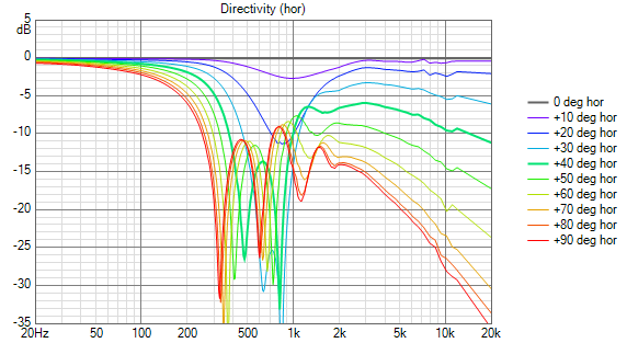

I'm just now once again realizing how much a normalized polar map can hide. These un-normalized charts are more informative.
It is due to using normalized data and not measured data. There is a tipping point where off axis goes up the further you go.
