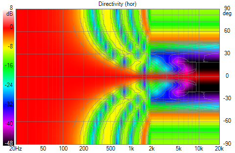

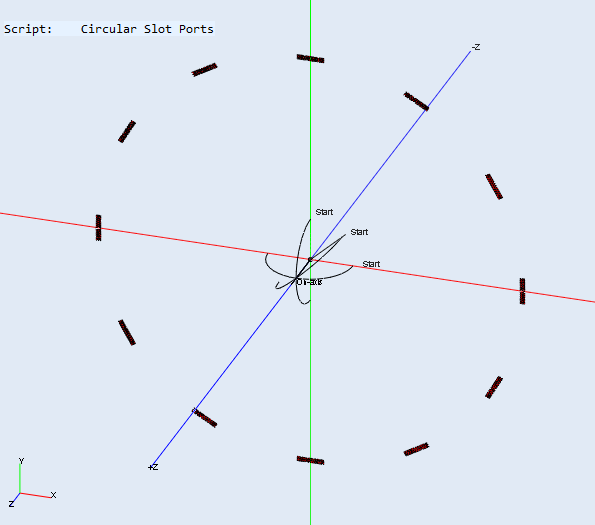

Here it is it worked doing it all as one, if you wanted to play with weights etc. then you could do each one separately. I made this by drawing a rectangle of the right size in Fusion and making a circular pattern of it, meshing this in gmsh at 5mm and importing.

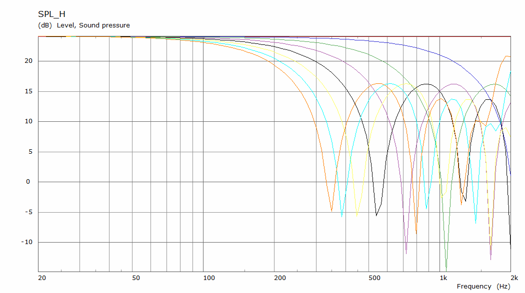

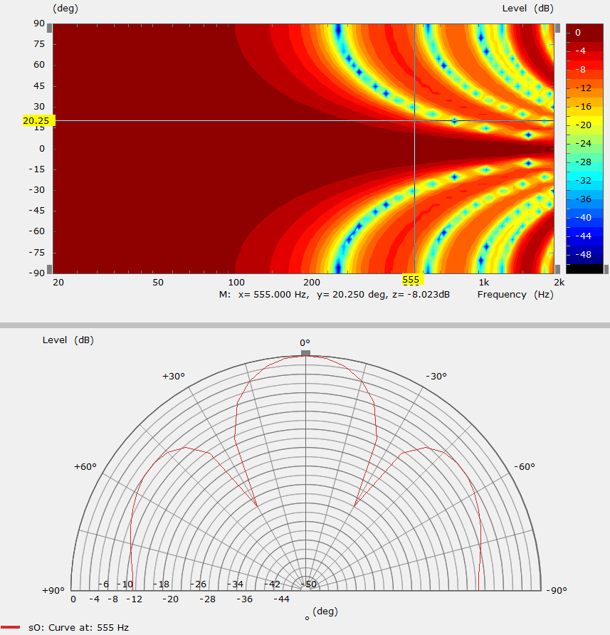

The frequency is 20Hz to 2K as really much beyond 500Hz is getting lobey. Vituix data attached. That is infinite baffle so use diffraction tool in Vituix.
The 20 deg pattern point is at about 555Hz as can be seen from the Polar.
H V and Diagonal are all the same so just mirror in Vituix.
There is no symmetry used as it wasn't really necessary and would have taken longer to CAD and mesh. The ABEC project is attached, it will import into Akabak but the observation planes end up wrong and the scaling can get messed up. I find it easier to do things from scratch in Akabak as it takes longer trying to undo the stuff that is wrong.
To see what was done look at the solving text file, you will see the frequency range defined the number of frequencies, whether any symmetry is being used and the mesh frequency (which only matters if using ABEC's own meshing).
Then the Mesh File is scaled with it's alias M1
The exterior subdomain is created as the only one as there is effectively nothing behind the baffle.
The Element for the the ports is created and named, assigned a unique number and linking the mesh alias and which tags are used.
The driving elements are labelled and referenced
The Infinite baffle plane is defined
The observation script links to the driving elements and set out the required spectra to be calculated, the parameters are set and given numbers to reference

The concentric ring behaves a just like an axisymmetric source below the point where it starts to lobe, it really is the same in every direction, that is why I only posted the horizontal, every other graph is the same just with a different label.
In an axisymmetric device it has to shrink or grow in both directions at the same time it cannot be otherwise. That is why matching it with a ring makes conceptual sense as the patterns are similar, what makes less sense is trying to force it to do something it doesn't want to which then makes the polar shrink and grow.

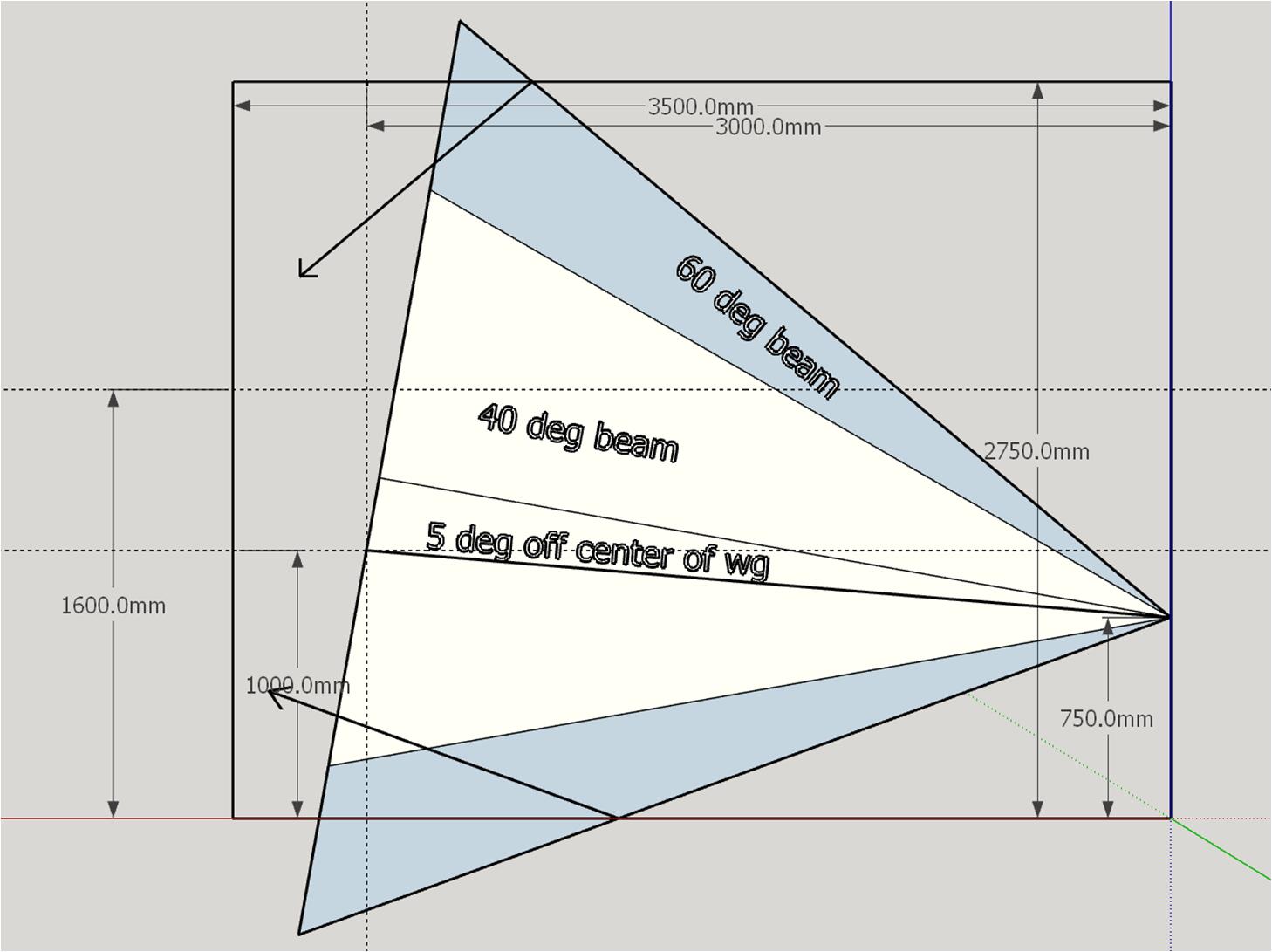

I think I'm between a rock and a hard place regarding the narrowing. If I fix the narrowing, the floor reflections get worse. The issue is the 60 degree waveguide but going to an elliptical 60H40V or 80H40V would not be without issues. I don't want to go wider (that is Mark100 territory 🙂) so it would shrink vertically, requiring a cross over to the rim slots the square of the pattern ration higher. That might well work but I've been wondering if the rim array and waveguide can't simply be tilted back 10 degrees. With a one piece rim array model, that is easy to try. I was lying in bed doing the trig in my head to figure the Z position for each slot. I got up to find I don't need to do that!

tilt back geometry
Here is the geometry for a tilted back 60 degree waveguide with the array center lowered to 750mm. The floor ceiling reflections mostly miss the head of a seated listener at 3m or so. A standing listener is not so fortunate.

This seems like it would help. I'm visualizing a gimbal mount for the free standing waveguide and rim array.

I can see that tiling the array and wg is not a good idea 🙂

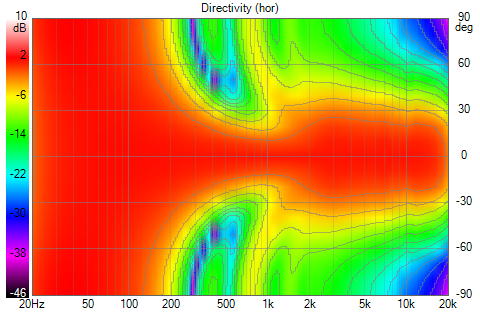

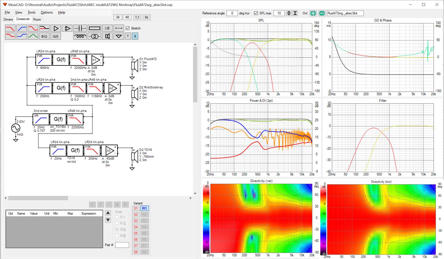

This is what I settled on after some fiddling. I optimized the polar maps rather than allowing narrowing in the vertical which would have improved the in-room response.
attachment.php
the waveguide plays 600Hz and up.
The rim array plays 200 Hz starts down gradually wih a Q=0.2 2nd order lowpass at 1 Khz and turns down sharply at 1156 Hz with LR48, all lin phase.
The td15 at floor level plays 20 Hz to 200 Hz

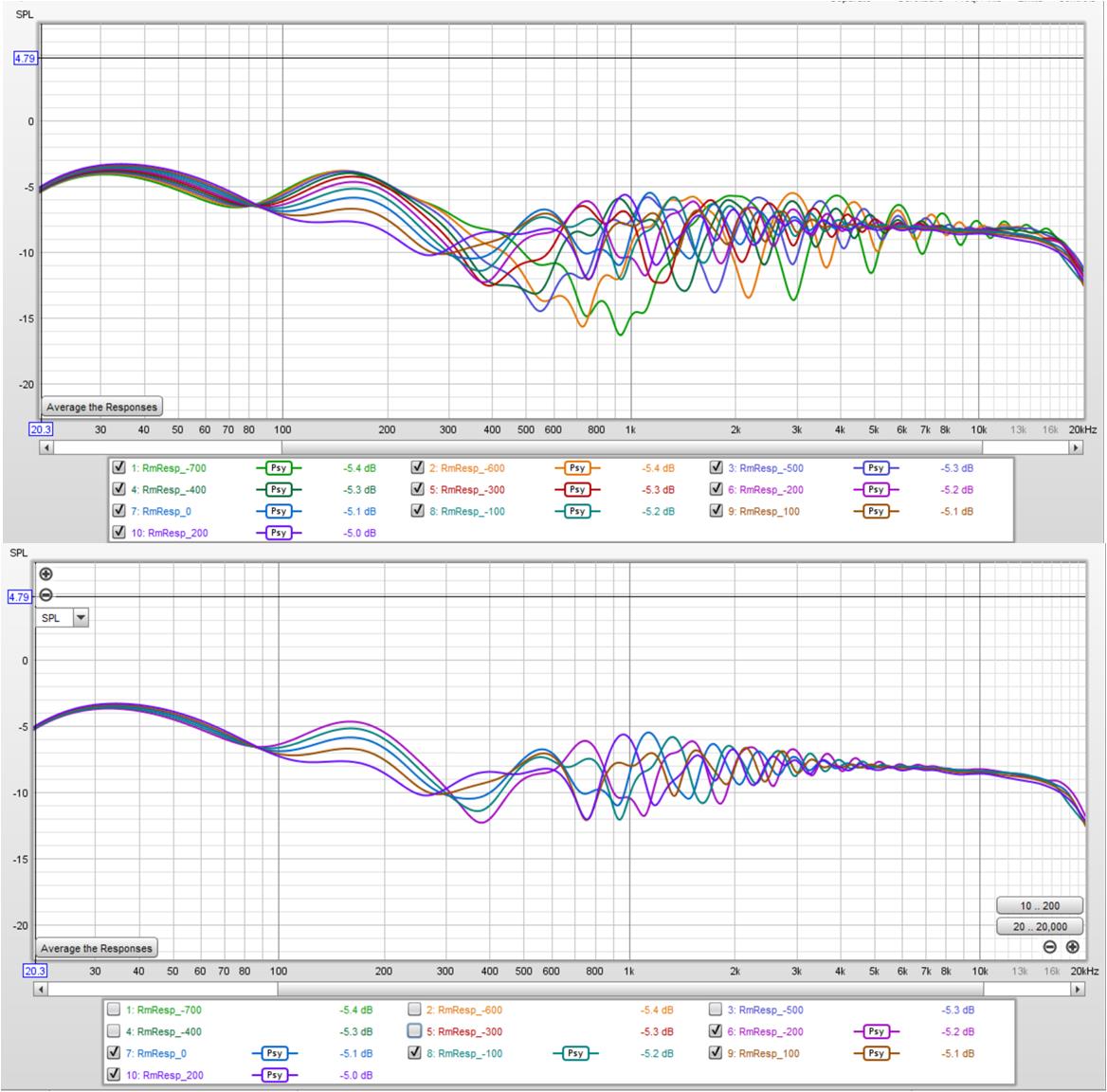

Equalized flat on axis anechoically, the room response vs offset:
attachment.php
Its +/- 3 db for +/- 200 mm around the eq height and array center of 1m.
The widening around 1 khz is because the rim array response narrows too soon to be able to control that.

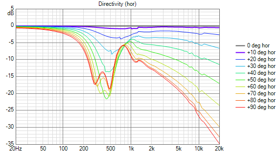

Here they are again:
first, the waveguide
attachment.php
and then the rim array
attachment.php
the first +/- 10 degrees are good, then we see the narrowing.
