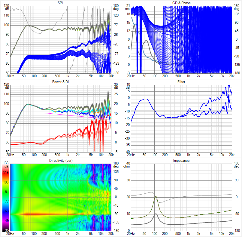

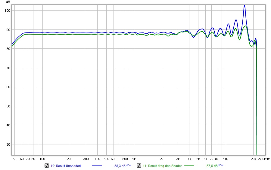

I tried the same recipe on the unshaded arrays. So 5 heights averaged and used for the correction.
First the model without the ground image:
attachment.php
And with ground image applied:
attachment.php
A bit more wobbly in the higher regions I'd say. Let's compare both curves as corrected:
attachment.php
Some shading may be in my future 😉.

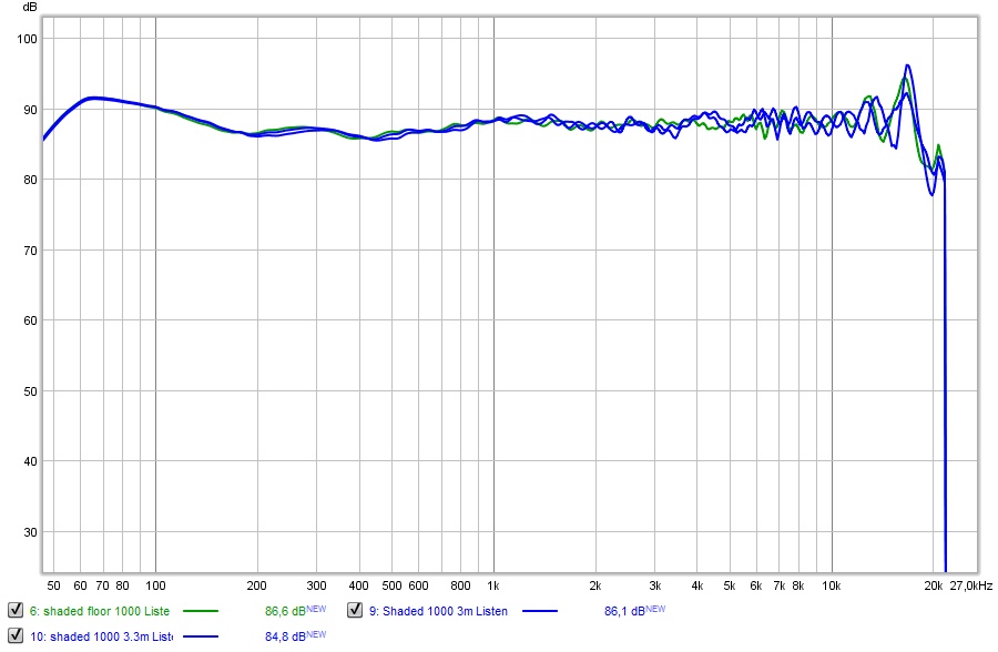

So far moving away from the correction position (2.7 M) to 3M distance to 3.3M distance seems to hold up pretty good too:
844094d1589486640-range-line-array-wall-corner-placement-fr-distance-2700-3000-3300-jpg
I've corrected for the SPL difference (from moving further away) to see FR plot changes. Quite acceptable.

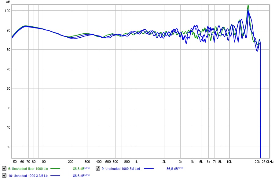

Unshaded:

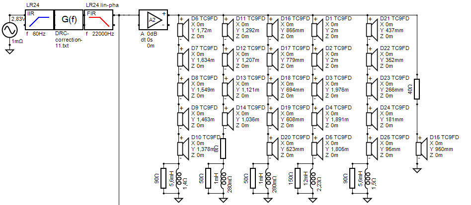

My shading schematic (the base for this was one of nc535's schematics with floor image, I adjusted it to meet my specific driver positions)
attachment.php
I haven't looked up the resistors yet, but the inductors can be had (even in air core) for not a lot of money. I found a few Jantzen Air Core that would fit the bill.
I may try and improve on this, but my main goal is to keep what I have that's regarded as a positive (good balance in sitting and standing positions).
I've looked at it from all angles I could think of and come to a preliminary conclusion that chasing this could very well be worth the trouble.
That is, without going all out with a super DSP aligned solution. I don't see myself moving in that direction. This is a relatively simple solution with potential. More simming could lead to even better solutions.
(I've done 12 so far! 😱)
I'm using DRC to do the corrections, exporting what I need to REW, average them and run DRC on it with one of my templates.
Then I convolve the pré-EQ with the DRC correction and export it as txt to apply it to the Virtuix model.

It is completely reversible... should it not bring what I hope. Just a lot of work. I do believe this scheme does not reduce output anywhere, the same amount of drivers runs at lower frequencies. Improvement in the upper frequencies is obvious, you could make a killer correction at a single position with this in place, but the up/down movements would be limited. However I like what I see as far as early waterfall plots go.
If I look at the sims, I ran the unshaded one 1 dB hotter, but looking at the filter window in both sims the 10 center drivers run with a similar amount of boost as the unshaded 25 drivers. That means they do have to work a little harder. I expect real world results will be a bit better at the top end, also based on your outside measurement but cannot count on that. I'll try and match SPL in both and adjust and compare.
Wesayso, don’t think we can call that shading. It’s an expanding array, no? Great sims, btw.
It does come close to an expanding array but not quite. I do use 6 dB (resistor bypassed with an inductor) shading for the first two groups and 12 dB for the upper outer group. I plan to sim a complete expanding array with a single top end driver, still using this high shelf attenuation scheme. I can't predict the outcome, the sim will tell the story. 🙂
I've 'only' done 12 sims so far... showing one... It costs nothing but time.

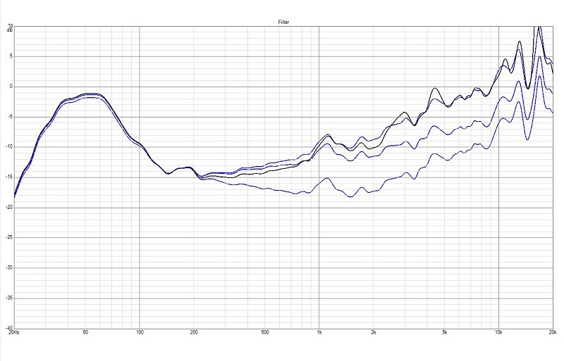

Adjusted SPL to match, and overlaid both SPL and Filter graphs...
First the SPL graphs:
attachment.php
(Unshaded measurements are in grey)
And next the Filter graphs:
attachment.php
It seems the top correction is about similar, but shared among less drivers.
The peaks in the Unshaded version are higher, without it getting a flatter correction as a result, it may sound louder though, due to the peaks.
Bottom end is practically the same, with all drivers sharing the load. The top 5 filtered drivers fall back about 1 dB due to the 2.23 ohm resistance of the air coil inductor. The other 10 filtered drivers can be seen lagging less than half a dB, due to a 0.8 ohm air coil inductor.
So all in all, we do get better upper performance but they will be working a bit harder with 10 vs 25 drivers playing the upper end. Bottom end is a tie.

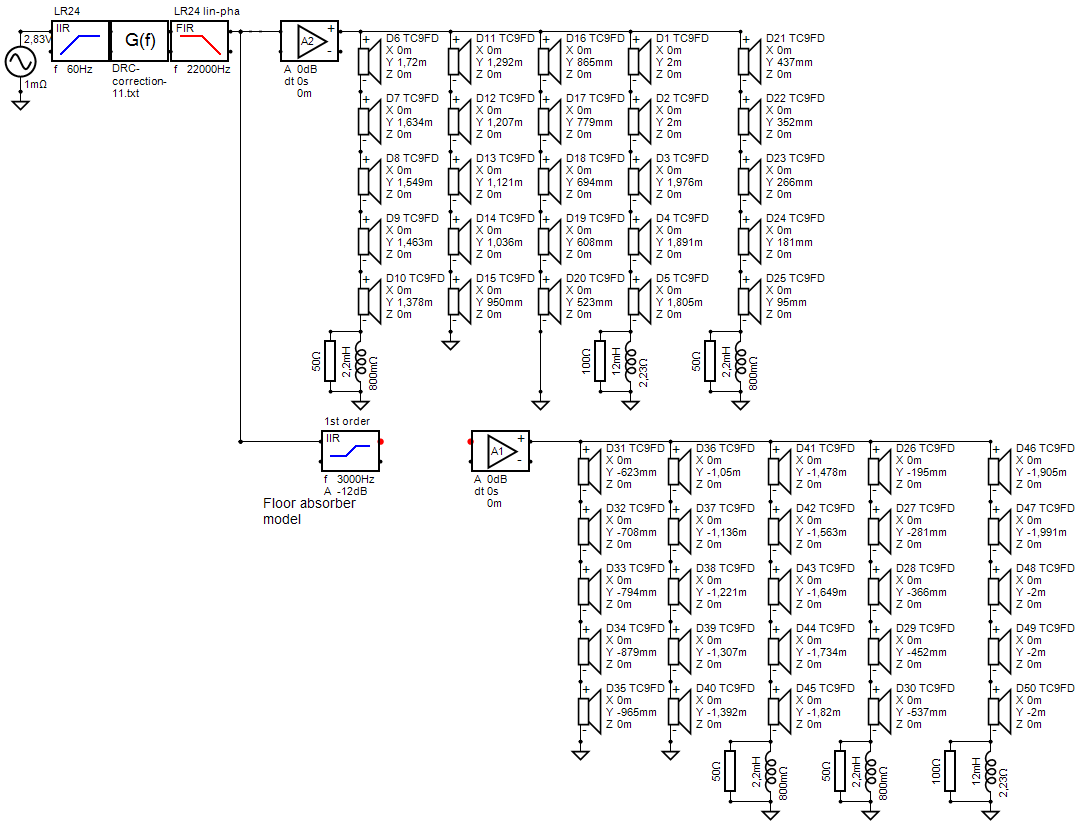

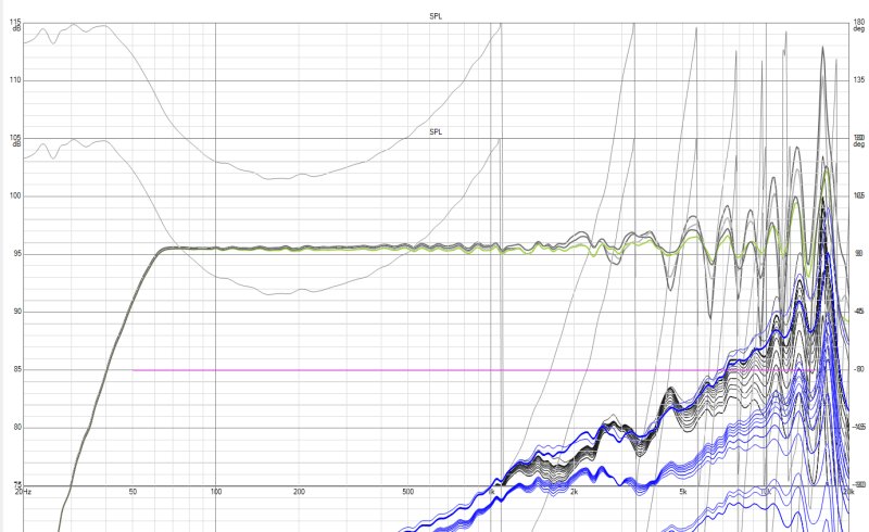

Teaser for the expanding array, isolating one driver for the top end.
No time to finish simulations, just a raw sketchup.
attachment.php
Need to finetune the resistors and inductors and the sole driver will need compensation for the impedance peak, a simple resistor isn't cutting it.
Sole driver is at listening level, 100mm, I know it says 950mm because the floor level in this model actually is -50mm where the mirror line is for the
simulated mirror drivers. (long story)

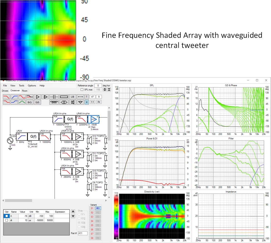

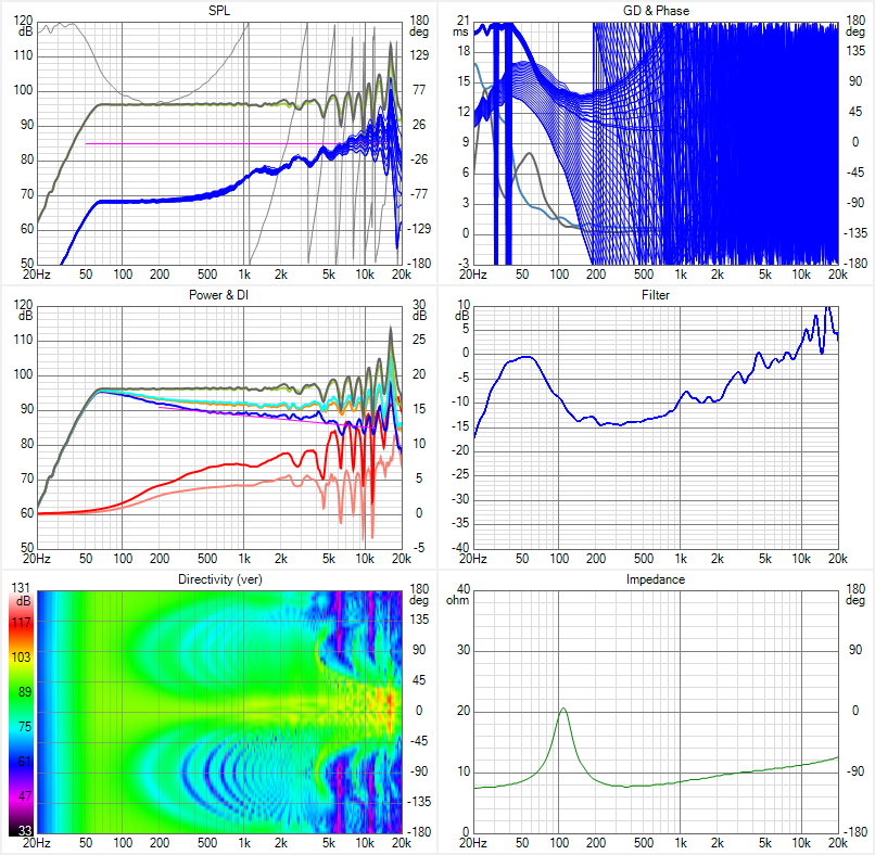

In the spirit of climbing a mountain because it is there, I pursued the central waveguided tweeter idea with a modicum of success. I modeled a 3/4" OS profile 3.5" high in HR response than exported 5 degree steps of directivity one step at a time for use in Vituix. After EQ, this produced the directivity on the top left image below.
attachment.php
I then optimized my fine frequency shaded array to graft it on. It turned out I needed relatively steep slopes in the TC9 filters to prevent subtractive contributions from them from pulling down the high treble. And then I had to allow the lowest two groups of drivers to contribute all the way up to 1000 and 500 Hz respectively to prevent floor and ceiling boundary dips and nulls in the mid bass.
This array has a usable vertical window of at least +/- 400 mm at 3m listening distance but it is a waveguided point source at the center of an array so the balance between the tweeter and the rest degrades with distance due to 3db vs 6 db per doubling of distance. The benefit of the full line vs the H-K approach is the vertical directivity can be extended low enough to avoid ceiling modes.
While this looks pretty good, I suspect one could do as well or better with Horbach-Keele crossovers and perhaps 3 pairs of successively larger drivers flanking the central waveguide/tweeter.

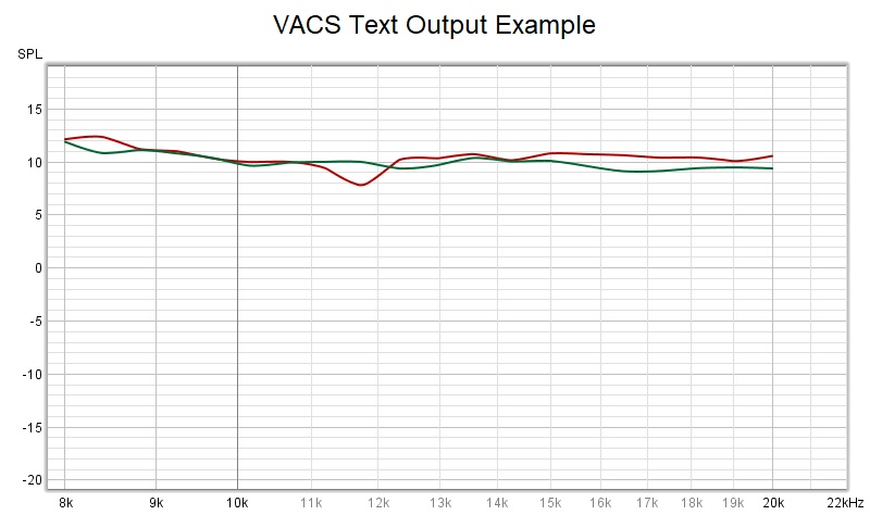

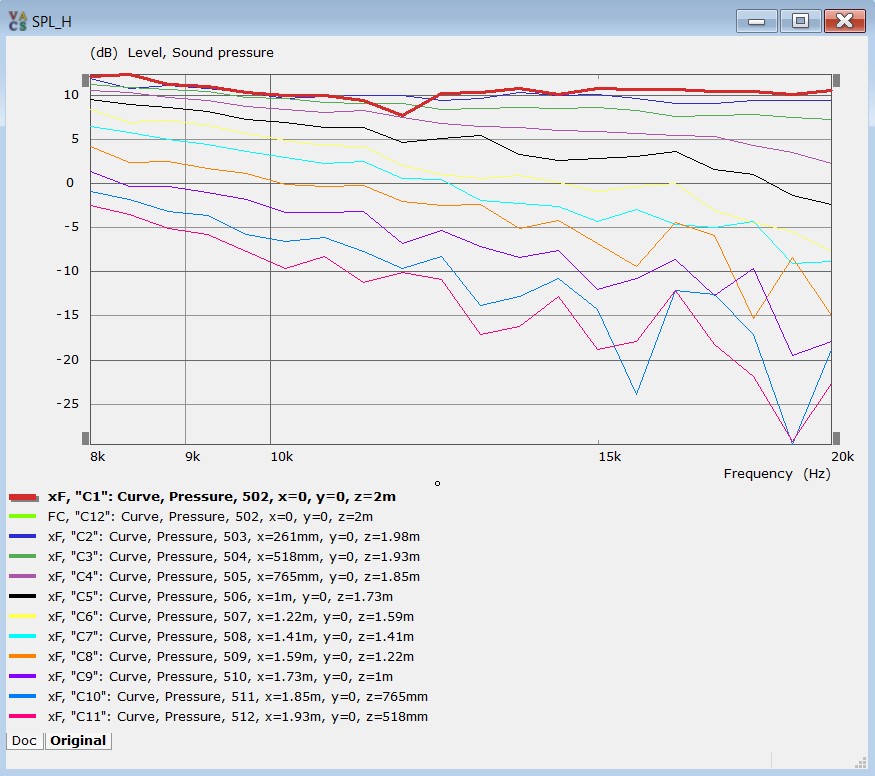

I have a non commercial licence for VACS the output viewer for ABEC/AKABAK and I can (somewhat laboriously) export the directivity curves from the horn simulations. Without some significant tinkering the simulation is based on an infinite baffle, but I think it could be useful.
As an example this is the VACS output (8k to 20K simulated)
attachment.php
And this is exported text files of the top two curves imported into REW.
attachment.php
This might be a good way to use the speed of Vituix with some of ABEC's power.
