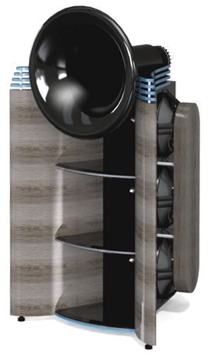

The Nighthawk will no doubt sound better than it looks🙂 I guess that is an example of what it takes to control directivity all the way down. We here realize however that a little padding on the walls eliminates the need for so much control The waveguide in the middle remains interesting. Mabat has made it much easier for us to study and implement them. I was getting ready to do some of that when I got distracted by these line array simulations.

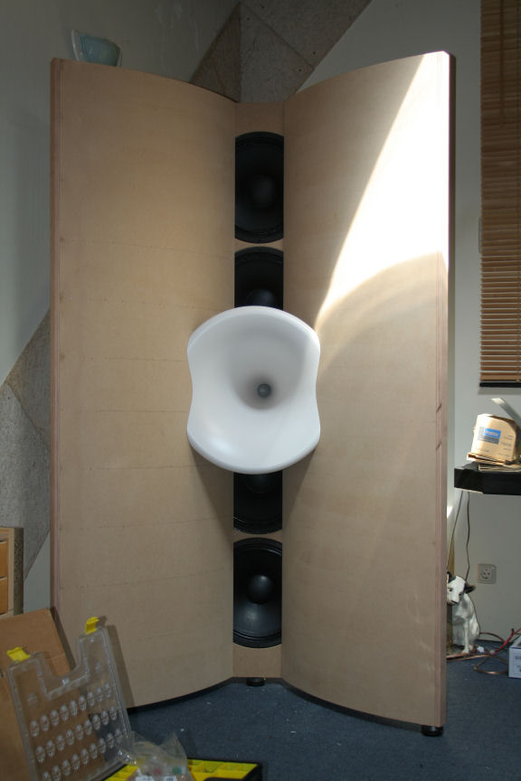

Ah.. the BD-Design waveguided array...
attachment.php
The concept still exist, but he cut the line in half:
attachment.php
BD-Design, only the best!
And it seems he's now using a full range driver for the waveguide 😉.

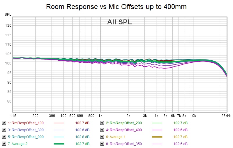

I went to take data vs vertical mic offset and found the window to be smaller than I thought I had seen yesterday. The cause was a growing dip at the 10 khz XO to the tweeter. I lowered that XO to 6 khz and got these data:
attachment.php
I still have a dip at the XO but its not severe. The equalization was done at array center and is down worst case 4.5 db at the bottom of the dip at 400 mm offset. Equalizing to the average of those heights should make the entire 800 mm window usable.

That's where I would prefer the wobble. As long as those are centered around the middle line they will keep it sounding balanced. I think you hear a sagging result over a wide area like this, sooner than a sight up/down variation that stays close to the center line. (as much above as it is below it)
What does this do moving half a meter closer or further away?
(still climbing that mountain because its there but its beginning to look like it might be worth the effort)

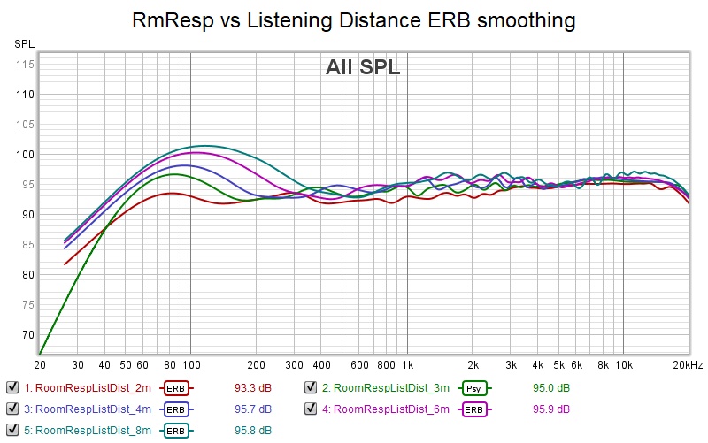

Here is the response vs listening distance. I first looked at this without floor and ceiling reflections enable, which is how it was equalized and how it has to be to get mic offset data, and I saw almost no variation with distance. Then I recalled that the floor and ceiling bass support does vary with distance so I enabled the reflections and got this data:
attachment.php
ERB smoothing was used to mask the comb lines that are caused by the longer delayed ceiling and floor reflections and which would otherwise obscure the data
The tendency is there. As you move further away, the delta path length reduces, so the destructive combining reduces so you should get more treble. As you move up or down, you move off the center of the vertical beam and thus get less treble.

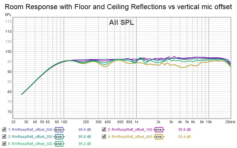

With the new release of Vituix, I can response vs mic height with floor and ceiling reflections:
attachment.php
The gold trace for 400 mm offset is over the threshold into un-usability. But the smaller offsets are impressively flat.

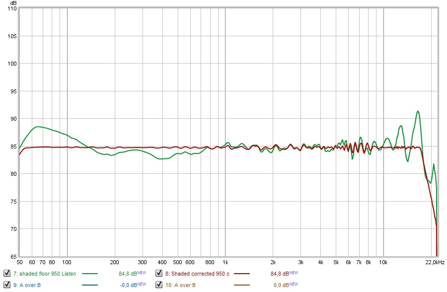

I redid my processing from the shelf-shaded array I did earlier, processing with floor image on. That's the one with the 10 unshaded drivers around the listening spot/height.
I also made a pure center correction, to see the differences between those two. As said earlier the vector average isn't a good representative for the top end of the array.
A quick comparison in SPL:

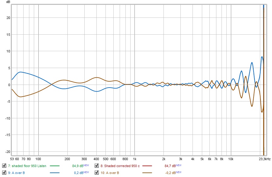

And if we extract them from each other, purely using the SPL levels we get this:
attachment.php
Subtracted either way to exaggerate the differences. As seen the top end is quite different between the center correction and the faulty average vector sum.

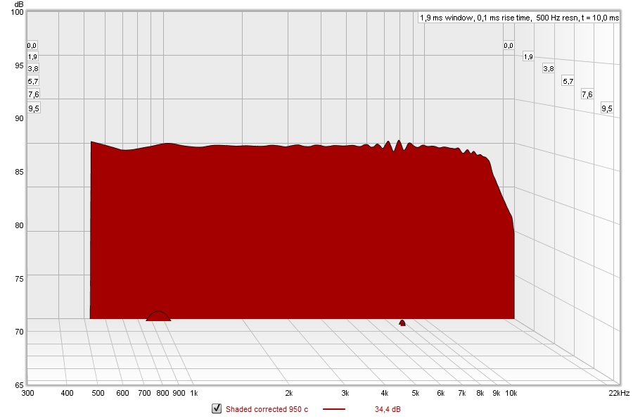

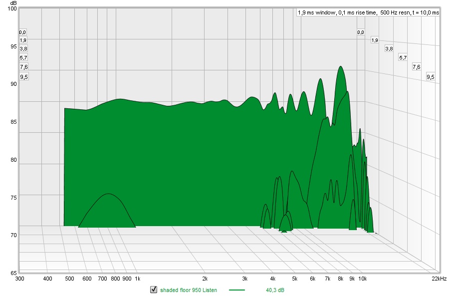

If we look at that the difference in waterfall results are clear too:
attachment.php
Average based processing...
attachment.php
Center listening position processing...
You might hear a difference between the two. It might be a bigger change than the SPL change between 700 Hz and 10 KHz predicts...

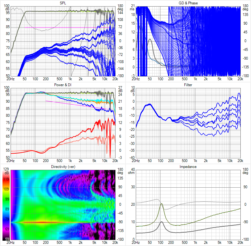

Next up will be to fine tune where and how much shelving is needed to be able to shape all positions of interest. The ambience speakers will help out to keep tonality in check below 3K, while also playing a role in imaging. The bottom end has never been a problem, certainly not with subbs added while using the arrays there too. (they are a lot of fun when combined)
It seems we can somewhat shape the bundle we need. Improving the top end while keeping the up-sides of using multiple drivers.
Right now moving down shows excellent tracking of the center line target, while moving up still is a somewhat bigger change (wobble 😉) between 2 and 5 KHz. No doubt the ceiling reflection would help somewhat. As did the floor. But I might need to fine tune the shelf shading.
