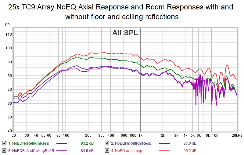

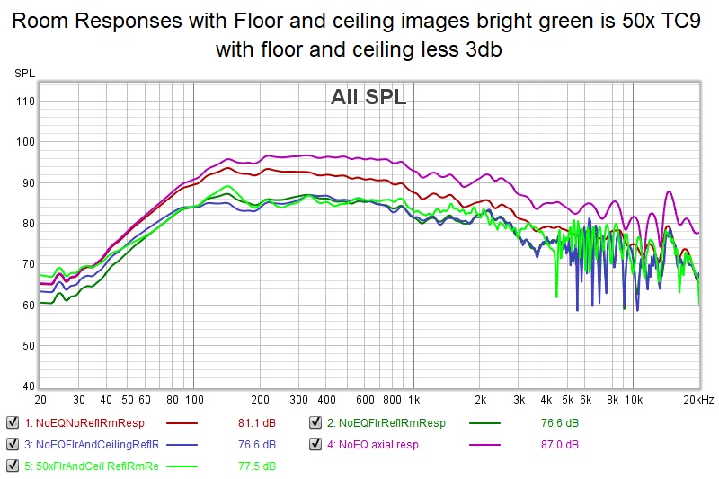

Taking a look at the responses with and without floor and ceiling reflections enabled.
attachment.php

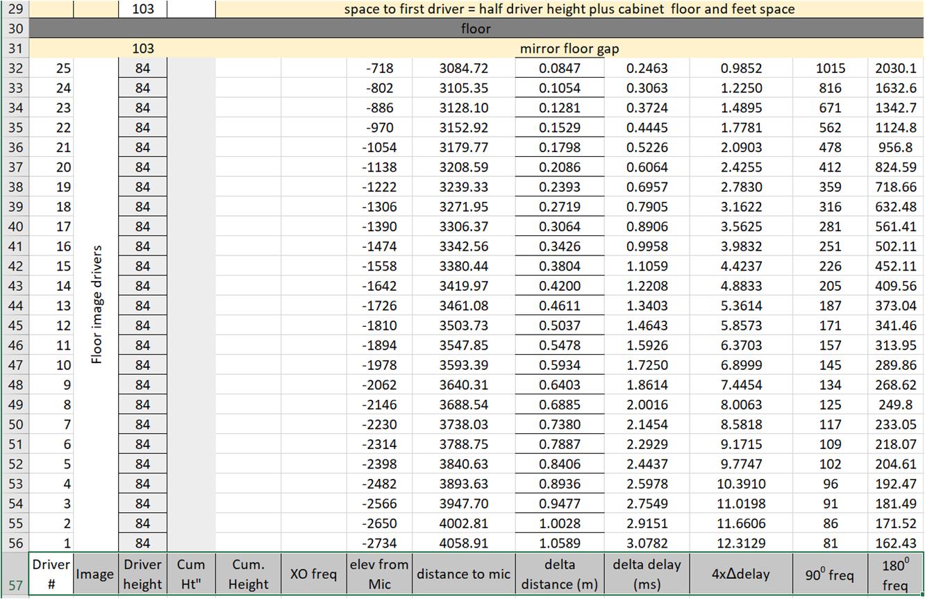

Did anyone ever wonder why the level of the room response curve drops when these reflections are enabled? I've been puzzling over this for a while and I finally realized its because the reflections are delayed long enough to combine subtractively. Fortunately I already have the delta path lengths for the floor image in a spreadsheet
attachment.php
below 500 hz all but the bottom 4 drivers combine subtractively below 500 Hz. By symmetry, if it were precisely symmetrical, then all but the top 4 drivers would combine subtractively in the ceiling reflection summation.
That is an interesting thing to understand. When I first saw this, I thought it might be a Vituix anomaly but its not, its real. You might never notice it though without simulation unless you compared indoor and outdoor measurements.
The other prominent effect is the increased combing amplitude and frequency above 5 khz. This is why I've been recommending a thin layer of floor and ceiling absorption.

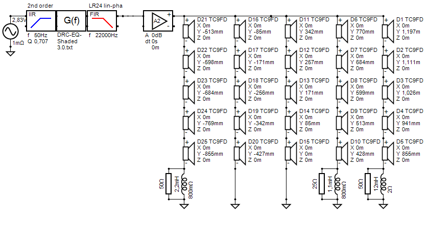

The schematic:
attachment.php
This is something I could go for. But hey, maybe we can whip up better results. All properties are a match to my room/my arrays. Except that I don't know how much floor and ceiling reduce their reflections. Treatment there is no option for me. That's why I went with these arrays in the first place 😀.

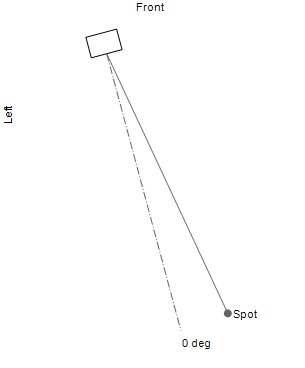

I'm glad you got me on this sim mission, nc535! With it, I can explain so much more of what I've encountered. It also holds the answer why I have the toe-in set like I did. It's pretty revealing of some of the things that I've wondered about. Great stuff! And I'm only on my 3rd day of simming 🙂.
I only guessed at my off angles so far, I'll measure what I really have and go from there. Fun to be able to see this in sims.
With a bit of practise I guess we can get pretty far to extract a good DSP recipe from it too.
My guesses were right, arrays turned in 15 degree. Measurement position is at a 10 degree angle.
One more line for yesterday's graph - 50 drivers with floor and ceiling reflections.
attachment.php
I wanted to see if the response reaches a limit as more drivers and reflections are added. Then I will know we are modelling enough drivers, or at least there is no point to adding more.
From this picture we are just about there - the 50 driver trace lowered 3 db aligns nicely with the 25 driver trace in the midbass and has the same character, so to speak, up higher.

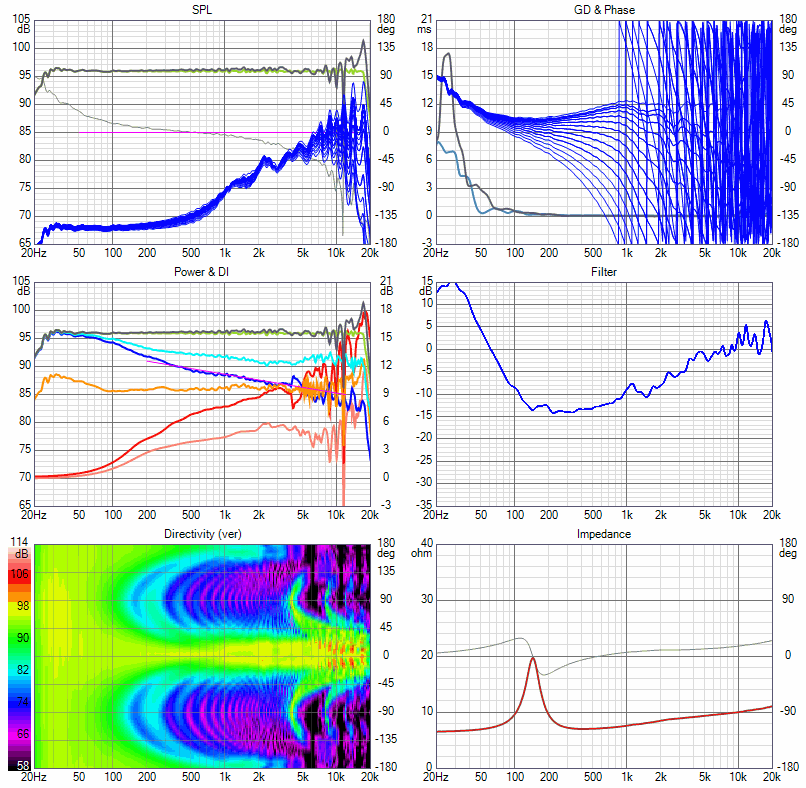

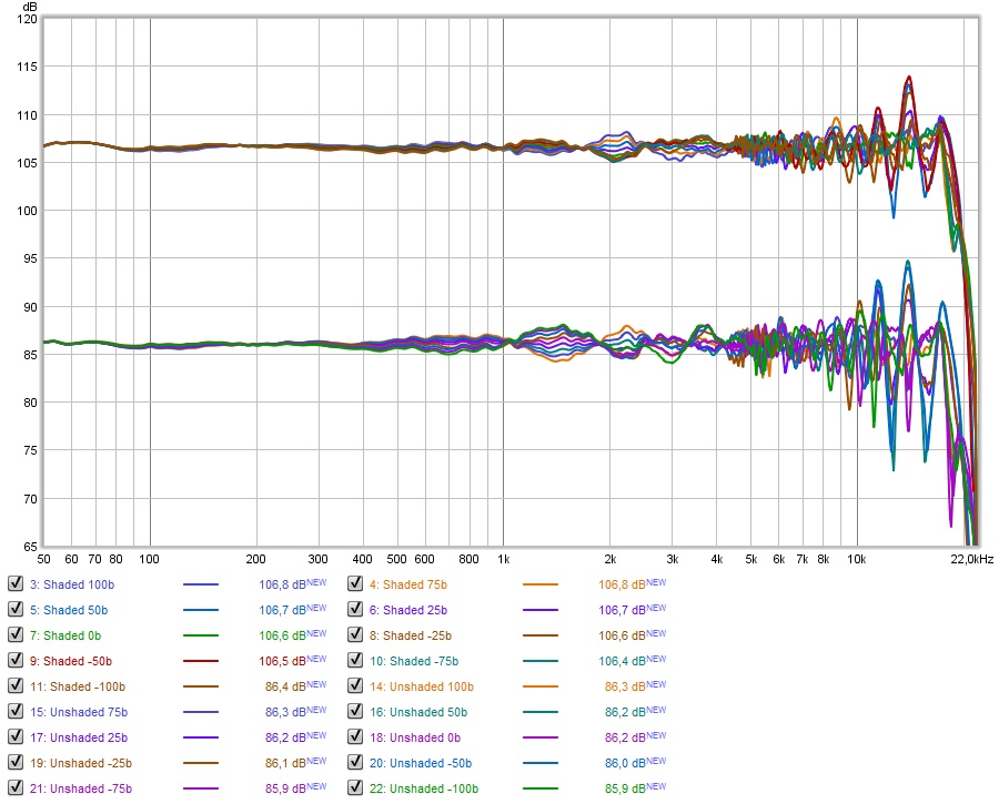

Here's a comparison at the listening spot for a frequency shelf-shaded array vs unshaded:
attachment.php
The upper results are the shelf-shaded array, bottom is the unshaded array.
These are the in-room results of positions between -100 to +100mm around the 1000 mm height measurement spot. I'd say it looks to be worth the trouble. The results of the 15 degree array toe-in and 10 degree off axis listening is much more in line with what I had expected.
The results are more even than the prior angle I used (on axis sims). Pretty much in line with my toe-in experience a long long time ago. The 10 degree off axis was my subjectively preferred listening angle, having the array cross behind the listening spot. (or in front but due to how strange that looked I did not dare let that pass judgement on the WAF front)
Edit: these simulations keep a reasonable tonal balance up to 1700 mm. That's the rule number one: it should work standing up.
A by-product of the shaded array is much better tonal performance standing up and at 4 m distance. So room sound could improve too.

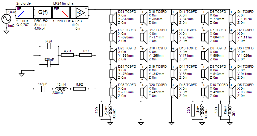

Belonging to the above graph, comparing shaded vs unshaded the 6-pack from Virtuixcad:
attachment.php
The in-room results were averaged and used for EQ correction in both plots.
So to recap:
I applied a pré-eq to get a somewhat flat result. Next I exported the Listen win SPL, which I altered in value to see a window of +/- 15 degree horizontal and +/- 5 degree vertical.
The listen-win IR was then corrected by DRC-FIR. The result of that was convolved with the pré-EQ to get a total correction.
This total correction was applied within Virtuixcad to the sim. Next I exported the in-room results looking at the height-differences from -100, -75, -50, -25, 0, 25, 50, 75 up to 100.
These results were averaged (non vector) and I let REW do auto EQ on that result, with a few quick tweaks. That EQ was applied to all measurements and the correction as seen in the upper six-pack(s).
Same procedure for both sims, Shaded and Unshaded.
Lots of work, but I need to find out if operating on the arrays is worth the trouble.
In the shaded version I've included my impedance correction schematic.
attachment.php
It is what I run, so I included it in the sim.
The above is with the earlier mentioned toe-in:
attachment.php
It looks like a performance upgrade worth the trouble. A nice reduction of peak values in the upper end, plus better performance overall.
I simmed way more than this to be honest, been at it like crazy. Trying to find improvement in the top end but I couldn't nail it entirely.
An almost 30% wobble reduction should do nicely though 😀.
