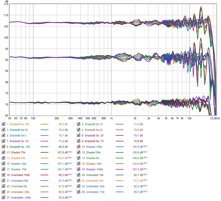

Here's the new schematic compared to my earlier shelf shaded example and an unshaded array:
attachment.php
Top one is the earlier shelf shaded example (shown before on this thread), middle one is the unshaded array and the bottom one is my new suggestion, the one with extra inductors to shade the top end.
It is easy to see, as these are raw in-room results, the differences. Based on this graph alone, I'd pick the bottom graph as a clear winner. It has less variation, similar processing on all graphs, including floor and ceiling reflections.
But let's examine it a bit closer. If I show the same graphs with psycho-acoustic shading we get a slightly different picture:

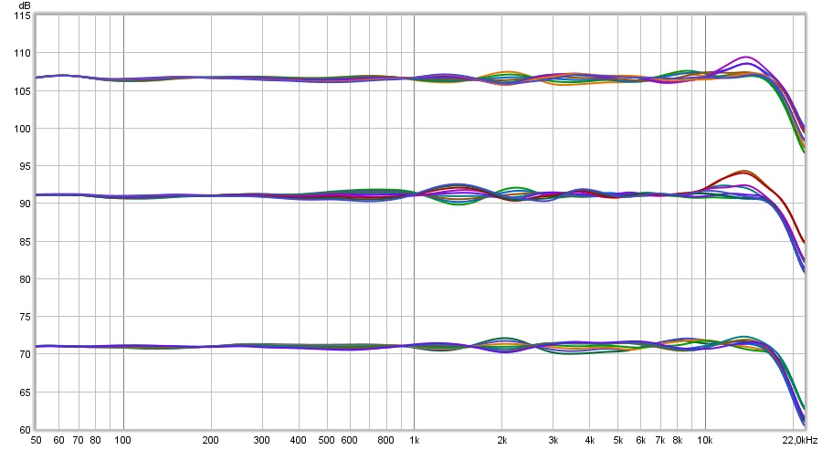

Here is what the unshaded array does:
attachment.php

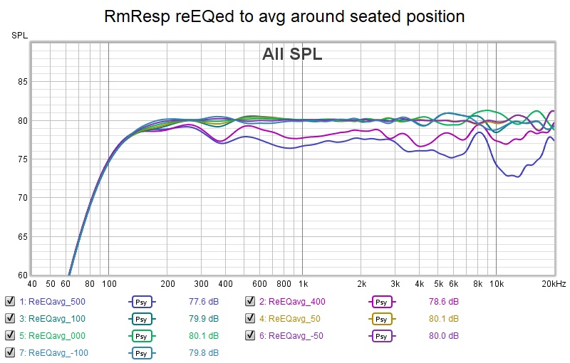

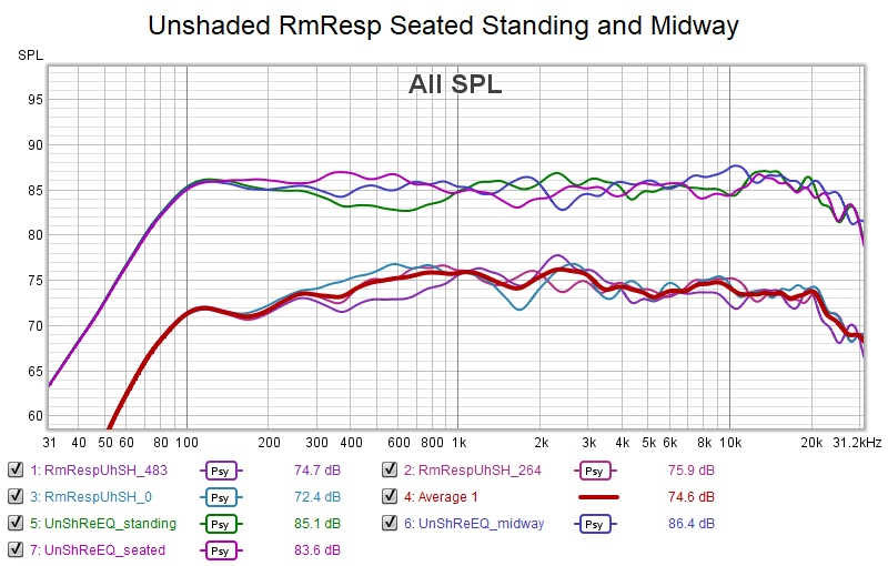

I'm using a two step equalization process. First I equalize to the listening window average independent of floor and ceiling reflections, then to the room responses averaged over the vertical window to get the top group of traces in the graph.
After a lot of tearing out what is left of my hair, I now have this from a mix of both shelf and frequency shading:
attachment.php
The top group of traces is the seated position and 2" and 4" above and below it. The lower two traces are at 400 and 500 mm. Standing is obviously too a relaxed standard but its still within +/-3 db at 400mm.

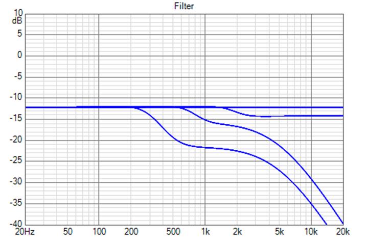

My current shading is best explained by filter graphs absent equalization:
attachment.php
I started with the Dave Smith shading coefficients, implemented shelves to preserve headroom on the low end, increased the top shelf attenuation from .9 to 2 db. then added low pass filters for the outer drivers to cut them off as soon as I could without increasing the response variation in the regions above cutoff.

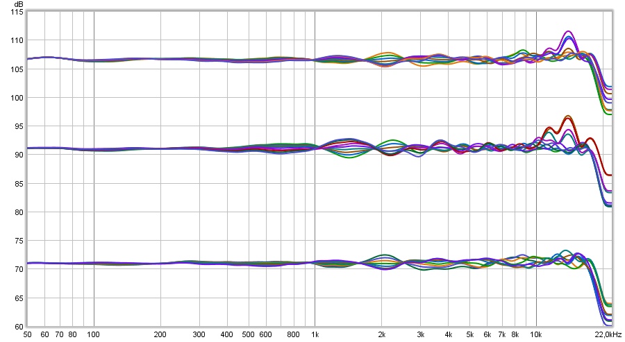

The results without smoothing:
attachment.php
I'd say a clear difference 🙂. I think even the raw results look pretty awesome with the exact same settings used to make all three graphs.

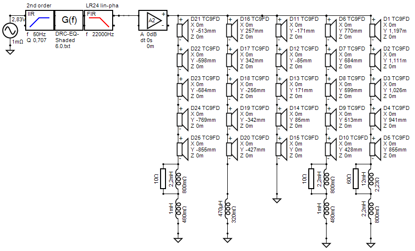

Normalised comparison between unshaded and shaded 6.0...
As the boost on the upper end for the group of 5 drivers is no higher than it was for the unshaded array, I'd say that this should be save to implement without worrying.
The shading schematic I used:
attachment.php
(look at the height numbers to see how I grouped the drivers)

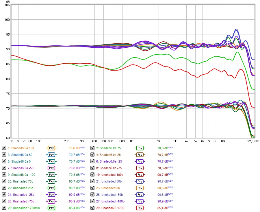

To make this set complete, I've included the 1.70 meter standing height of both the unshaded and shaded array:
attachment.php
The unshaded array (green) is a little bright standing up. I guess I'd have to trade that in for a little darker (red) if I go ahead with shading...
I'm pretty sure I could live with that...

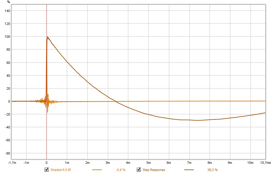

As long as I'm feeling a little victorious about this improvement, here's the predicted IR & Step (from Vituixcad)*
attachment.php

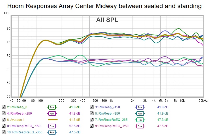

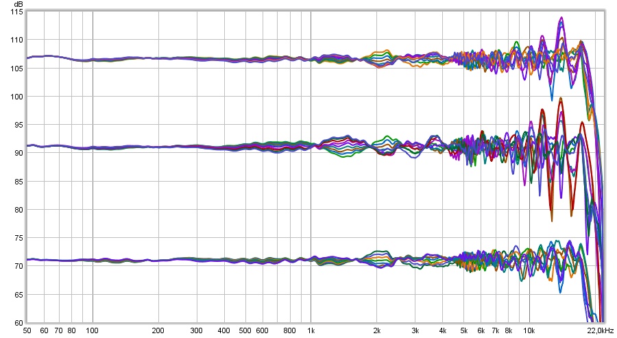

I finally realized that my best chance of getting good responses both seated and standing was to mount the array on the wall with the center of the array midway between the seated and standing ear heights. This is feasible with my construction using french cleats.
attachment.php
As before I first equalized to 15V listening window average and the re-EQed the room response to the average around the seated position. This left the standing ear height still an outlier but not so far out. The ear height group is good but not quite as good as with center of array very close to ear height.

Incidentally, using an expanded arrangement means you can sit closer to the array without seeing much combing, something you could not do with a full array of TC9s. In my measurements, the minimum distance was above 1.5x the array length when using TC9s full out. This might be important because by sitting closer you will be more in the direct field and have reflections arrive later. This will definitely be a plus for clarity and imaging.
That is indeed true. I've been using 3m listening distance in my sims which is about 1.5x the height.
The last time I looked at expanding concept, I took it too far and ended up with a single tweeter at the center flanked by two midranges that also needed to be robust - not really an array anymore.
But the EQ I'm using in simulation of my 32xSB65 array effectively expands from a central section of 8 unshaded drivers using both frequency and shelf shading:
attachment.php
For the graphs shown, the array was EQed for flat room response at 3m then the listening distance was reduced to 2m. There is some combing in the 6-10 Khz range due to relatively long delayed floor and ceiling reflections (just like at 3m) but the shading takes care of combing from the direct wave. You would want to reEQ if 2m was your primary listening distance but the sim shows combing wouldn't be a problem there.
And this is a seated optimization. If I wanted a taller vertical listening window, I would not have the 12 khz LPF on the driver group flanking the central 8 drivers.

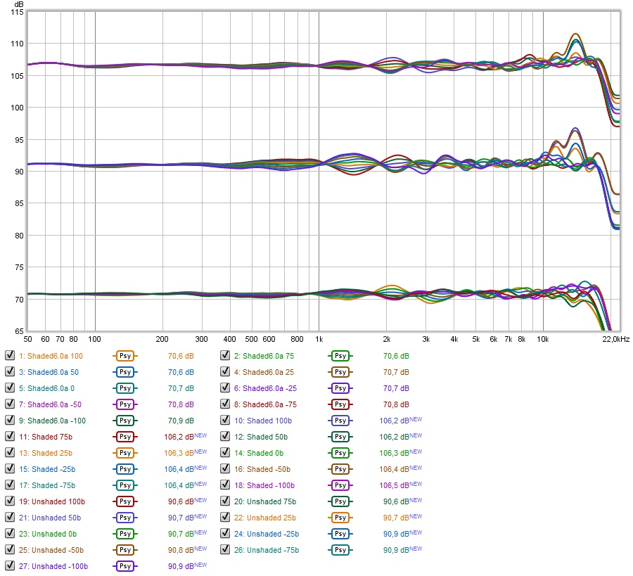

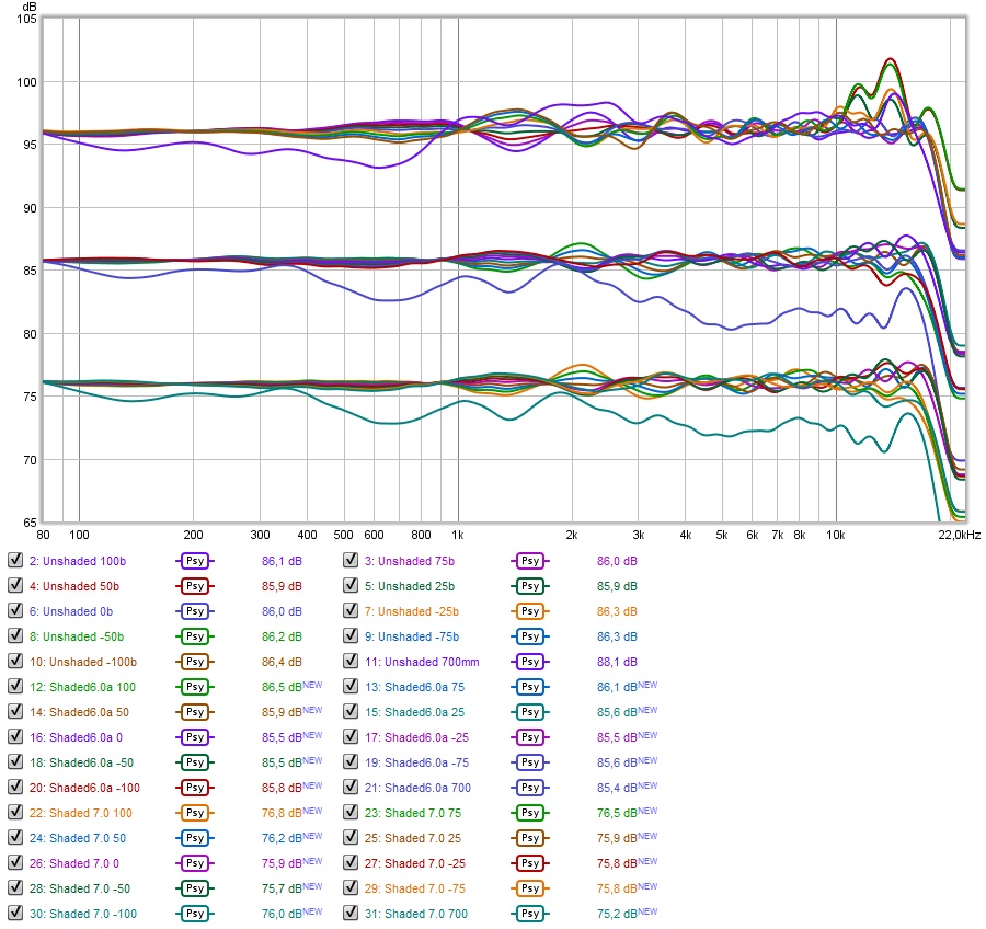

I was looking for an upgrade of standing performance, hoping I'd get it without any big compromises. I think I've managed to achieve it:
attachment.php
Top - Unshaded (as seen before)
Middle - Shaded 6.0 (seen previously shelf shade + top end compensation)
Bottom - Shaded 7.0 (new with the task of better standing, 1.7 meter, performance)

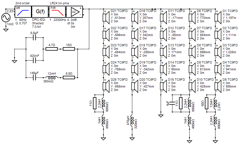

I've tried many things, in the end it was quite simple. I just had to learn about passive compensation filters like notches etc. Here's the schematic:
attachment.php
All it took was an extra cap and a slight change in component values. I may yet find ways towards further improvements. But most of it is within plus/minus 1 dB from 900 cm to 1100 cm.
The difference in the 5 KHz dip is almost 1.5 dB in favor of this last schematic. Not bad for a passively filtered frequency dependent solution I'd say.

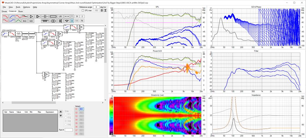

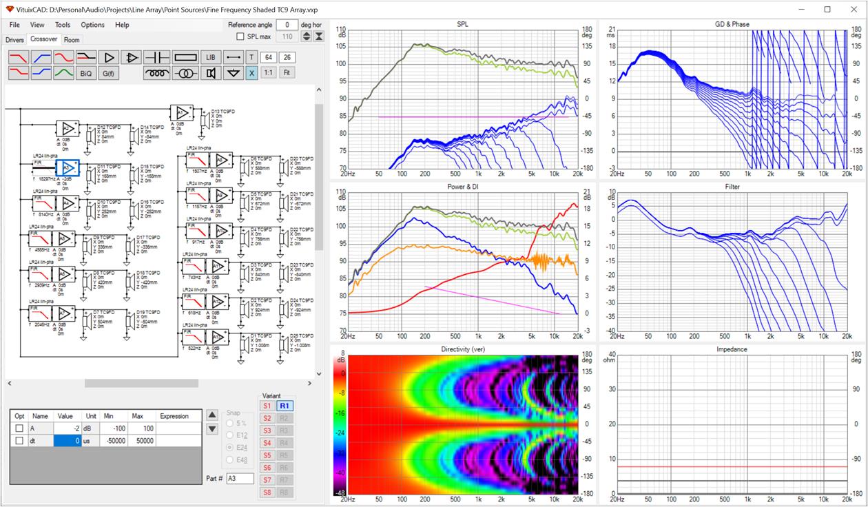

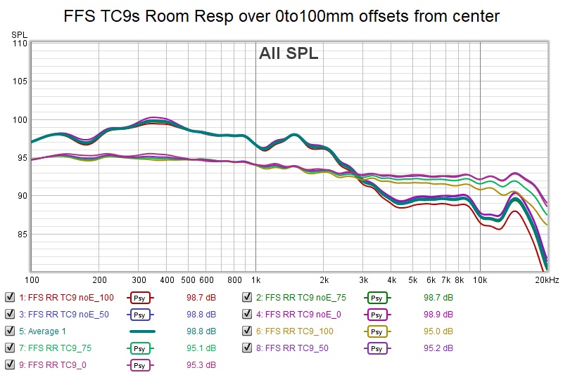

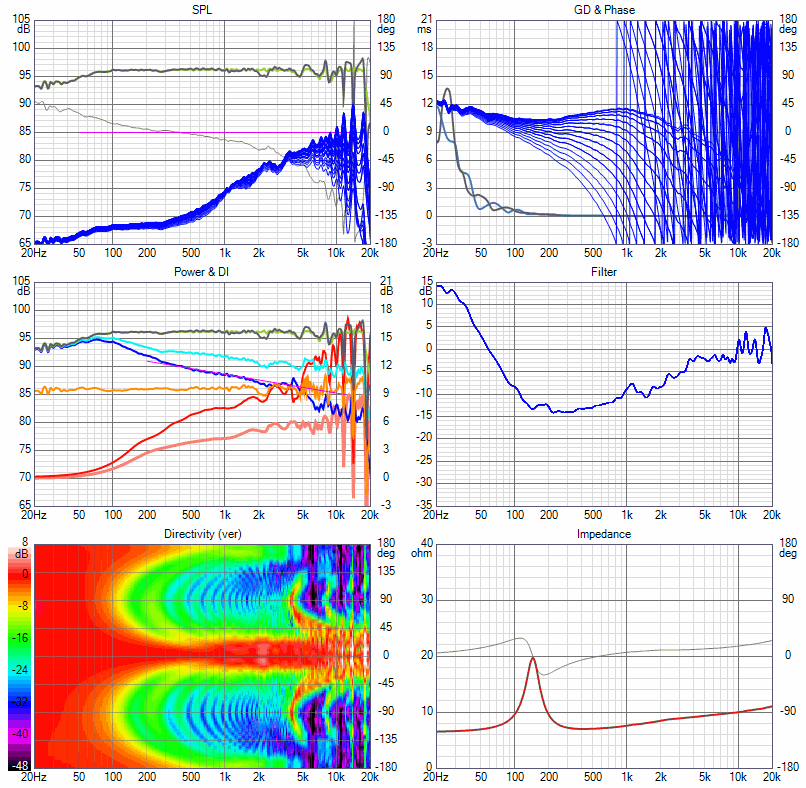

I took another look at the fine frequency shaded array today.
attachment.php

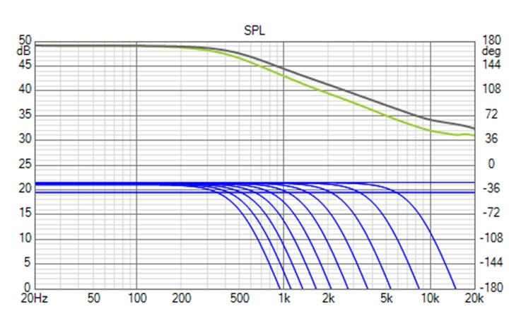

I started out with a DSP/amp channel for the center driver and each successive flanking pair. I got a great response but then effectively combined the two groups flanking center. The response remained great:
attachment.php
The filter cutoff frequencies were chosen to cut each driver pair off before their delta path length phase shift exceeded 90 degrees. This eliminates all subtractive combining and thus makes for a ripple free frequency response in free space. There is not even a hint of combing. Unfortunately, when floor and ceiling reflections are included we do get combing above 6 khz because of the longer delta path lengths for these reflections but as shown earlier a thin layer of absorption on floor (carpet) and ceiling will reduce/eliminate them.
But how tall is the vertical window? Well, there are 5 drivers each getting full range response although the outermost pair of the 5 are down 2 db to reduce the rising response I found in the treble as the mic was raised off axis. 5 times 3.5" is 17.5" so it will be something less than that.
Here is the room response before EQ and after EQ to the avg over 0 to 100 mm offsets.
attachment.php
Yes its +/- 1db below 10 khz and within +/-2db above 10 khz over an 8" vertical window!!! Its hard to imagine doing better for a seated only listening window. Too bad actually implementing this would be somewhat extravagant.

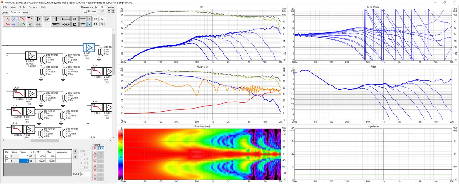

well a Motu 24AO has 24 channels of 32 bit DAC for (only) $995
If this were the bad old days when I was young and foolish and had prototyping infrastructure and lab at hand, I would whip up a small LM3886 board with a couple of op amps and have 24 of them built. How hard can it be ? (famous last words)
Chances the number of channels can be cut down without giving much up.
got it down to 9 amps by combining adjacent pairs at the low end. I almost didn't need to re-EQ. Could probably combine one or two more pairs without damage.
3 amps will go down to 1 amp at the high end with just little trouble
so 8 amps for sure; possibly as few as 6
Soon I will need to try the same thing for the 32x SB65 array...

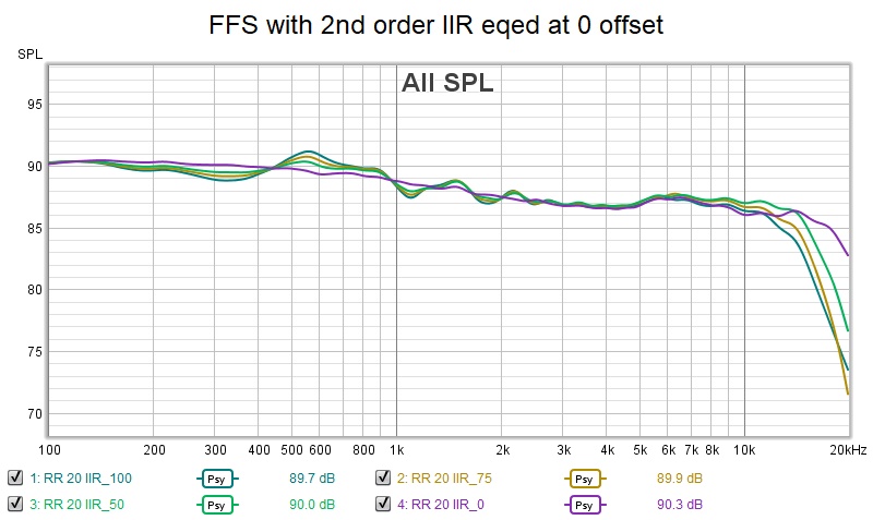

and I can get a fairly good response with 2nd order IIR. any higher order and the phase rotation kills it.
attachment.php
It suffers a little in the mid bass and there is a loss of treble going off the vertical axis. This is without much tweaking so its encouraging.
