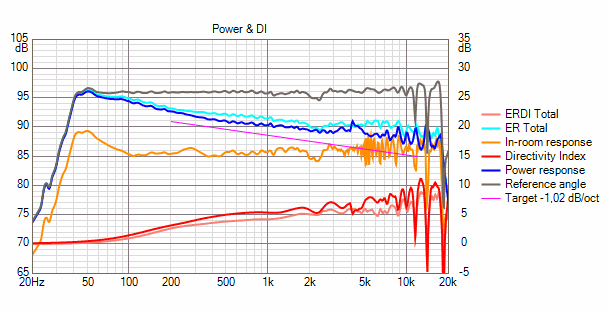

Question to you and NC: what is filter function file doing? Is it adding a floor reflection, a ceiling reflection, or both? Should I remove the ceiling and floor reflection from the room section when using the filter file?

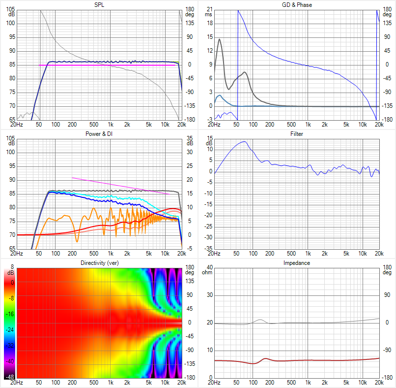

If by filter function you mean the one loaded into the G(f) block, it performs equalization. My current method of creating those files is by exporting in-room response(driver offsets) over the target range of listening heights. (Note that a negative vertical driver offset is equivalent to moving the mic up.) I average those exported responses in REW with the averaging obviating the need for smoothing, then bring the average into Vituix calculator tool for mirroring, which is equivalent to impulse response inversion. While exporting the room responses you would ordinarily have boxes for floor and ceiling responses checked. Prior to that, enter the floor and ceiling distances from the center of the array....
My way of doing things is slightly different. I have made a global pré-EQ with REW to get things in the ball park (relative flat response).
Next I export the "Listen win SPL" from Vituix and run that one through DRC-FIR (I use REW to normalise it first).
After creating the FIR correction with DRC I convolve the outcome with the pré-EQ. Adjust SPL in REW and export it as a filter for Vituix. That's what's shown in the Vituix graphs I presented. A neat flat listening window will be the result.

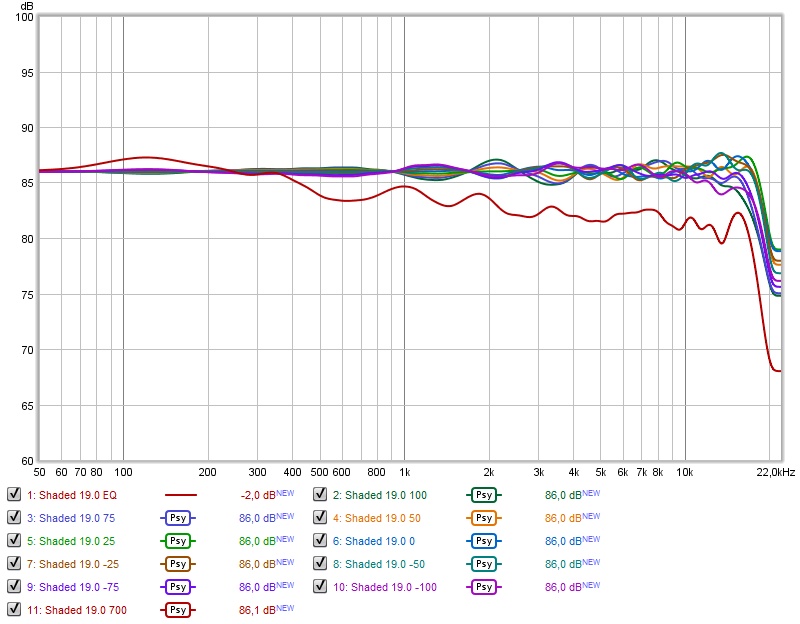

Next I change the Room settings and export the "In room response" for each height of interest. Indeed a negative number on driver offset is representing a higher microphone position. See the graphs that show Floor, Ceiling and speaker position.
For each height you've got to adjust the floor and ceiling heights too. It's a bit of work but you get used to it.
After importing all of the in room heights within REW I make an average and
use the inverse of that to make a second correction which is convolved with all height graphs. That's the one I show in the REW graphs.
attachment.php
I use 100, 75, 50, 25, 0, -25, -50, -75 and -100 as actual differences from my 1 meter listening height. Meaning 100 is 100 above 1 meter is 1100 mm or 1,1 meter. To get to 1.1 meter I had to offset the drivers with -100 (the Y value) in VituixCad. And also adjust the floor and ceiling height to represent that total height change.
My results are with floor and ceiling reflections set to on, but absorption set to 12 dB (only looking for general trends). I see that the latest Vituix has different absorption levels for all wall, floor and ceiling reflections.
I have made mine when there was still one number for all planes. This will bring even more usable data as one can set the absorption per plane.
Here's a comparison between unshaded and (frequency) shaded with both floor and ceiling reflections set to "on" at -6 dB level:

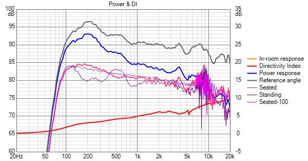

Awesome results, Ronald! I can't approach them standing but my seated optimization has less variation, as one might expect. I'm still searching for a good seated and standing scheme.
I just realized that the large rise towards the bass that I see in my standing sims is due almost entirely to the wall, floor and ceiling reflections. Its not boundary interference but more bass boost seeming to be a function of height. More likely, its loss of higher frequencies due to shading. If I sim and equalize without these enabled, I get very acceptable standing results. With them enabled, response is highly dependent on position relative to the walls and the amount of absorption, which isn't modeled well by a fixed value. There is a lot to look at because of that.
I've just started using the Vituix "copy selected as overlay" feature accessed by right clicking in the room response graph. Do a sim e.g. at zero driver offset then place cursor over the orange trace as select copy selected as overlay. Do a sim at another offset and the prior results remain for comparison without bringing them into ReW. You can do multiple overlays and click the "traces" button to get a pop up where you can rename them and/or delete them.
attachment.php
This sim was done with just floor and ceiling reflections. Its standing result is much better than my fine frequency shaded seated optimized approach.

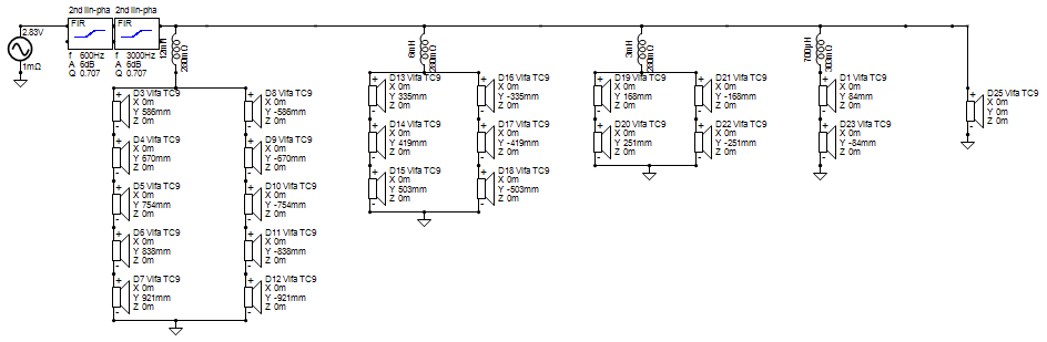

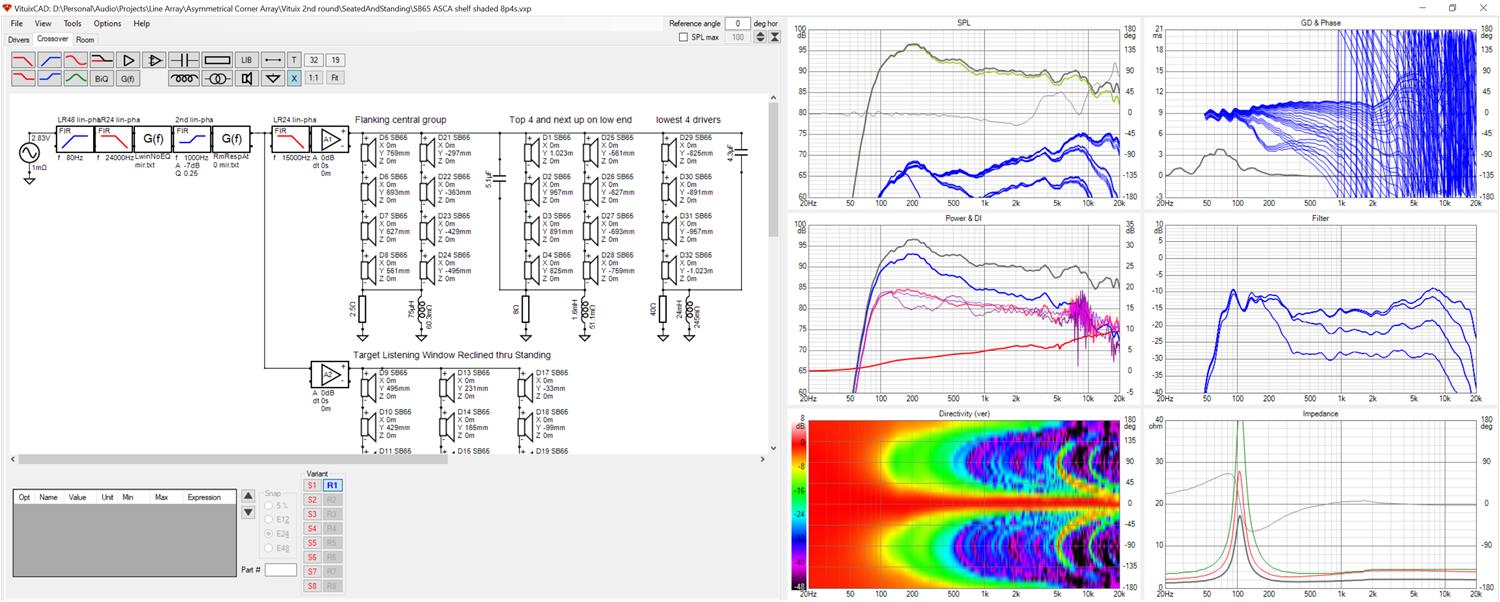

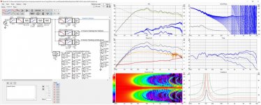

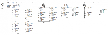

Here is a screen shot of the shading mechanism. I've bi-amped between 12 central drivers and 3 shelf shaded groups off a 2nd amplifier, otherwise a single amp would see ~2 ohm load. Two of the shelves have the drivers bypassed with caps to provide a low pass frequency shading effect.
attachment.php
This approach shows some potential and if I can get it to work well enough, it minimizes the rewiring I would need to do. At first blush, the inductor values look too high to be practical (PE doesn't stock them) but I can do the shelves in DSP just as well without buying more electronics.

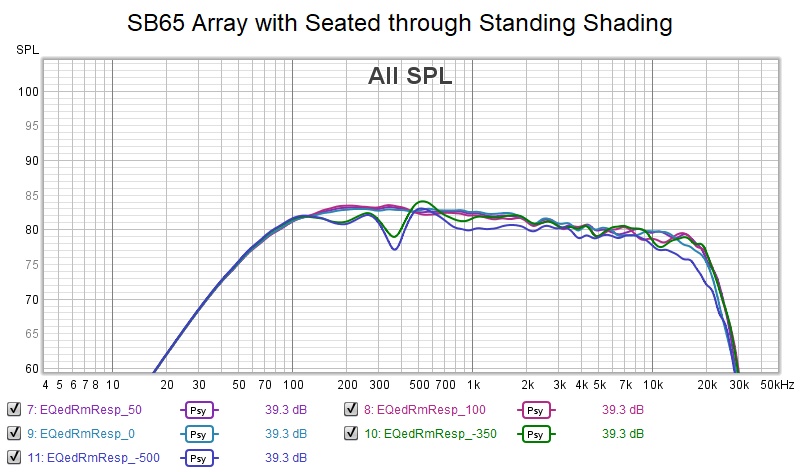

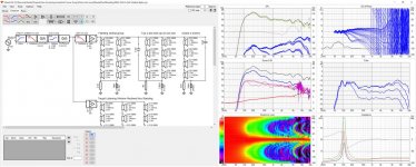

I did an active version of the previous passive shelf and frequency shaded array. I added 1" to the base thickness to raise the array and remeasured my and my wife's standing ear heights. This lowered the standing ear height offset by 50 mm and the difference is noticeable. But the improvement at standing heights is due more to adding shelf shading to the original frequency only shading than to this 10% reduction in standing offset.
attachment.php
I modeled the array tight in the corner with 12 db absorption on the near walls. The dips in the midbass at standing offset are a testament either to the inadequacy of those absorbers or the modelling but this standing response is miles better than what my seating optimization provided. The seated position looks just as good as the fine frequency shaded result but only after smoothing. Unsmoothed, it is rougher and I wonder if that matters.

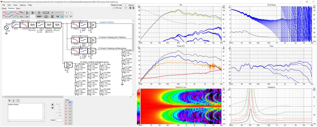

Here is the Vituix screenshot:
attachment.php
  • Vituix Screenshot Seated and Standing Active Shelf and Frequency Shading.jpg

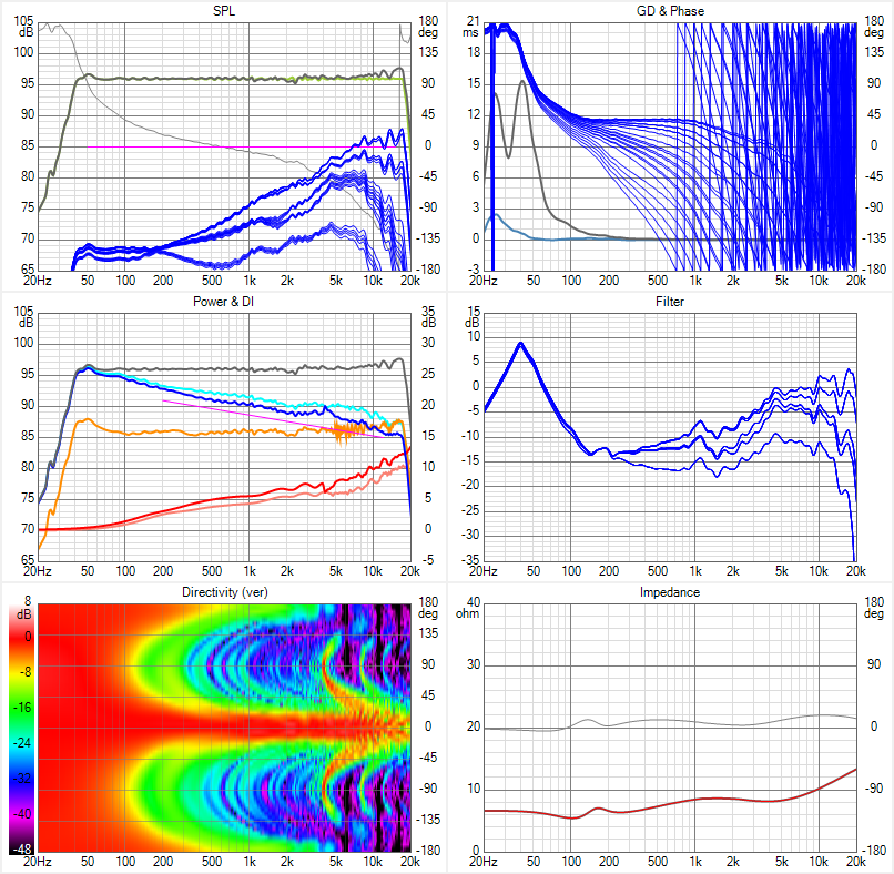

I am finding it instructive to model using ideal driver behavior rather than the measured response (provided kindly by nc35... thank you!). There are two schemes I am trying:
1. Sets of six drivers (I have 24 in total, not 25 like you two) plus one central tweeter. Currently simulating with just a TC9.
2. Expanding set with central tweeter, 12, 6, 4, 2, 1. This one shows promise. I am getting much smoother directivity change with this approach. See attached layout. Still very preliminary.

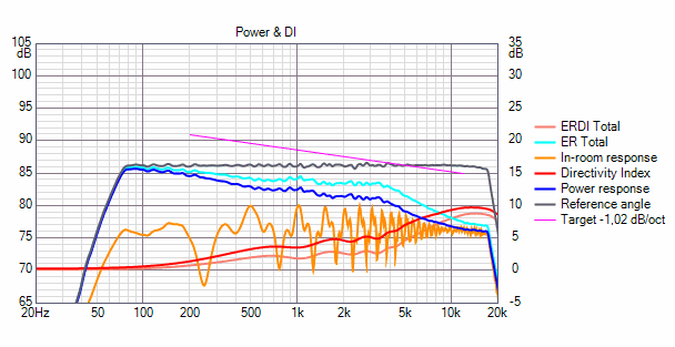

One question is about the floor and ceiling reflections. Turning them on does absolutely nothing to the results. What am I missing?

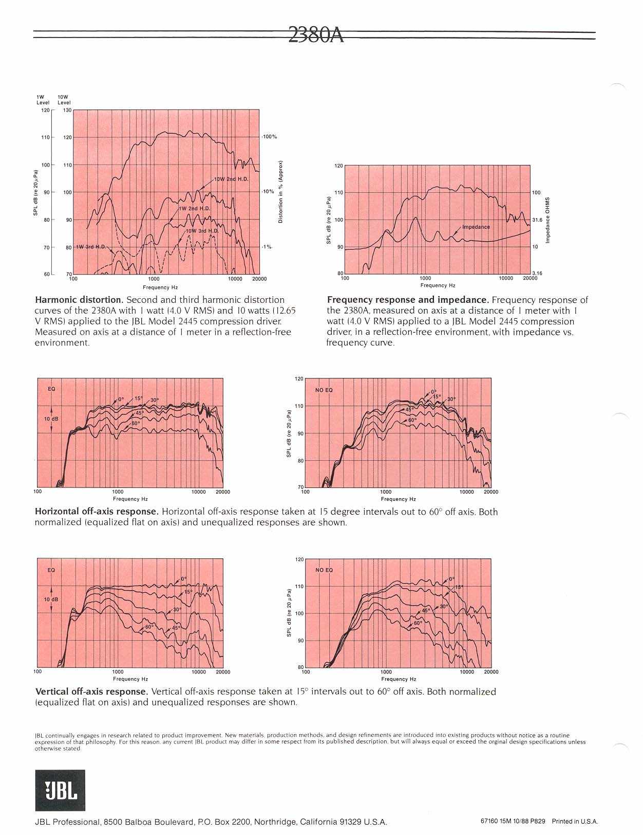

On a slightly different note, I wanted to share some observations from my other speaker, JBL 2226 + JBL 2445 on the JBL 2380 horn. This produces absolutely stunning imaging when coupled with the Mid-side EQ and a 45 deg phase differential from 1 kHz - 8 kHz. The imaging is other worldly. There is so much emotional impact.
So, this got me thinking about what am I doing with the arrays. For sure, the arrays produce fewer reflections from the vertical plane. I was convinced that this would lead to better sound. But the JBL system does nothing to avert floor or ceiling reflections. It is true that the horn helps with early vertical reflections, but the woofer is omni up to 500 Hz. Moving the JBL system out into the room, 5 feet away from the side and back walls produces this really nice "wet" sound with a lot of late arriving energy that is really pleasing. This is what is missing the most with the arrays I feel. Wesayso too probably felt this and added the ambiance speakers.
So, I've been pondering about this for a while, but have no conclusions yet. I think my next build will be a compact monitor with a waveguide-loaded tweeter, something like the Heissman Acoustics designs. I want to plop them in the middle of the room and see what happens. The thinking is to reduce the source size as much as possible while keeping smooth directivity.
Haven't given up on the arrays yet though. Just have to find a large slot of time to work on them. Rewiring them is going to be a pain. I am thinking of using one of the Wavecor tweeters to make a smooth transition for the two TC9s.
P.S.: I had bought the BMS 4590 thinking it would be an improvement over the 2445s I've owned for a long time. But NO! The BMS drivers, while more refined do not produce the imaging or the emotional impact of the 2445s on the 2380 horn. So, the JBL engineers certainly knew what they were doing and there is something to be said about matching the horn to a particular driver. I checked and measured the crossover a dozen times, that wasn't it.
I had a huge reply all typed up, I looked at the horn/CD combo and provided the data sheets, but the jest of it is that I am glad to hear/read a noticeable improvement of the mid/side EQ with phase tricks... ...on something other than line arrays 🙂.
I would love to see the values used of both the EQ and phase tricks.
I liked the graphs of the horn, as it does stay quite constant at 0-15 degree
attachment.php
Source: Index of /images/jbl/specs/pro-comp/2380
Floor and ceiling reflections only affect the in-room response, the orange trace in the left middle graph. If you don't see an orange trace, you can enable it by right clicking in that graph and checking "show in-room response".
