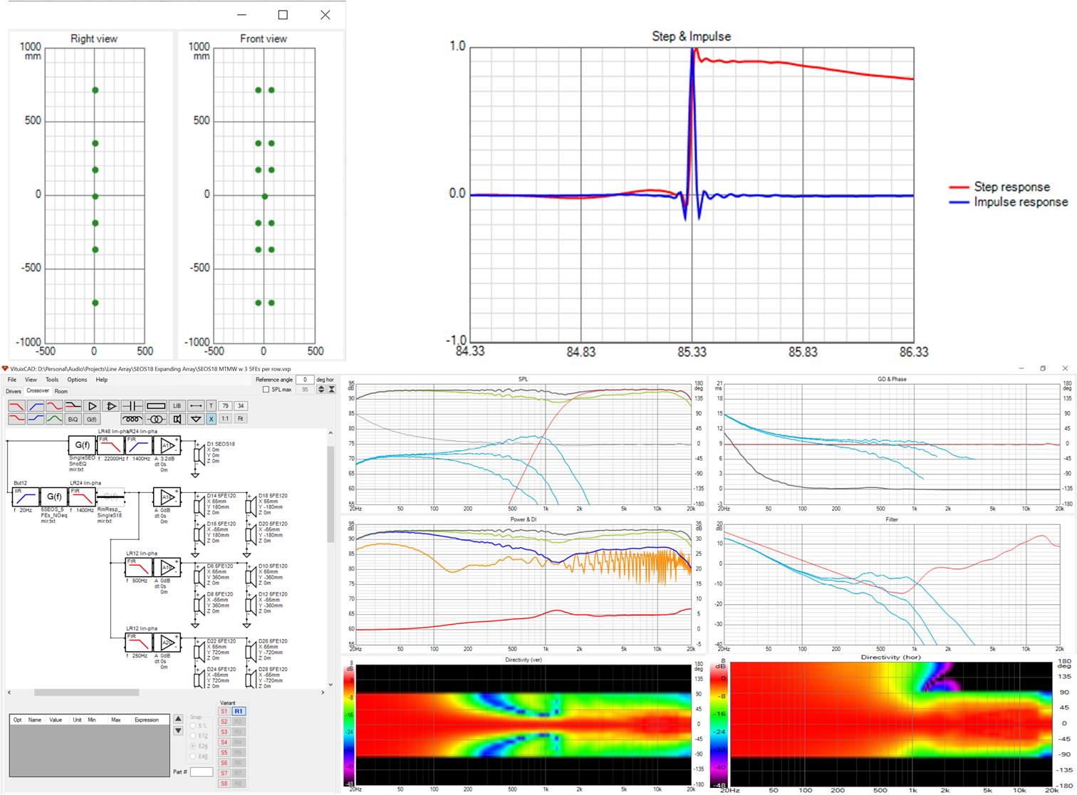

I don't quite have results to share yet. Time is at a premium, but should have more time next week.
I am finding it instructive to model using ideal driver behavior rather than the measured response (provided kindly by nc35... thank you!). There are two schemes I am trying:

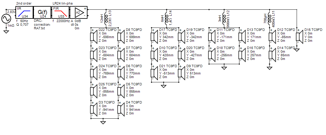

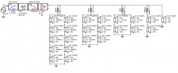

1. Sets of six drivers (I have 24 in total, not 25 like you two) plus one central tweeter. Currently simulating with just a TC9.

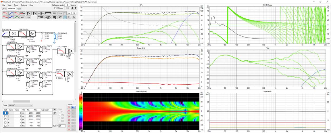

2. Expanding set with central tweeter, 12, 6, 4, 2, 1. This one shows promise. I am getting much smoother directivity change with this approach. See attached layout. Still very preliminary.
I definitely think a dedicated tweeter is the way to go having heard the improvement with the Fountek Neo CD 3.5H.

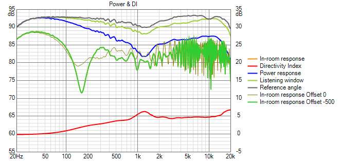

One question is about the floor and ceiling reflections. Turning them on does absolutely nothing to the results. What am I missing?

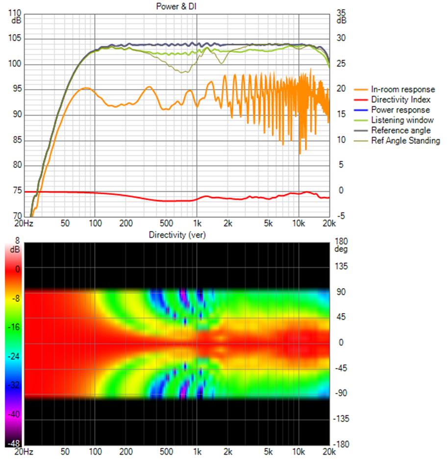

I was curious enough to try:

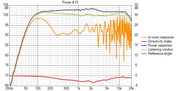

A quick try though with my own driver positions more or less...
The wavy orange in-room prediction shows it does suffer from some from floor and ceiling reflection (set at -6 dB for both here)...
The worry I would have is that the single tweeter is asked to do a lot!
I made the level the same as on my own sims. We see a 10 dB boost on the top end of the single tweeter, where my own sims show way less and the load is shared by 5 drivers.
My sim with similar -6 dB reflection levels...
That's what I meant with a "rugged tweeter" would be needed.
Your DI curve looks excellent though! But to get there would require something better than a TC9 as tweeter.

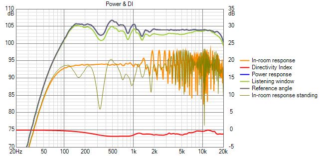

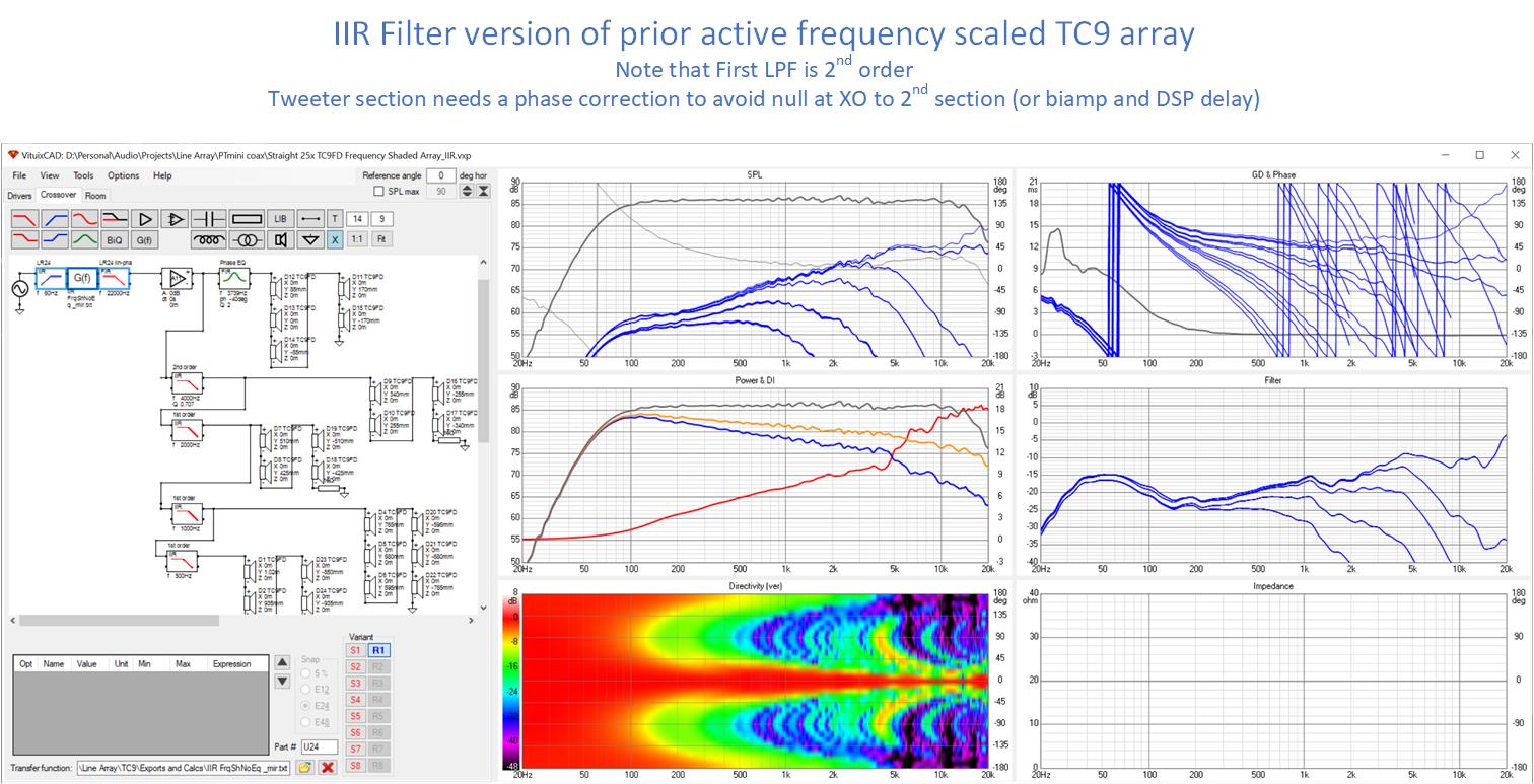

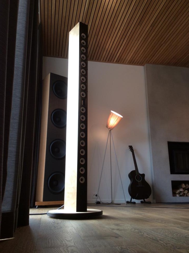

went back in my archives and found this screenshot of my tc9 expanding array with SB26 in OSWG waveguide at center. I guess I went further with this than I recalled. I got the tweeter directivity by tracing a graph linked or posted in Augerpro's open source waveguide thread. Its a fudge as the waveguide was elliptical so I'm using horizontal directivity for vertical and very likely the CTC doesn't correspond to what is possible.
I cut the tweeter in at 10 khz, could well have gone lower, don't remember why I didn't. This was very early in my simulation marathon and I diverted onto a different path. I think the reason I quit this was I didn't have realistic waveguide directivity.

It looks like the speaker load Z goes down to 2 ohms at 20 hz. not necessarily a problem, just saying
My only concern about passive filters is that their group delay adds to the delta path delay. I wonder if that is why my actively frequency shaded array has a narrower vertical pattern, which isn't necessarily a good thing if your usage model is both seated and standing listening.
I've spend a lot of time to get it narrow enough, but still keep the standing position.
There's only so much we can do, especially with passive components.
Even though the graphs on the proposal from ra7 look better in terms of DI index, the floor/ceiling influence is bigger than on my shelf shaded proposal.
My preference goes to the shelf shading in this case, as it has the most chance of working with the room. At least in my room 🙂. Plus I like the shared load better than one driver working real hard to keep up. The compromise mostly is top end performance above 10 KHz. But compared to the unshaded there should be a noticeable improvement, at least on paper. The factor that got me willing to try it is that there is a chance of improvement all across the board down to 200 Hz.

In fact, I would say the passive's delay does have an effect. Note the comment on this picture:
I can't find the sim this came from or I could say more about it. I did find a couple sims where I crossed to the tweeter at 6 khz and one where I simulated a brickwall filter. This latter was clearly not the way to go. Blending tweeter and waveguide makes a smoother transition to the tweeter's wider pattern and narrows the composite pattern.

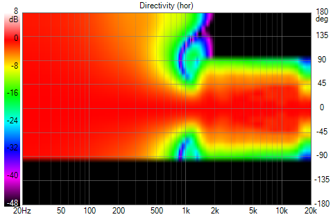

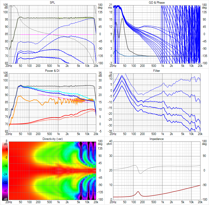

This discussion inspired me. I was able to trace posted directivity for SEOS18 (and I do have a pair in storage so this isn't entirely theoretical for me) and did a simulation with them. The S18 is 166mm tall so for quick sim, I replaced the 3 center drivers of the 25x TC9 array with the SEOS18 and went to work.
It didn't take much frequency shading to get a decent result. Crossover is at 2500 Hz because WG starts to widen vertically at 2 khz. Used low slope XO thinking overlap would help.
I equalized the axial response and then looked at the room response separately for wall and then for floor&ceiling reflections. Like any other speaker, one has to treat the first reflection points. This 90H WG in a corner keeps sound off the walls so above XO, wall combing disappears but its 40V directivity allows floor and ceiling bounce at 3m distance, much less at 2m given the geometry. So just like with the homogeneous array, there is benefit to floor and ceiling absorption in the treble.

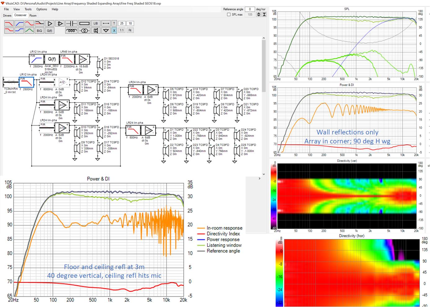

One of the biggest concerns is keeping wg balanced with array over distance. This next plot shows the FR at double the distance, 6m. The axial response doesn't change much but the floor and ceiling support for the bass does, just like in the homogeneous array.

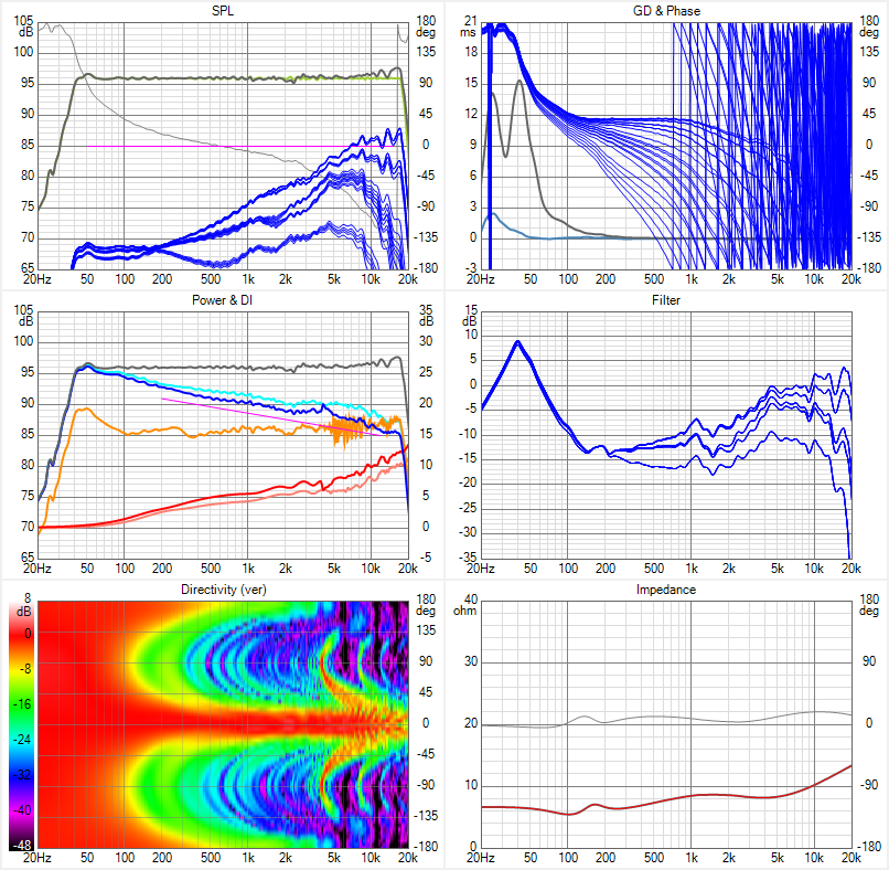

If you displace the mic vertically more than 200mm or so, the response falls apart at the XO because of the vertical directivity mismatch. No doubt a passive shelf shading approach like Wesayso uses that widens the array vertical directivity would help.
Well the SEOS18 is rather large for something like this but I am encouraged nevertheless. I also have a pair of SEOS12s and the SEOS family goes down to SEOS6. DIYSG has stock on SEOS8 dome tweeter waveguides for $17.
I got the best vertical response with no shading and a lin phase LR8 XO at 1600 Hz
room response includes just floor and ceiling reflections at 3m and hasn't been equalized
Equalizing the room response at seated height:

I went back to the Expanding Array with SEOS18 today and made the array less like a line array and more like a Snell expanding array.
Here are the uncorrected room responses both seated ( 0 offset) and standing (-500 offset):
It was equalized for seating but standing response is pretty good except for the one floor/ceiling dip at the standing height. Axial shows a 3 db dip at XO but that is at standing. Its only 1 db when seated.
The next picture has all the details.
The driver layout is in the top left. The single driver at center is SEOS18 with BMS4550 CD. All other drivers are Faital 5FE120 midwoofers. There are enough of them to get down to 30 Hz but if anyone were to build this, I would recommend replacing the top and bottom pairs with something larger - like an AE TD15 for real authority.
Nothing to complain about in the impulse and step response.
At seated height, the dip at 1400 Hz XO is only 1 db. Originally at 2 khz XO there was no dip but the lower XO improves the directivity match between the array and the waveguide. I started with rows of 4 5FE120's but got the best horizontal match with only 2 per row
Above 2 khz, the directivity is all due to the waveguide. 2 Khz is where its vertical pattern starts widening, but the widening is controlled by blending it with the array, although blending is not very gradual - I'm using 4th order filter slopes. You will find linear phase filters on my schematic but aside from wanting flat phase, there is no reason why they couldn't be IIR or passive.
Snell et. al. would build something like this with a 4-way XO with a lot of engineering behind it to fine tune the directivity. Treating the woofers as an frequency shaded array allowed me to do this with only a simple 2 way XO and a couple of low pass filters.
quite a bit. here is what Hdir looks like with 4 woofers per row
Its the narrowing directivity of the woofers meeting the expanding directivity of the waveguide. I imagine that if I went down to 4" woofers for the closest in row and got the spacing just right, I could have a smooth transition
Instead of the ribbon I suggested, I figured a solution like the Tecton speakers would also be a viable option for the top end. See this demonstration by Adason: https://www.diyaudio.com/forums/multi-way/356684-mtm-sound-characteristics-12.html#post6275701
It has even more options as one can play with vertical and horizontal dispersion separately from each other. Fully adjustable and not a single element that has all the load, but sort of an array that carries the load together. 😉
The adjustability of such a group of drivers packed together should enable a good transition to the array.
