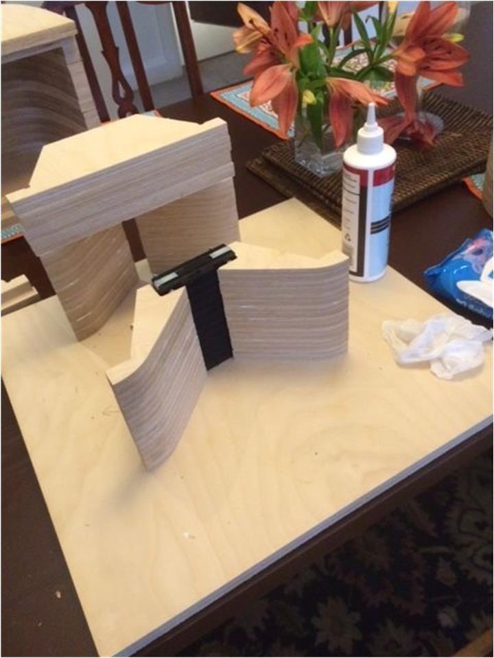

Here is a pic from an Atilsey thread on TPL 3-way.
Atilsey did his own horn and it added almost nothing to the CTC
If I were doing this and cost/time were no object, I would run the glue lam baffle full height, driving the midbasses through slots so horizontal coverages would match.

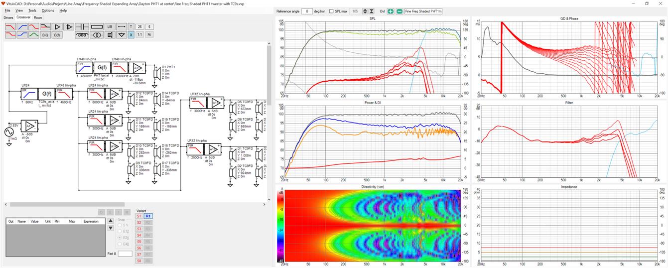

I stumbled across the Dayton PHT1-6 Planar Tweeter ($97) and thought it worth a look. It blended with the array quite well, likely because it is within a small waveguide. There is a lesson there.
Dayton Audio PHT1-6 Planar Horn Tweeter 6 Ohm
Here is the vituix response just swapping it for the SRT7 and re-equing

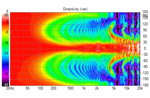

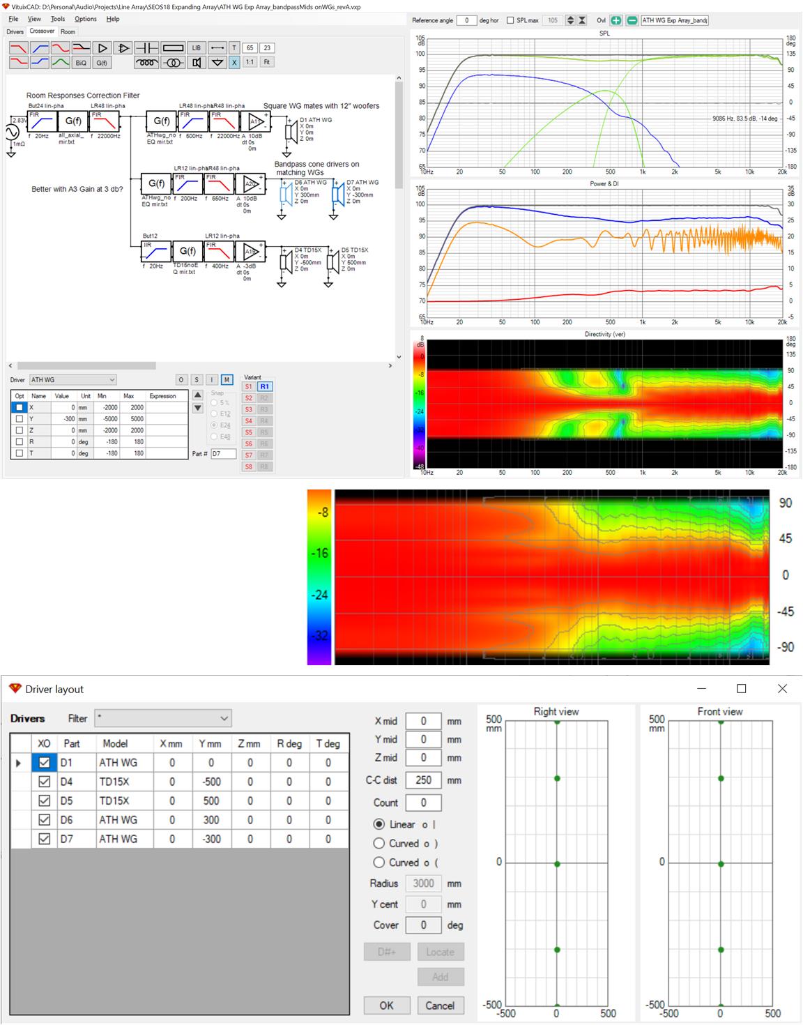

speaking of best results with waveguide in center, I'm going to repost an expanding array with waveguides in center. I'm sure I posted this before but I couldn't find it right away so I can't just point to it.
I took a square waveguide sized to match with 12" woofers from the ATH thread and traced its directivity. I assumed a 1.4" CD at center useable down to 500 Hz. I flanked this waveguide with two others immediately above and below and assumed them driven with cone midwoofers in the 200 Hz to 650 Hz range. These filled in the gap between the central CD and 15" woofers at top and bottom. Without the bridging drivers, the central wg loses pattern control early and lobs appear in the 500 Hz range. Despite my best(?) efforts I still got an abrupt directivity change at 1 KHz where the wg's lose pattern control
This wouldn't be a terribly extravagant approach if one was 3D printing his own waveguides. It might be that 12" woofers would work just as well as the two "extra" waveguides but I didn't try that.
I'd want wider directivity in the vertical plane than the first sim shows and shallower than the second (previously posted) sim. Which is doable I guess if you make up your own waveguide, and use the arrayed drivers to steer that directivity for mid and bottom. Due to the center to center distance the side lobes start to form at higher frequencies, that's what I would want to prevent when a tweeter is added. Yet keep an even as possible vertical output for sitting and standing positions.
The width I have now, with my specific filters, works better than the unshaded array over the same bandwidth and that shows the in-room prediction (within that window) to be largely without floor and ceiling influence. In my personal hunt, that would be the goal of an expanding array like that.
But to even consider it, from my point of view, it would have to be both smooth in the vertical plane (over a controlled width of about a 15 degree angle) and in the horizontal plane (mimicking the results of a single driver there).
Purely to avoid the floor/ceiling as much as possible while retaining that flat response within the envisioned window.

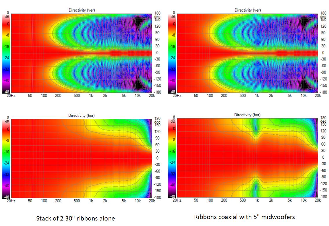

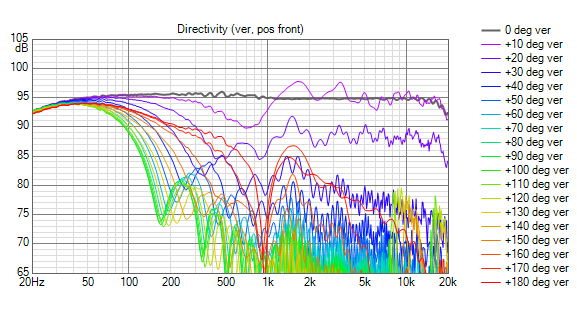

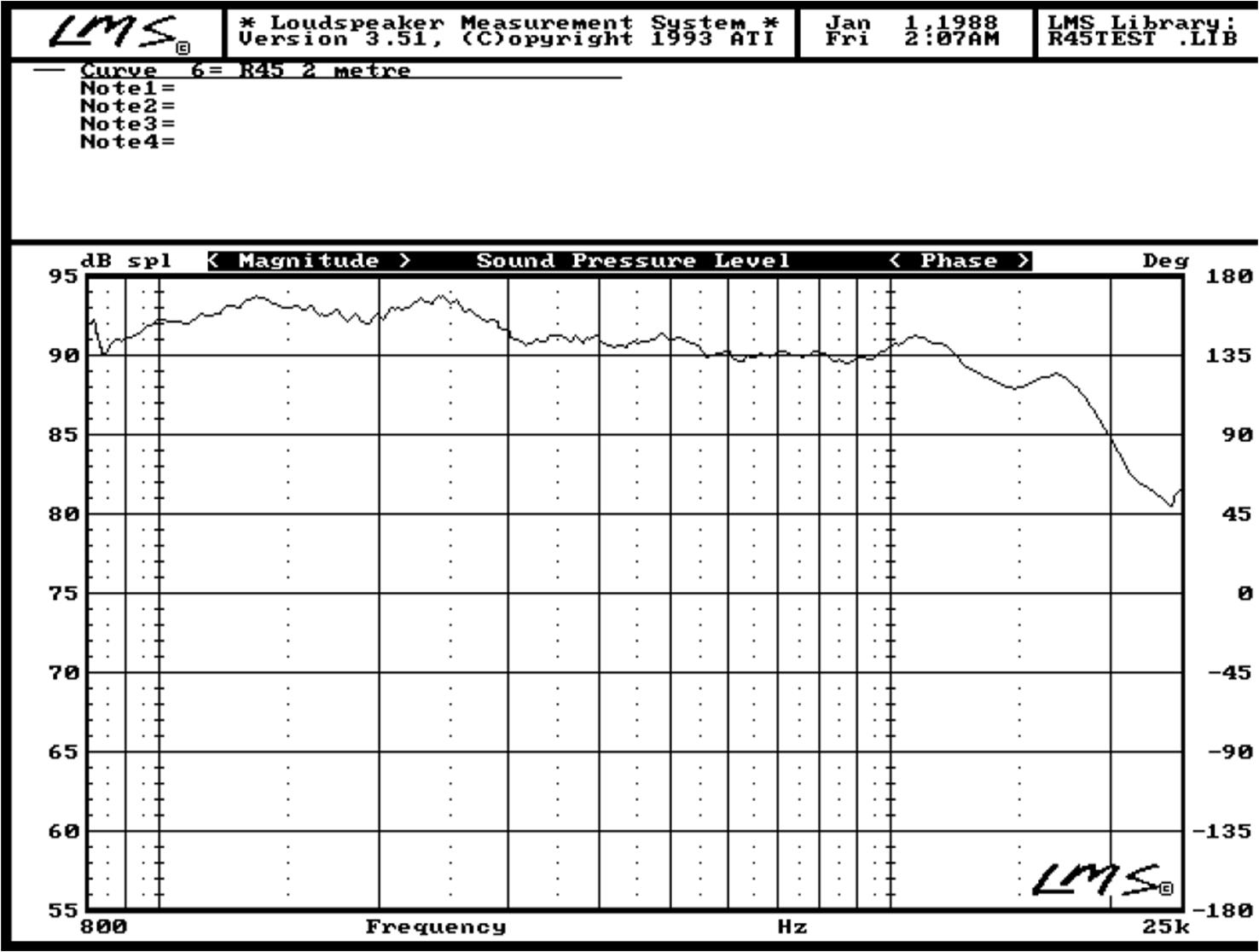

Newform Research R45
The Newform Research line array is perhaps the closest DIYers can come to a full height continuous ribbon line array. Its been around for a long time and surely that would not be the case if it were not a very good solution. But as always the manufacturer doesn't publish as much info as the engineer would like so we turn to Vituix to answer remaining questions.
Axial measurements are available on the web for the 3/4"x30" R45

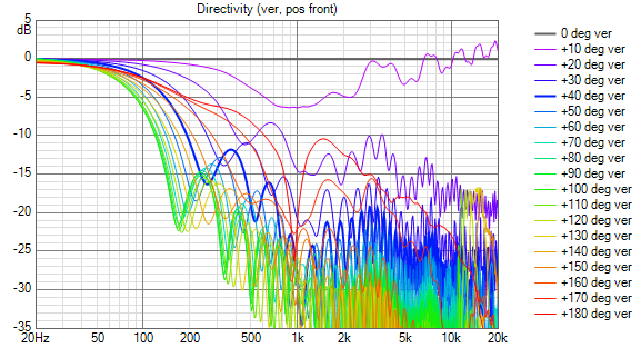

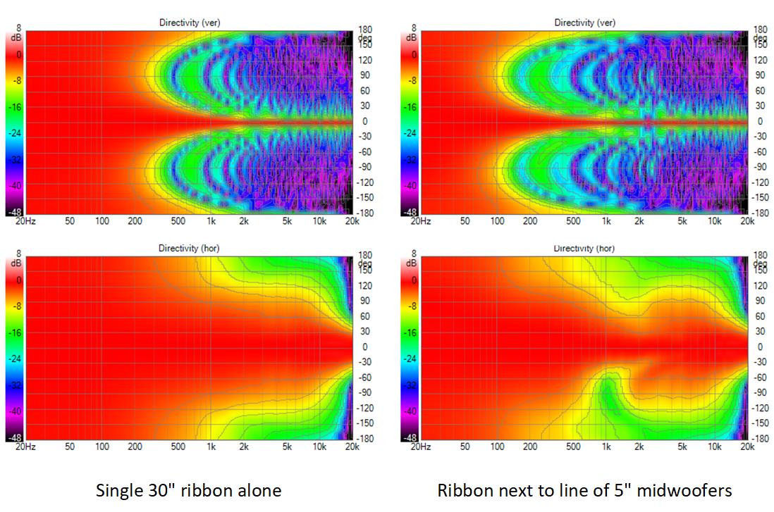

I traced it into Vituix and then used the diffraction tool to create directivity for it. I then simulated it next to a line of 5" midwoofers which give me about 4x the displacement of a line of TC9s.
The system sim shows the issue with 2 way side by side arrays - the abrupt narrowing of the polars near XO on one side. I don't think this is problematic if the arrays are in a corner and that dip faces a sidewall with absorber.
Obviously a 30" tall ribbon is going to have a narrow vertical response. 30" may be sufficient for seated only listening but you would want to stack them 2 or 3 tall for a wider response and to ensure that your listening position was in line array nearfield.
I would also point out how wide the response is. If anything its too wide, certainly too wide for a small untreated room.
I originally thought I could model a single R45 in the diffraction tool at high resolution by segmenting it into 40-50 small rectangles and then place 2 or 3 of these drivers on my schematic. When I did this, I found an axial dip in the system response. Kimmosto showed me in the Vituix thread that this could be eliminated by tilting the drivers vetically to equalize the path length distance from points along the ribbon to the microphone. It was surprising that a horizontal anomaly could be fixed by a vertical tilt.
It only then occurred to me that the continuous ribbon has a continuous path length difference along its length and will therefore show some of the same response ripple as do the discrete arrays.
Kimmo also acknowledged that this dip was due to some approximations in his directivity calculations. The best way to model the stack of 2 ribbons would be a stack of 50 or more individual drivers with the middle driver muted. But Vituix really bogs down under such a load. Therefore I modelled the double driver in the diffraction tool as 49 individual elements - per Kimmo's advice except the center/gap driver isn't muted. This gives a small simulation inaccuracy as the gap between drivers isn't modelled. However the gap is on the order of 5% of the radiating surface whereas the rule of thumb advises keeping the gap under 10%.

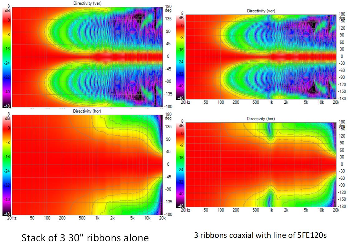

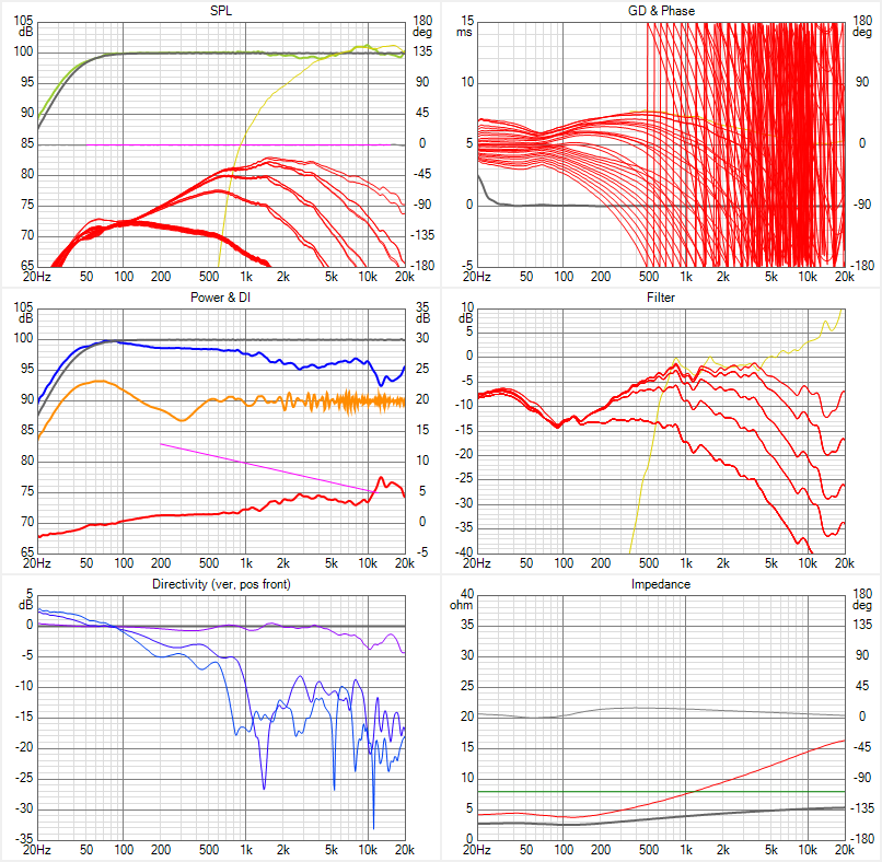

Here are the double and triple ribbon simulated responses
The midwoofer line's response narrows between 500 Hz and 1 Khz. This could probably be fixed with some shading but I have yet to address it. Except for that, the vertical polars look pretty good. But polars can be misleading; here is the vertical line chart for the double R45
and for the triple R45
so the long ribbon is not a panacea but it looks like something that enables a very good solution, but perhaps not the best for a smaller small room given its very wide response.
