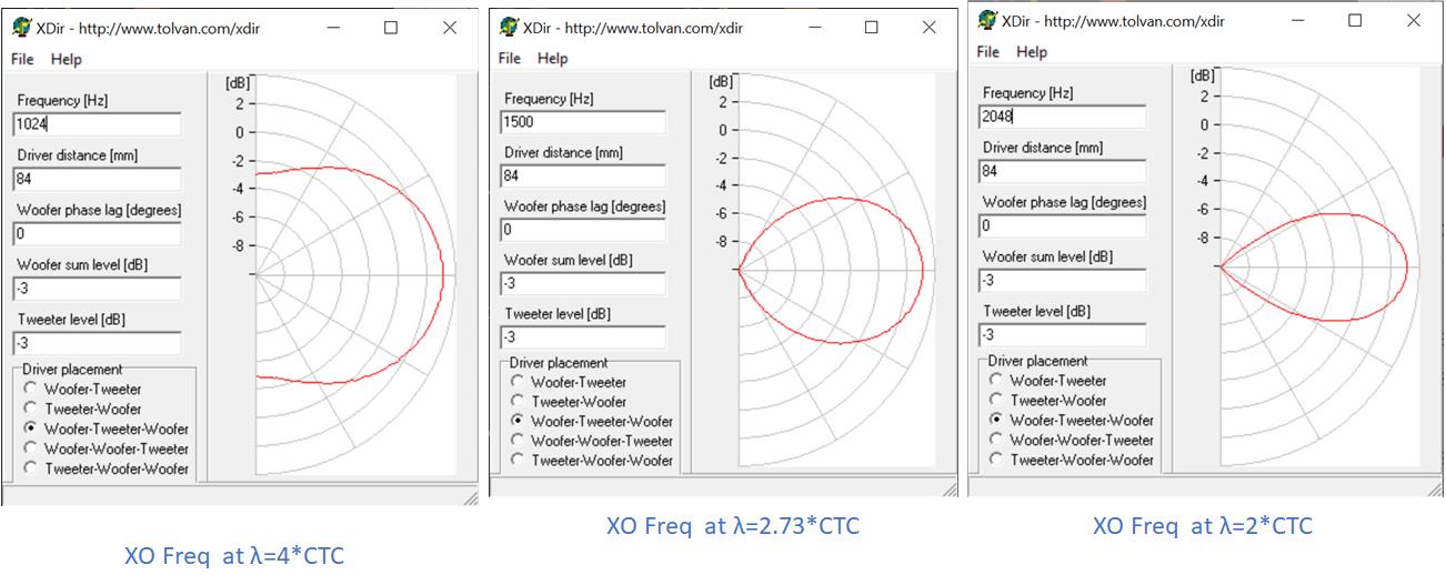

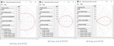

I asked XDIR what directivity we would get from this 1/4 spacing rule
It seems to me that the 1/4 rule gives too wide a vertical beam. Too much energy will be splashed off floor and ceiling and come back to the ear/mic to cause combing.
Using a 1/2 wave rule gives too narrow a beam that will result in something suitable for a single listening height.
At Wesayso's position, there is a 14 degree elevation to standing ear height. The middle diagram will be down < 1 db at that angle. There is still significant energy hitting the floor at 20 degrees but it will return to ear height well past the listener. This seems like a good choice.
The challenge is to maintain this directivity throughout the audible spectrum...

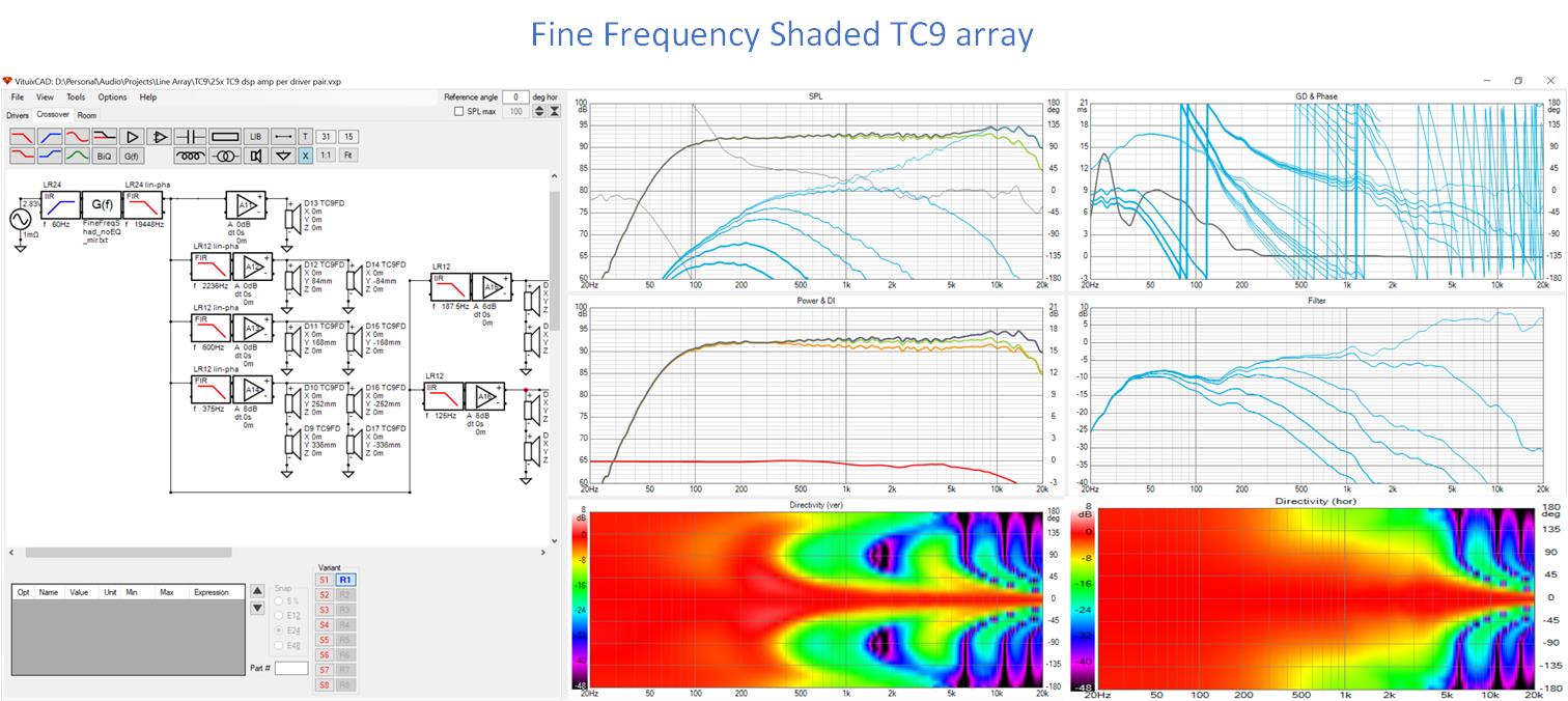

I took a shot at maintaining that beam width across the entire spectrum and almost made. The vertical beamwidth is 10 degrees but in the treble it seems to be limited by the beaming of the central TC9 itself. This is a combing free array at this 3m listening distance, absent the ground image. Other such combing free arrays have been more like 5 degrees vertical beamwidth. This is the flattest directivity index (red trace middle graph) I've seen.
The expansion in this array is not only increasing length with decreasing frequency but also increasing driver group size for groups further away from center. The outermost two groups have 8 drivers each and IIR filters. The other groups have linear phase filters. The filter for the group closest to center is the most critical and absolutely requires IIR or the filter phase shift hurts the directivity. Further out, linear phase becomes less critical. The other linear phase filters could be changed to IIR with smaller injury to directivity some of which could be made up with via DSP delay. Raising the corner frequencies narrows the directivity.
This does require a fair number of amps and DSP channels; a custom DSP/DAC/chip amp board would go a long way towards making it practical for most.

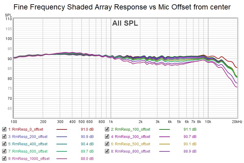

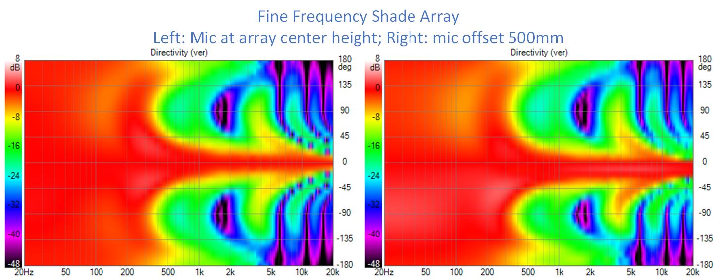

Checked the response vs mic height and it seems too good to be true
Strangely, if you move your ear up or down relative to array center height, it seemingly widens its vertical directivity to accomodate you or rather, its axis of symmetry moves in the opposite direction. Somehow this helps...
My expectation is that adding ground image drivers won't change this aspect much but we shall see.

The last array described in this thread does not use resistor/amplitude shading but frequency shading. This frequency shading eliminates combing on responses coming directly from the driver but not on those longer delayed reflections from floor and ceiling reflections. I have a spreadsheet that calculates the delta path length and corresponding quarter wave frequency for each driver allowing me to set low pass filter cutoff frequencies before the phase shift from any driver reaches 90 degrees.
I've shown resistive shading isn't as good as frequency shading even when paralleling the resistors with inductors to undo the shading at low frequencies. Amplitude shading reduces but doesn't eliminate destructive/subtractive combination from distant drivers. In frequency shading I see a strong advantage for using linear phase filters in frequency shading because of the lack of filter delay. I suspect that this can be worked around to some extent with compensating delays in the center driver channel but haven't seriously tried that yet.
