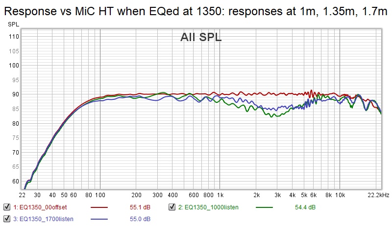

Tried some amplitude shading in the center group for a 1 db improvement in the deviation circa 3 khz. Even if I got the variation within +/= 3db over the entire window I still wouldn't like the frequency of the ripple in the top octave.

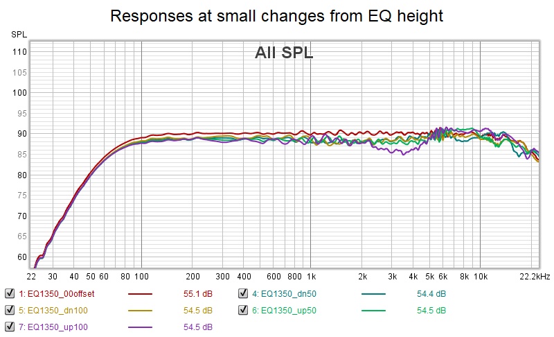

There would be many ways to do the shading, but seemingly we'd need a longer array to get good performance at 3 KHz, so the crossover should move up.

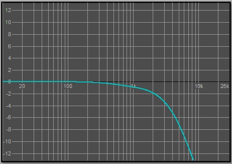

Isn't shading with a bypassed resistor (to keep bottom end) a better solution?

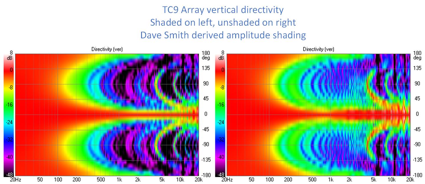

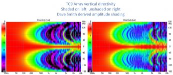

a picture to reinforce what I said in the previous post
842787d1589136723-range-line-array-wall-corner-placement-shaded-vs-unshaded-vertical-directivity-jpg
Looking at both these pictures, I still expect improvement in the array behaviour if one were to shade the 5 drivers above and below the center ones above 5K (as from 1K to 6 K we have a pretty good graph unshaded, but the left graph shows less side band influence above 5K. I see no reason to shade them any sooner. The amount of shading could possibly keep pattern control a little higher up the chart. A little goes a long way, basically it would be experimenting.
Also, the narrowing between 5K and 1K isn't there in the shaded example. So the outer drivers could be shaded above about 400-500 Hz. Making the bottom end mimic the D.S. shaded array.
Looking at this presentation:
And assuming both of these graphs were made with the measurement point at the center, the difference in distance between the outer most driver(s) compared to the center driver would be 160mm. Wavelength of 160mm x 4 = 468Hz. 'Probably' responsible for the narrowing around 500 - 1 KHz.
I'm guessing that 'could' make the graph prettier overall. It could also mean you'd actually need to build an array of twice the listening height in length as an ideal devise, so it's always symmetrical around the preferred listening height/position. Making sure to absorb high frequencies enough in floor and ceiling reflections (may not even be hard to do). As these examples do somewhat sim finite arrays. I'm not thinking my arrays act like infinite at high(er) frequencies. Most of what I was hoping for is that it would help out the bottom end.
The low frequency handling would go down, but it could have excellent properties around the listening height. More shelf shading of drivers could bring that back by letting those drivers making up the rest of the length help out the bottom end (below say ~200 Hz).
Do you get what I said about a corner array by the way? That it has 2 extra ridges to worry about? No offence meant, but that's what I see when I look at these corner constructions. Sharp corners/ridges/parallel planes... that's the kind of thing I tried very hard to avoid. A gradual change from baffle to wall could avoid that, but it would make up a strange waveguide in the process. Or... absorbing the energy at the abrupt end of it.
Thinking about the unshaded graph, my ambience channels probably help fill in the 500 - 1 KHz area above seated height (as they are within the Haas limit). Possibly making the narrowing a bit less obvious.
attachment.php
Disclaimer: The array + ambience (when ambience isn't low-passed) sums pretty flat. The ambience channels fall off naturally below 200 Hz.
I still have to try a high shelf instead of a low-pass.

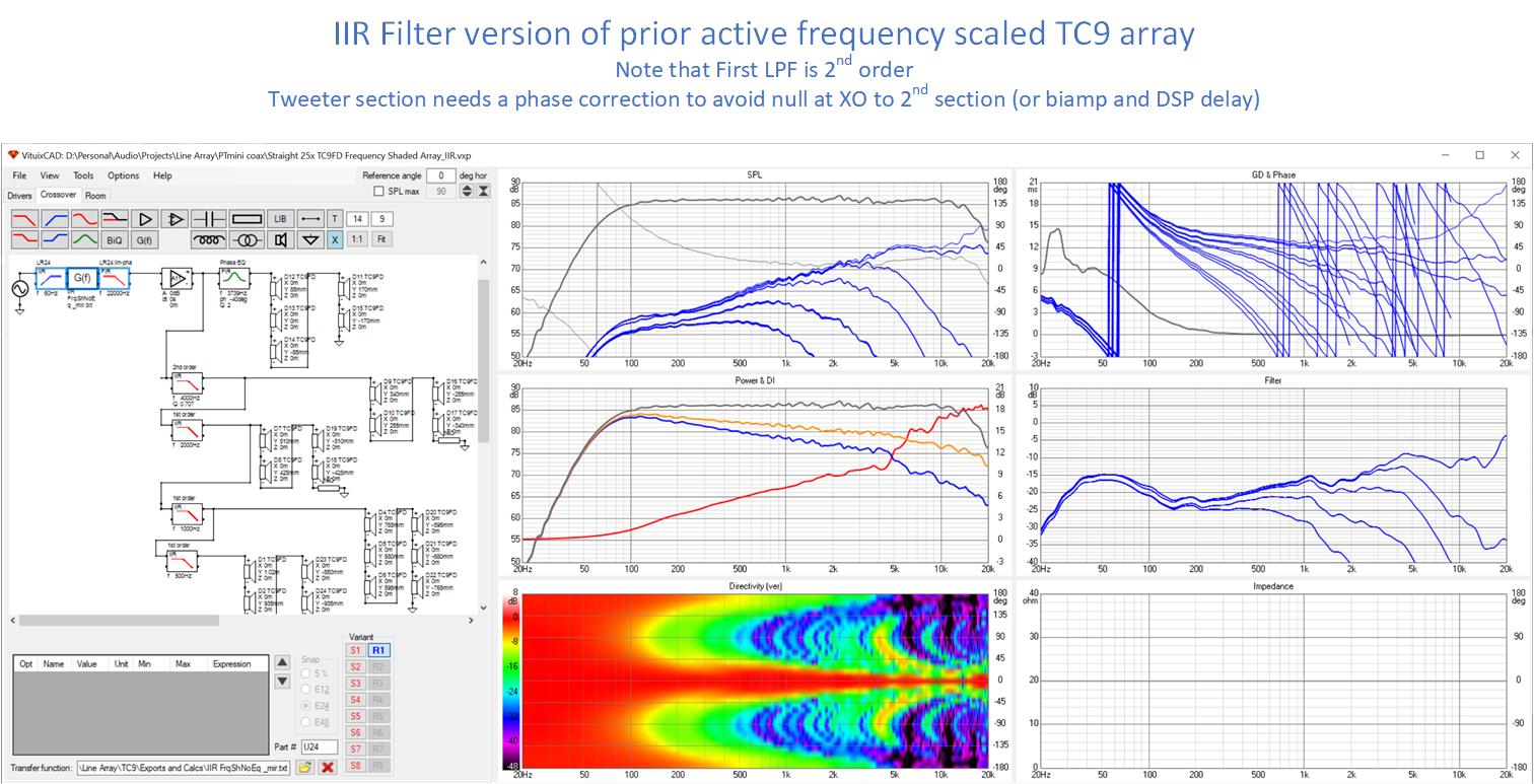

What you describe sounds like a passive version of my active frequency scaled array. I quickly threw together this IIR version, which I had been meaning to do. Little attempt to optimize it; just enough to get a decent response. Mic still at array center, moving off center is another complication. I'm not sure where the net Z ended up; for some reason its off the scale in the Vituix graph.
attachment.php
I had to make the first low pass 2nd order to get a decent response and I had an XO null near its corner that I fixed with a phase correction element, which suggests biamping. The rest of the filters are first order
The results aren't as nice as the active version and the narrowing of the vertical is still there; perhaps a little wider, perhaps due to the higher level of vertical sidebands. There are lots of things to explore in your own simulation that might or might not improve it.
Not quite what I had in mind. The reason for me not to dive into Vituix is that I need to learn how to apply what I want it to show.
My suggested setup only had 3 groups. One center 5 drivers, running full range. 2 groups of 5 drivers each running up to 5K and shelve-shaded above that, so a resistor bypassed with inductor to lower high frequency content above 5 KHz while keeping the same SPL levels below 5K.
2 more groups of 5 drivers (top and bottom) that have a similar high shelf-shade applied for anything above 450 Hz.
Again, resistor bypassed with inductor. Creating that shelved result. The variables are the SPL level that is used to shade, seeing how that influences the graphs.
We know what the non shaded array looks like, this is to improve the 500-1 Khz and the top end above 5K.
You are shading way more drivers than I would and it is obvious that eats away from the good things the unshaded array shows us. At least in my mind. ;)
Those would be my ingredients, but I'd need to learn how to apply the directivity to the drivers, learn how and where to EQ etc.
I have limited time, this learning curve is going to take time... so it isn't for me right now. At some point it may be... maybe when I'm without a setup when my home renovation starts... (while I do have some spare time on my hands, I'm filling a website I started. Not as meaningful or helpful, but I can walk away from it whenever I need to. Learning a new tool with lots of options requires much more attention :))

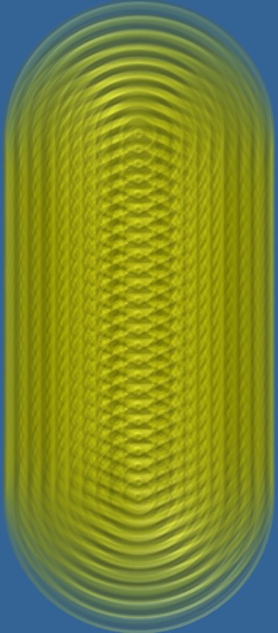

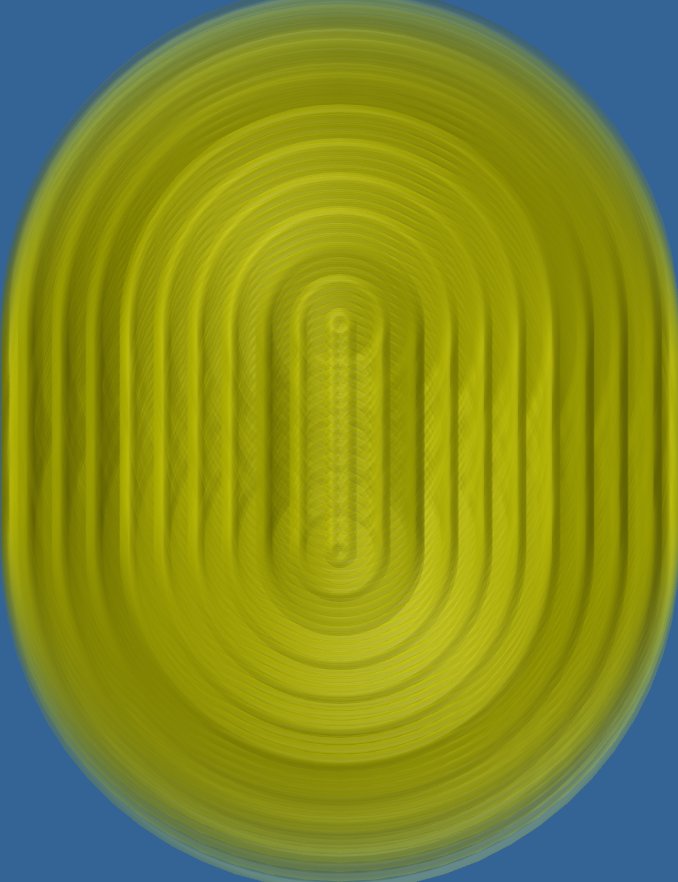

Let me show my previous post by adding a couple of pictures...
2 sources spaced a quarter wave apart:
843133d1589219598-range-line-array-wall-corner-placement-2-sources-jpg
Click on picture to enhance...
No matter what angle you view it from, it has no comb lines.

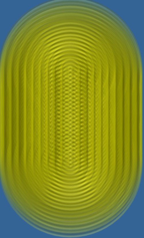

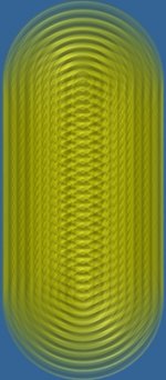

Now add a couple of sources, making it 5 in a row, still spaced a quarter wave apart:
843134d1589219600-range-line-array-wall-corner-placement-5-sources-jpg
See how we get combing? except on the frontal lobe?
Now lets examine 25 in a row:
843136d1589219916-range-line-array-wall-corner-placement-25-sources-jpg
Here's what the line theory is all about, it looks like a flat wave front is emerging from the source...

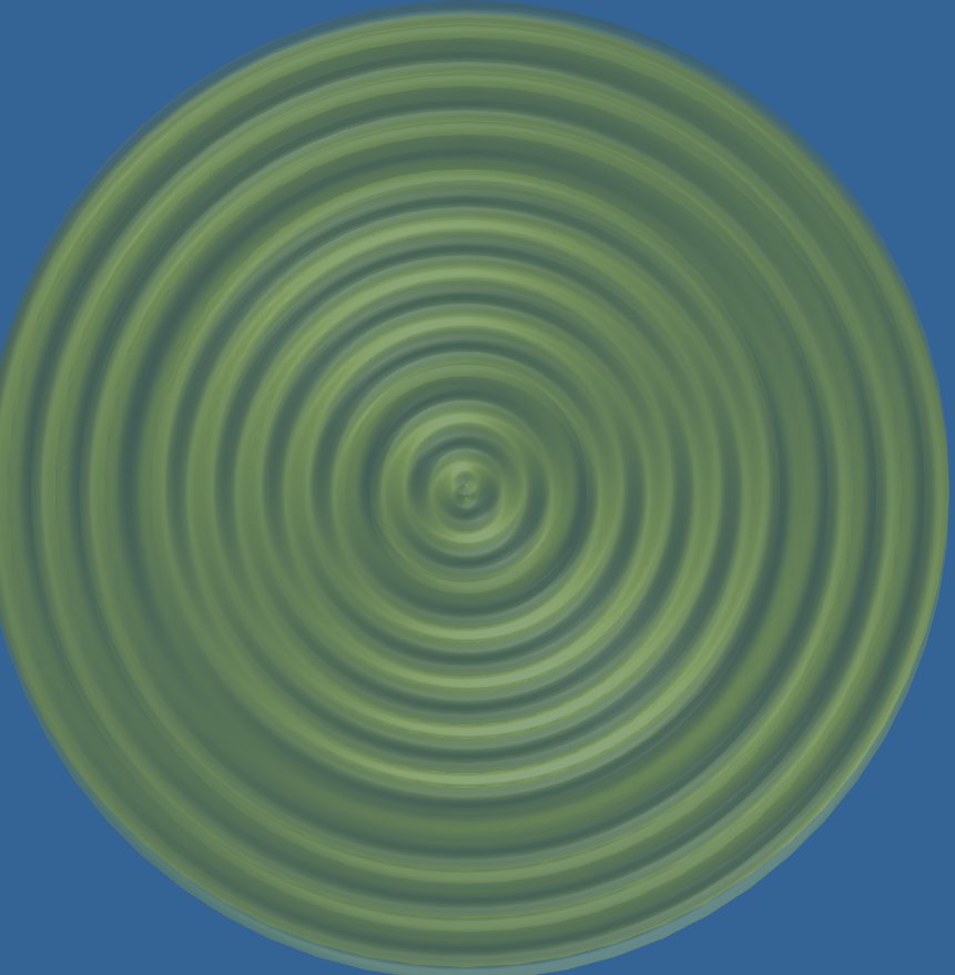

Now lets look at the same situation but where the drivers are half a wavelength apart:
843139d1589220190-range-line-array-wall-corner-placement-25-sources-half-wavelength-jpg
In this case, the further you move away from the source, the more it looks like a flat wavefront.

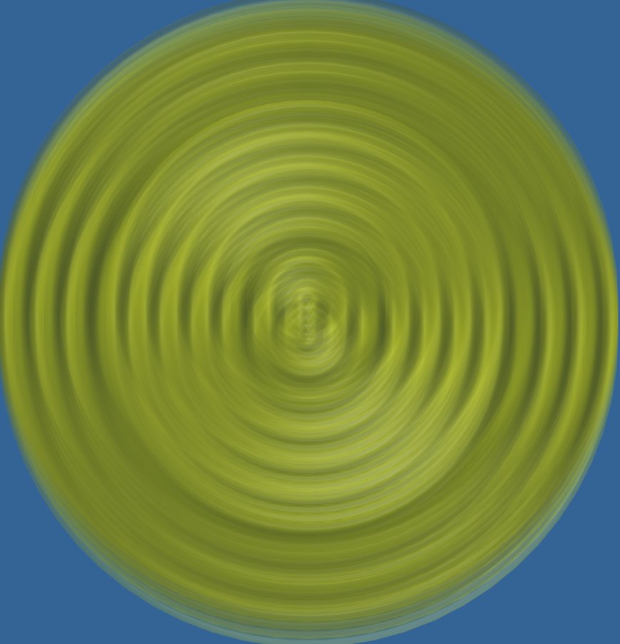

One wavelength apart:
843140d1589220434-range-line-array-wall-corner-placement-25sources-wavelength-jpg
I did not add enough sine-shaped waves to clearly show the protruding flat waveshape here...
It will be there though, at enough distance but it is clear to see the advantage of closer spaced drivers.
Make your own conclusions ;).
