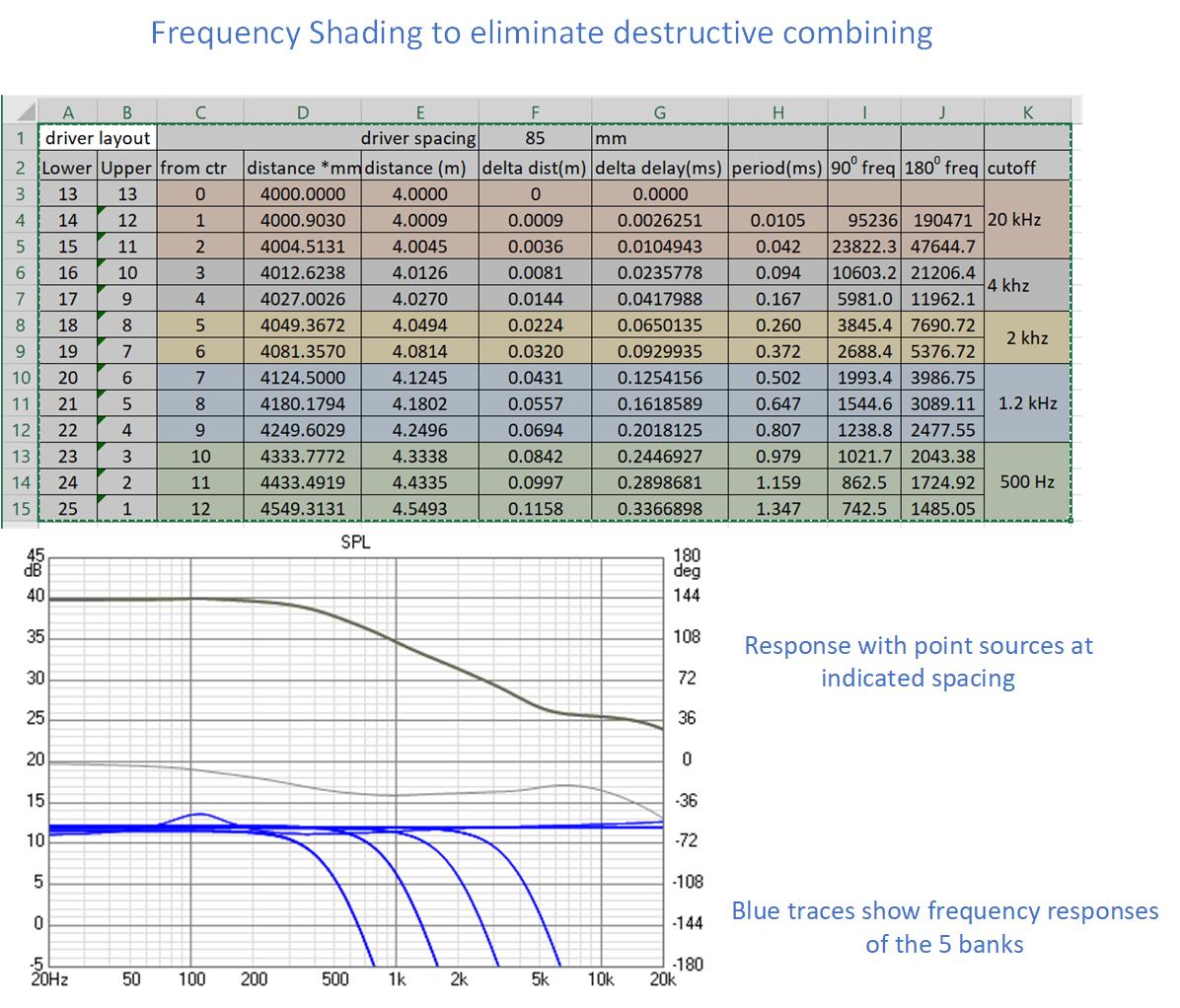

Yesterday, I made the aphoristic comment that destructive combining was the root of all evil for full range line arrays. Later, out of the blue I realized I could frequency shade to cut off each driver before the phase shift due to its delta path delay relative to center driver reached 90 degrees. Then there would be no destructive combining!
This led to this spreadsheet (inadvertently attached to previous post) which suggested the banking and cutoff frequencies indicated in it:
attachment.php
What happens here is that fewer drivers contribute at the higher frequences but no drivers contribute destructively. You don't get roll off in the high end so much as rising response towards the low end as the lower you go, the more drivers contributing all constructively. In that sense it is an expanding array!

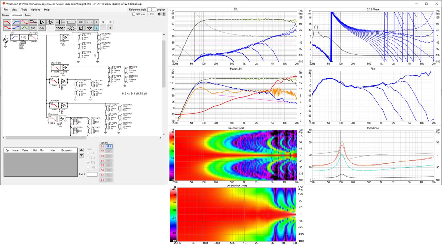

Going on to a full simulation:
attachment.php
I plugged in the weights and corner frequencies from the spreadsheet, tried LR4 linear phase slopes, IR inverted the axial response and went for it. Chances are IIR or even passive filters can be made to work. I also had a 4 bank version that seemed to work just about as well.
There isn't a hint of combing in this response. Vertical sidelobes in the top two octaves are significantly reduced as are ceiling and floor splash visible in the orange room response trace.
I see a lot of promise in this approach. The drivers don't all have to be the same size. One could use smaller ones at the center for wider horizontal dispersion and larger ones at the edges to extend the low end. The only downside I see is the number of amplifiers and, so far at least, DSP channels needed. That can be worked on.

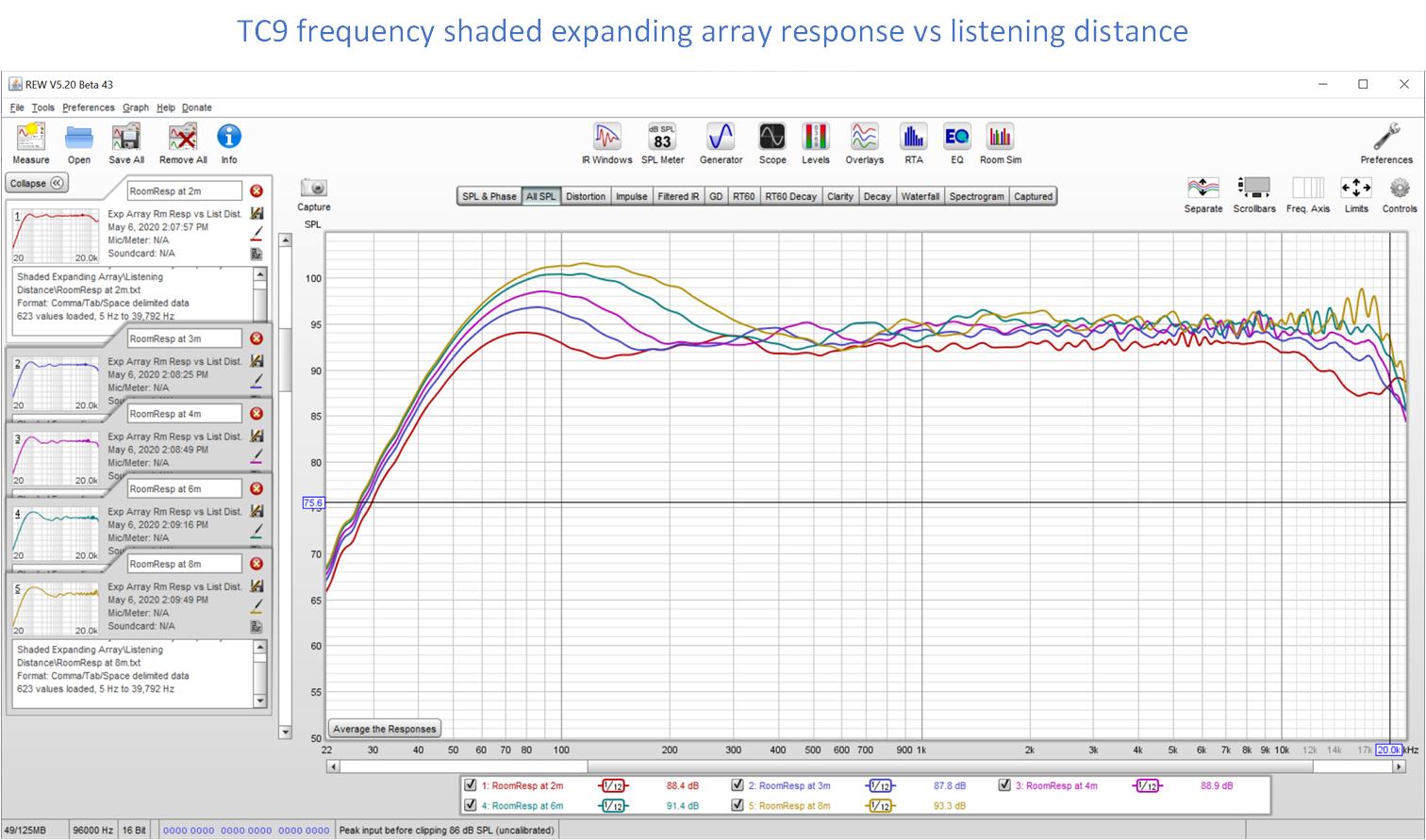

one thing I should point out that might not be obvious until you dig into my spreadsheet -
the fllter corner frequencies that it calculates depend on the listening distance. The calculation should be done for the closest listening distance anticipated. Then if you move back the filters will still work although their corner frequencies will be lower than they need to be for the increased listening distance.
Which reminds me: I did the spreadsheet for a 4m listening distance but I had Vituix set for 3m out of habit. Correcting that I see very little change - less than a db -in the axial response over range of 3m to 6m. You can even listen at 2m with this shading although you will lose some of the high treble.
The room response curves do vary more over this range. Most of that variation is in the bass region.

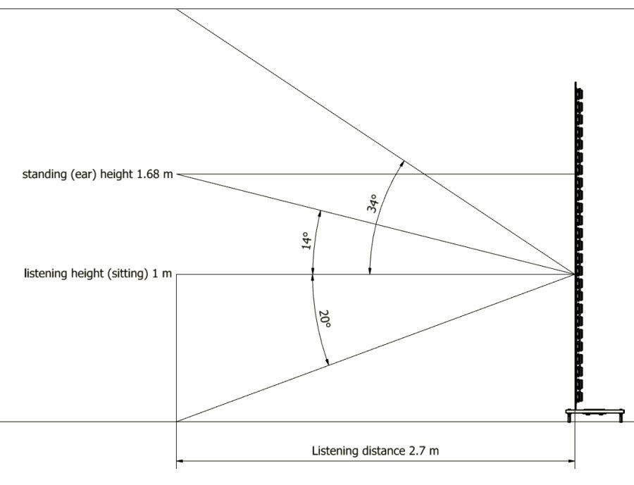

Explain the vertical angles again, but after looking at my measuring distance.
Not quite at 3 meter, I measure at 2.7 meter. But I can never be more off-axis than 20 degree below my measurement/correction position, I'm 14 degree off axis when standing up and cannot be more than 34 degree off axis above the measuring/correcting position. So a simulation of a floor and ceiling should take these realities into account I'd say. That's where the ceiling splashes ;). We can't be under the floor or above the ceiling. Yet I cannot see that in these graphs, as they do not show any boundaries.
The presentations from Keele for his CBT, use the floor as reflective for a CBT, but not for the 1 meter long array. So no help there.
How much deviation would you expect between listening seated and standing up?

I don't have real floor to ceiling coverage of drivers. Not a surprice for those that have seen my pictures. This drawing represents my reality. Yet I don't think these simulations tell me what I experience.
Sure, there is audible deviation, but the listening window predicted just doesn't seem right to me. Can you explain that away?
Part of where the mystery begins, my measurement position is at about 1 meter height. That isn't the center of my array.
The center lies at ~1.197 meter height. So I expect a reasonable symetry from the array around that measurement spot.
As at 1.394 m height I have a similar amount of drivers below/above as at my measurement position. The floor complicates

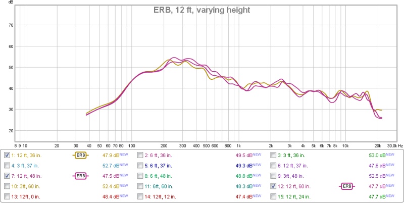

Here's the raw measurements from ra7 at 12 ft distance and the following
heights:
36" or 0.9144 meter
48" or 1.219 meter
60" or 1.524 meter
525558d1453005536-corner-floor-ceiling-line-array-using-vifa-tc9-12ft_varyingheight-jpg
Looks quite acceptable to me, as it did back then. That kind of variation I can relate to.

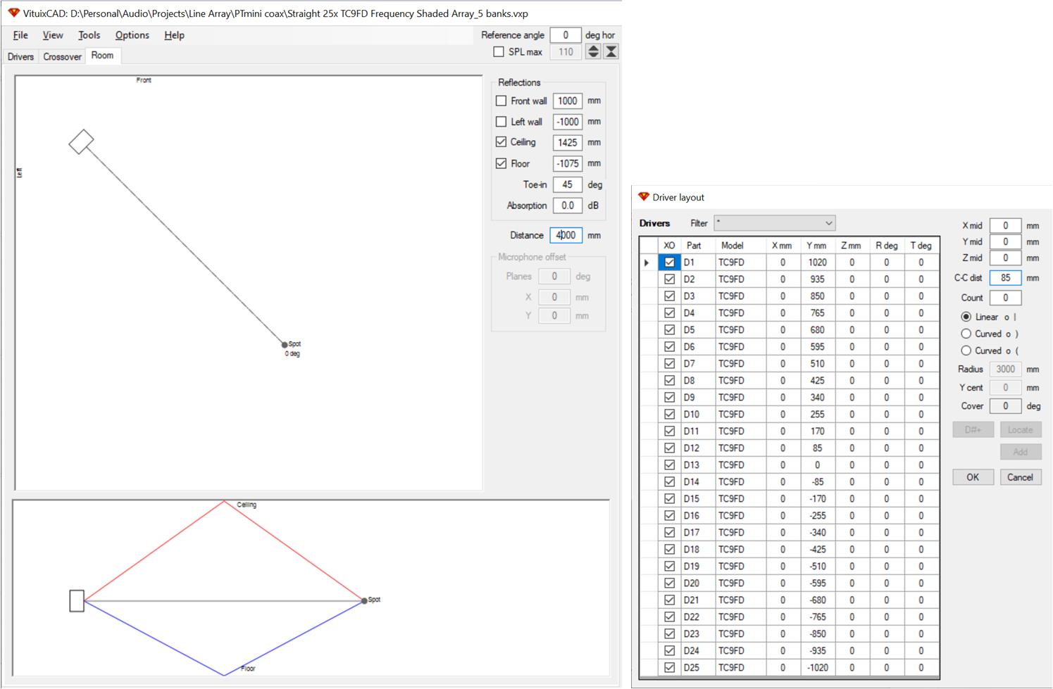

I guess I didn't answer where the floor was in a Vituix simulation. The only place it exists is in the room response tab. On its right edge are check boxes for which reflections you want contributing to the room response. If no reflections are checked, the microphone offset table becomes un-greyed-out and you can move the microphone relative to array center. The driver location table can be edited to move or re-0rient drivers.
attachment.php
The axial response is the anechoic response in free space which has no floor or ceiling.
Re' Don Keele: when I do a groundplane CBT I always input the full curve considering the bottom half of the array to be the ground image.
heights:
36" or 0.9144 meter
48" or 1.219 meter
60" or 1.524 meter

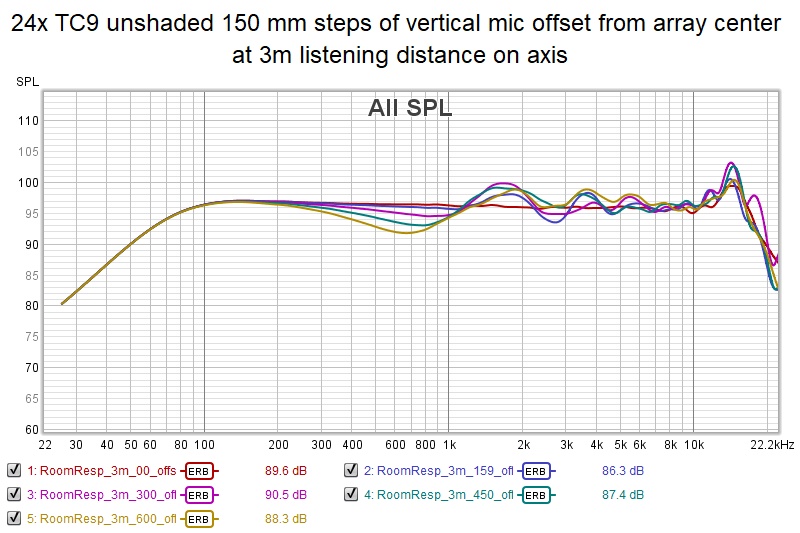

I was going to pull that graph up but you beat me to it. I have yet to show the equivalent for the same array but here is one now; not quite the same but close enough.
ERB smoothing, equalized at 3m listening distance with mic at array enter. no floor or ceiling support. Steps of 150, 300, 450, 600 mm away from array center. S
It may differ in detail from ra7s but the amount of variation is remarkably close.
attachment.php
Re keeping of evenness of response.
My shading algorithm can only make it better. The unevenness that comes from destructive combination (driver responses arriving at microphone >90 degrees out of phase from center driver's response) is eliminated. Other causes of un-evenness are unaffected.
Give me a few minutes and I'll do the same graph for the frequency shaded array

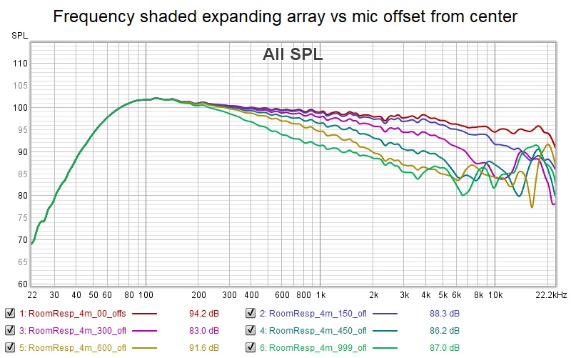

Here is the response vs mic offset for the expanding array. Its remarkably even until we bump into the narrow vertical directivity and start losing treble.
attachment.php
Yes, the vertical window is only +- 5 degrees
Perhaps that drawing board will need to be revisited:)
might have to allow some destructive combination to get a wider vertical window or we put in a real tweeter in that central position - which would have wider dispersion but which the array would not be able to control
and I bet we get some destructive combination when we move the mic so far up or down that contributions from the then most distant end of the array exceed 90 degrees phase shift
Which should mean that the area between plus and minus 600 mm is a good listening height? That's a 1.2 m wide sweet spot vertically within a reasonable variation. What are the angles of that area?
It would be even better/wider if you were to equalize below center. As equal distance above center you would get back the exact same situation. Making for a much wider vertical sweet spot, as seen in practice.

Now you see my point of me, moving away of that frequency shading idea? As said, I'd like to keep the vertical window....
Which should behave even better equalized below the actual array center out in a room.
There are reasons for floor to ceiling arrays, not sure these simulations portray all of them equally good...
I think you are getting my point. But this simulation did help to prove that point, and it can be made into an even bigger difference.
The simulations are pretty cool, but do not show every variable to make it comparable to real life. Unless we know enough to chase that.
It's almost the same as with DSP. DSP does exactly as we tell it to. The problem is knowing what you want out of it...
According to your picture, you need a 700 mm tall listening window. That can be provided IFF the drivers over that range of elevations plus some margin are driven full range. Thats 9 TC9s, maybe 10. In my initial expanding array, only 5 drivers are driven full range and they are centered at array center. Its obvious how to fix that. Once I do I will have to equalize to the reflection free room response curve in order to offset the mic.
Yes I agree I shouldn't be equalizing with mic at array center. I either want the mic at seated ear height or midway between seated and standing ear height. My implicit assumption all along has been that if I could get a good response equalizing at array center, I could get one just as good equaling offset from array center. One reason for this assumption/belief is based on the infinite array model - that the response is the same at any height.
If we are going to compare simulation to measurement than we first need to do all that we can to align the simulation with the array whose measurements we have.
Couple of things in the light of a new day:
Physics/geometry sets clear limits on the vertical window of this style expanding array. There is a limited height of a string of drivers over which that 90 degree phase shift window can be maintained. If you move the mic off vertical center, its now closer to some drivers and further from others, so that the 90 degree phase shift rule may be violated and some destructive combining may occur. I tried several things this AM but was never able to get a window tall enough for both seated and standing. What this shading provides is a single listening height solution that is exceptionally constant over perhaps a 12" vertical window but suffers increasing loss of treble as you move up or down outside that window. I think this tradeoff of smoothness and reduction of combing within the window goes hand in hand with a narrower vertical window for the shading algorithms I presented earlier.

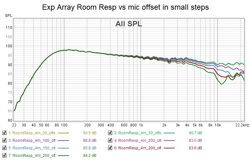

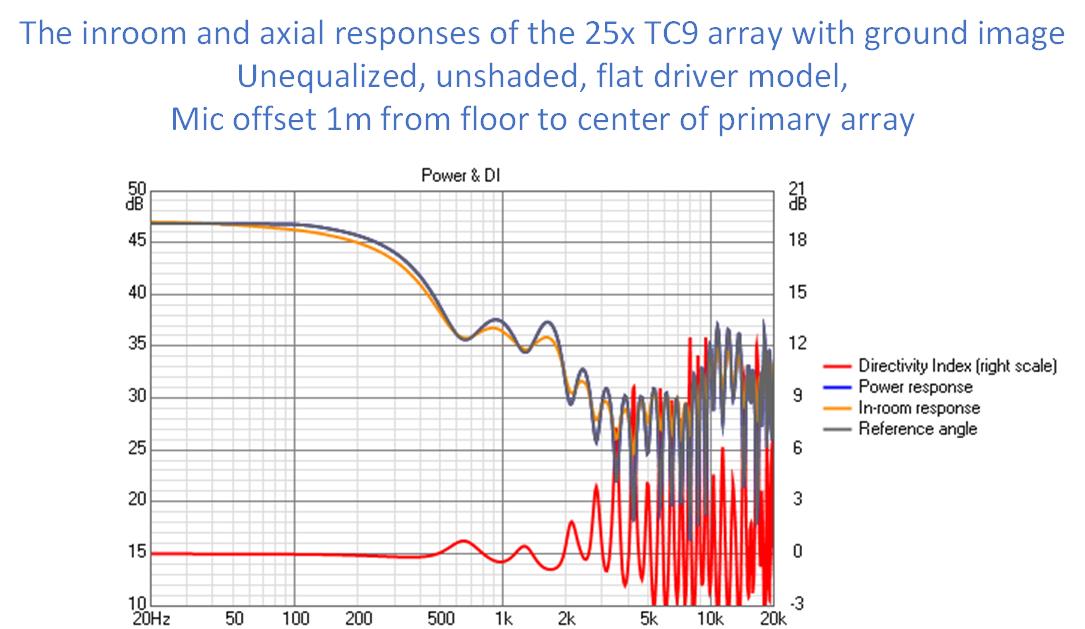

I found out that the offsetting the mic in the room response tab does affect the axial response and the polar maps in the main screen. Its not onerous to equalize to an offset mic. Lots to play with there.
How best to model the quasi infinite line array?
If Vituix doesn't fight back, the best way is to include ground and ceiling image drivers and then will see effect of ground and ceiling reflections when offsetting microphone. I will try this...I'm confident I can include a ground image, perhaps not ceiling also.
Over what frequency range does quasi infinite line array model apply:
- certainly where the driver remains omni. The beamwidth for the TC9 is omni below 500 Hz or so and stays wider than +-90 degrees until almost 2 khz
- certainly not above 12 khz where it beams
- at for example 5 khz or so, the beamwidth is about +- 45 degrees. Geometry shows that the 2nd and higher order floor and ceiling reflections return to mic height behind the mic so modelling a single floor and ceiling reflection should be fairly accurate above 5 khz where we have the most concern.

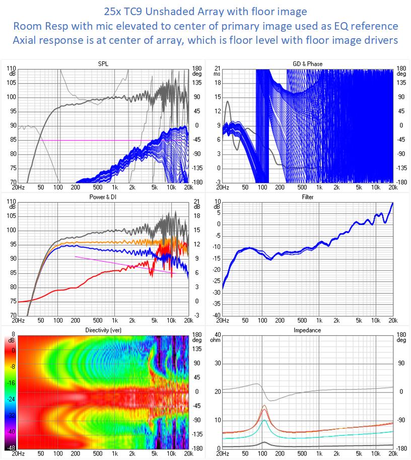

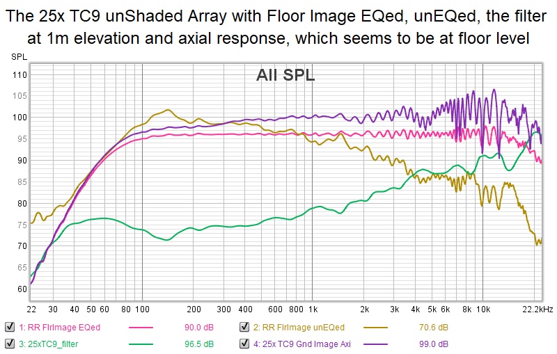

wrestling with image drivers
Its taken me a while to add the floor image drivers, sort through various pilot errors, and figure out what I'm looking at.
attachment.php
The first thing I saw was increased combing, which is only to be expected given that now there are twice as many drivers combining, half of them from greater distances. That dampens my enthusiasm for the frequency shading because the image responses will be delayed enough for destructive combining even though the direct sound is not. But that frequency shading may be useful for a half ceiling height array shaded so delayed floor and ceiling reflections don't pass 90 degree phase shift.
The true array center of the 2m high physical array being modeled is now 1m above the virtual floor, which Vituix treats as array center. Therefore, I set the microphone offset to 1m and used the room response as simulation reference.
attachment.php
This worked as you can see in the nicely flattened orange trace in the middle graph. In the next picture, I've pulled responses into Vituix for a better look:
attachment.php
The flattest trace is of course the equalized room response. The downward slanting gold trace is the un-equalized room response, which looks more like a real measurement than anything else I've produced. The dark purple trace is the axial response which apparently is at virtual floor level. The green trace is the filter itself created by IR inverting a 6th octave smoothed version of the unequalized room response.
What about the ceiling image drivers. Including them seems to break Vituix. I'm still investigating how badly and looking for the maximum number of drivers I can include and still get sensible results.
In all honesty I think this FR plot is pretty close to reality. Did you apply some sort of absorption in the reflection properties? I'd believe we wouldn't get a true floor reflection but that it would be somewhat reduced in level. Not sure how much it would be reduced though.
Not sure why the vertical directivity is upside down from what I expected, but that may be due to the lengthened array with floor mirror? (missing the ceiling, thus having the symmetry (mid array) fall below the zero line)
What does it look like without floor reflection but with the 1m height position for equalising?
I think for a seated listening preference that shaded result looks pretty interesting too.
If one were to prefer a listening seat only setup it could prove to be worth investigating this further.
Can you show the other graphs belonging to this one?
841592d1588855358-range-line-array-wall-corner-placement-exp-array-resp-vs-mic-offset-steps-jpg
And was this one done with passive means or linear phase LR like before.
