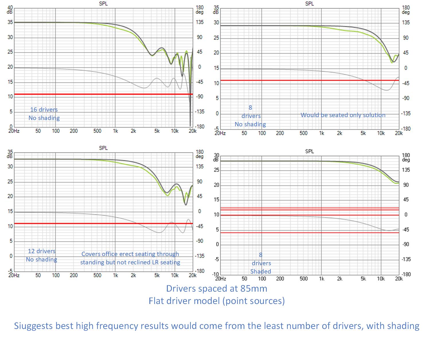

A compelling case for shading

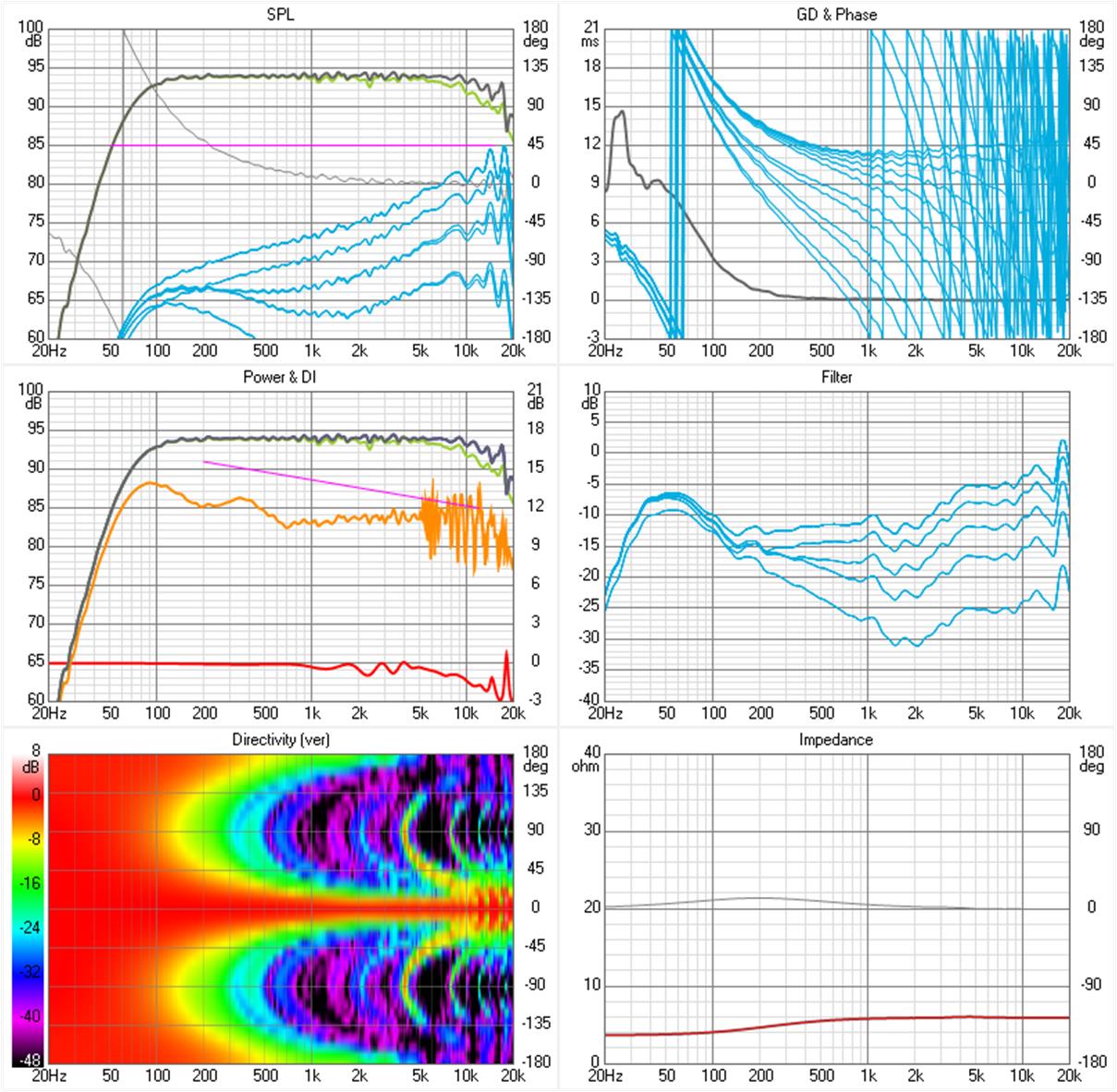

In his landmark article back in the day, Dave Smith made a compelling case for shading line arrays.
AES E-Library >> Discrete-Element Line Arrays-Their Modeling and Optimization

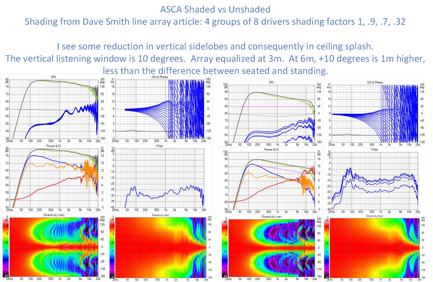

I reread the article recently and decided to give his simple 4 group shading a try in simulation.
attachment.php
Shading reduces the amount of frequency response ripple that needs to be equalized, which is good because that equalization is distance and position dependent.

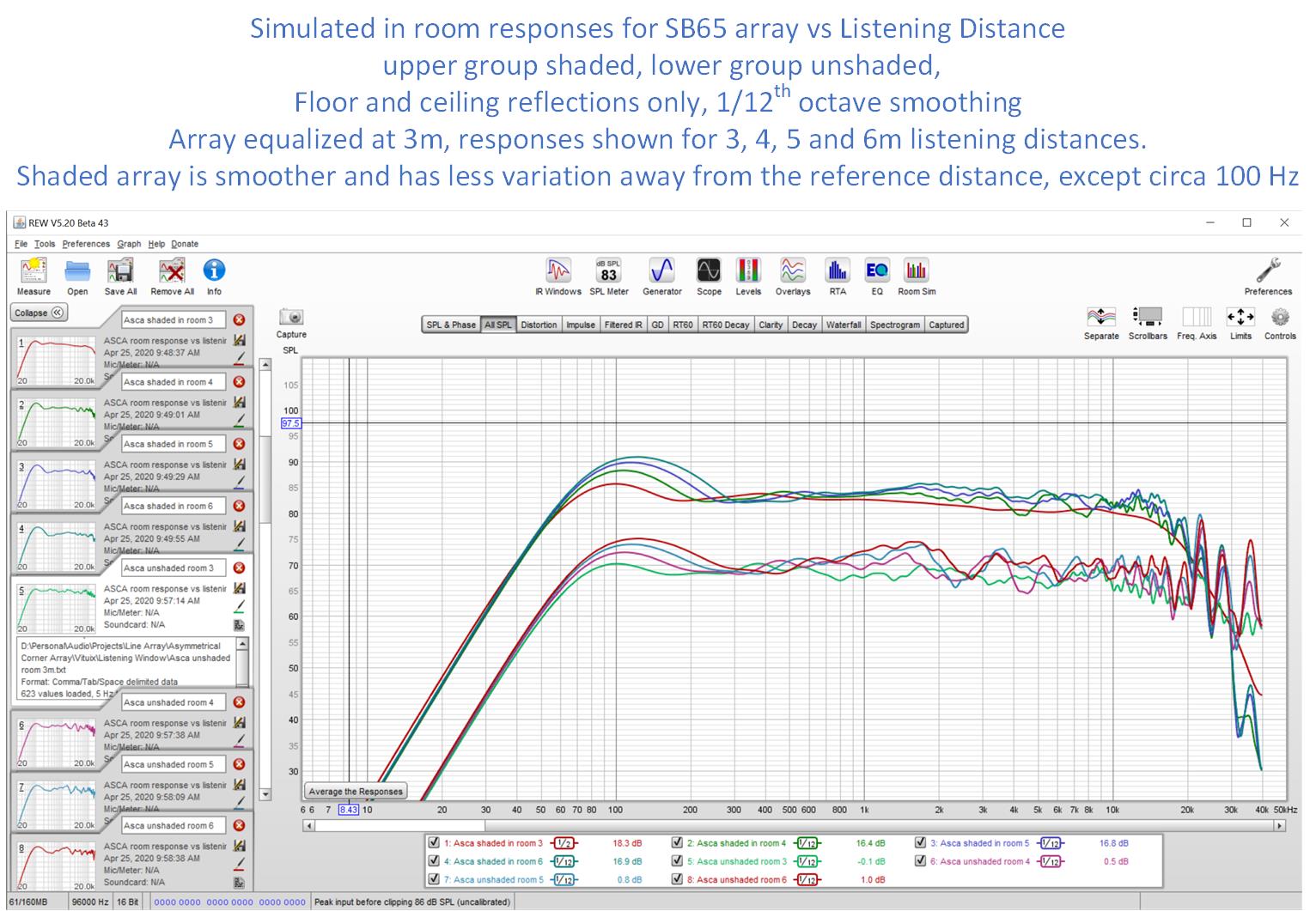

After I completed simulation models for both shaded and unshaded SB65 arrays, Vituix produced these graphs:
attachment.php
My usage model is seated at around 3-4m distance with standing futher back in the room. Thus I set the vertical listening window to 10 degrees, which covers this difference in ear height front to back.
The reduced ripple in the top octave allows me to get a smoother equalization result there (although it may be difficult to fully duplicate this result with in room measuments (understatement)). I also reduced vertical sidelobes and consequently less of what I earlier termed ceiling splash.

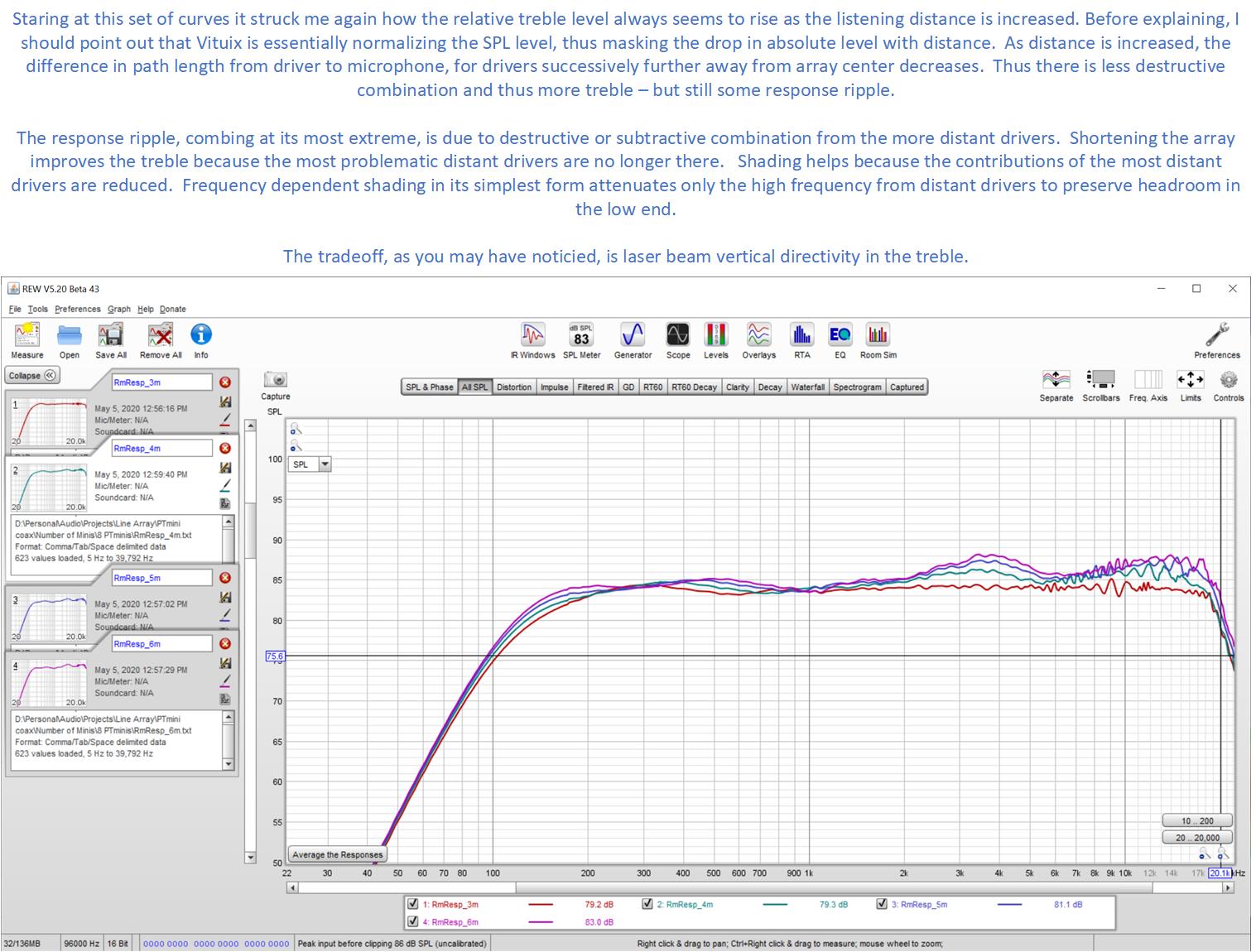

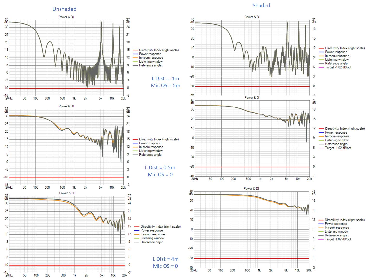

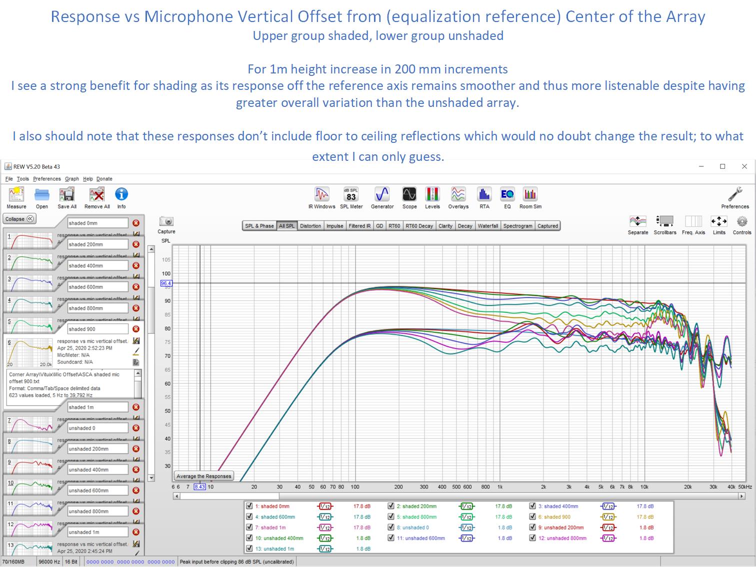

Next lets look at response variation with listening distance and then mic/ear height:
attachment.php
attachment.php

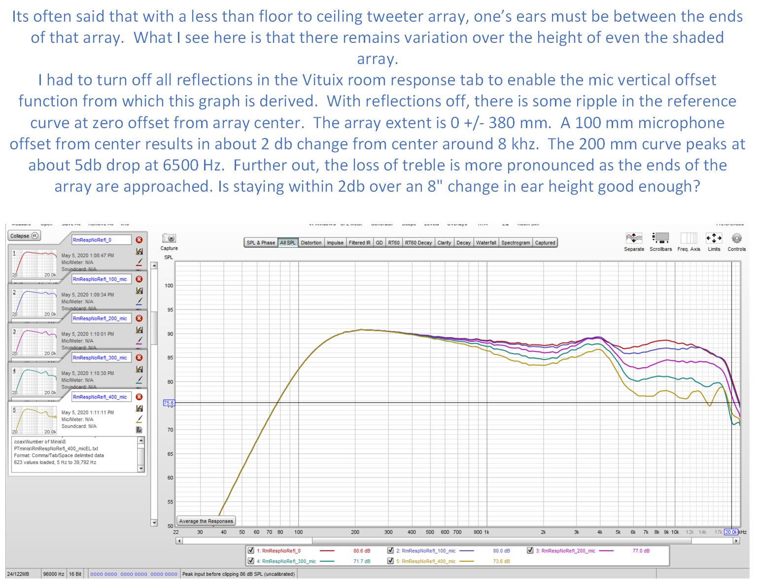

and finally those comb lines that cause so much concern but which disappear under smoothings that attempt to mimic human hearing:
attachment.php
For the shaded array at my primary listening distance, 2 db pk to pk ripple remains fom 12 khz up due to equalization limitations but there is only a single true combing null and that at 17.5 khz!
Several (many) of us have built unshaded floor to ceiling line arrays relying on floor to ceiling reflections to provide performance approaching that of an infinite line array. We've measured these in room and seen more variation that perhaps expected under the infinite line array model. Some of that is undoubtedly due to the room but a lot of it is due to the discrete nature of these arrays. If simulation can prove anything, its proven that shading a discrete line array can reduce that part of the positional variation.
If you have a single listening distance (e.g. multiple seats on a couch) then I think you can get away without shading. For any other situation, I think shading will have significant benefits.
Thanks for that analysis. Very interesting.
In my own investigations, I found that comb filtering was not an issue as long as you are at least 1.5 to 2 times away from the array as the length of the array. See posts beginning #127 here:
Corner Floor-to-Ceiling Line Array Using Vifa TC9
My conclusion was it was good enough without shading if you are far enough from the array. The summation starts becoming random at frequencies where the individual drivers are too big if you are far enough from the array. So, you don't get exact peaks and nulls because there are too many drivers.
Apart from the combing, however, my recent investigations with dedicated tweeters have shown that there is definite improvement to be had with a dedicated tweeter. In keeping in that vein, I want to experiment with an expanding array where the elements would roll off depending upon their distance from the center of the array. So, like shading, but instead of using resistors, it would be inductors. The outermost elements would roll off earlier and only two elements would be operating before the crossover to a single tweeter.
Hi Ra7:
My conclusions are consistent with yours. For a single listening distance of at least 3m or so, comb filtering isn't a problem and thus no shading needed. I didn't state the "at least 3m explicitly" but that should be apparent from my simulations as well as from your measurements and my use of 3m as the equalization reference.

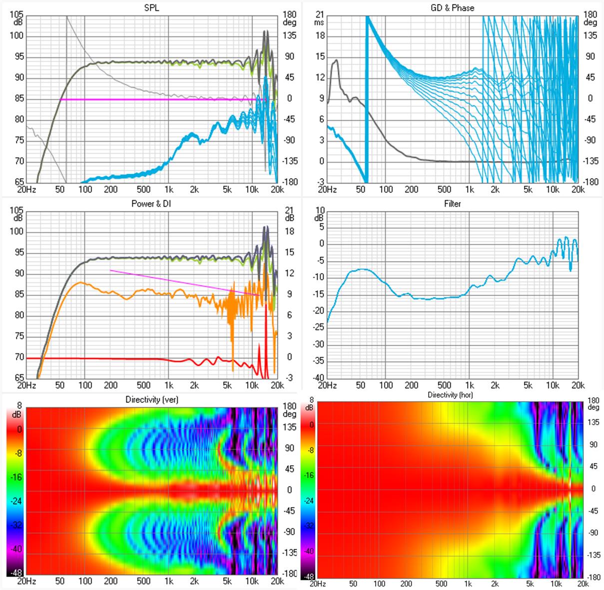

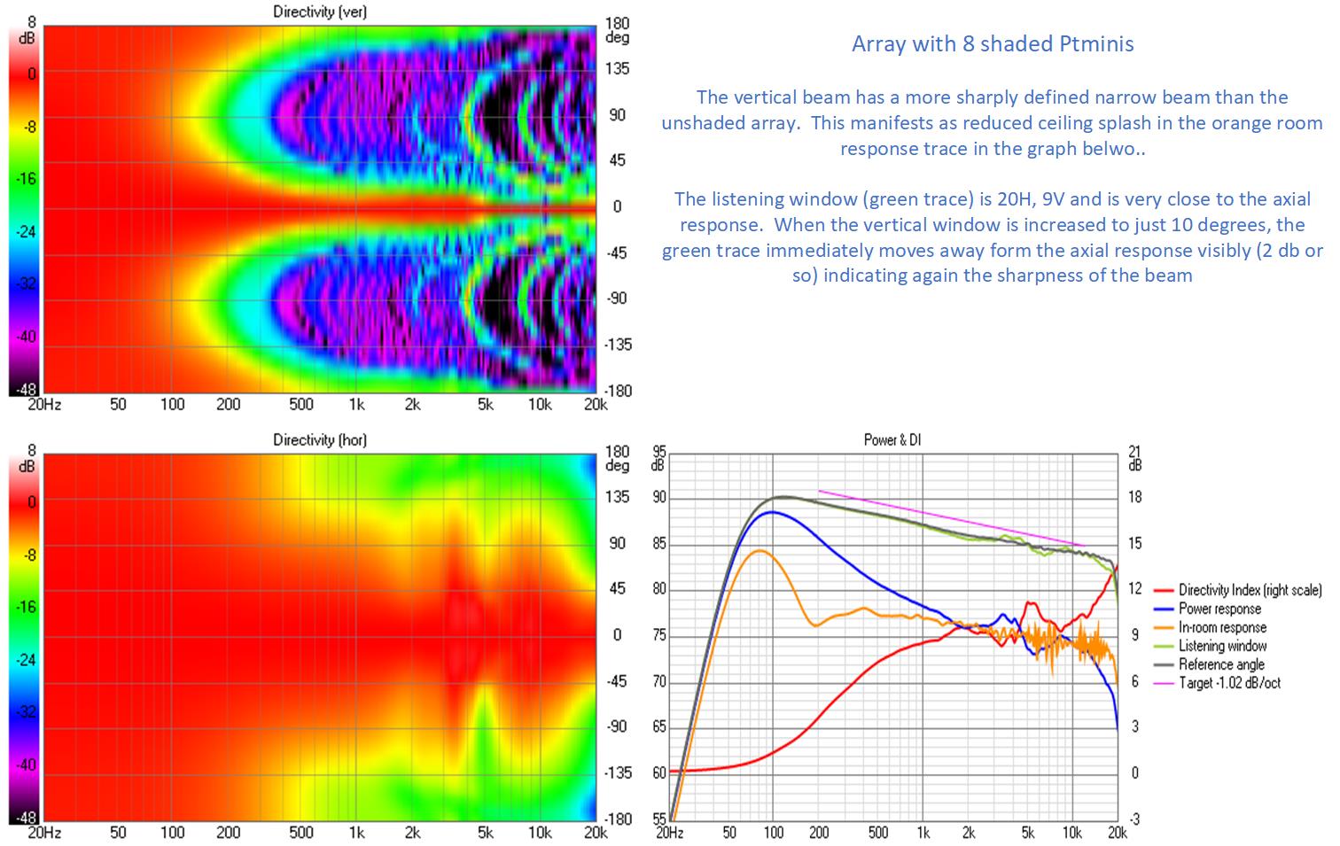

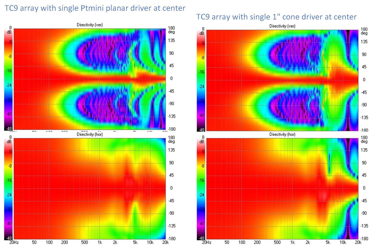

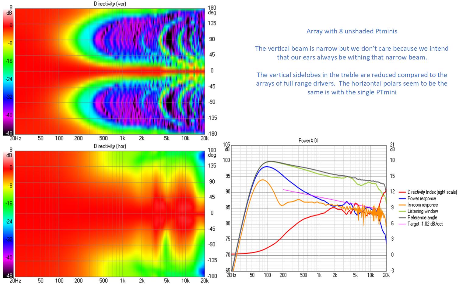

We had a brief discussion a few days ago about an array with a central tweeter. I did a sim of my developing PTmini coax array with a central tweeter as a quick experiment.
I repeated it with the planar mini replaced with a 1" full range driver acting as a tweeter.
attachment.php
The thing you can say about the planar tweeter at center is that the vertical beam is very narrow. The tweeter would need to be at ear height and
a single tweeter would be too restrictive, head position wise. So how tall should the planar tweeter array be. More sims required to answer that question.
The 1" driver has a comfortably wider beam and a 3/4" tweeter would be wider still but then there is an abrupt change of polar shape at crossover. So the goal of the frequency weighted array would be to match to that directivity. Doing so with first order filters (e.g. inductors) brings time delay into the picture so that the frequency weighted array likely has some similarity to a CBT.
There is also a narrowing and an asymmetry of the horizontal polars at crossover. I think the asymmetry traces back to the tweeter being on one side of the woorer. The narrowing doesn't appear serious to me - its still 90 degrees wide and can thus fill a room from a corner. It might even be too wide for a small room. The TC9 array's horizontal directivity comes from playing through a slot that is 22mm wide. I could not go any narrower without restricting the bandwidth. The slot could be wider...

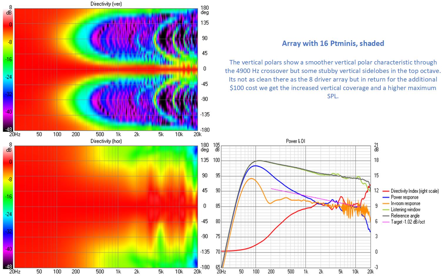

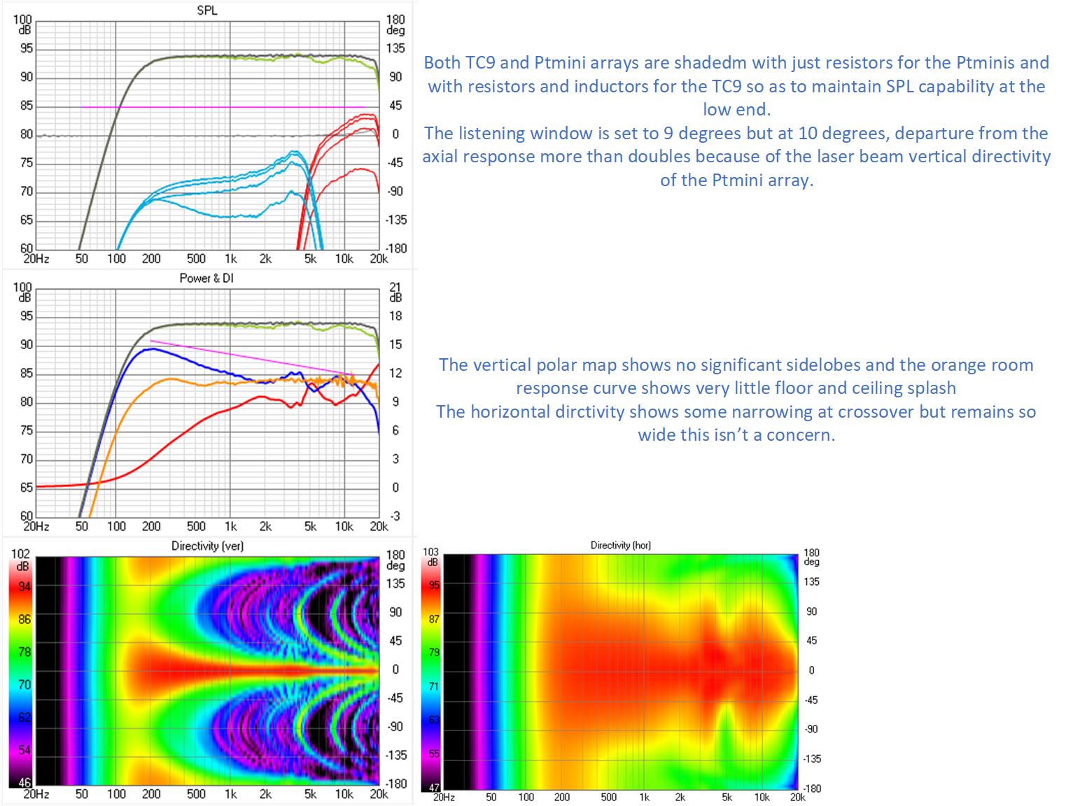

I think the very minimum planar tweeter height is 12" to cover the difference between sitting erect and sitting reclined. But that brings in concerns about how far the tweeter array will remain in nearfield and leaves little margin. 8 drivers gives an array height of just over two feet. Lets take a look at that:
attachment.php
Shading reduces the vertical sidelobes and resulting ceiling splash further at the cost of 3 resistors:
attachment.php
With 12 drivers, leaving off approximately 13" at top and bottom of the nearly floor to ceiling array we could cover sitting through standing ear height. I opted in the sim at least for 16 drivers for more margin at the high end:
attachment.php
So the shorter array gives a cleaner top octave but the longer one has more SPL and wider vertical coverage. The former isn't unexpected - contributions from more distant tweeter elements usually don't help at high frequencies. One doesn't need to accept the tradeoff; one can make tweeter length configurable.
The question about tweeter array height can be made more simply and quickly looking at point source simulation results:
attachment.php
The frequency response ripple in these graphs is entirely due to destructive combination from the more distant drivers. This slide clearly says that the shorter the array the better, at least in that respect.
Now put that 8 tweeter array coaxial with an equal number TC9s, extend the TC9s to floor and almost ceiling and equalize:
attachment.php
What are the consequences of that short tweeter array. I'll have to check how far away it will remain in the nearfield but first let's look at the response vs listening distance:
attachment.php
I hope the text on the slide wasn't too much of an eye test. To summarize, it says that at longer distances we get less delta path length from drivers progressively further out on the array and its that delta path length that is the root of all evil in the treble.
The remaining bugaboo is the vertical directivity. As the next slide shows, one will want the center of this short treble array within a couple of inches of ear height.

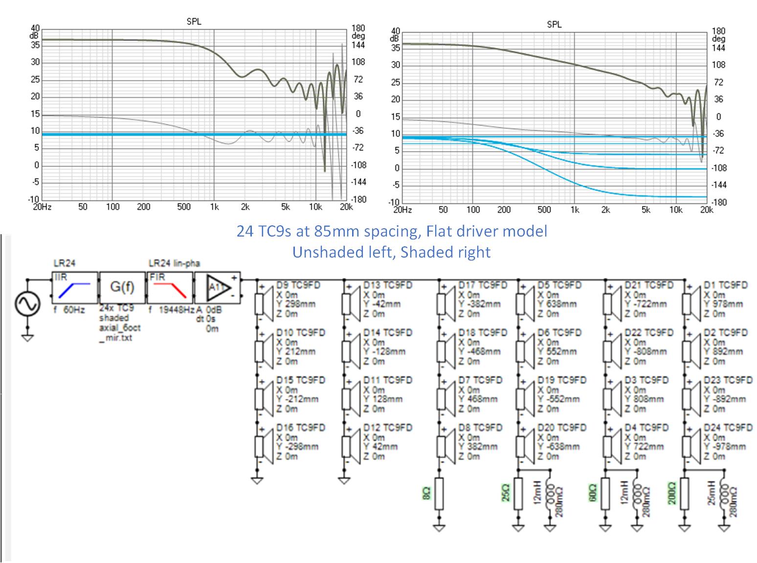

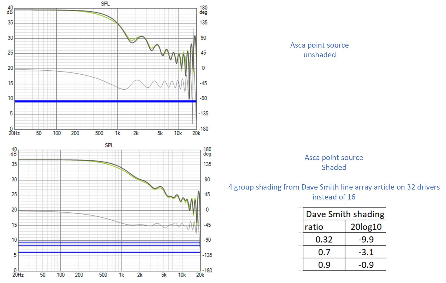

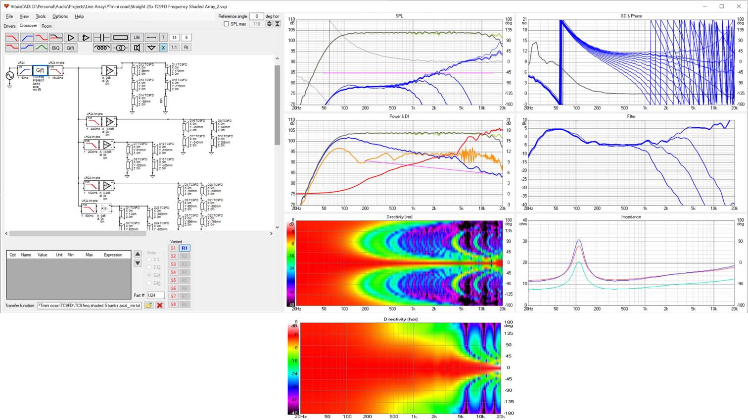

Shading TC9 Arrays
Given the large number of TC9 arrays in the world, it would be remiss of me not to explore shading them.
The simplest shading uses resistor weighting to reduce contributions of distant elements then parallels resistors with inductors to get back the displacement capability at the low end of the frequency range:
attachment.php
This simple shading reduces the frequency response ripple but doesn't eliminate it. Full simulation results for shaded and unshaded follow:
attachment.php
the above is unshaded, below is shaded:
attachment.php

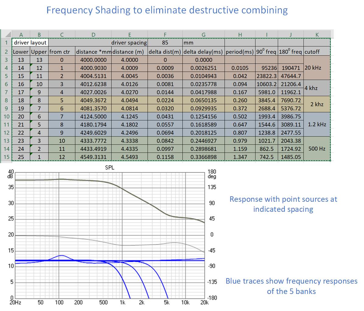

attachment.php
As I see it , you are going to loose a lot of sensitivity this way. Maybe the cure is worse than the illness?
The loss without the inductors is something like 2.7 db. With them you get all but a couple of tenths of a db back at the low end where you might need it without subs. To some that might matter, not to me, but hang on - a better shading algorithm is coming.
