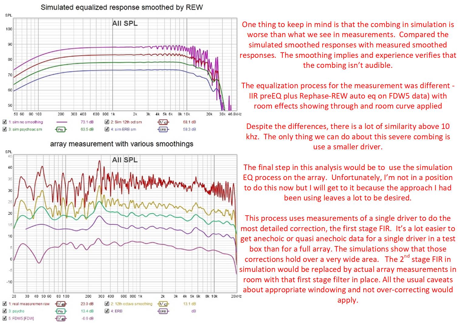

Well its been a long time since I posted. Since then I've moved and haven't gotten the arrays back up. To keep myself busy lately I've been doing some simulation/analysis and a couple of paper designs i may never build.
I would like to share some of this so here goes

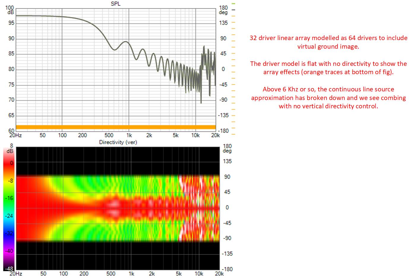

We are left with at least two questions:
what about that combing; is it audible?
would this equalization method work as well in practice as it does in simulation?
Well I too don't believe the combing is audible but I can't help thinking the SQ would be better without it - so I'm going to take another look at CBT and at smaller drivers.
As to the eq method, I'm excited to try it. My old method of laborious manual pre-eq followed by Rephase REW semi-auto-EQ took way too long and didn't work as well as I would like. This method with a detailed driver eq on data one has taken special care to ensure the cleanliness thereof followed by a room eq of the full array shows a lot of promise.

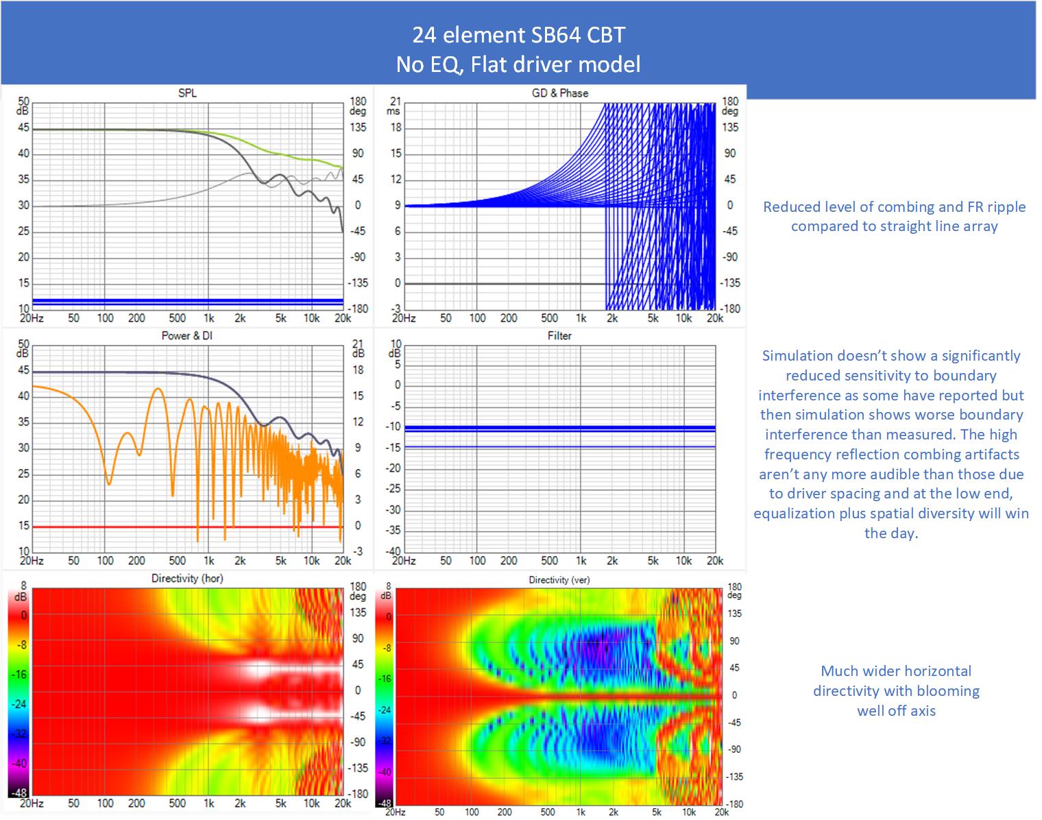

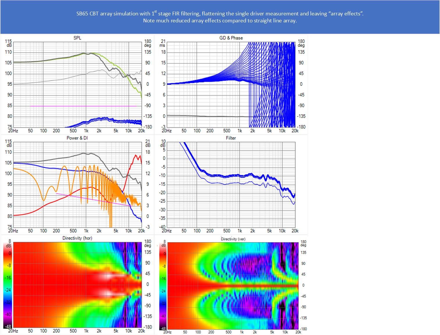

The next several posts will go through same set of slides but for a 24 element CBT. Surprisingly, the CBT simulation doesn't show that "wildness" in the top octave that we see in the straight line array. As a result, equalization at the high end is much simpler (and as regards, DRC has no apparent need for tunable windowing there). You may recall that Jim Griffin just used the auto-EQ in his AVR for his CBT.
What the CBT does apparently suffer from is some peaking in the upper midrange/lower treble well off axis which may be addressable through weighting.

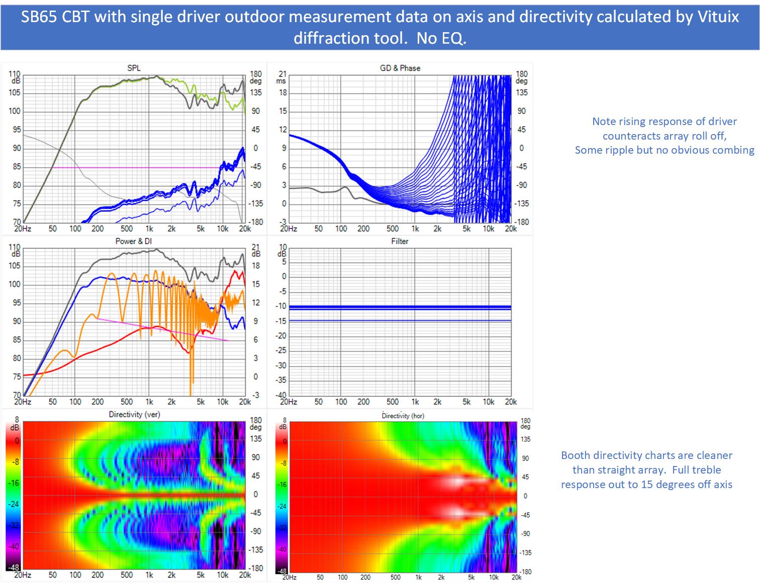

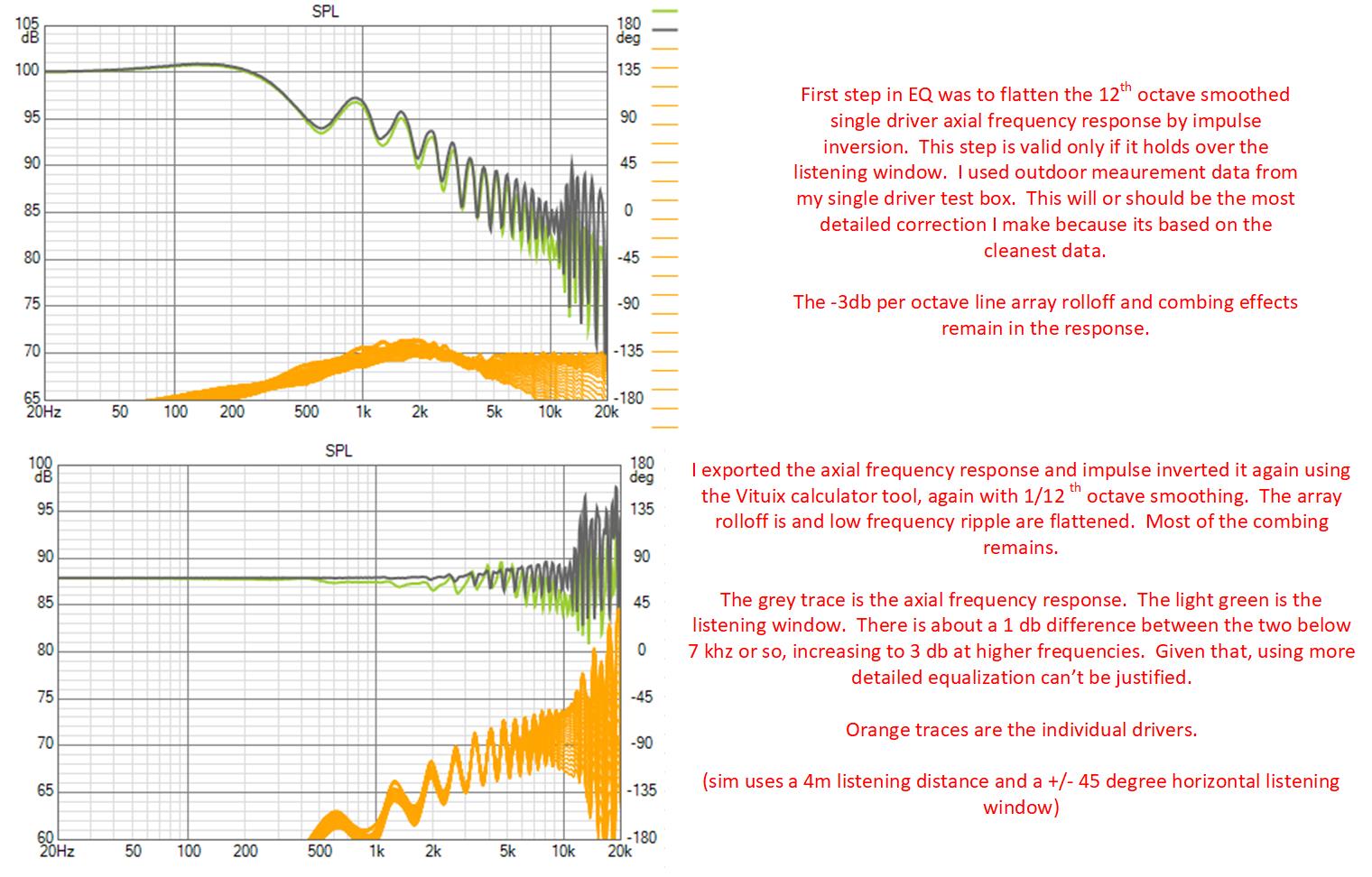

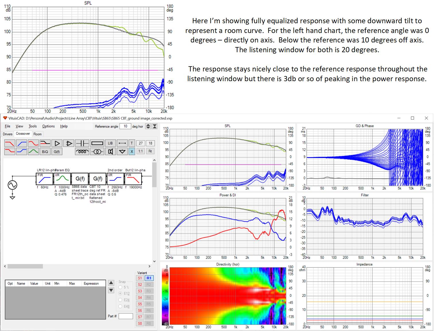

now for the first stage equalization. Take out the driver response variations and you are left with the array effects: roll off and ripple
Wow! The strong combing above 10 khz we saw with the same driver in a straight array doesn't appear here.
In fact, we could get pretty close to a finished result with an HF shelf filter and a couple of PEQs, but IR inversion with the appropriate windowing will get there quicker and more accurately ( or a shelf plus DRC, which also does IR inversion with sophisticated FDW)

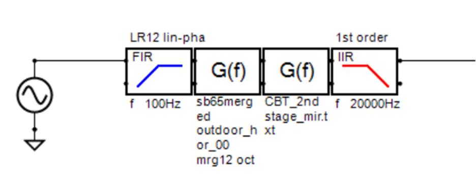

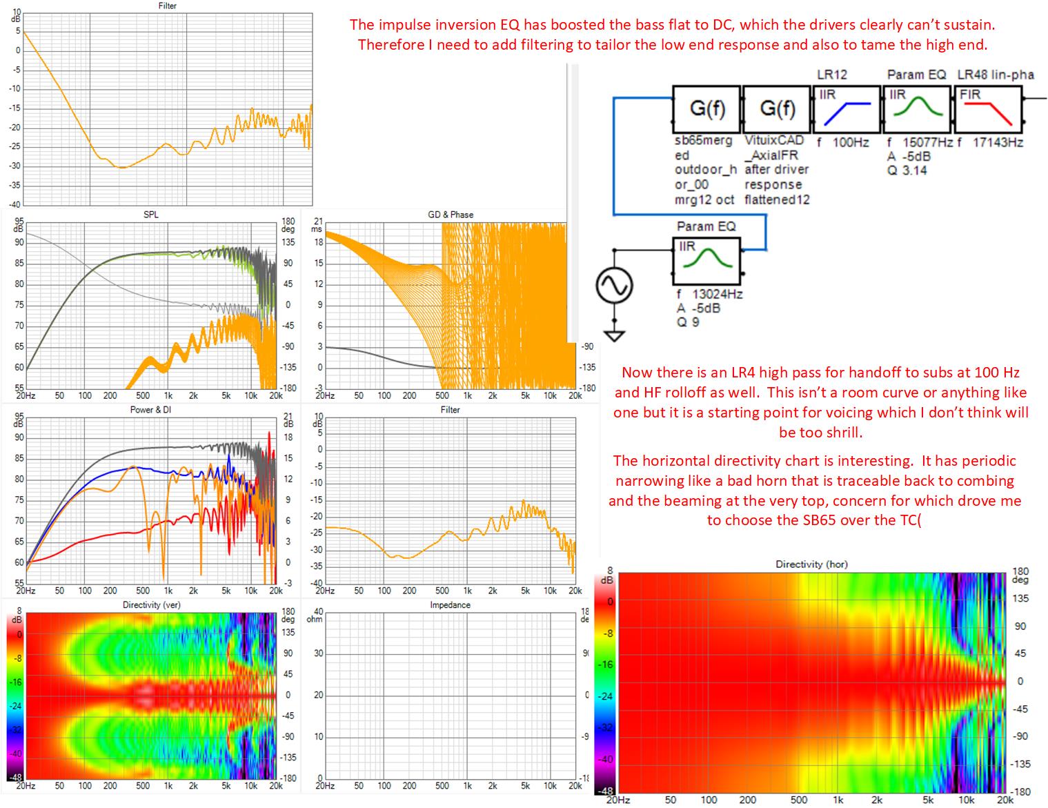

2nd stage IR inversion EQ with response shaping on both ends of the spectrum
The listening window is set to +/-20 degrees to avoid the upper midrange blooming that has been mentioned. Next post I'll show responses for wider windows.
This is the all the eq I'm using but that is because there is no room to contend with:
that final LPF should be higher order...

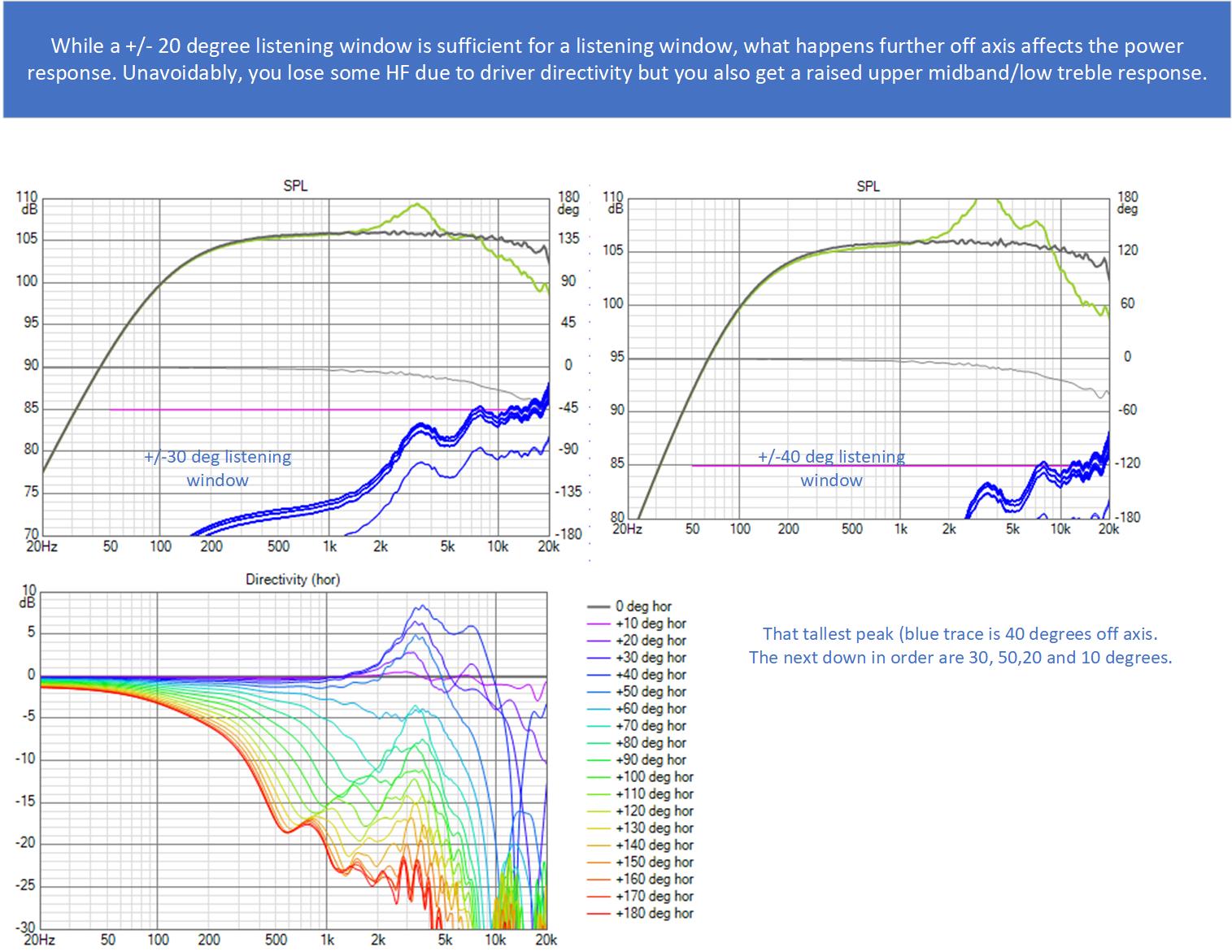

a look further off axis...
Do we really care what happens so far off axis? Probably not at home but perhaps we would at a live music event if our CBT could play loud enough for pro sound use. I've played with the weights enough to know I can improve the off axis response at least incrementally. Strangely, adding delays to the outermost drivers had a significant effect.

I would say that yes we do, if targeted treatment is used then those sort of bad behaviours may not affect the outcome but if left unchecked they will have a negative consequence.Do we really care what happens so far off axis?
What I like less in your CBT simulation is that the Power and DI seems pretty good before the single driver EQ but it gets some pronounced peaks when equalized flat on axis. That is something I would be wanting to avoid.

Yes I don't like the power and DI peaking, which are manifestation of the off axis upper mid range "blooming". But thanks for pointing that out because looking at those curves is a good way to judge the impact of that effect. So far that is the only negative I've found for CBT.
I didn't start down this path looking for an alternative to DRC. I just wanted to use simulation to better understand array behavior where the continuous line source approximation has broken down. The equalization was a quick a surprisingly clean way to get to a finished simulation. I got excited about it and I got excited about the CBT looking so much cleaner than a straight line array in other aspects.
But your are right on with your scientific repeatable recipe. I want one also. The well measured single driver measurement flattening filter, followed by the array effects undoing filter, followed by filters to tailor the rolloff at each end of the spectrum. Any mismatch between that and an in-room measurement has to be due to the room, right? To some degree perhaps if you have high enough resolution directivity for that single driver, which I don't. But I do wonder how close it will come.
I believe what you and Ron say about it even while I can't help but believe there has to be not a better way but a different equally good way more compatible with the way I think. You guys have the track records and demonstrated success.

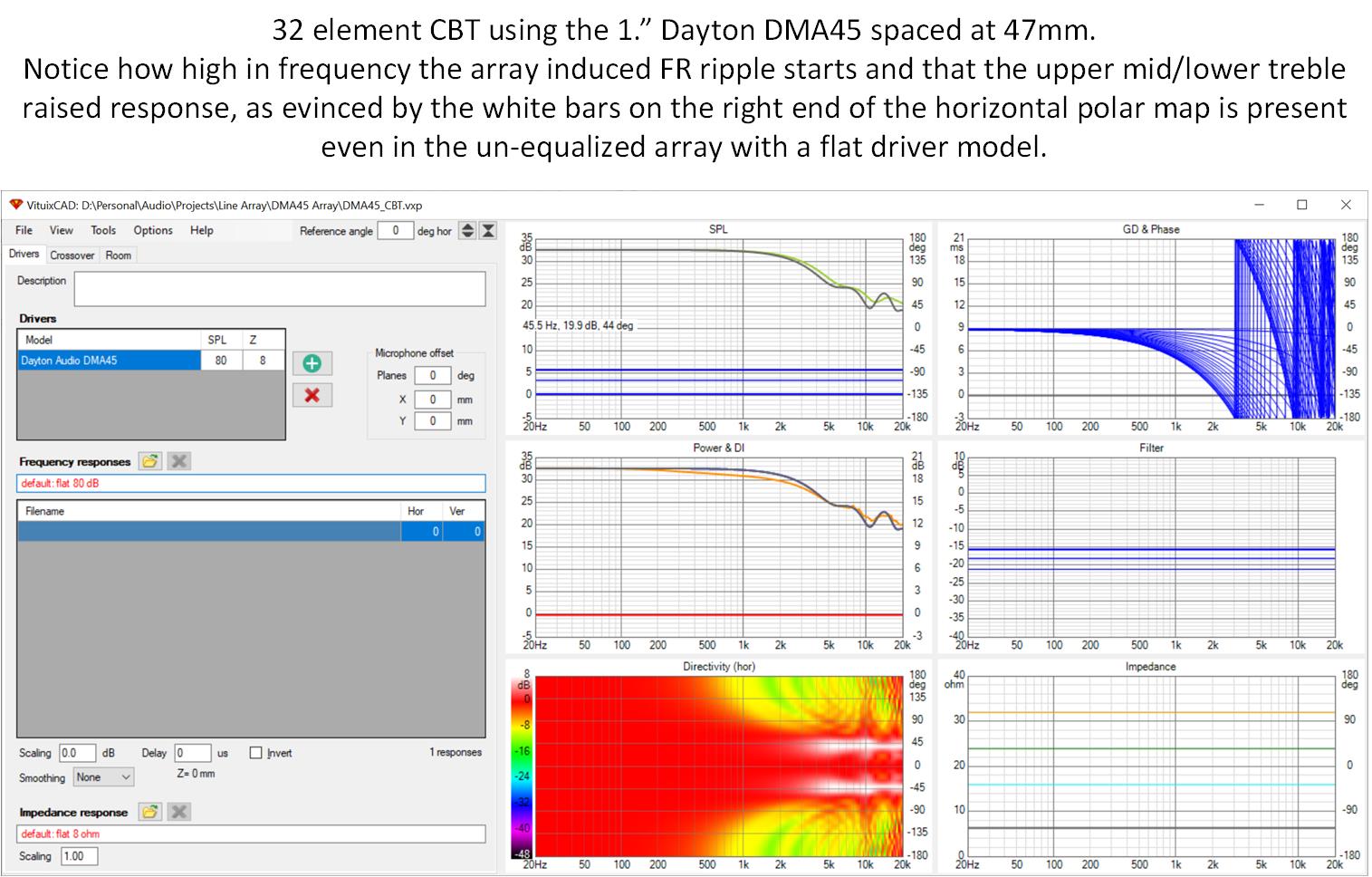

It didn't take long to see that the raised upper mid, lower treble response off axis is a result of equalization to flatten the array effect frequency response ripple. One can see this ripple and the blooming in the horizontal polar map in these CBTs even with no equalization at all.
Going to the smaller Dayton DMA45 driver reduces this effect and pushes it higher in frequency and so that is where I'm going to concentrate my efforts.

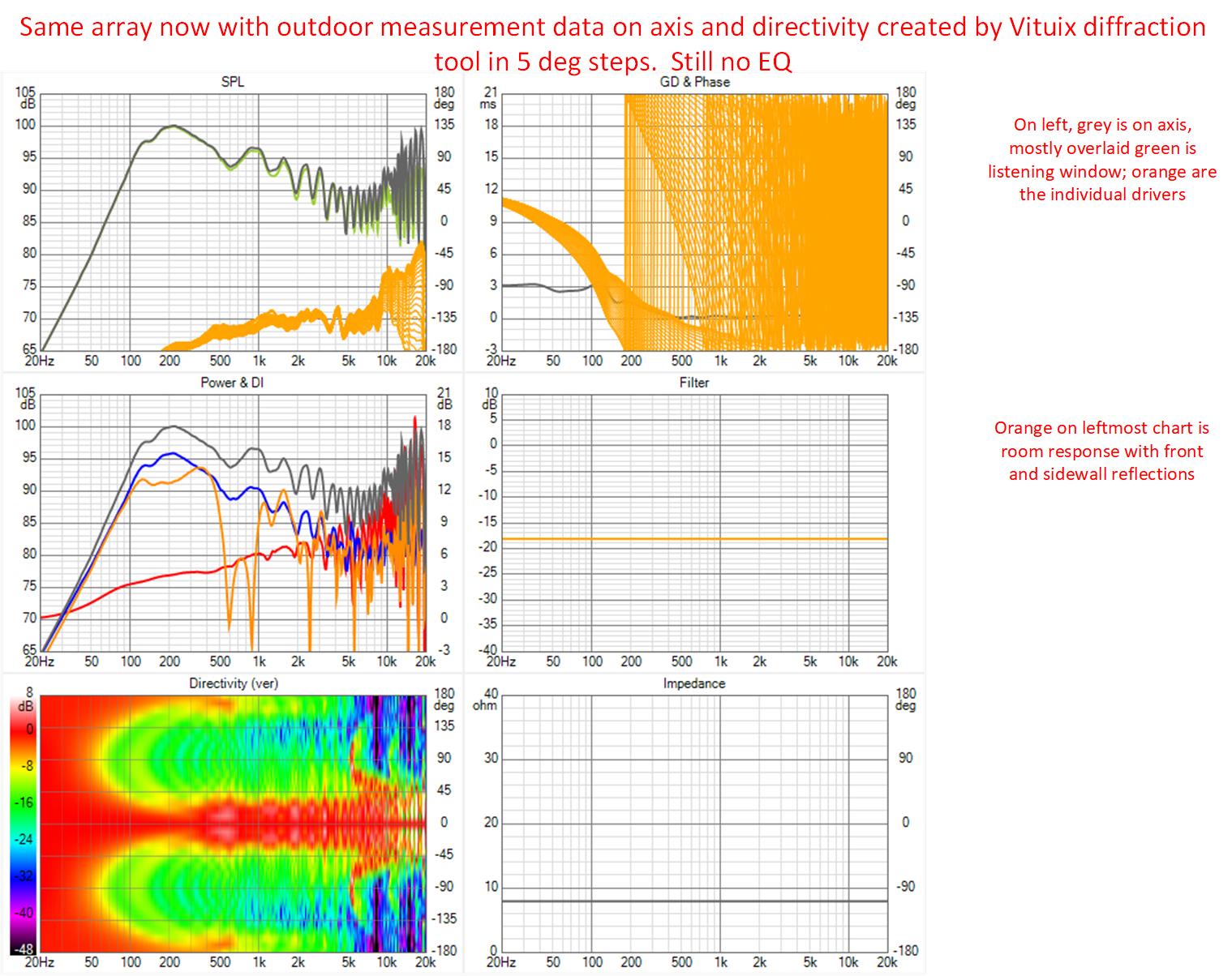

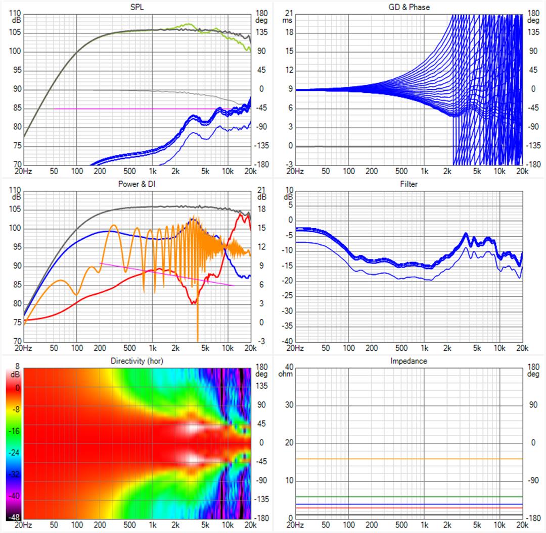

Before going ahead with DMA45, here is the best I was able to do with the SB65 CBT
If I were doing this in the real world instead of simulation, I might never notice that peak in the power response and would think I had done exceptionally well based on the frequency response measurements alone. I would notice a potential problem if I took detailed polars. Listening tests might or might not confirm a problem based on level of room treatment and thus ratio of direct to reflected power and how delayed the reflections are.
In simulation, we can equalize on that direct wave that is so difficult to isolate in the real world but too much of that can be a mistake even if the corrections hold over an adequately wide listening window. In the real world, we can choose to allow more or less of the reflected energy into our equalizer depending on the window used. I guess that is where DRC excels given its sophisticated FDW. But I think that so long as these peaked off axis reflections are delayed enough not to be early reflections, they will be outside any reasonable FDW window.
And far off axis reflections are going to bounce off the near side wall, where presumably one has treatment for early reflections. That might be enough to preclude audibility of this peaked off axis response.
But like fluid says the array in room never responds quite like one would expect...
