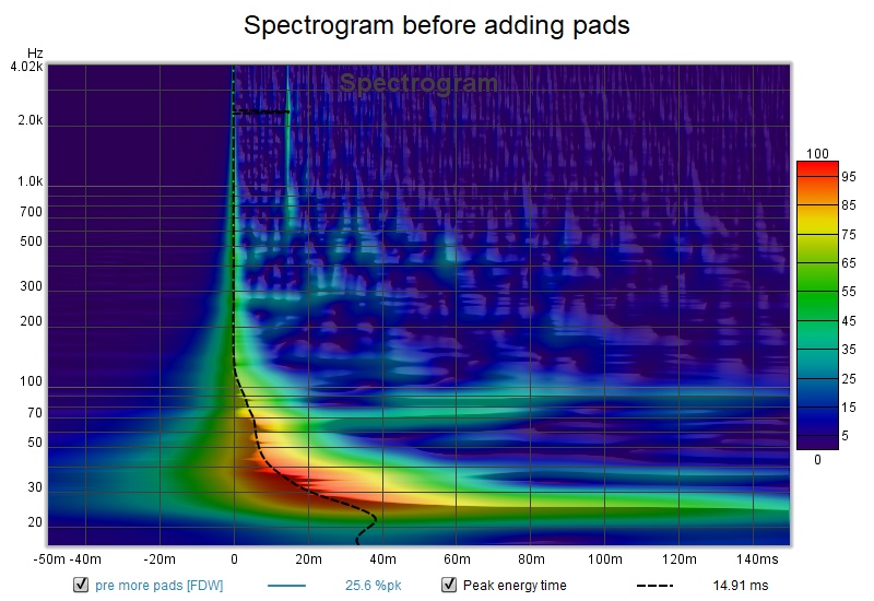

How should I be spending my time? I thought it was best to tame the room before doing anything else so I bought a bale of 9 6.5" thick fiberglass batts 23"x93". My plan was to build conventional absorber panes. After building the first one, I just started folding batts in half paper side out and stuffing them on shelves around the room. Spectrograms (un-normalized) show marked improvement:
Here is how it looked before I started:
Here is after a tentative first step with just 4 of the 9 batts in place
and finally with all 9 batts in place mostly on the back wall
Amazing what one roll or bale can do. Now to pretty and finalize the installation. But before that a re-eq to take advantage of the improvements

Nice work!
You are doing exactly the right thing imo/ime....solving acoustic problems acoustically.
I wish everyone spent more time separating speaker tuning from room tuning.
Gives greatly superior results than lumping them into one tuning basket, ....again imo/ime.

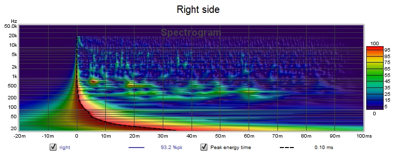

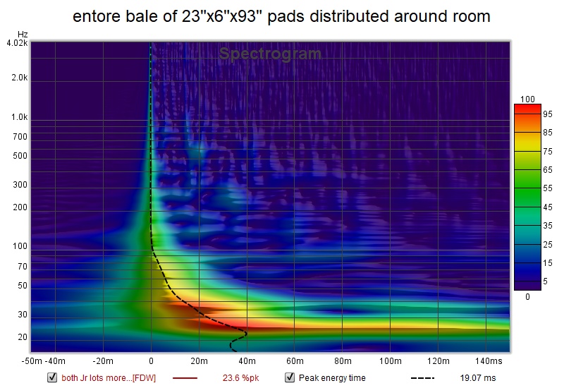

funny how that works. suppressed more of the room and now I get to a listenable eq with fewer PEQs. didn't even need FIR or auto EQ.
but I also found I'm not done yet. I still have some sub 10 ms reflections to track down. They don't show up in the spectrum of both sides playing together but you can see the effects in the individual speaker responses.
also the echos die out in under 200 ms now vs 500 ms or so before

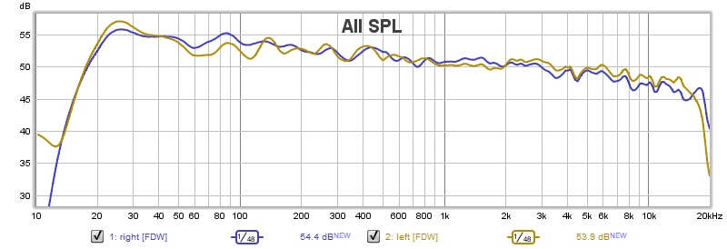

I don't have the ears to do a detailed critique but its getting there. Some tracks are really striking. Above 1 khz seems to be free of the room and with the right taper sounds really good. I think I've got the bass level about right this time. The imaging is good but I think will improve with more room treatment.
Try some DSP on what you have right now, just to get a taste. It is a game changer...
You've got reasonable clean output up to 15 ms, the DRC will help focus it. I've got your back, I'm home again.

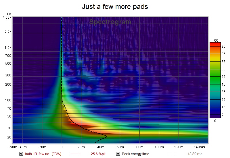

Well, a couple of days without working on FIR/DSP but I did make another absorber panel and re-arrange some of my loose fiberglass batts for a small reduction in not very late reflections.

But it also brings up question as to what I should correct manually. By playing with time gates in IR windows of REW, I see that my FR ripples around 200 Hz are due to reflections arriving at delays of 8-12 ms. FDW5, which I have been using for manual EQ, doesn't exclude them. Most of my effort last couple of days has been to try and eliminate them.

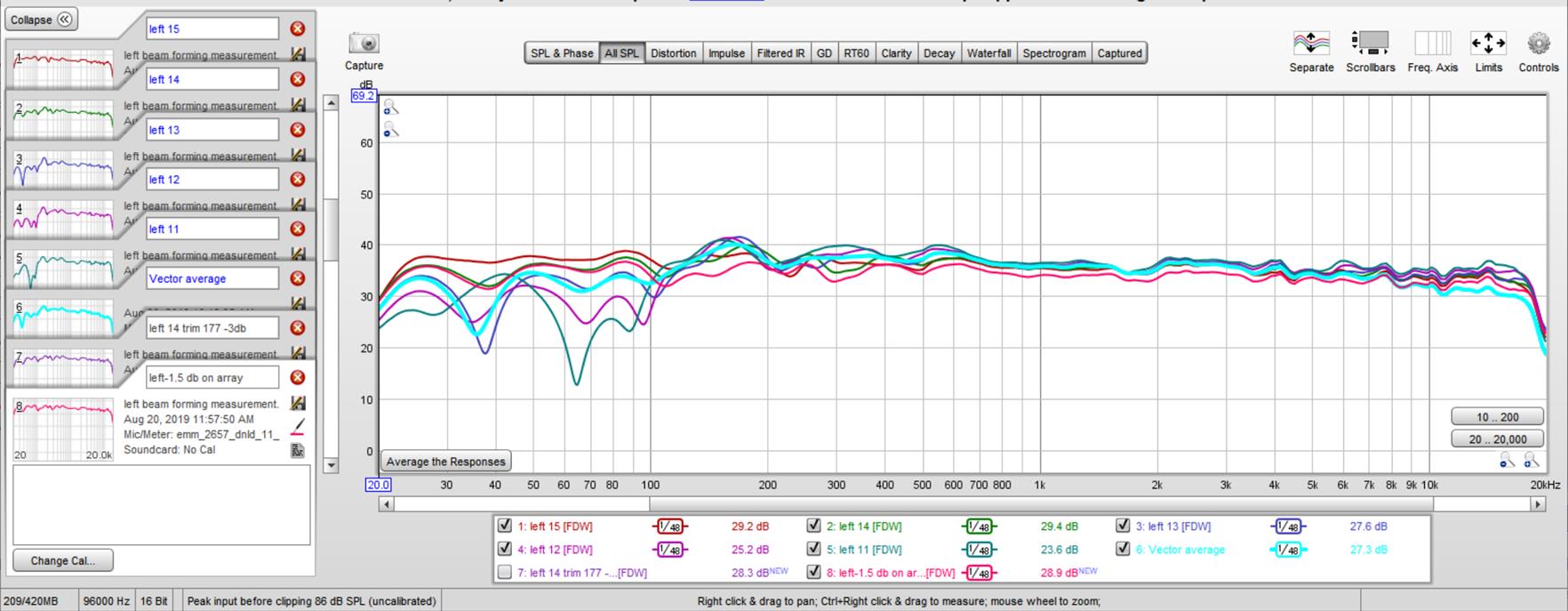

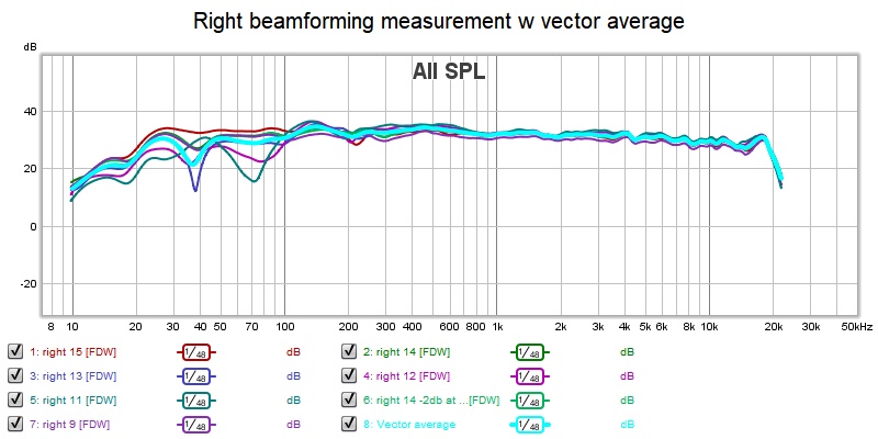

fluid had prompted me to try beamforming measurements some time ago. I knew he was right and so eventually I did. I took a series of measurements at 1 foot intervals along a line from my primary LP to the center of the array. This was with my miniDSP manual EQ but no FIR.
I have flat bass below 100 Hz at the primary LP which isn't surprising since that is how I equalized it. As I move in towards the array, room effects increasingly show up. They are the greatest below 100 Hz and taper off in the 100-1000 Hz region.
Its striking how highly correlated the diverse measurements are above 1 khz. This suggests I can do a fine grained equaliztion in this region at least along this line. That needs to be confirmed by measurements at other angles.
Apologies for the 20 db scale of the drawing. REW's choice, not mine.

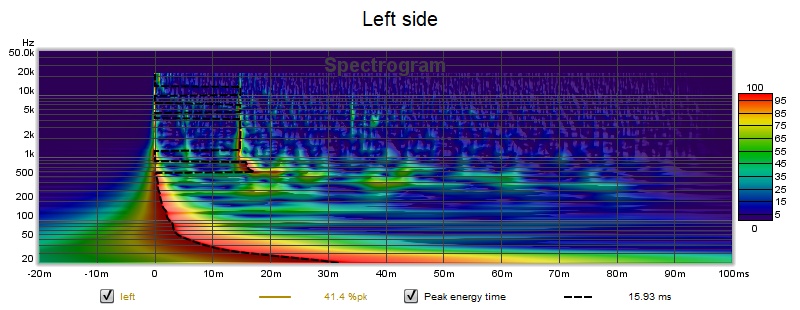

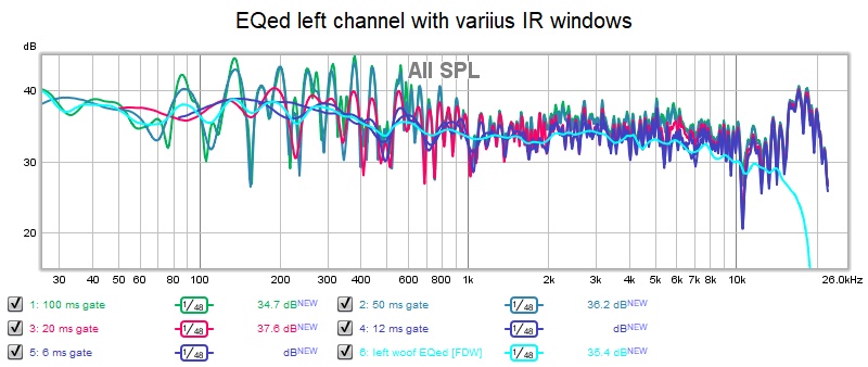

For completeness, I should post the left.

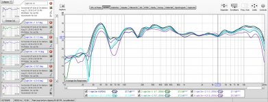

This channel has more room in it. The spectrogram shows a 15 ms delayed reflection affecting 100 to 1000 Hz. With that delay, I don't want to over react to it. But, as you can see in the bottom two measurements I increased the attenuation I already had on the peak at 177 hz and I dropped the level of the array by 1.5 db. This is what I'm listening to now.

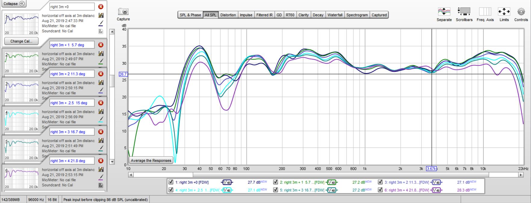

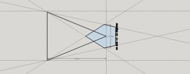

The horizontal off axis measurement had a number of things to tell me. I took this data at 3m distance from the right array, on its axis and then moved to the right in 1 foot steps, about 5.7 degrees per step. This put me well out into the room.
A different bass equalization is needed in this region. I wonder if more woofers would help. I have them to deploy.
I see the PEQ attenuation I have at 177 Hz hurts the response out there in the room to almost the same extent it helps closer to the wall.

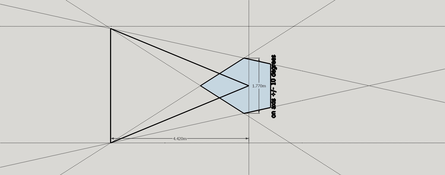

Above about 7 khz, I see the treble falling off per the dispersion characteristics of the driver. Response can be equalized nicely flat within a +/- 11 degree off axis listening window. Outside that window it falls off rapidly. I need to point the arrays at the primary LP and re-equalize.
This will give me this listening triangle with flat HF response over an almost 6' wide area. (pity my hearing won't allow me to appreciate it fully)
(blue polygon is within +/- 10 degrees of on axis)
