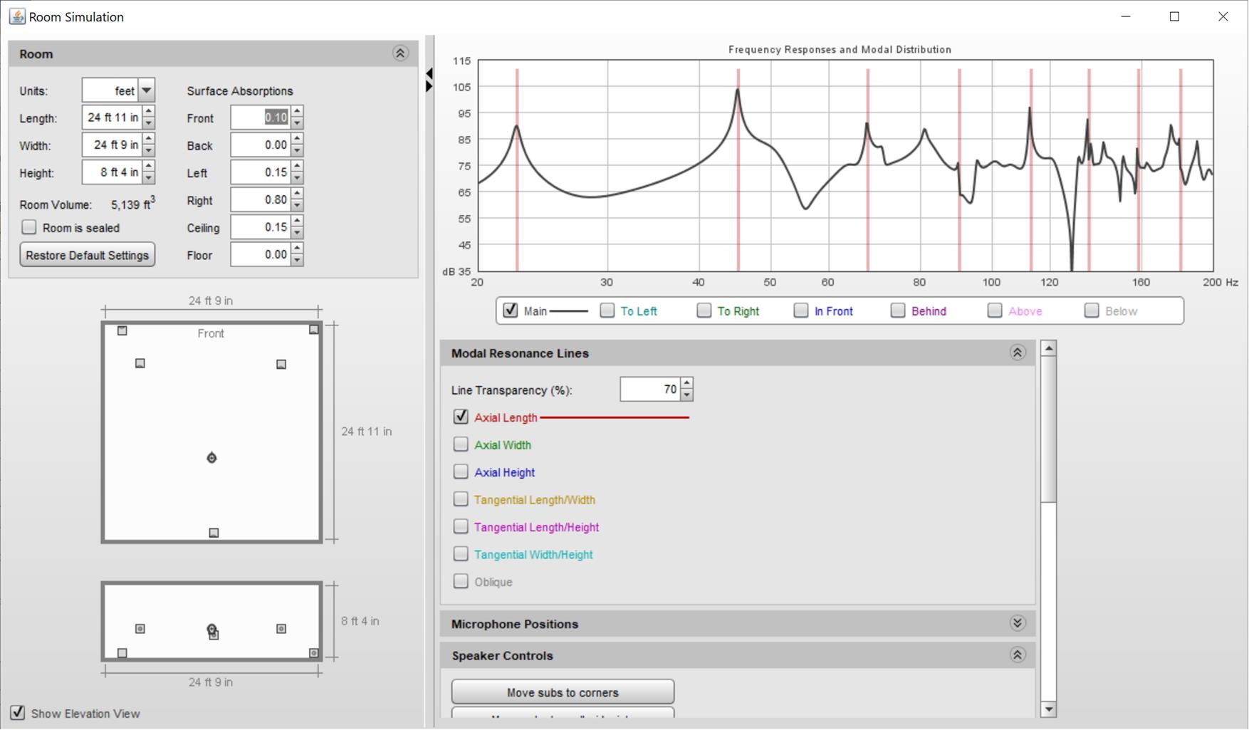

Looks like your listening height is close to ½ of the room - difficult considering first vertical mode. Movable panels do practically nothing for bass either. Make other of solid side walls to work as bass trap - fake board-wall with at least 2' of loose stuffing with insulation wool. There is no height enough to do the same for ceiling...
I like this simulator - you can add several subs and adjust height of speakers and mic
hunecke.de | Loudspeakers Calculator
Thanks for the link; been wishing for a room response simulator better than REW's.

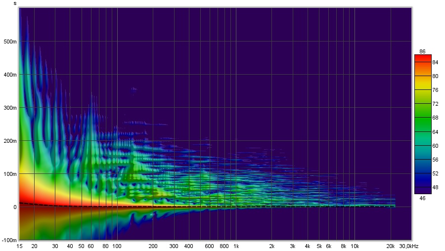

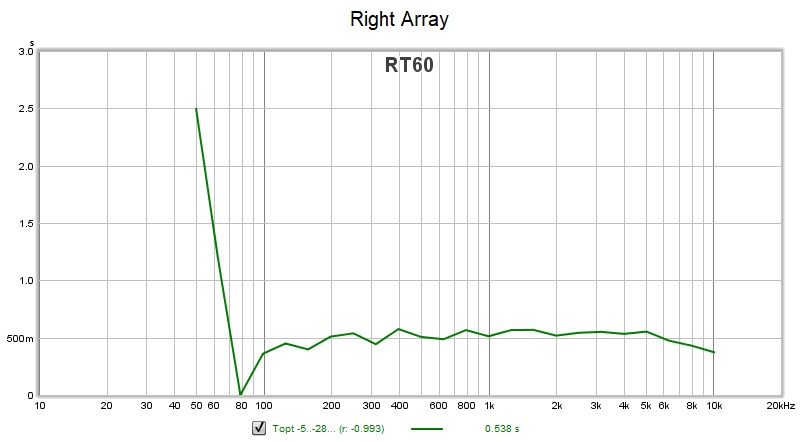

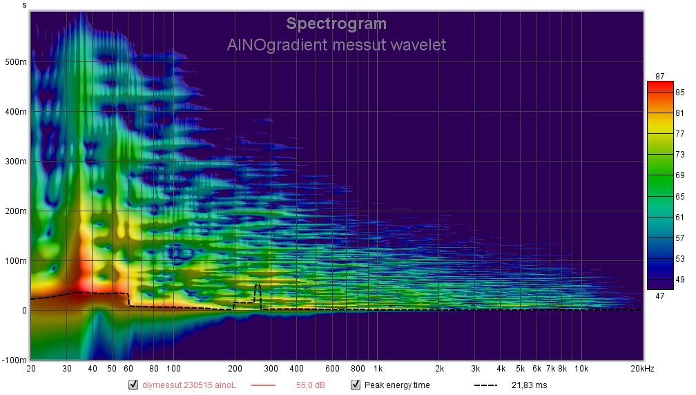

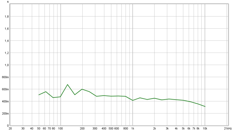

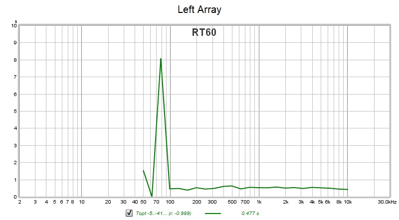

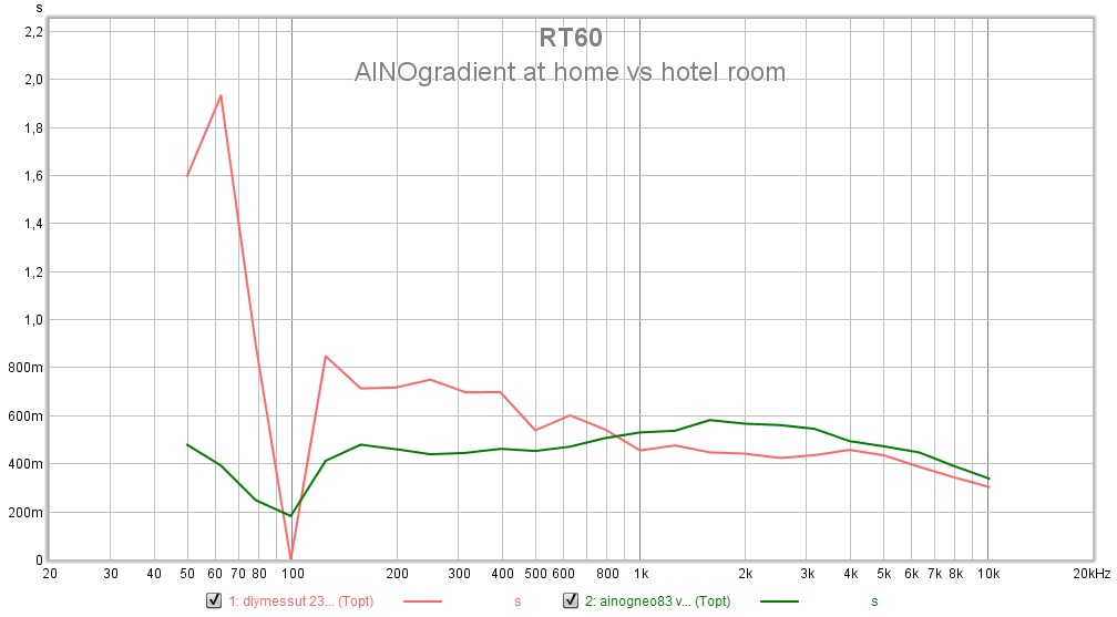

Have you looked at RT60 values? In my home downstairs has block walls and upstairs has wood frame with plasterboad, also inner walls with insulation and outer walls are 1' thick (Scandinavia you know...)
Here is RT and wavelet of my room and a hotel room with concrete walls.

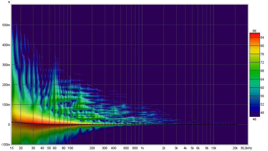

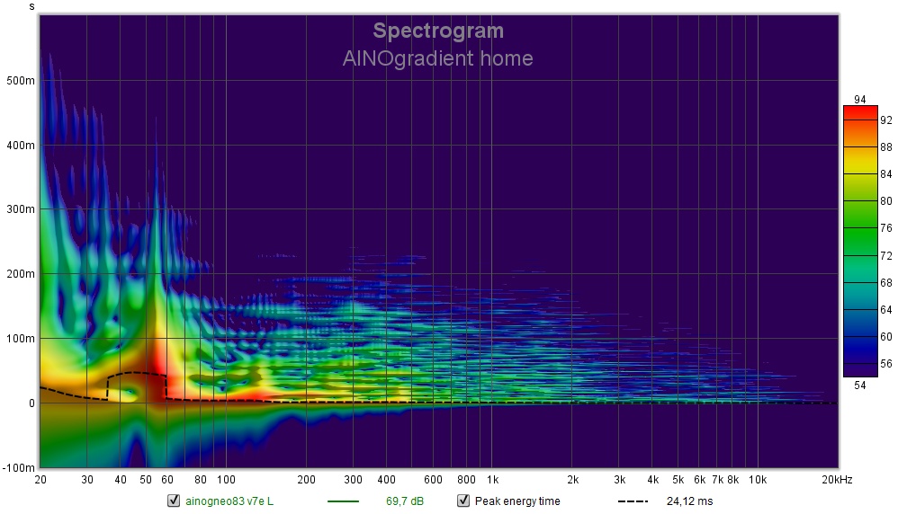

In designing my damping panels I had 3 primary inputs I concentrated on. The IR to determine where I needed panels. RT60 to see where the excess energy was. I also made FR graphs that showed a filtered frequency response (smoothed with psy filter at that time), filtered to start at 50 ms out to 500 to, again determine the area where I had excess energy. In my room it was clearly down to at least ~200 Hz, which made me decide to have a thickness of 3" fiberglass insulation (covered on both sides with wool felt) on the side walls, with an air gap between panel and wall. The one behind the listener is 2" thickness and disguised as a poster. Again using wool felt on both sides and a little air gap behind the panel (only about a cm here as it would look strange otherwise).

Tight enough bass? I do believe so. I could never have got there without the damping panels. I still have plans to improve on overall performance with the addition of a couple of subs.

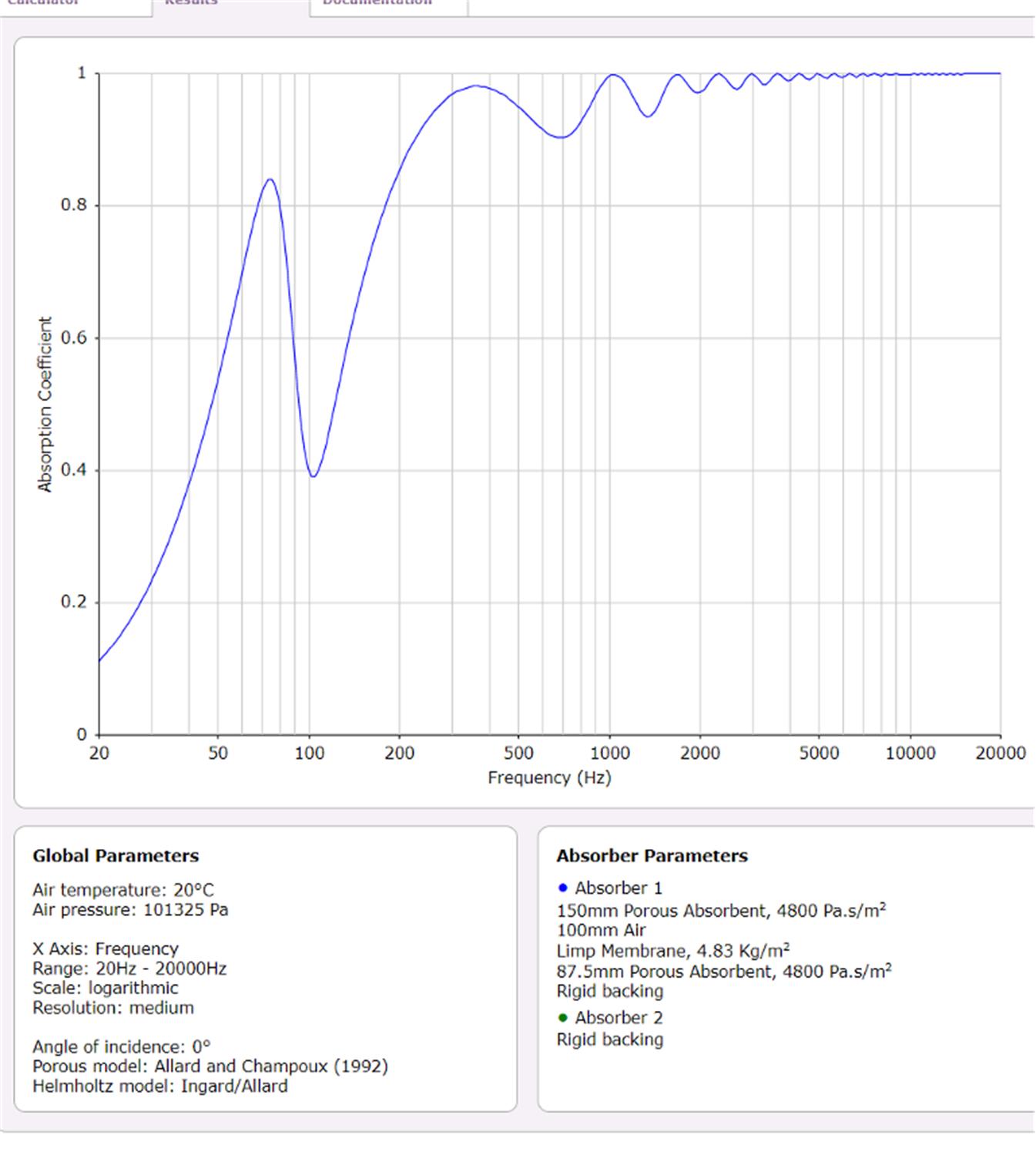

Last night I was looking at limp membrane trap that can be tuned to 70 hz. Apparently, per multi layer absorber calculator I can incorporatea porous absorber in front of the membrane and get tuned as well as broadband absorption but with a gap
such a thing would be about 14" thick and could go beside or behind the array in place of the marginally effective panels I have there now. I would hate to have to line an entire wall with these.

My guess would be both corners behind the arrays or the corners of the opposite wall. I would check though, what the arrays do by themselves RT60 wise. Easier to whip something up with the fluffy kind of fiberglass isolation. I'd go for simple panels on first reflection points, stuffing the corner with a bit more material (if possible).

re designing traps - I'm learning. the online calculators give me likely false confidence. Problem is the resonant traps are very narrow band so more opportunity for "experimentation".

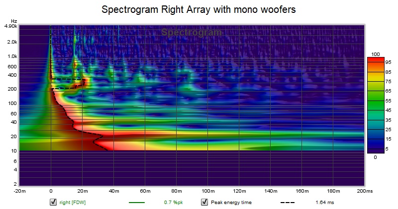

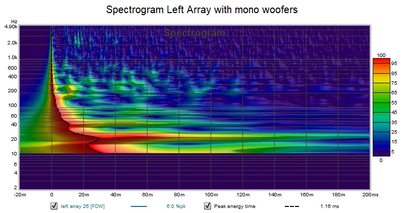

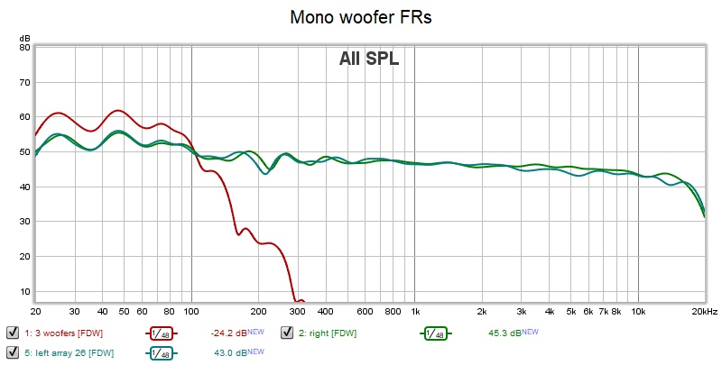

So here is that frequency response with mono woofers, rear channel inverted and delayed 9 ns.
are here are the spectrograms
So the big difference was moving panels from rear wall to beside the left array but we still need more. Issues still apparent in the spectrogram.
These are good enough I'm encouraged to try DRC but its fighting back.
Delaying the sub sounds logical. Phase rev effect is controversial but most likely necessary. Crossover freq and 1 octave around is most critical. The problem is what happens to other frequencies...
