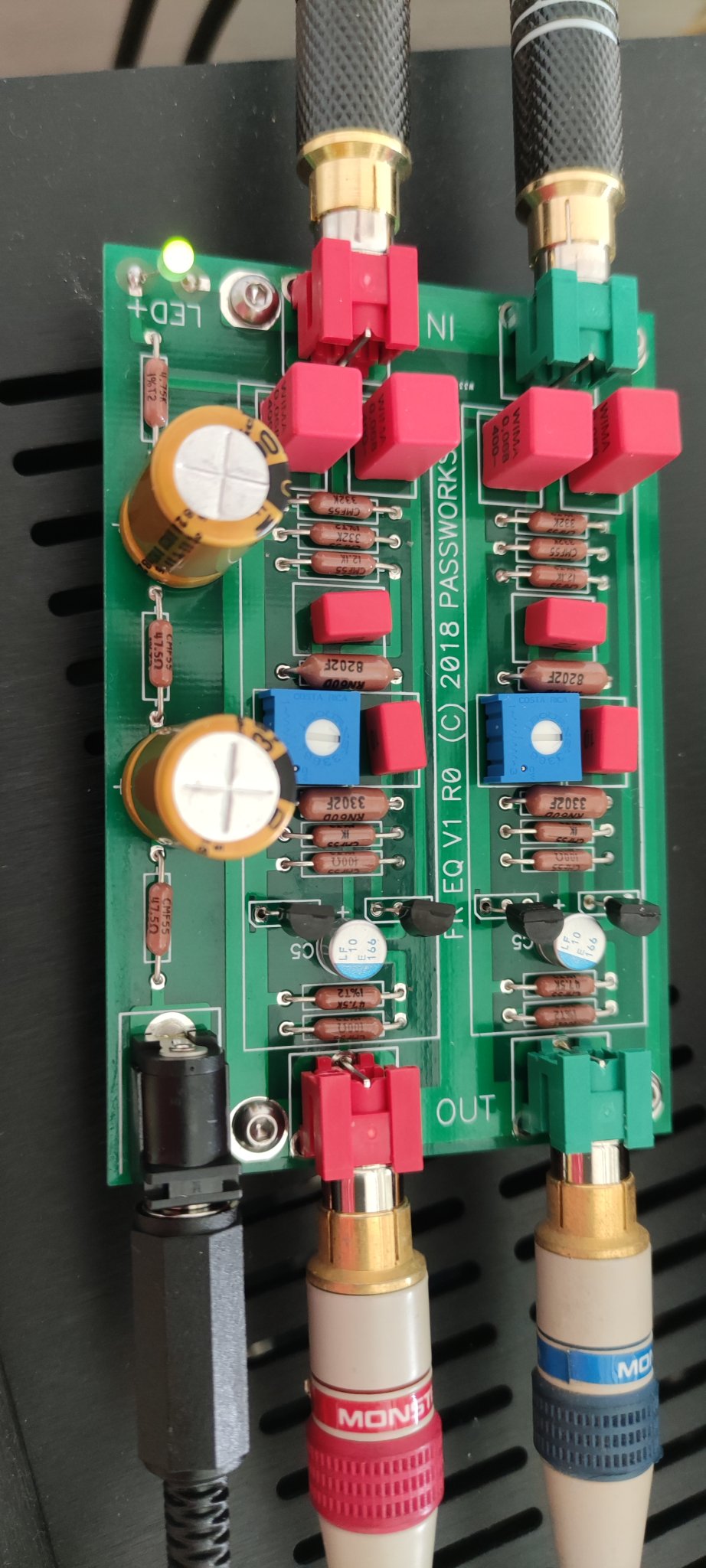

Timely post!, I finished assembling my filter yesterday and was ready to powertest it and the connectors did not match. With a little work it became clear that the connector on the power supply was not big enough to take the center pin on the pcb jack. I checked all the part numbers and the datasheets and everything said 5.5 x 2.5, but the connector on the cable from the wallwart was 2.1. Everything matched the post from Nelson earlier in this thread and the info on the ACA mini. It's as thought the specified switcher for this project needs an additional -xxx added to the part number.Pay attention to the pin diameter of the power input jack (post #62, CP-037B-ND). The center pin is 2.5 mm.
I ordered and got, very quickly, the right connector which is attached and the unit is working away fine.
Much tuning and experimentation to come.
Check yours, the cable end connector, not the board jack, when it arrives!

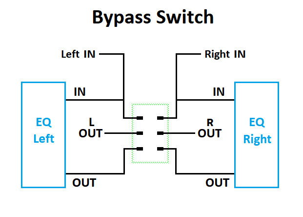

I want to add a bypass switch to do AB testing of the EQ - even if it's just in the beginning. Can someone please check if my wiring of a DPDT switch will work?

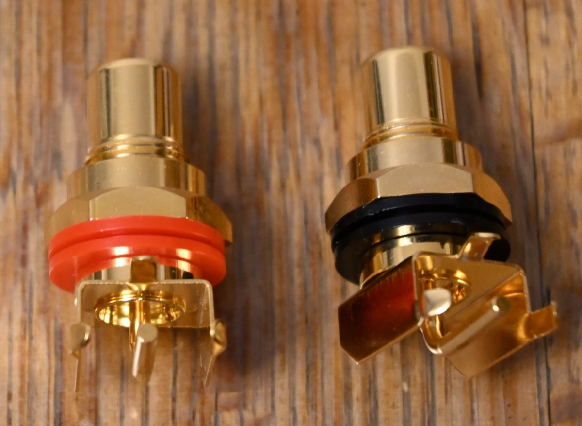

"Non cheapo" RCA PCB mount types exists. I got some by a mistake and just use them as standard chassis mount connectors.
I think you could get those to fit the PCB......more or less.....and then at same time have the RCA connector secured to the chassis which is nice. Then no stress will be on the solder joints.
The PCB mount RCA connectors used for SSII headphone amp are something in between. Rather cheap but made with two screw holes to secure connectors to chassis. The easy way is just to use normal chassis mount RCA connectors and use very short wires to the PCB. That would probably be my approach.
That's what I intend to do as well.The easy way is just to use normal chassis mount RCA connectors and use very short wires to the PCB. That would probably be my approach.
Very good 🙂
A nice thing with those "expensive" PCB mount RCA connectors I pictured is that you don't have to "fiddle" with the thin ring used for the gnd connection that only have electrical contact with pressure which is usually not very high (because of the plastic isolators (Neutrik types are an exception)). With those PCB mount types you have "direct" connections 🙂
