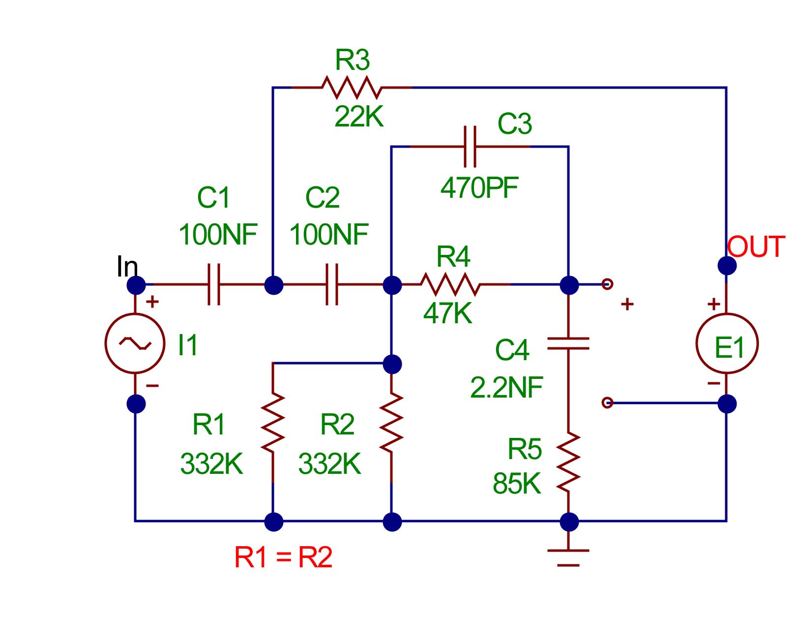

Thank you Nelson.It's possible, but some of the filters are quite variable with respect to resistor and cap values.

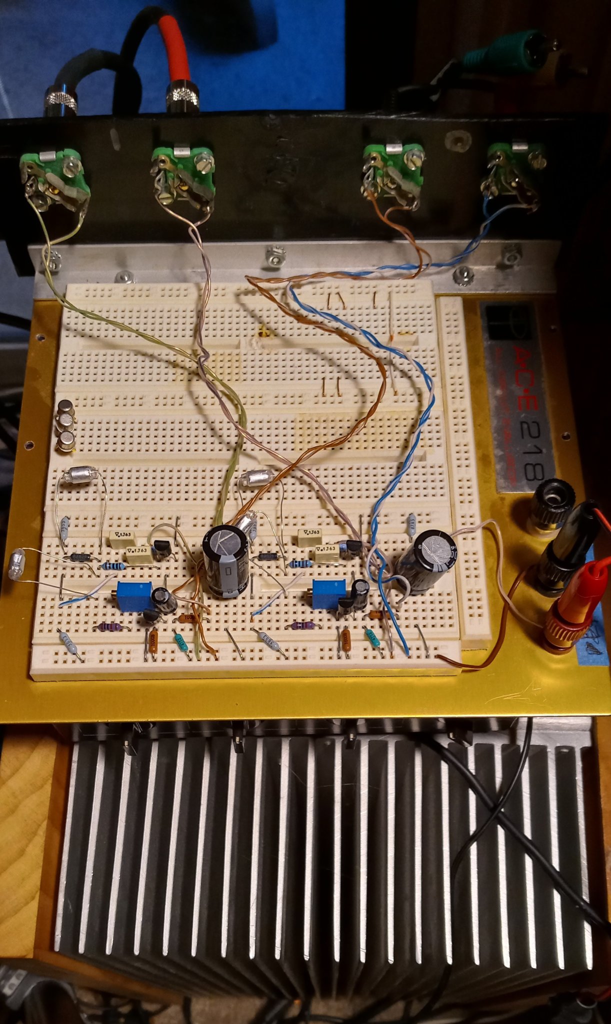

I cobbled the circuit together to fiddle with values until the PCBs arrive.

Simulating in LTSpice and looking at driver response curves.
For my Markaudio 12P's, it looked like the high filter caps at about 1000pF and reducing R5 to 10k would do the trick.
I left low filter with Pa's reference values.
I'm really liking the sound vs. my old passive baffle step correction. It was just a low pass filter. Detail without the harshness and enough bass.

This depends on your enclosure with regards to the bass EQ, so there is not a straight answer.Hi all, just order the kit and wonder if some one have the EQ value for Seas Exotic F8 ,4 Omh., so I can order the correct parts. Thanks in advance.
The reference curve in the article would be a good start for a sealed box with a few cubic feet,
and possibly open baffle.
On the top, you probably also want to start with the reference curve, as the upper mid on the Exotic
is a bit hot. Adjust to taste and see what you get.
