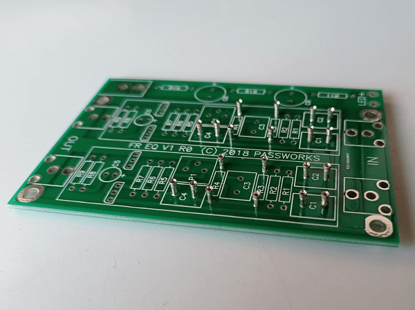

The female header pins that I installed for C1, C2, C4, R3 & R4 when I built the EQ makes it easy to quickly drop in new values. The other components don't make much difference, so I soldered in stock values there.

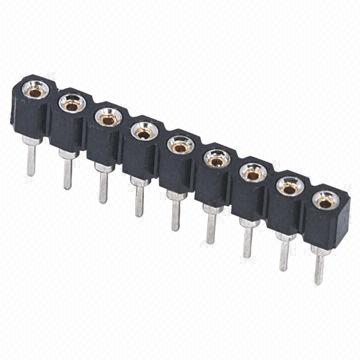

Part numbers would be most helpful for those header pins 🙂 Also tips for installing them. I have some that take the cap and resistor leads nicely, but the male pin diameter is a bit small, so getting it soldered while keeping it perpendicular to the board can be a challenge. I fully agree that your approach is the right one (I hate rework). I'm doing up my second filter soon, the first was fully standard and soldered directly.

Admittedly, it's not easy to solder these female header turrets after removing one from the plastic. I used small long nosed pliers to hold each one perpendicular to the board while soldering - and had to adjust a few after soldering.
I don't have a Mouser part number, because I got it from the local robotics store.
Yes, that looks like what I've used.
I like to use the sockets with wire wrap pins. If the square pin is too large for the hole, just use a jewelers file to knock down the corners to fit.
Much easier to keep the pins perpindicular to the PCB.
Mouser 855-D01-9952042
If you have the small pins as above, insert the component into socket before soldering. Only one dimension to staighten that way.

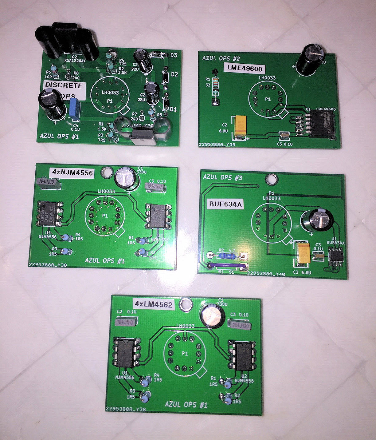

If you want to null the DC offset of the obsolete & unobtanium BUF-03, you'll need to lay out a brand new PCB which accommodates its TO-99 package and which includes a footprint for the DC offset trimmer potentiometer. I'd suggest you go ahead and spend the extra money to create a four layer PCB, so it will have an ultra low impedance ground network -- an important consideration when using video speed parts.
Perhaps you might consider also building a "BUF-03 emulator" daughter card, which plugs into a TO-99 socket and behaves exactly as a BUF-03 behaves, but is built using modern, widely available, low cost parts. Then during prototyping and testing, when something goes badly wrong: you destroy an easily replaceable emulator board instead of an irreplaceable BUF-03. I did this myself on the Azul HPA, exhibited at Burning Amp 2019. The obsolete and expensive LH0033 was socketed, and various cheapo emulator boards were built which plugged into that socket. It's mentioned in this post, I've copied the photo below.

Thank you Mark, I will check that link out later. I already have a PCB laid out for BUF-03 devices with DC nulling components, albeit just a two layer board (bottom layer is a ground plane) as I have used them to very good affect as the buffer stage to modify a passive attenuator (I'll resist using the term pre-amp). I'm in the lucky position of having half a dozen of them available. I use the BUF-03s in DIP8 sockets via adaptor PCBs.

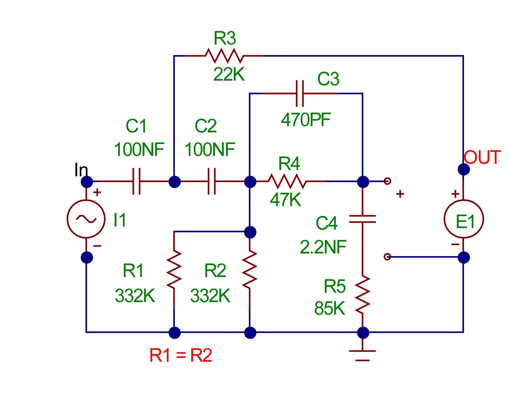

I guess the first step is to take Nelson's Micro-cap schematic, modify it and run some simulations.

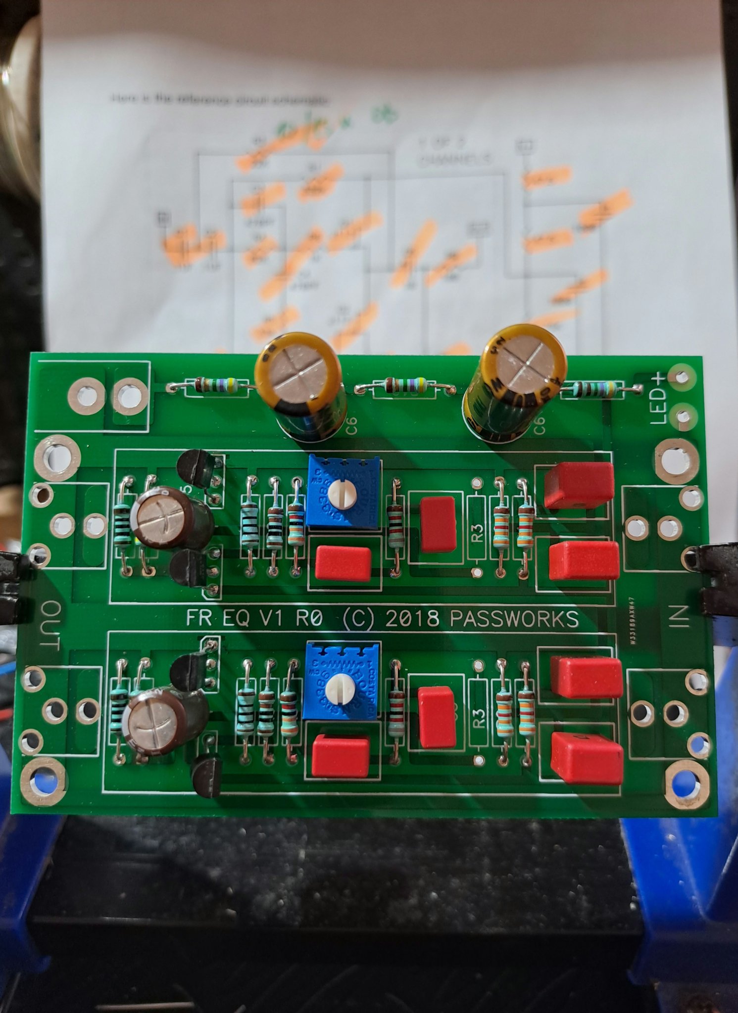

Just got this board for the Lii silver 10. Not being the most savvy, what would I use for the R6-R11 and C5 and C6? Even better a parts list for this particular speaker would be much appreciated. Have some wine to trade for it.

Thanks you! Polyfill added to the list! Think I got the shopping list dialed. Any reco for C6? Many thanks!
