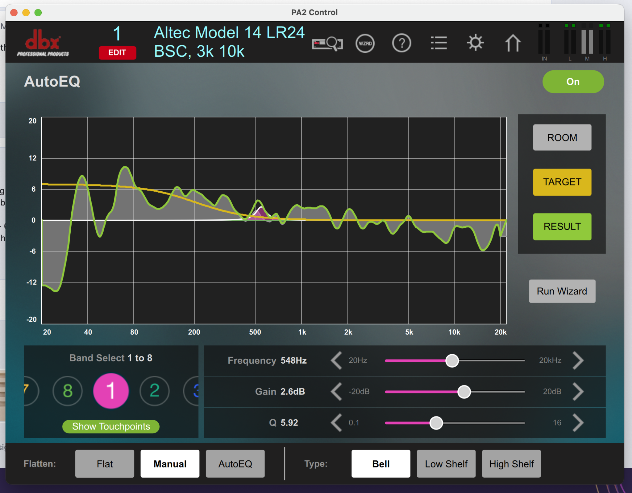

I recently, (yesterday!) landed on simple 3 filters EQ for a pair of Altec model 14s that yields a very similar curve, but a shelf at the low end vs a bell, but this looks very similar to this.

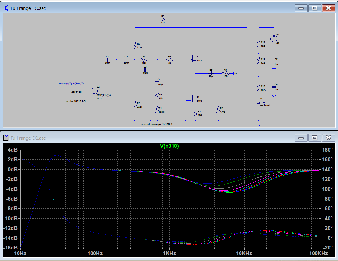

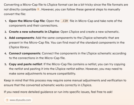

Does anyone happen to have an export of the Microcap file that might import into LT Spice? It's not a lot of components, but hoping to save a step.

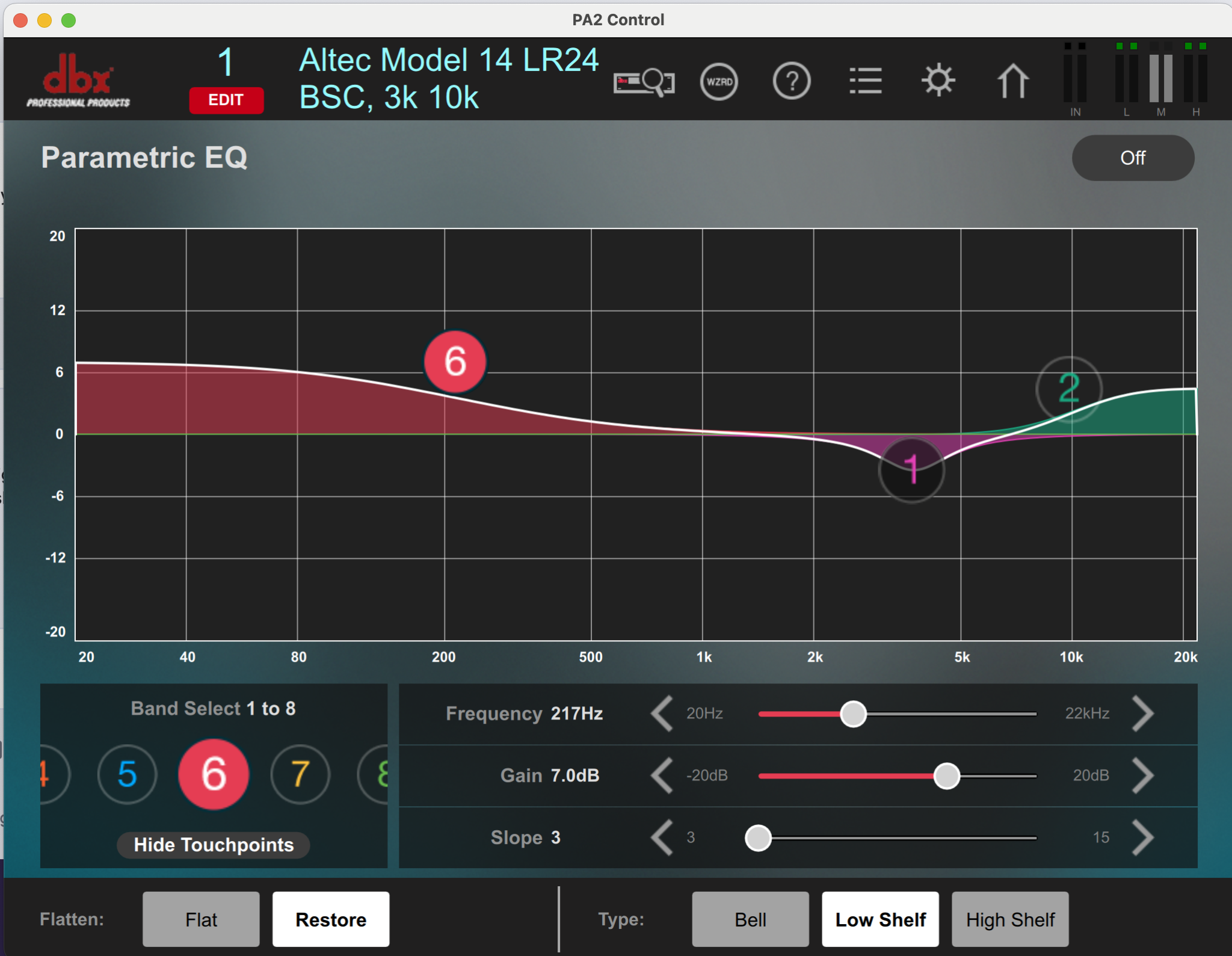

Would love to model this out to see how close I can get to the below. (xover is LR 4th order @ 1.5khz on HP and LP)
(filters are: #6 low shelf +7db to 217hz (baffle step freq);
#1 adjustment for horn peakiness (-3.7db, Q 2.04 @ 3.75kHz)
#2 adjustment for CD/horn roloff + 4.4 db high shelf @ 10kHz, 6db slope --- I can't honestly even hear this one at my hearing levels, lol, but threw in as I was contemplating pllxo and would help with attenuation perhaps)
There's also 7db of attenuation on the HF, but I can manage this at the analog active crossover.
the resulting curve is as below, certainly there's room response in the FR below, but was happy with the simplicity. (ignore the pink filter, I was playing with the FR at the seating position.

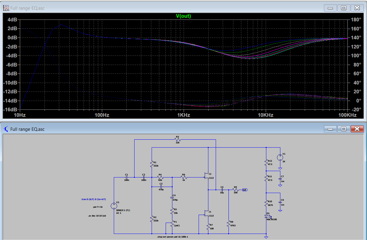

Thanks stevu! Much appreciated!
I have a windows 11/UTM virtual machine for installing Microcap installing the o/s in the background, so this is a substantial timesaver!
