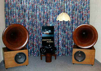

Sure , I can easily agree with that. Sierra /Brooks two way horn speaker was just that -Altec 416 in BR box and Tad 4001 in huge wooden tractrix horn. How where adjacent channels implemented?
Was the depth of imaging and source identification good ? I bet it was beaming like a mofo and slight turn of the head caused total shift of the balance from left to right.
