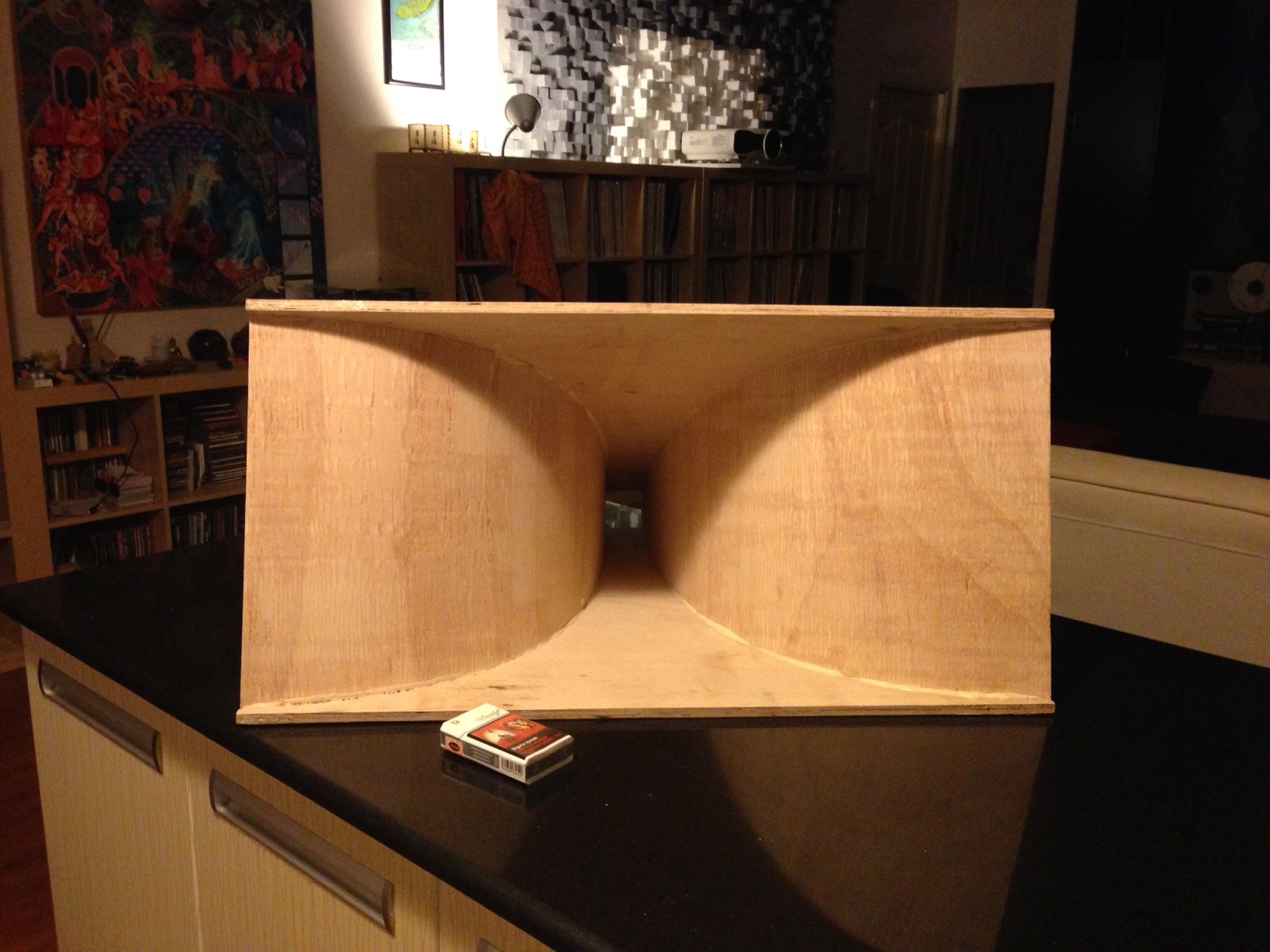

Ok. As I have said before, I want to experiment with as many horns as possible. I started building a cf 190hz tractrix horn with rectangular mouth.
I have a cf 260hz rectangular mouth tractrix on top of my klipschorns. I cross it around 380hz. I had a problem (though no one but me seems to care) with phase shift close to crossover point. I built this one I want to see if I can get rid of that. I also wanted to see what difference it will make with a bigger horn but with the same crossover points.

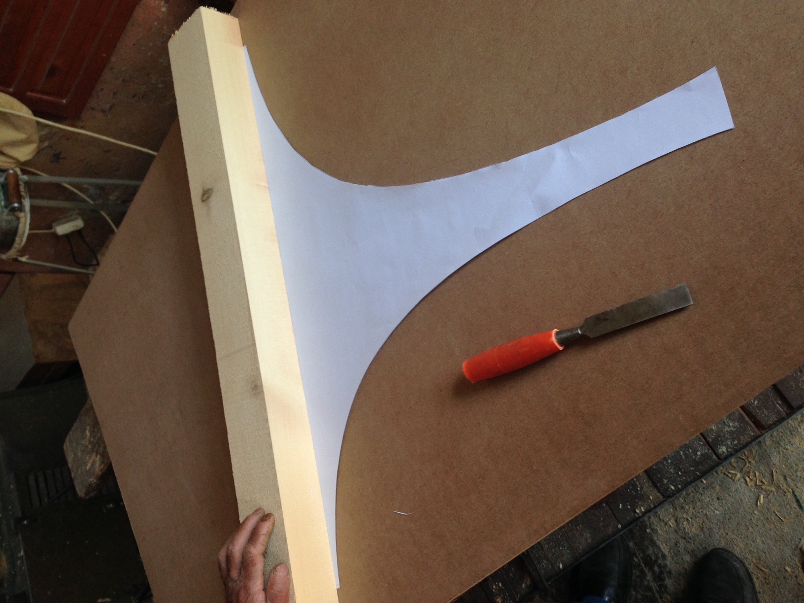

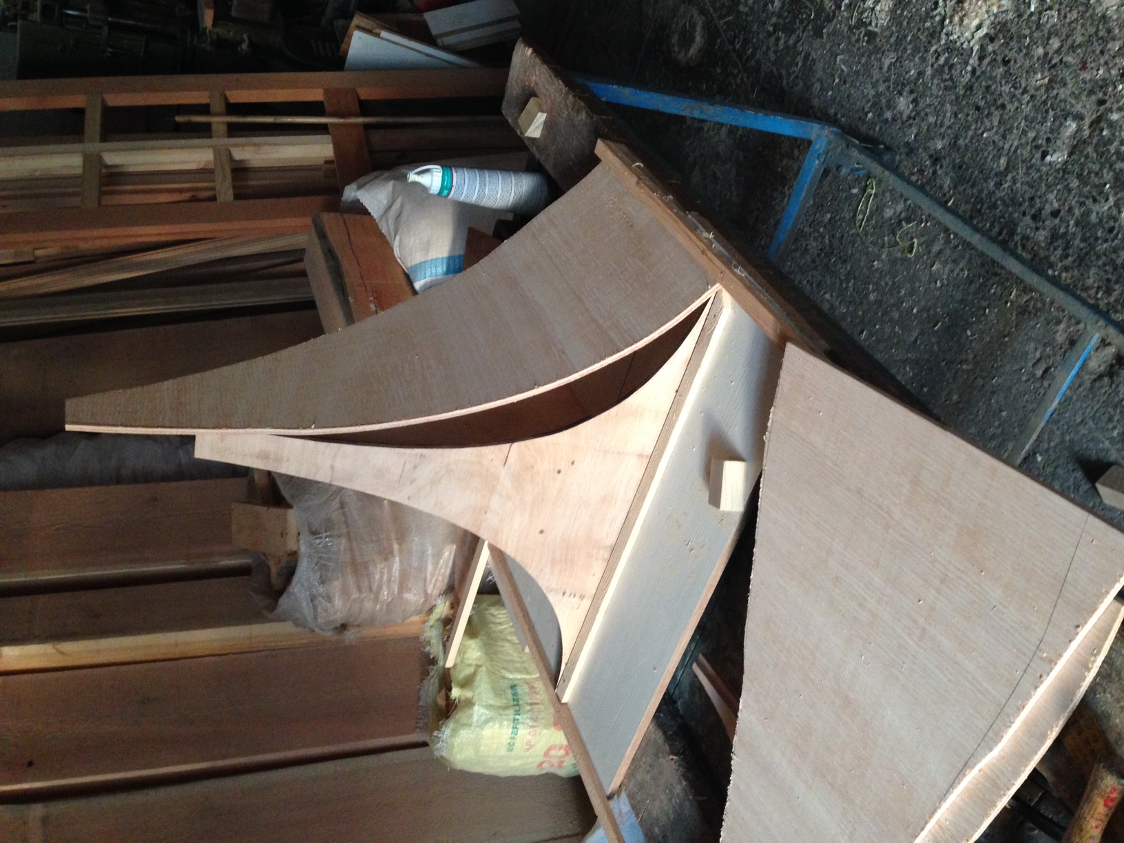

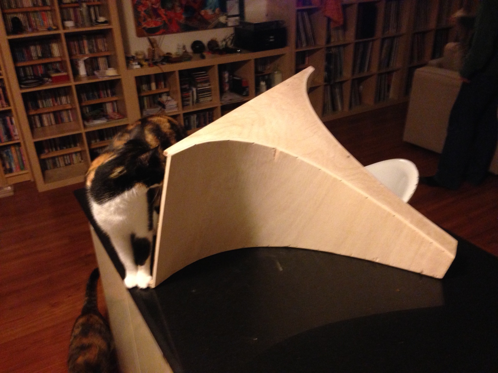

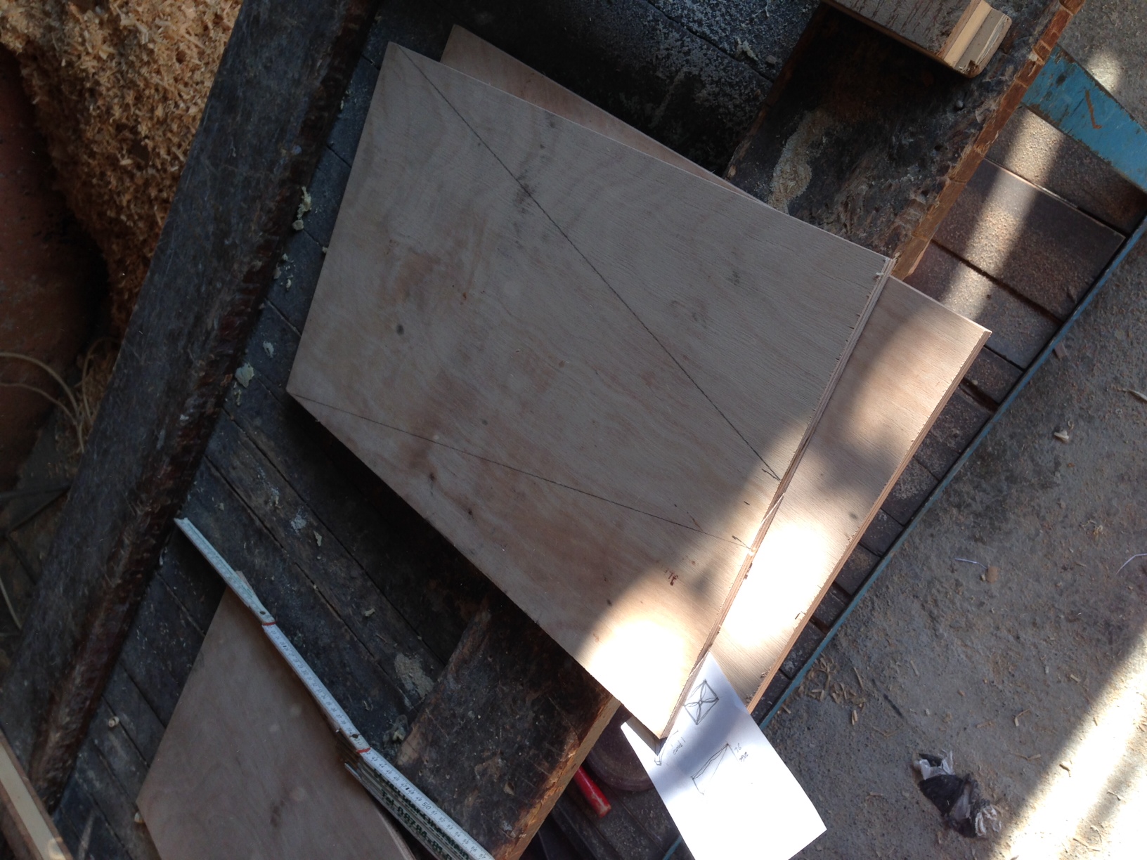

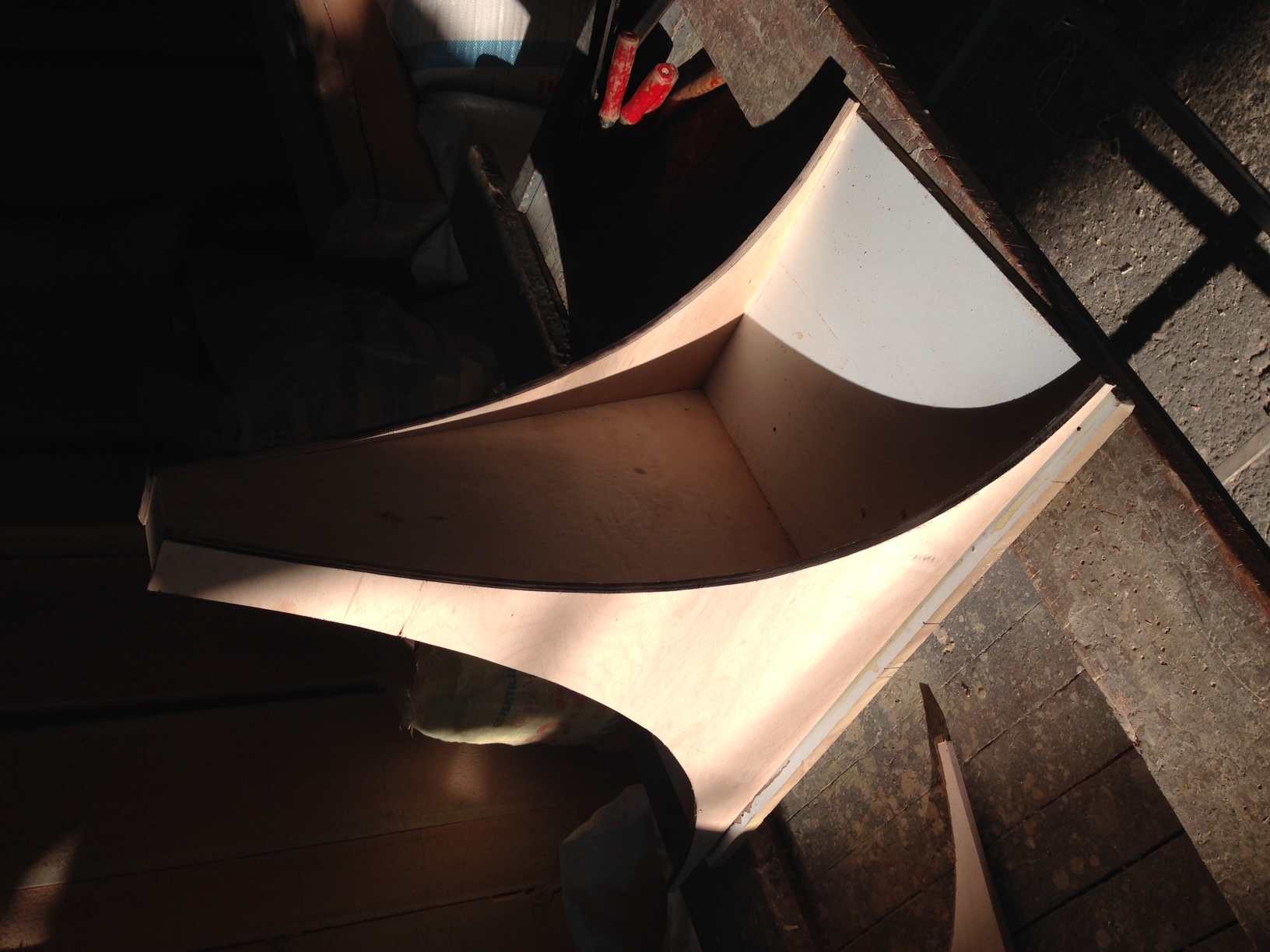

I printed the template on a paper. Cut it out of 10mm marine plywood. Then built the jig to hold them on the right incline. While holding them, I used the bendable plywood to build the side walls. I sanded roughly. Next step is more sending, primers and then paint.
I am also going to build the mouth transition piece from round to square. I calculated it as well. So it will be a gradual transition roughly fitting the tractrix curve...
