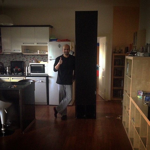

I have my modified klipschorn system that I am happy with but I am looking forward to having a full range 5 way (very little compromise) horn speaker
This is just a fantasy now, but as it would cost a lot, I thought why not plan ahead as much as possible. Here is my initial sketch and thoughts on it. It's been obviously inspired by Cessaro speakers. Not a specific model but something in between their Gamma, Beta and Beethoven...
20hz - 60hz - Tapped Horn with 15" driver, this tapped horn will also be the structure that carries the tractrix horns and the bullet tweeter.
60hz - 160hz - 3 of Speakerplans HD15 with 15" drivers. I am very concerned about this range and have little real experience, I want it to be as clear and as high quality as possible. My candidate was HD15's with good quality 15" drivers.
160hz - 600hz - somehting close to 110hz Tractrix horn with special 11" mouth (I need suggestions here) with Supravox 285-2000 (the one cessaro uses in midbass) This is a very important range so I wanted the best quality driver possible in this range. Centre of this channel is about 56cms from the ground.I heard good stuff about Fane 8m but it is out of production and I don't want to deal with that.
600hz - 8000hz - 200hz autotech Tractrix horn with 1" Tad 2001. Updated to 2" TAD 4001 I heard and really like this driver better than my BMS 4592nd-mids. Centre of this channel is 141 cm's from the ground, it may be tilted downwards a little. I can have an adjustment system there.
8000hz - 35.000hz - Fostex t500amkII bullet supertweeter. Centre of this channel is about 101 cm's from the ground. Good height, about ear height when sitting.
I will be utilising a 2 in 10 out active crossover system, and tune the speaker with measurements. I have umik-1 mic coming up, have multichannel external sound-card and rew.
What do you think of this fantasy? Do you think it is worth investing in? Does anyone have recommendations or things I got wrong... I don't have a time limit and I most probably will be spending a lot of my hard earned money on this dream!
