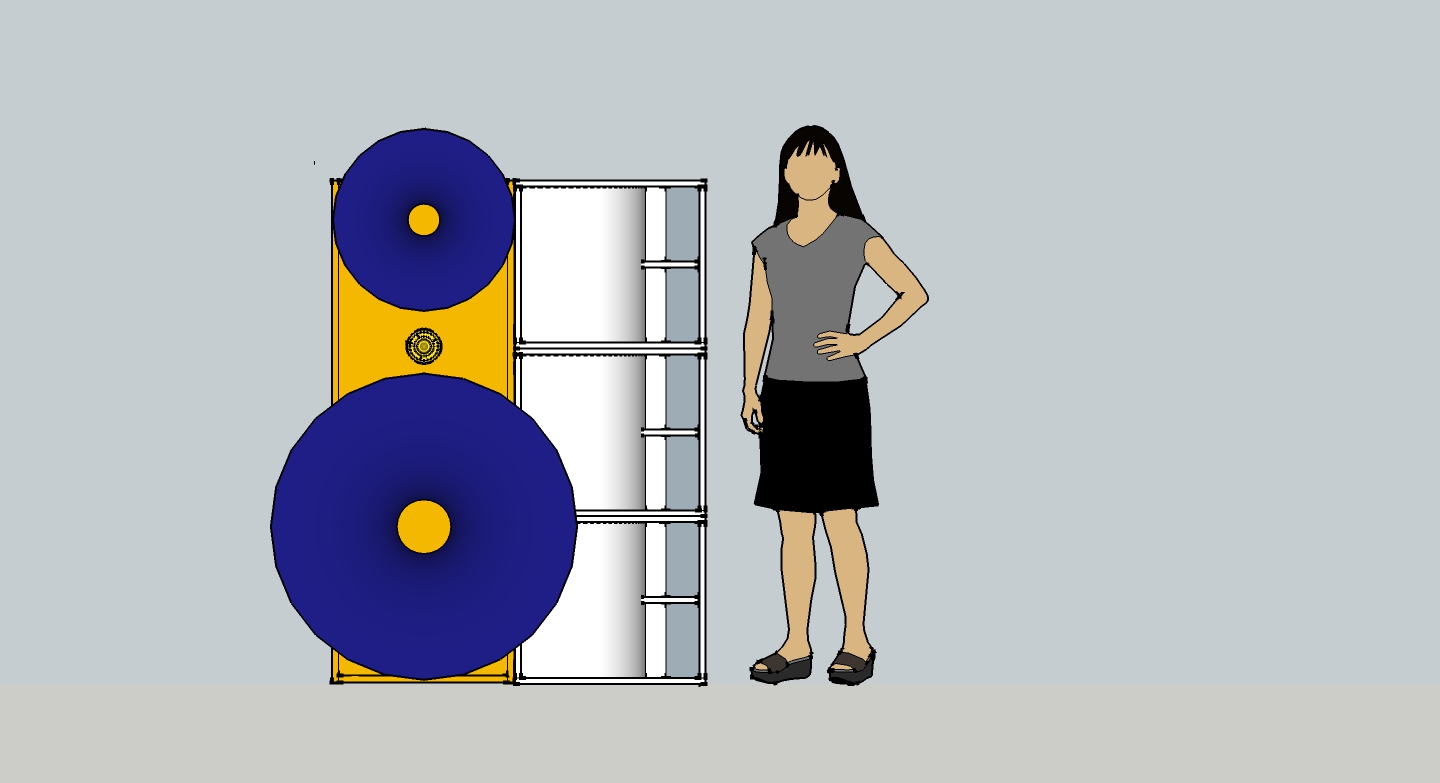

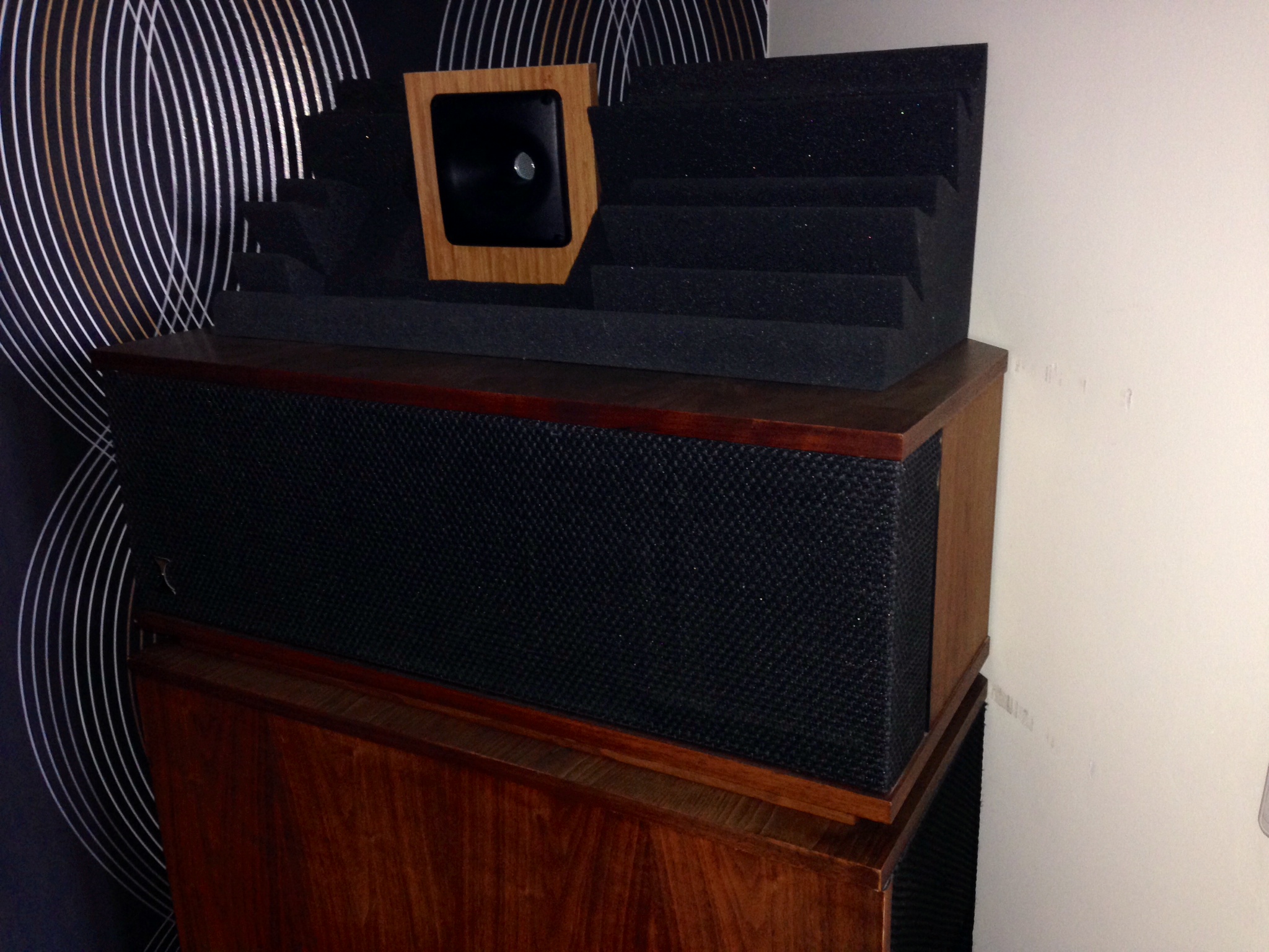

I have my modified klipschorn system that I am happy with but I am looking forward to having a full range 5 way (very little compromise) horn speaker
This is just a fantasy now, but as it would cost a lot, I thought why not plan ahead as much as possible. Here is my initial sketch and thoughts on it. It's been obviously inspired by Cessaro speakers. Not a specific model but something in between their Gamma, Beta and Beethoven...
20hz - 60hz - Tapped Horn with 15" driver, this tapped horn will also be the structure that carries the tractrix horns and the bullet tweeter.
60hz - 160hz - 3 of Speakerplans HD15 with 15" drivers. I am very concerned about this range and have little real experience, I want it to be as clear and as high quality as possible. My candidate was HD15's with good quality 15" drivers.
160hz - 600hz - somehting close to 110hz Tractrix horn with special 11" mouth (I need suggestions here) with Supravox 285-2000 (the one cessaro uses in midbass) This is a very important range so I wanted the best quality driver possible in this range. Centre of this channel is about 56cms from the ground.I heard good stuff about Fane 8m but it is out of production and I don't want to deal with that.
600hz - 8000hz - 200hz autotech Tractrix horn with 1" Tad 2001. Updated to 2" TAD 4001 I heard and really like this driver better than my BMS 4592nd-mids. Centre of this channel is 141 cm's from the ground, it may be tilted downwards a little. I can have an adjustment system there.
8000hz - 35.000hz - Fostex t500amkII bullet supertweeter. Centre of this channel is about 101 cm's from the ground. Good height, about ear height when sitting.
I will be utilising a 2 in 10 out active crossover system, and tune the speaker with measurements. I have umik-1 mic coming up, have multichannel external sound-card and rew.
What do you think of this fantasy? Do you think it is worth investing in? Does anyone have recommendations or things I got wrong... I don't have a time limit and I most probably will be spending a lot of my hard earned money on this dream!

Its a nice looking setup, but I think you have to reconcider the Tractrix 200 and the range for TAD2001.
Maybe you are better off with a midrange horn playing from 250/300-2000? But most likely this solution would require a mid bass that can be crossed higher than HD15

If I can not have the spherical horns shallower, I may need to change the setup like this. However, if it is setup like this, I can not physically align the supertweeter, it would be too recessed and the waves would be hitting the lower and upper midbass horns. So it seems digital time alignment will be mandatory. This means I will need to incorporate a very high quality digital crossover with the best possible dacs.

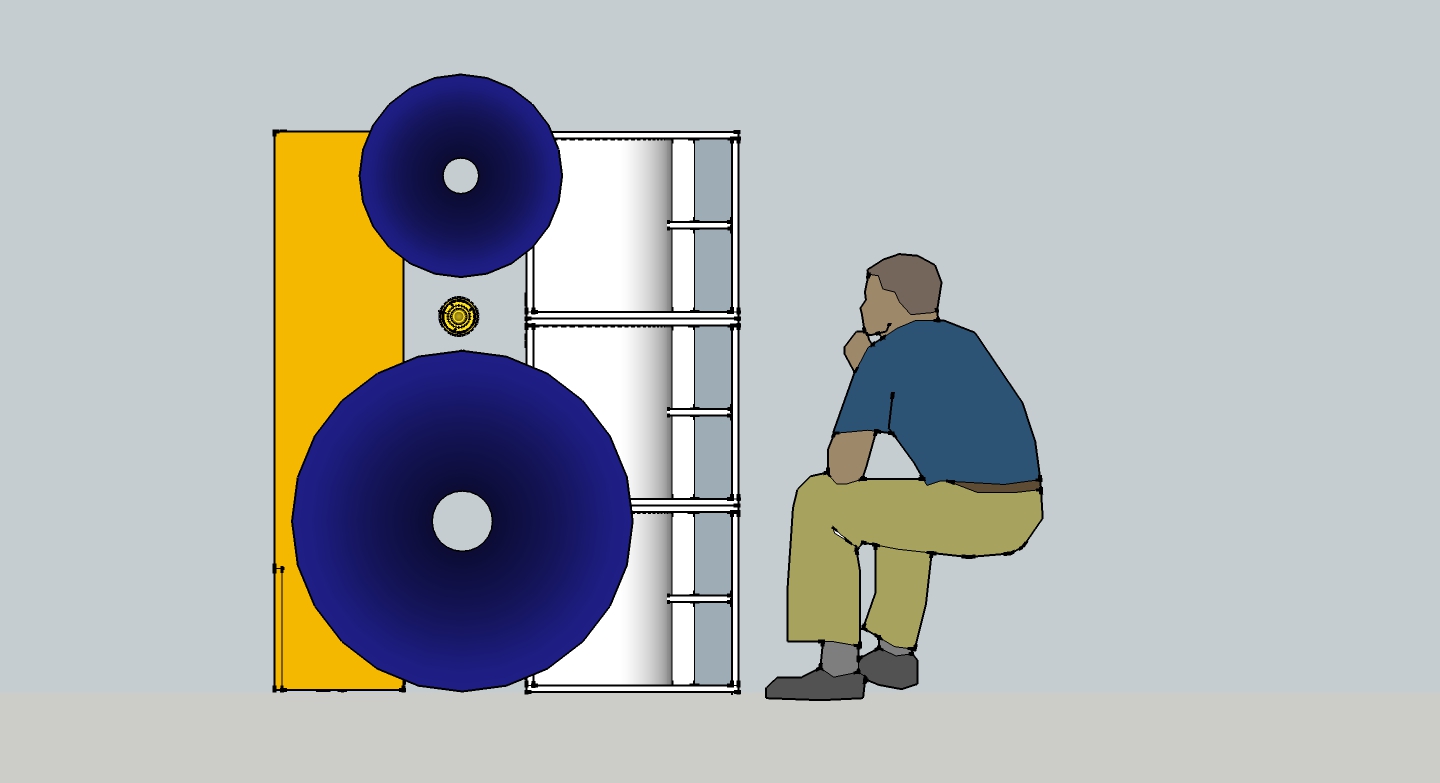

Wow cool hints! Thank you very much. Actually, I will try emulating Beta 1's low mid and midrange so why not get the tweeters too! I am trying to find the horn profiles they used, it says spherical. I know their throat sizes, their opening sizes. I don't know about the depth and the flare. What I know is as such;
Low-Mid - 28cm throat - 93cm opening spherical horn - Supravox 285-2000 alnico
Midrange - 2" throat - 54cm opening spherical horn - (TAD 4001 modified)
Treble - 9 cm opening spherical horn - Tad ET-703
So I will need to cross the tweeters really high to get them aligned without reflections to bother. This is a good hint. I will try this.
Then I can add 20hz - 60hz Tapped sub and 60hz-160hz scoops for deep bass.
For crossovers, my plan is I measuring with my sound card. I have a music production studio, so have external sound cards with multiple outputs. I can emulate active crossovers and try finding the desirable crossover points and slopes as well as necessary attenuation values. Then I can build passive crossovers with those settings. I can use the dsp for deep bass alignment, like they did.

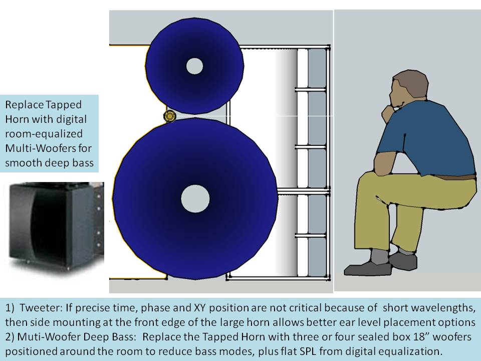

Cut and paste speaker design:
1) Tweeter: If precise time, phase and XYZ position are not critical because of short wavelengths, then side mounting at the front edge of the large horn allows better ear level placement options
2) Multi-Woofer Deep Bass: Replace the Tapped Horn with three or four sealed box 18” woofers positioned around the room to reduce bass modes, plus flat SPL from digital equalization.
For passive analog crossovers, when physical time alignment is impractical, “quasi-optimal” crossovers that can "offset compensate" are worth additional study. LeCleach developed a spreadsheet. For very minor physical offsets, LR4 + LR4 with slight freq shift is popular - spreadsheet on web. Xovers are based upon acoustic slopes. A few passive filter tweeks are common to remove funky SPL peaks.
3rd order Butterworth Low Pass, -3dB @ Fx*0.87 (+)
3rd order Butterworth High Pass, -3dB @ Fx*1.15 (-)
