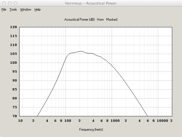

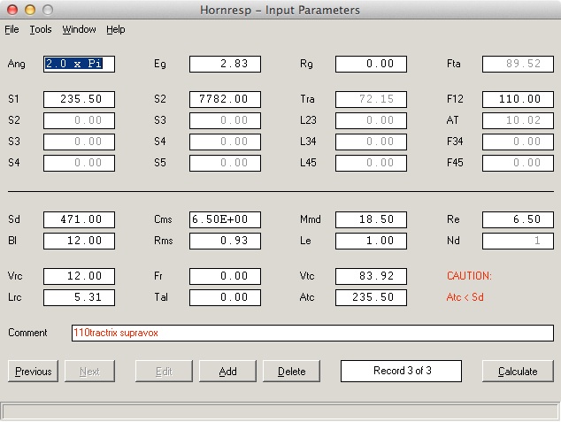

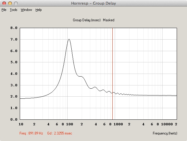

supravox 285-2000 cf110tractrix horn sims
Here are the sims of Supravox 285-2000 on 110cf autotech tractrix horn with a small back chamber. Maybe I won't need a crossover/filter on my upperbass horns at all!
For the upper part of my midrange, the natural roll off of the 200hz tractrix horn and the BMS compression driver seems to be enough to cross around 6400hz. For the lower part (600hz ish) I may get away with an inductor. However I will need to pad down. Maybe a fostex attenuator could work here, or maybe a better match then BMS 4592nd-mid?
For the tweeters it seems one 68mF would do the job.
It would be great if I would be able to get my system together with few components in the crossover.

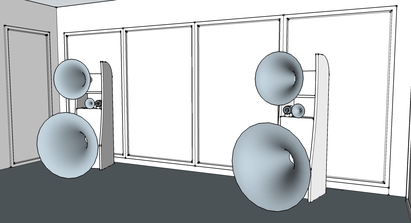

I just went ahead and bought myself a pair of Radian 850pb's. I will try to compare these to my BMS 4592nd-mid 16ohms. If this works out, I will have a complete set of Volti upgraded Klispchorns in my hands which I can sell (or keep as rear speakers!)
So now the system looks like it is going to be something like this:
20hz-100hz - Tapped horn - Eminence 4015lf (already have)
100hz - 600hz - cf110 Tractrix autotech - Supravox 285-2000 alnico (ordered)
600hz - ? - cf200 Tractrix autotech - Radian 850pb (ordered)
? - 45khz - Fostex t500amkII (already have)
Now thinking of ordering the Fostex rt100 attenuators for midrange padding.

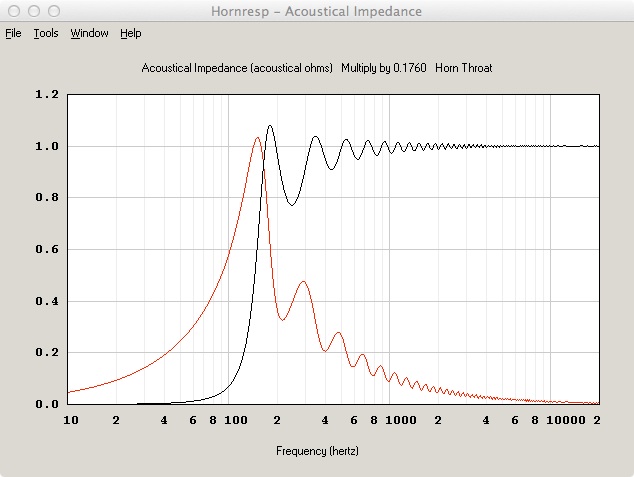

Also I have been working on reactance annulling for the 110 tractrix horn. I have calculated that for the Supravox drivers back chamber to have a resonant frequency 110hz, it has to have a volume of 11 litres (110,586hz) Now, I estimated supravox would take around 2.5 litres of space. So I will build a sealed box of 30cmx32cmx15cm. Is this right? It looks like it works in hornresp as well.
Also I have been working on reactance annulling for the 110 tractrix horn. I have calculated that for the Supravox drivers back chamber to have a resonant frequency 110hz..........
This will not reactance annul it, you must maximally flatten its impedance, which shifts its usable F3, etc., BW upward a considerable amount from the horn's 1/4 WL cutoff [Fp], though in a HIFI app it often negates the need for an XO as well as presenting a benign load to a high output impedance amp.

GM I have been trying to understand reactance annuling. I guess I haven't understood it then. I though one should get the resonant frequency of the backchamber to the cutoff of the horn.
You are suggesting that I should aim for higher frequencies right, like 130-140hz. I guess than building what I have sketched out and then adding solid blocks piece by piece into the chamber while measuring along the way would be the way to go...

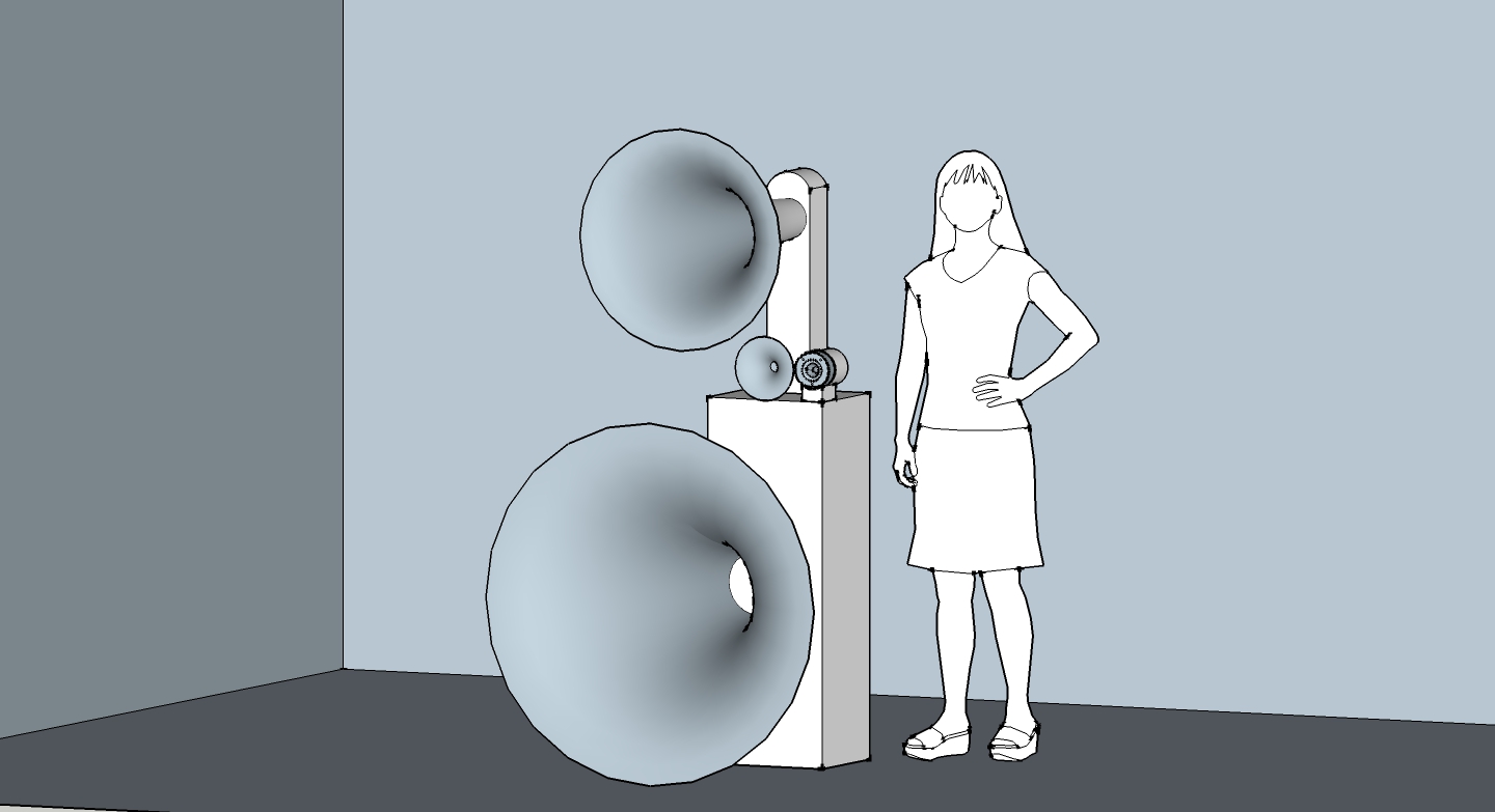

Oh, here is another sketch of the horn

Right; using the popular DSL Unity/Synergy concept that requires a 250 [Flc] - 1000 [Fhc] Hz mid horn section, it ideally needs to 'ring' at [Fc]: [250 x 1000]^0.5 = 500 Hz, whether it's the driver's [sealed back] Fs or a lower Fs driver in a separate sealed alignment.
So calculate your horn's Fc based on whatever you or HR chose for Flc, Fhc, then use the simple sealed cab alignment math or software to find the net volume [Vb] required, though IME this often only returns a 'ballpark' figure to start reducing from unless it specs a fairly large net Vb that is much more tolerant of tuning error from the theoretical ideal.

Got it GM!

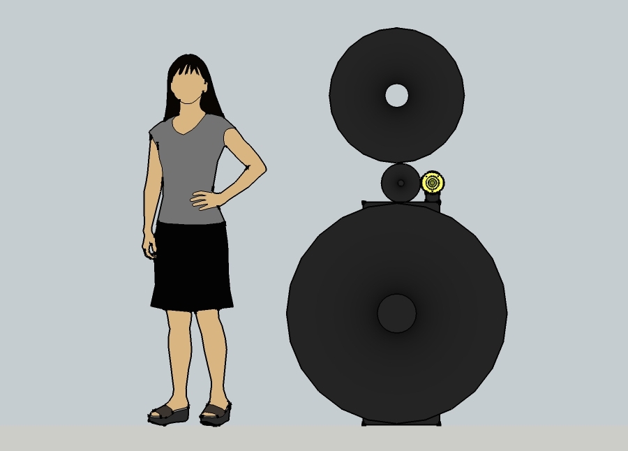

On another note, I was warned by Autotech for 2:1 compression ratio I chose for upperbass throat. They suggested 2:3 would be better. As far as I can see 2:1 is quite common and does not create any problems, also the hf extension is better. I check with hornresp as well...
ps. here is yet another sketch

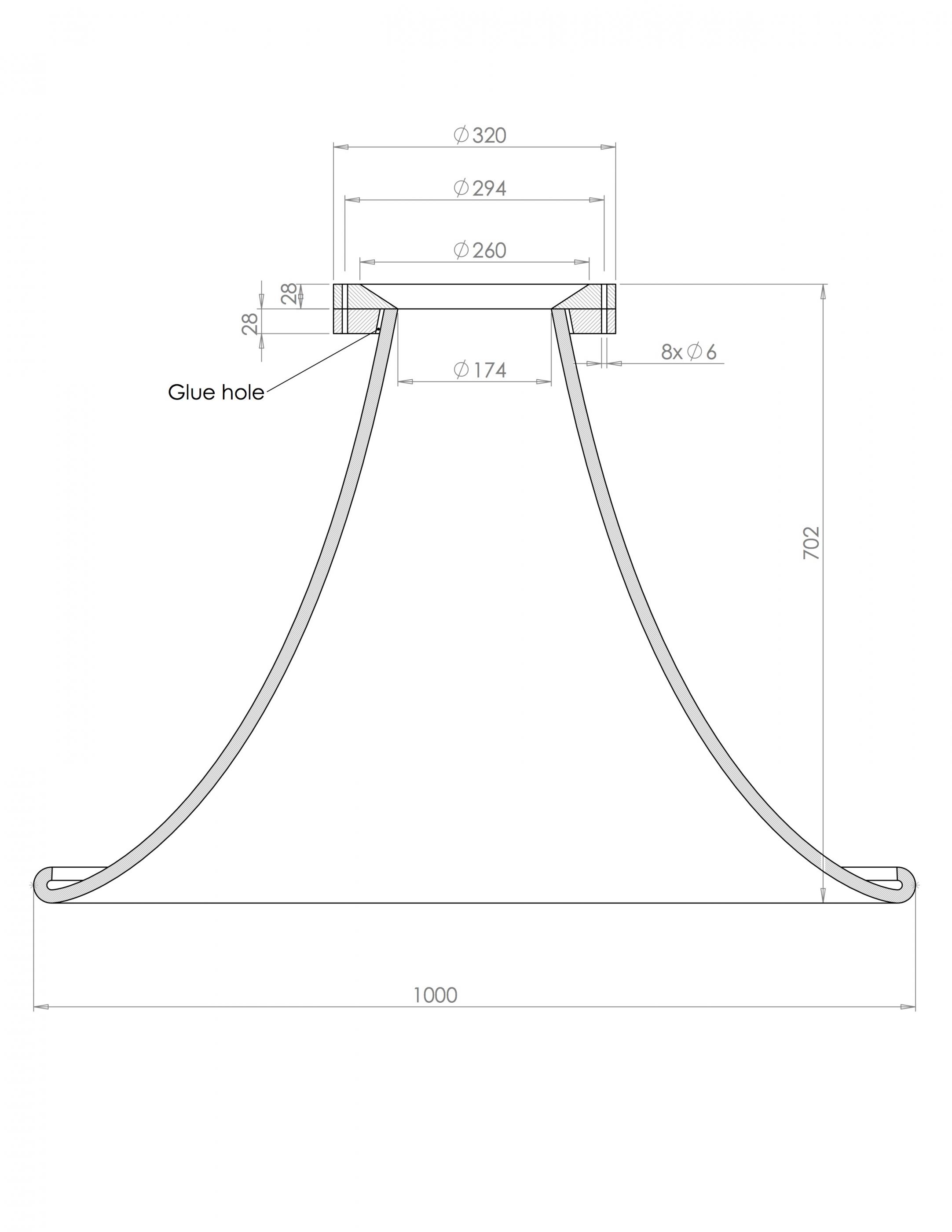

I have gone with the 2:1 compression. Here is the detail of the throat adapter that will be built by hORNS.pl 🙂 I am in contact with them through Greg at g-point audio and everything is going very smoothly and they are very helpful.

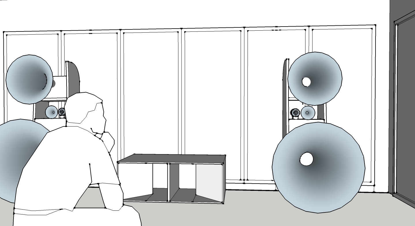

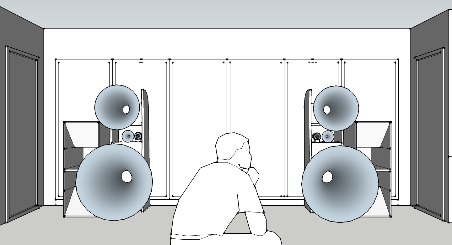

I was going a little crazy and thought why not have two f218mk 2 units, each with a dedicated hypex 🙂 It certainly will be overkill, but I will have less room problems with stereo bass and less distortion! Also, as I drive them up to 160hz, it would be good to have them stereo as there is musical information and even vocals down to that range. As someone who loves listening music that has horns in them (like trombone) it is still an important range for me. I will get a quote for the units and then decide.
Here it is, there is no harm in dreaming!

There is something in stereo bass, IMO but it isn't stereo. I prefer not to have a bass unit in the middle of the wall.
