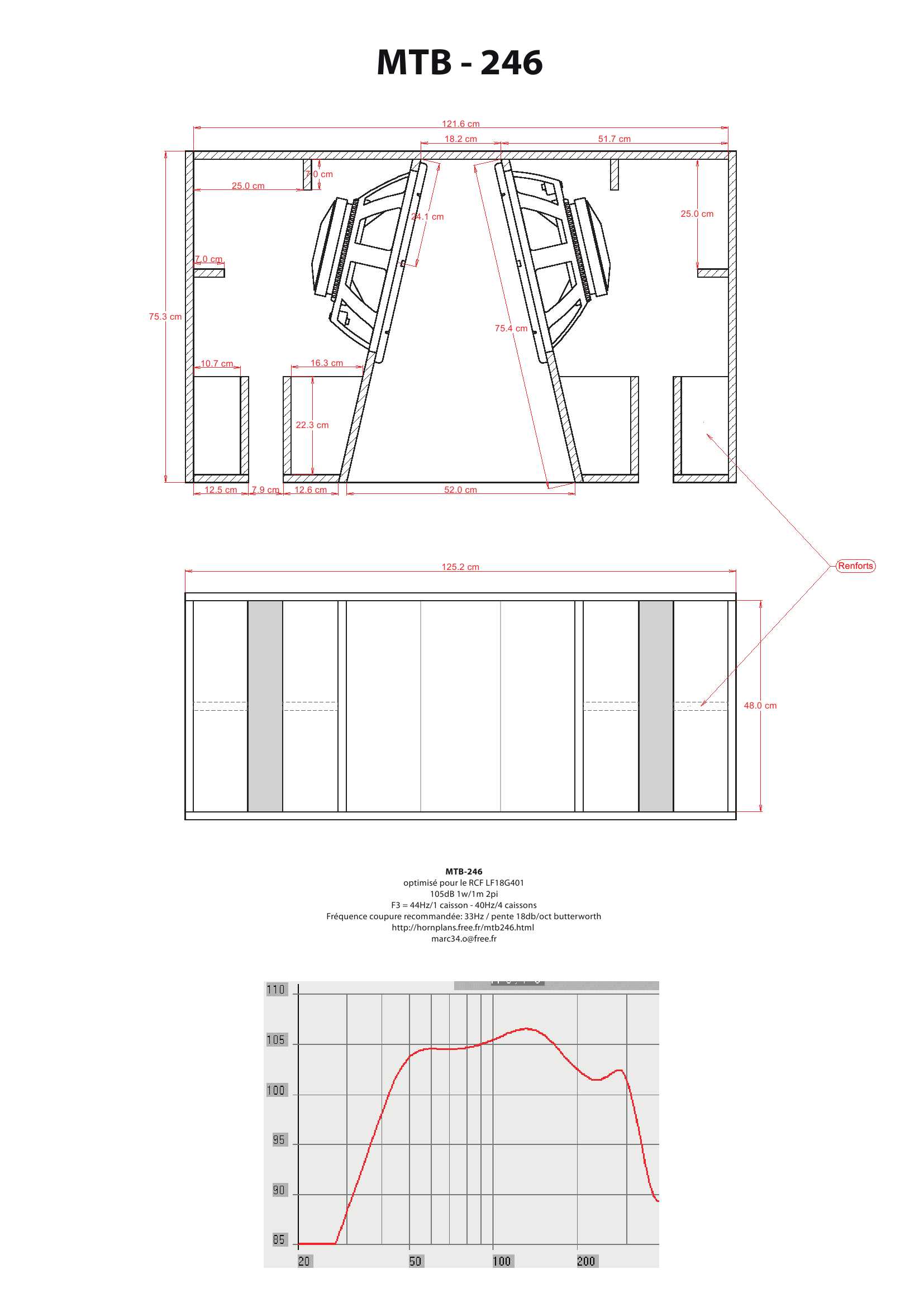

Ok, I can cross at 160hz to MTB 246 bass bins. They extend to f3: 42hz with 2 cabs. This is great extension for music.
If I build two of these with 2x18" RCF drivers they were intended for, and buy 2 hypex ds4.0's, it will cost me the price of a single Funktion 1 - F218. I can also make the same finishing for the side panels of my horns and these.
I have heard Funktion 1 at various places and they were sounding great at bass department. However over PA forums like speakerplans, people suggest that these sound cleaner and extend more into the lower bass. If this is all true, and it looks like that, I will build two of these.

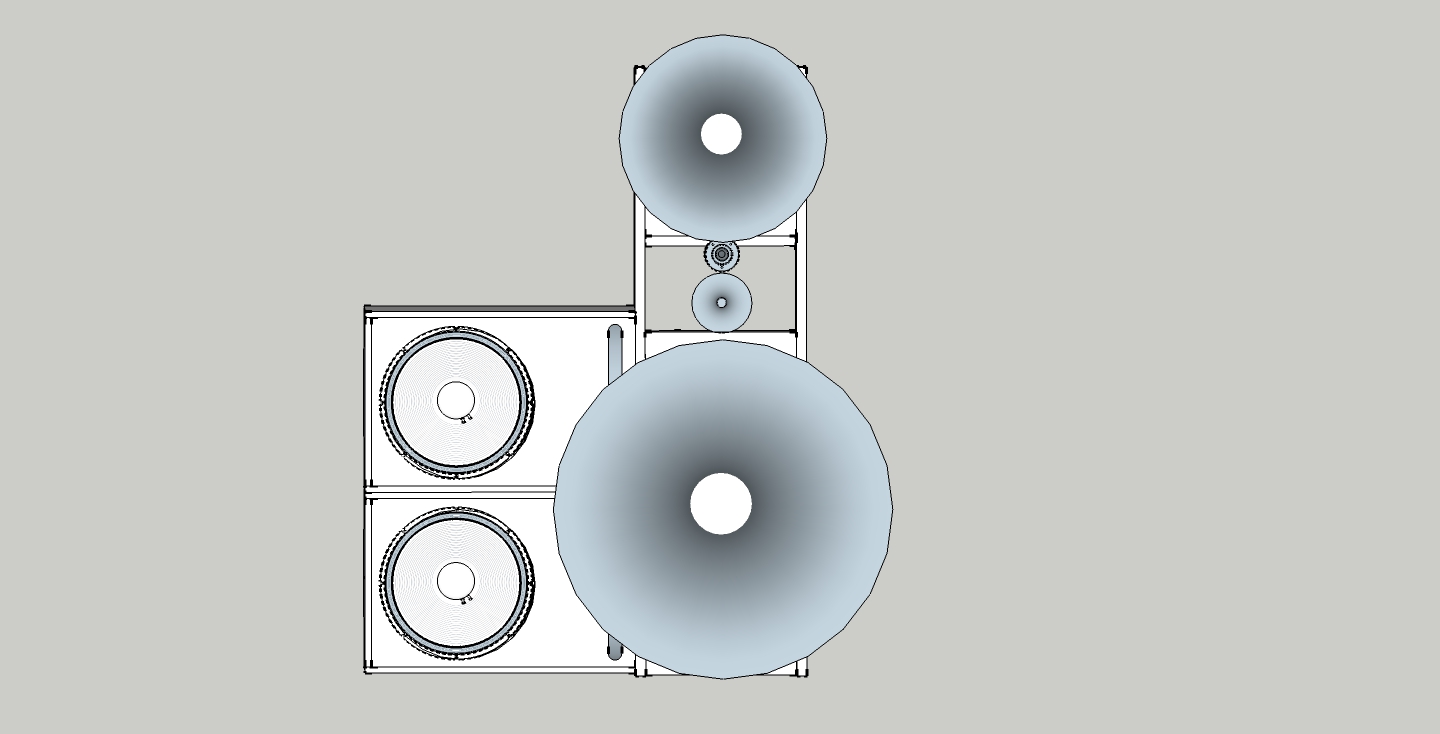

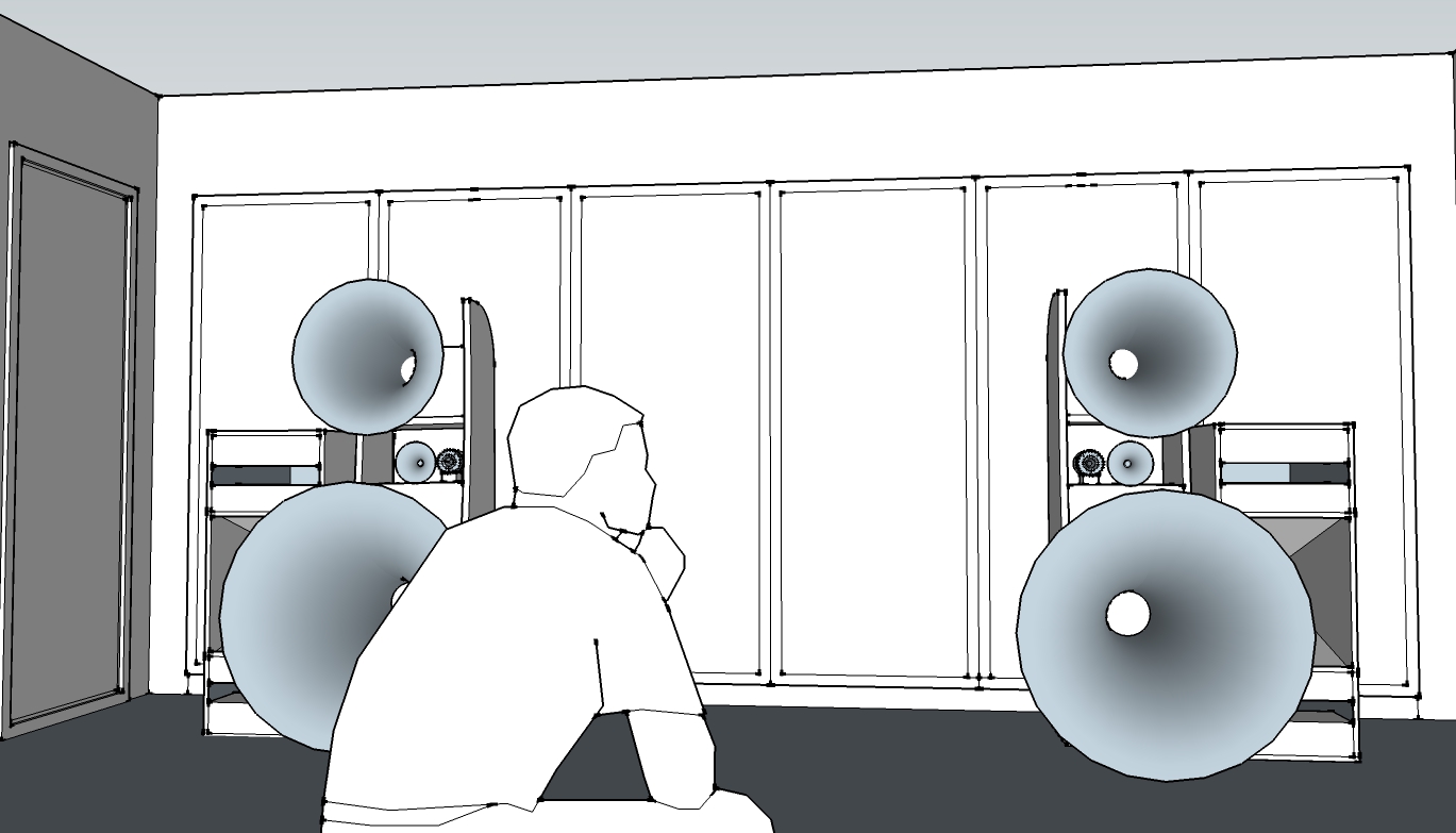

This is how they would look with the rest of the system

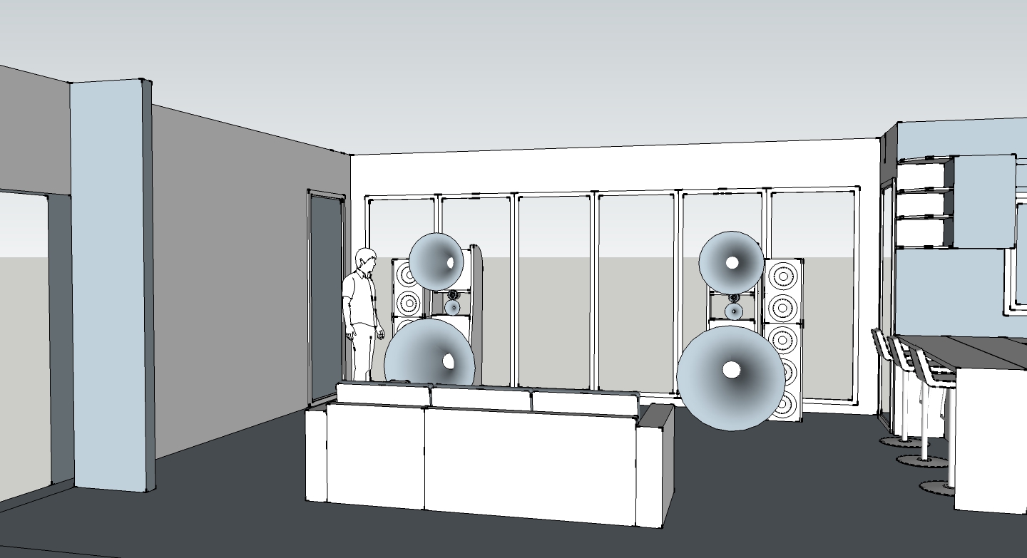

the bassbin looks great. You might consider a sub bass line array from the floor to the ceiling. Upon my experience, that will energize the whole room evenly with bass, not only from the bottom to half of the room. Its commonly asserted that bass is not directional, but there is a hudge difference doing this. I had first only the bass horn, and added two Altec 416's above. The improvement was considerable. Much better.
I thought the bass bins were ok too, but on the subwoofer forum they people have pointed out the problematic centre port and the two vents. I don't want ports, vents that are audible. People were agreeing the PPSL is better than this solution.

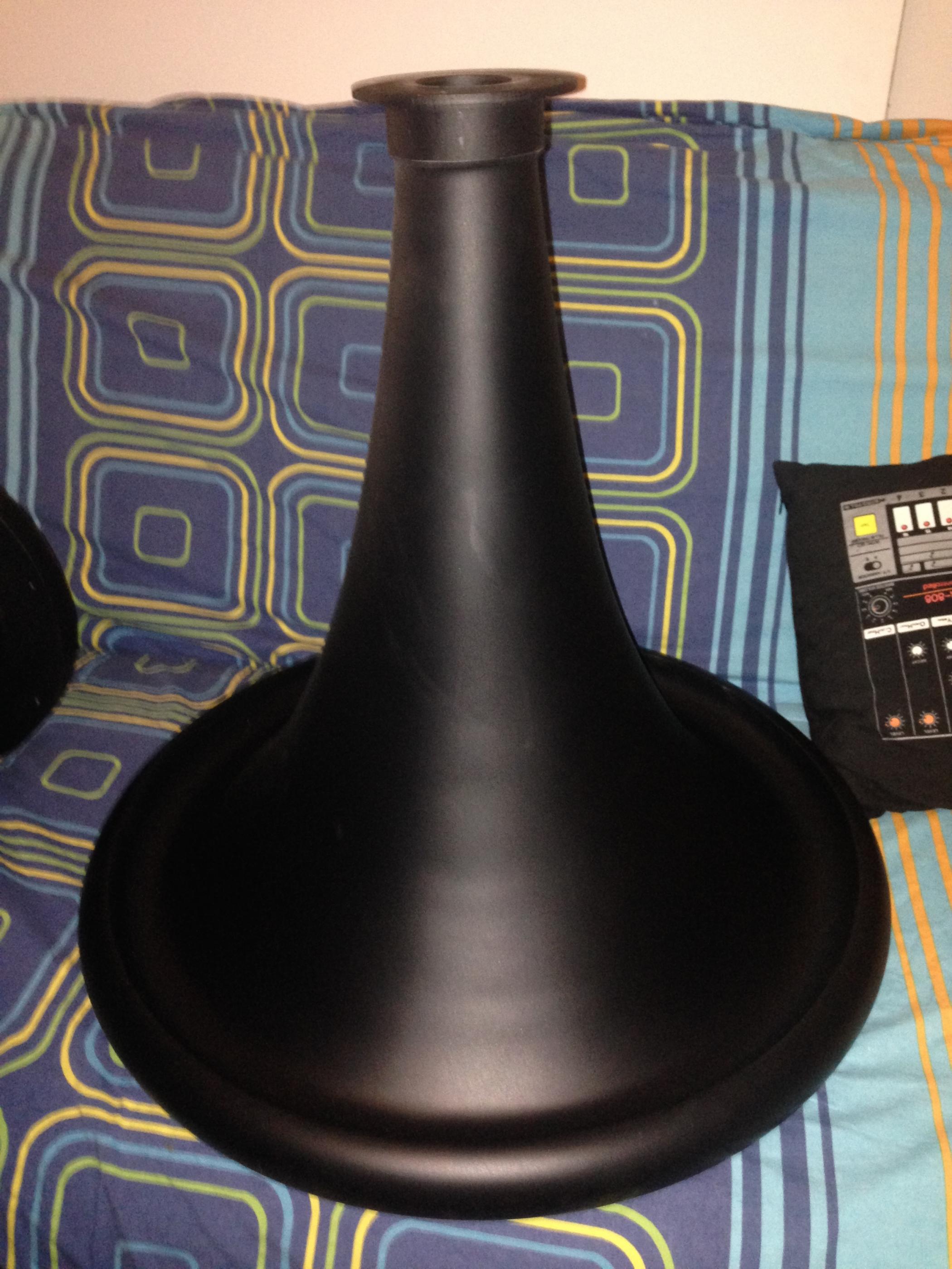

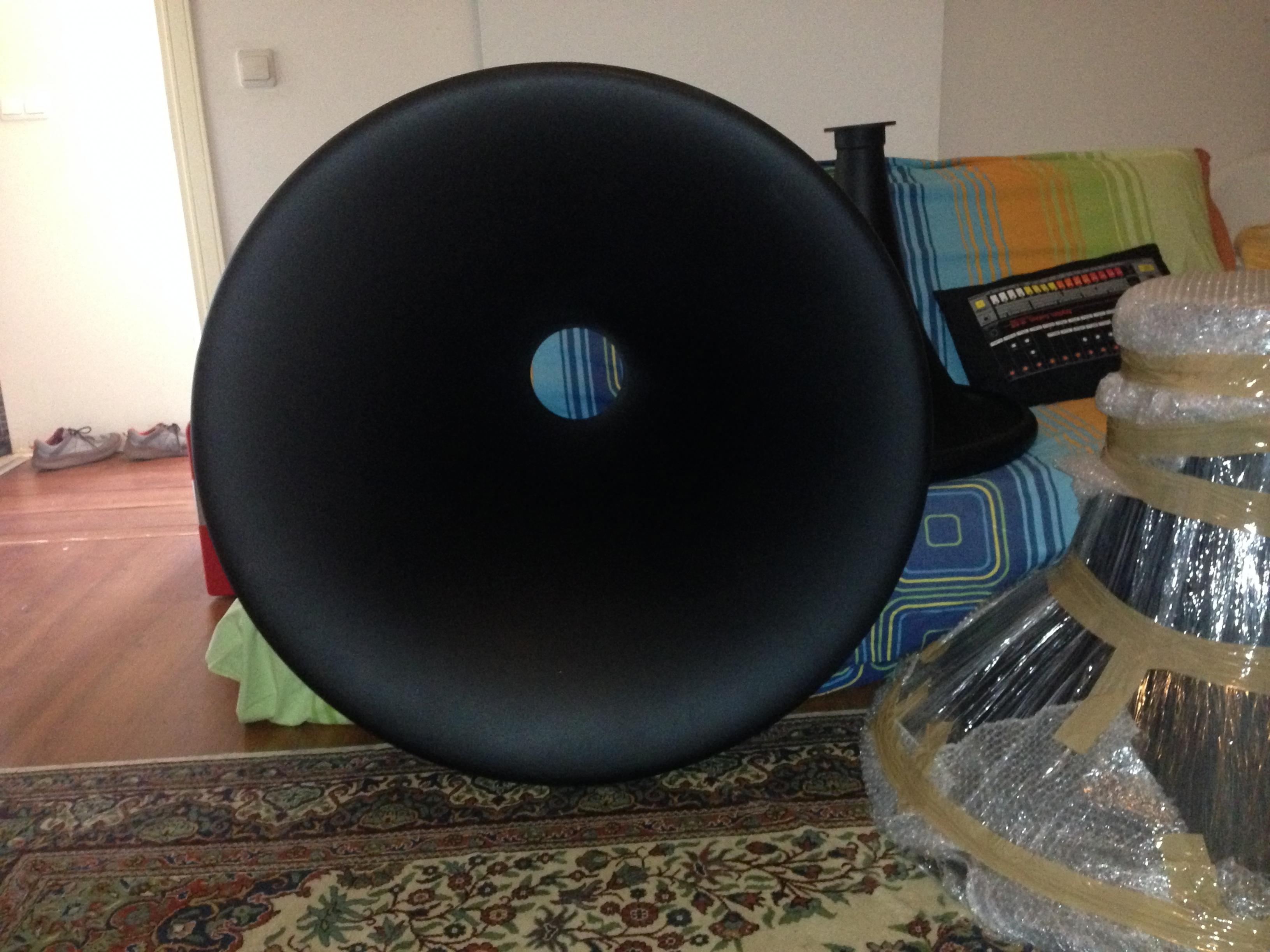

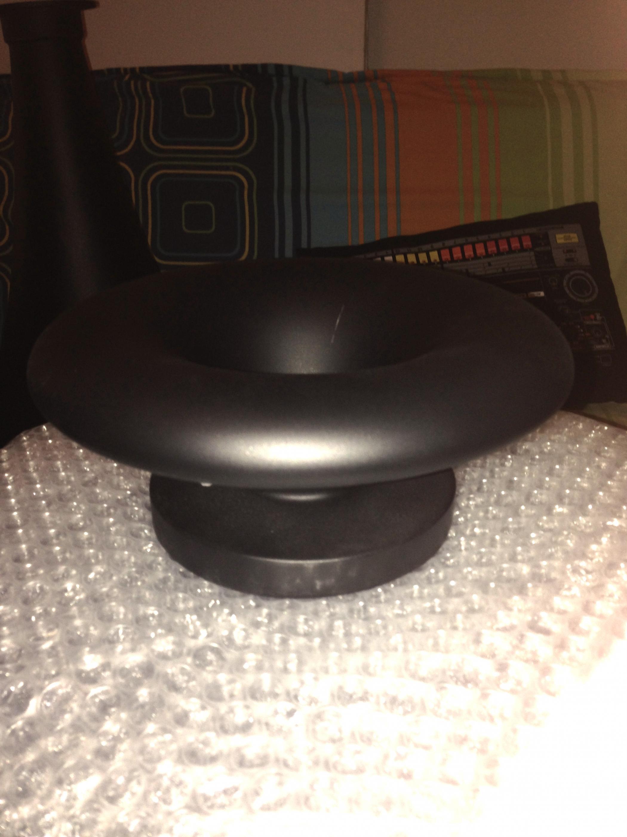

new bass units
After poor service of Turkish ScanSpeak dealer I changed the bass units from 4x2 12" scanspeak units to 2x2 18" Tad units. I am going to use TAD TL-1801's in bass reflex boxes from about 34hz up to 160hz or maybe 200hz. It matches the efficiency much better too. Here is the latest bass units with the horns, but I am also changing the frame of the main unit to a visually lighter frame.

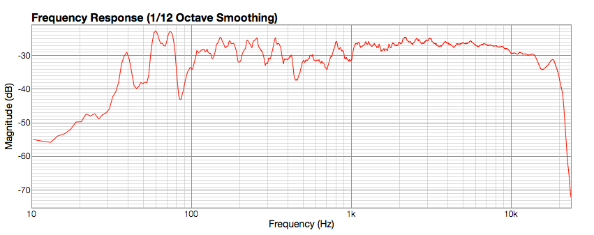

Picture of the system (the TD2001/Fostex are not installed here, still deciding on the final shape for the bracing). I also attach the measurement I took a while ago (there was no tweeter) and the measurement of the big tractrix (at 1mt) I took this morning with and without 120Hz active high pass ... no difference as you see
Hope this helps.

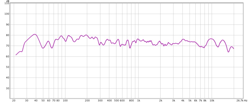

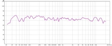

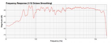

By the way this is my current horn systems response, I hope to achieve a much better response than this although it is not bad at all. This response is from a tapped horn built by me covering 20 to 80, klipschorn bassbin with cw1526 from its bottom limit to 380hz, 190hz tractrix made by me with bms4592ndmid from 380z to 6.5khz, fostex t500amk2 tweeters from 6,kHz up to 45khz. The measurement is in room at listening position by amok mic with rev with 1/12 smoothing.

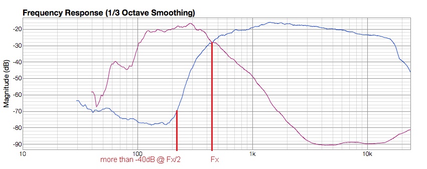

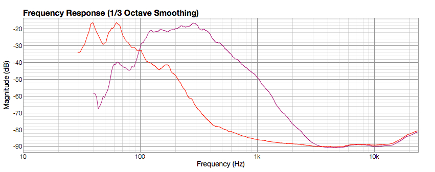

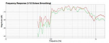

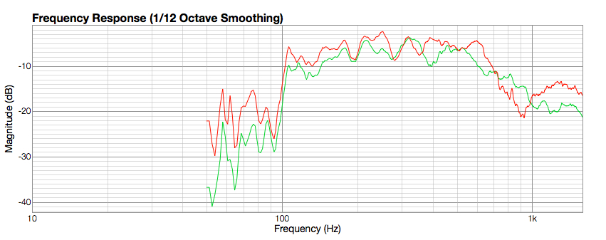

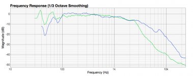

@Gluca: Do you have measurements just for your bass bins?

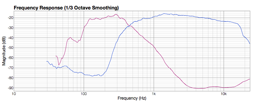

Yes, the attached first graph is bass bin and mid-bass horns with no xover (green and blue curves), room resonances did not allow me to take a better sweep but theoretically the bass bin should be good down to 55Hz or so.
Marco, thanks for the comments. I did actually share your worries and let me specify that I am crossing horns at 2x the cutoff (and much more for the smaller TD2001) and clearly the resulting slope due to horns/driver + electric xover is 12dB/oct: see attached measurement with xovers.
Many reported the TD4001 to be somehow harsh probably due to high freq breakup modes of the diaphgram (and you can see them in my poor measurements too) while I am liking it more (way much more) than old altecs and the classical JBL pro line which I owned in the past.
I am using a 1uF for the TD2001 so it kicks in at 10kHz or so when the big 300Hz horn and TD4001 starts loosing energy
Anyway, this is just the starting point ... I may be switching to 18dB/oct electrical cover in future. So far I am happy and I do understand most of the commercial and custom horn systems are running minimal 6dB/oct xovers.
attached:
low and midlow NO xover
low and midlw with xover (24db/oct @ 120Hz and 6db/oct @ 600Hz
midlow and mid with xover (6db/oct @ 600Hz)

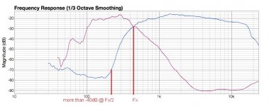

Well, to me this is clearly NOT a 12dB/oct slope on the high-pass, since at Fx/2 the TD4001's output is down by more than 40dB with respect to its level at Fx - see annotated attachment.
That's to be expected, since the natural roll-off of most horn-loaded compression drivers below the horn's cut-off (Fc) is between -24 and -36 dB/oct.
But I'm glad to see that you didn't expect the 6dB/oct electrical filter to result in a first order acoustical crossover 🙂
I'm not at all surprised. The TD4001 is a far more advanced driver than those old drivers - and I know it sounds excellent even when used by itself for all the mid-high range.
OK, that makes sense. So you're basically just using the TD2001 as a supertweeter for the very top octave. Nothing wrong with that.
Not sure about "most", but some certainly are. This still doesn't mean that it's the best way to filter a compression driver + horn, though...
Marco
