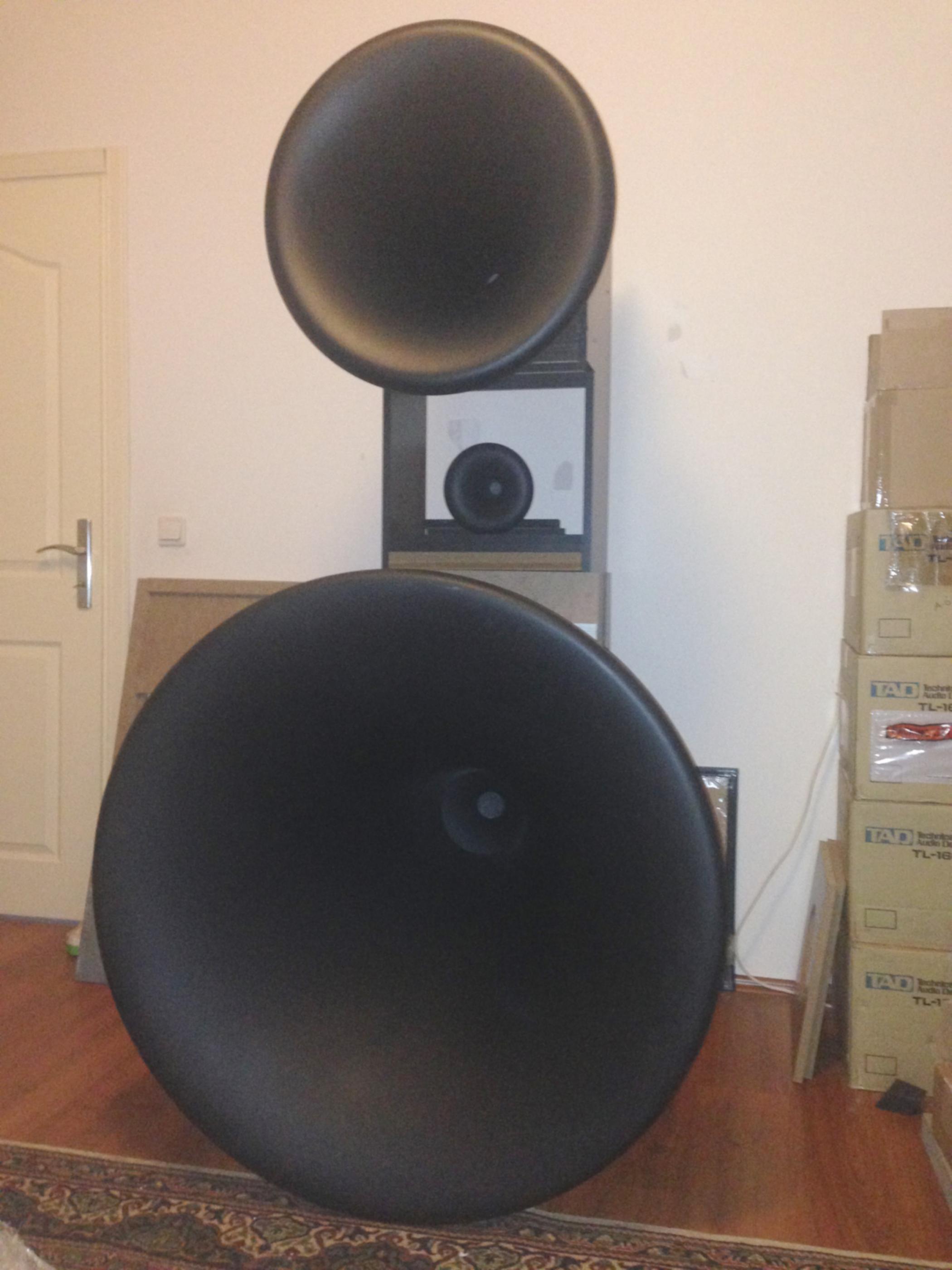

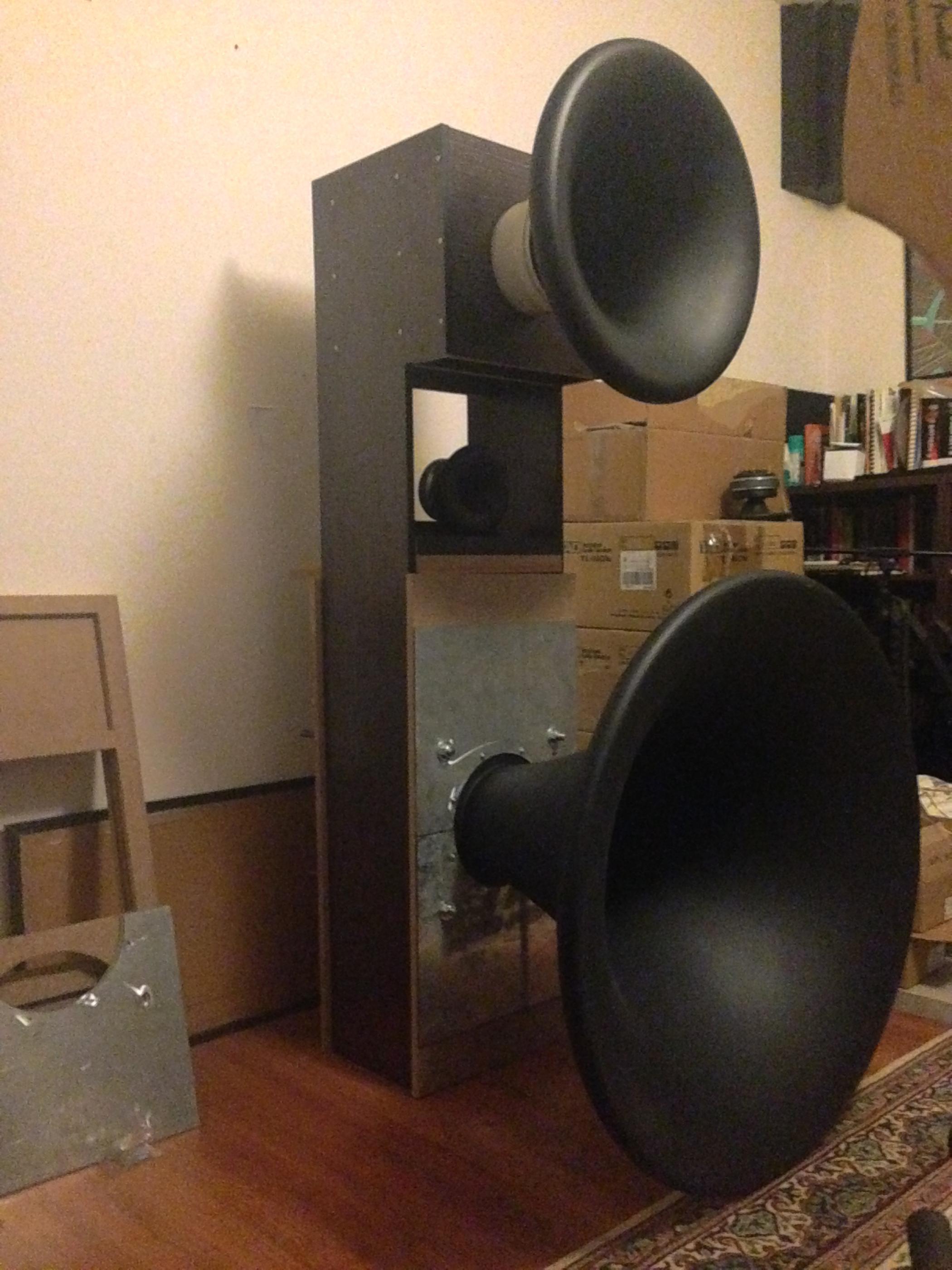

Here is some more progress. I forgot to take photos when tweeter was in place. The 1000jmlc with 475 is normally positioned on top of the fostex t500amkII's. Here they rest where the tweeters are supposed to be...
horn system
And think about 110hz Tractrix horn.
In bass i have 25hz tapped horn, midbass 95hz exponential (15inch driver), mid jmlc350, highs jmlc1400,

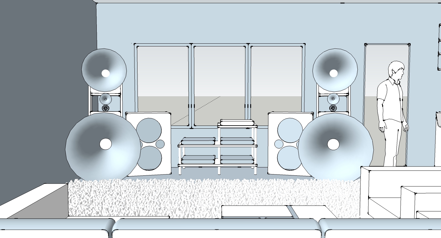

I also currently building horn system.and this is how they will be in my room 🙂

I am building a 5 way system with many similar components:
Fostex T500
Autotech Tractrix 1000 with Radian 475be
Autotech Tractrix 200 with JBL 2446 & Truextent
2 x Acoustic Elegance TD12M in sealed enclosure
Acoustic Elegance TD18H+ (with apollo upgrade) in 150 liter reflex
I use Groundsound 8 channel DSP and therefore i need to make a passive crossover between T500 and Tractrix 1000 with Radian.
My listening room is small so i must place the components as compact as possible.
I will follow your thread with interrest and remain with photo of my system when it is ready 🙂

Hey good to hear someone walking a similar path. You can ask me anything you would like to.
I love the Fostex and I am using it with my current system. I tried the Radian 475be and I really like it. They work quite well with fostex too.
I have minidsp but just to check the crossover points. I am doing it with one speaker, so 2x4 was enough for me to try. The bass I uild with TAD's have their filter already. Actually I am building just one speaker, testing everything with it in mono and then will build the second one. Change whatever needed with the construction etc.
I have listening distance around 2,5 meter. I hope i dont get trouble with vertical loobing.
