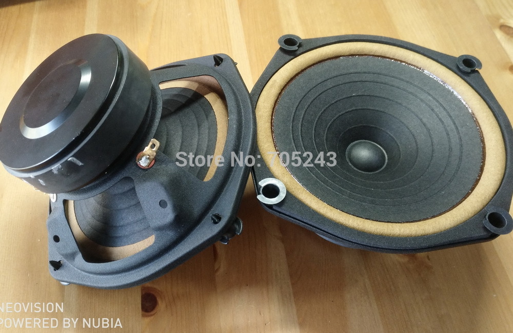

I have a pair of Diatone clones, would they work in FrugelHorn XL?
Speakers are well runned-in. I measured TS with Dayton DATS, and parameters are different from published. My results are:
Re 6.5--6.5
Fs 61.9--64.6
Qts 0.869--0.951
Qes 1.05--1.16
Qms 5.038--5.265
Le 0.153--0.151
M 7.034--7.125
Vas 23.24--21.07
Thanks in advance 😀

The Qts is kinda high, as is Fs. More in OB territory than box territory, but the measures are from DATS. What are th efactory numbers?
dave
dave
Qt is too high.
DATS isn't perfect but it's decent enough; while I'd expect it to indicate Q to be a little higher than under a higher voltage drive, it's rarely a giant difference. Unfortunately, mine has broken.

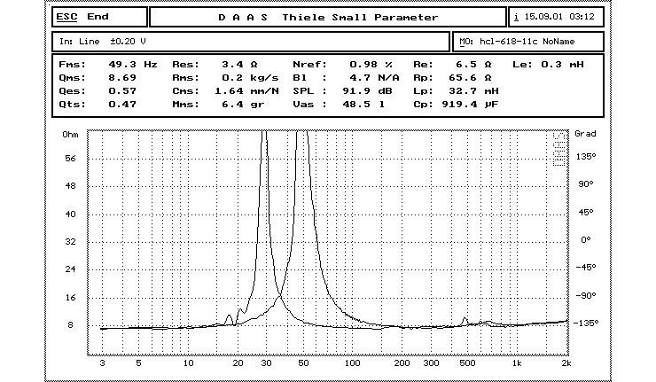

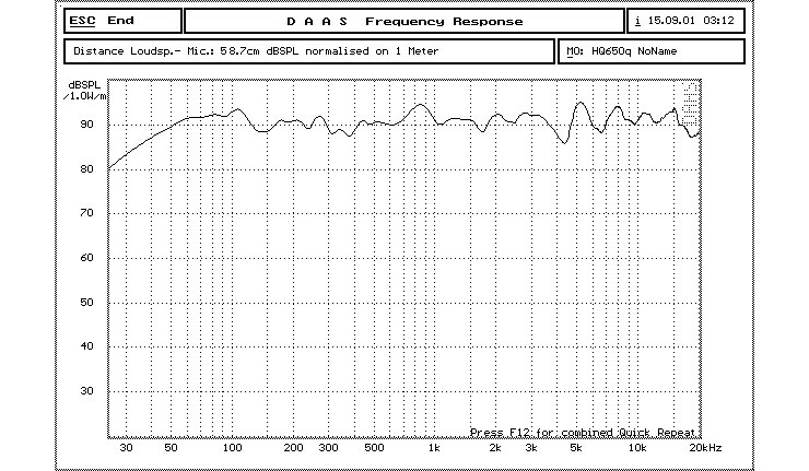

Thanks Dave & Scott. Numbers from factory are:
Fs 49.3
Qms 8.69
Qes 0.57
Qts 0.47
Re 6.5
Vas 48.5 L
You can see it in the response graphic, too. Pretty different from DATS, maybe mine is wrong? Or I made some mistake using it?
I've built several FrugelHorns (3 and Lite), and I'm very happy with all them. I would like to have an XL too, and need some pretext 😀
