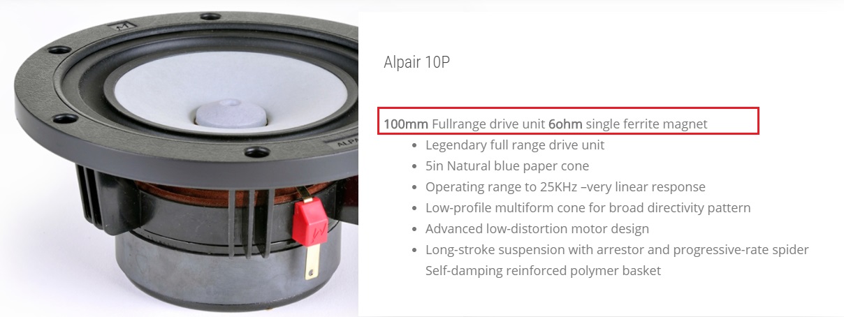

Hey, I see on the Mark Audio website mention of the 10p being 6ohm, however the datasheet appears to show that the impedence doesnt drop below 7.5 ohms throughout the frequency range. Can these drivers be safely used with 8ohm SET amp? Thanks
djhurley92,
The description on the Alpair 10P landing page on the Mark Audio website seems confusing/erroneous.
The DC Resistance (Re VC) of the voice coil of the Alpair 10P is 6.2 ohms according to provided specs.
For nominal impedance I recall that you can take Re VC value and multiply by 1.2. So that would be ~ 7.44 ohms which is close enough to 8 ohms... BUT you have done the right thing and looked at the impedance curve, as the impedance of a loudspeaker is not a static figure, and varies with frequency. So your eyeballing the curve shows you that the impedance doesn't drop below 7.5 ohms - so that should be a relatively easier load for your SE amp with 8 ohm secondary taps.
The nominal impedance is 8Ω. Typically an 8Ω nominal driver has a DC impedance (no reactance) of 6-87Ω.
