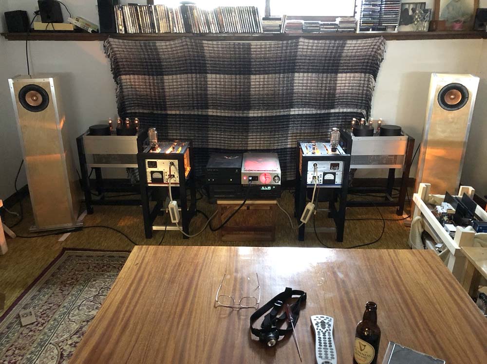

The most from Frugel Horn XL
I just had a transformative experience with my Frugel Horn XLs. It speaks to the above concerns.
I never before took my best little amp down to the basement to play on the XLs because I thought they needed more power than those two tiny watts. Boy was I wrong.
That “little amp” is a SET 45, home made of course. It just Rocks! The XLs are thriving, big bass... big bad *** bass in fact and they track every nuance so there is no lack anywhere in the timbre and tone.
I had thought I’d just once in a while play the XLs when the mood struck me and I wanted to listen to a small intimate recording. Who’d think that by going flea watt I’d discover the life I thought was denied them for their size and power requirements. They need just a couple watts, really good ones 😀
Sorry the pic posts upside down I find a way to fix it!😱
