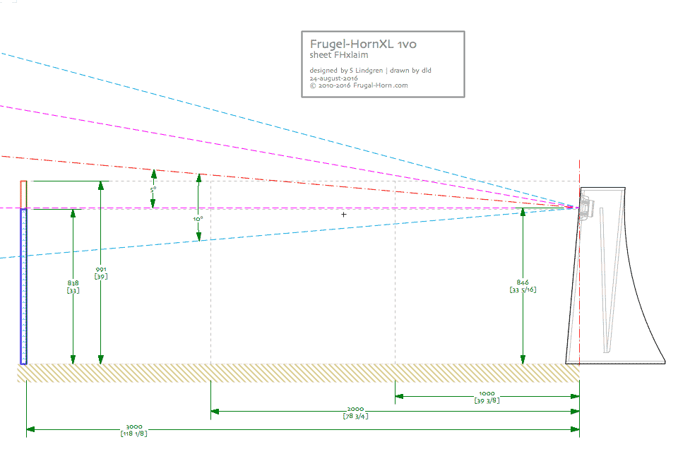

Questions on Frugel horn XL slope of front face… If my normal seated ear level is around 38 inches then I would be below the on axis at 10 feet and beyond . My question is what is the benefit of having the 5 degree tilt
One does not want to be listening on axis. Even with the tilt, off-axis is less than 5° unless your ears are really low.
You can skew the whole box 5° forward if you want to have a vertical baffle.
dave
Yes I understand the horn angles would have to remain the same, my listening seat would be around 10 to 10.5 feet from the speaker and if I set up straight my ears are at 42 inches but I have a tendency to slouch on the coach which puts me at 38 to 39 inches. Even so with the current design it's 41.45 inches on axis at 10 feet so not a problem, I was just wondering if the speaker (10 p) sounds better off axis or if it doesn't make that much difference. On some of my past speaker builds with conventional tweeters a vertical shift of + or - of 6 to 8 inches was noticeable. Thanks for the quick reply good forum.

Jim - like I said earlier, I've not noticed an issue with driver height in the FHXL - what I didn't say is that I'm using A10P as L/C/R in a 7.1 system, and they're all at much lower than ear height when I'm slouched in my cozy lazy boy (and I'm not a tall guy) .
I guess I somehow got stuck on that 5dg slope angle from the original Tysen build a few years ago, but the compact floor-standers and centre channel have it as well.
Of the numerous designs I've built or heard with this class of drivers over the past dozen years or so, there've been none that I can think of that differ ONLY in the presence or absence of such a slope - i.e. the performance due to other enclosure design features would almost certainly swamp that from tilt alone, and I've just been too lazy to tilt any to an upright position for comparison.

Pulled the data sheet from Markaudio Alpair -10P and looking at spl vs freq and looking at the upper response roll off at -15 degree, so for me I like a softer top end so it will probably be a good tonal balance for me at around 10.5 feet. What I have found in 2 and 3 way systems the off axis shows up in the integration of the tweeter and mid range. It looks like a good for go on the FHXL for my use.
