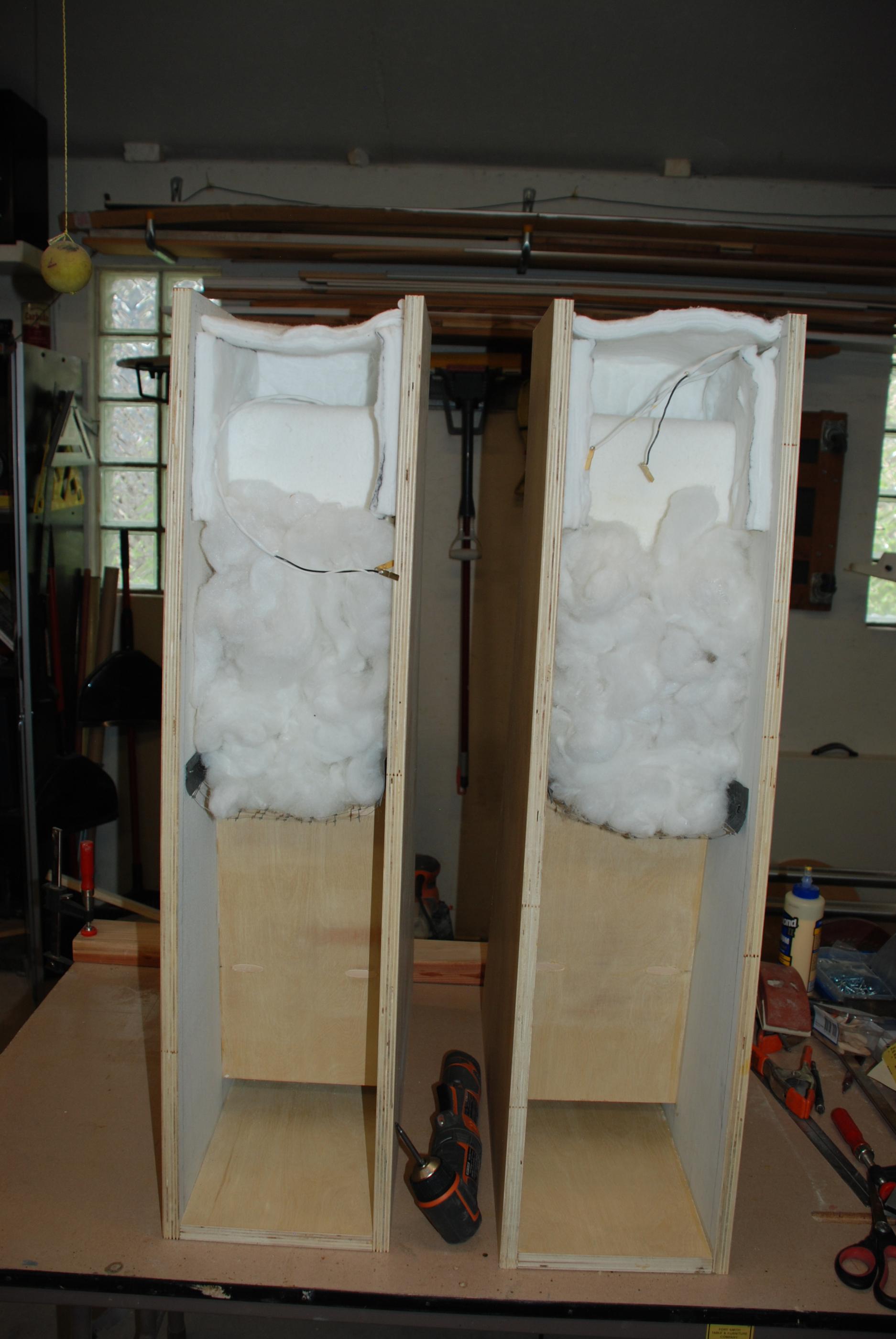

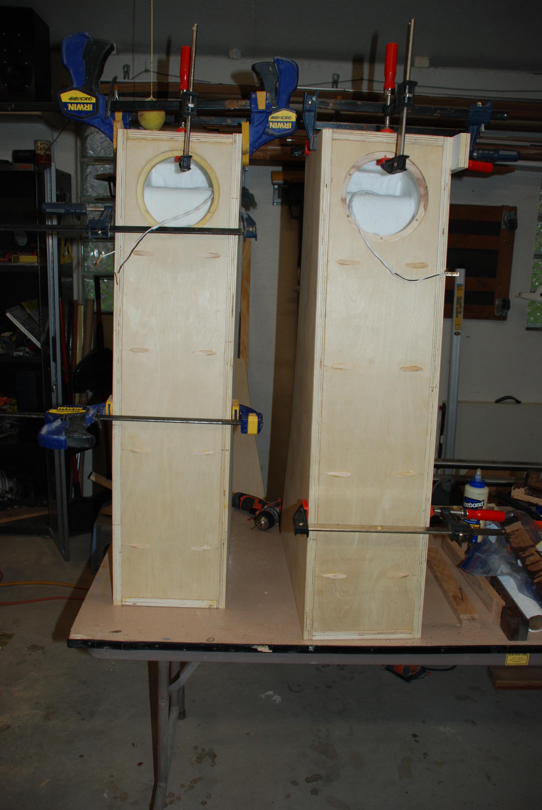

Hi Guys,
Just got my flatpack from Stefan (KJF audio).
Panels are nicely CNCed.
I already love them (vs Pencil).
That's a really good illustration of the build. The end results look really good, particularly like the outriggers. I hope the sound lives up to your expectations. The final positioning of the speakers will have quite an impact on the bass response, experiment with them closer to the corners of the room to realise the full potential.
Happy listening,
Ian
Happy listening,
Ian
At least closer to the wall. Ideally less than 18”.
dave

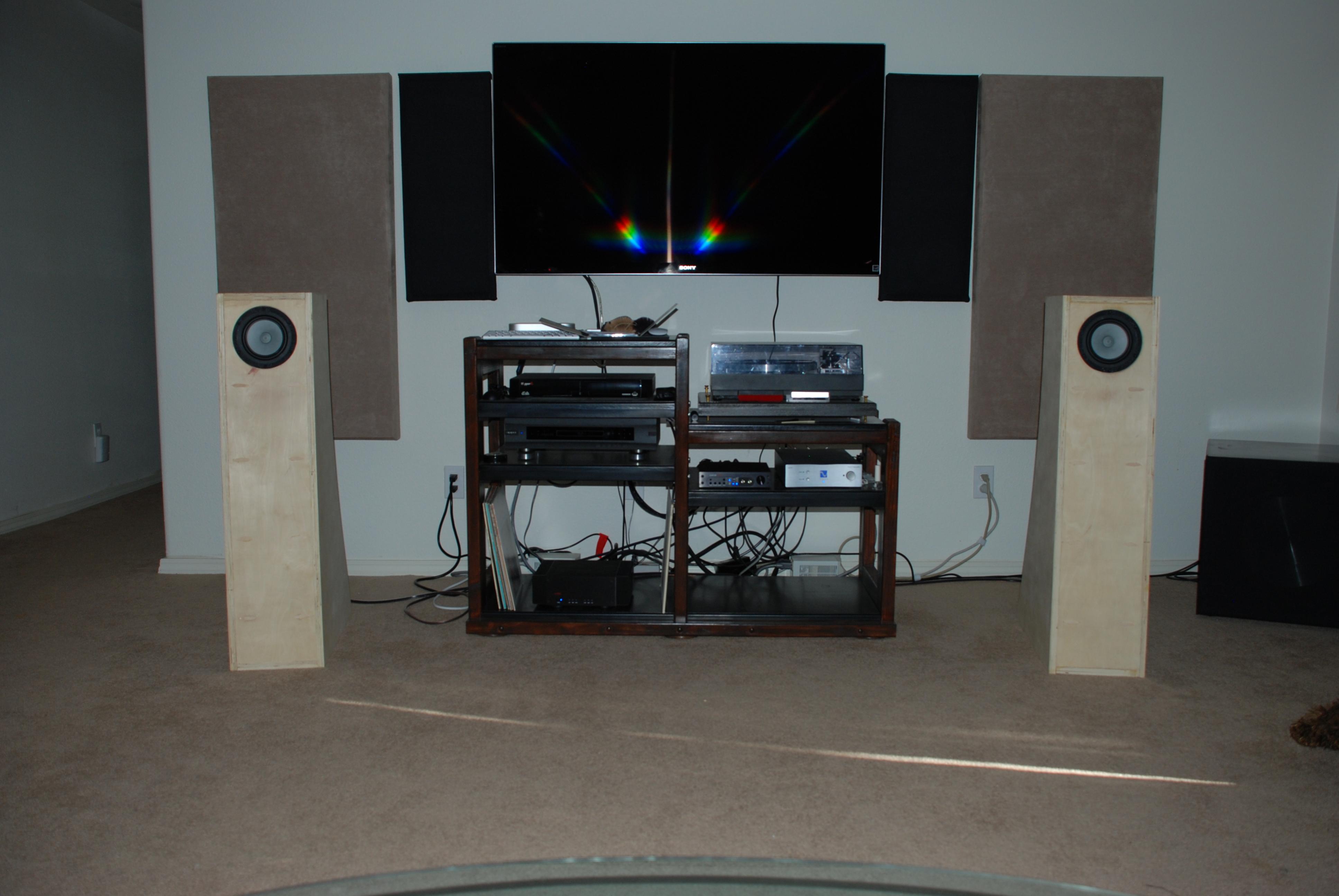

After the 400 hour break-in period, the mids and highs are to die for ... very articulate and musical. Bass is still shy and still finding the sweet spot from the wall
JoeyGS, nice pair of FH-XL! How do you find the sound?
Thanks Ian for the comment and as well as your build share.
I have adjusted the stuffing with 1 more iteration left and will decide on the best one. Final positioning is still being experimented on.

Getting there Dave .... and a little more running in for the bass to settle.
When you say closer to the wall, in my case, on the side wall or on the front wall?
dave
