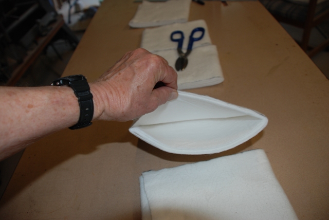

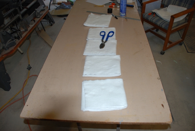

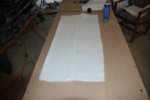

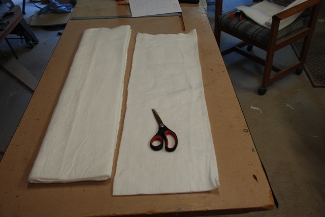

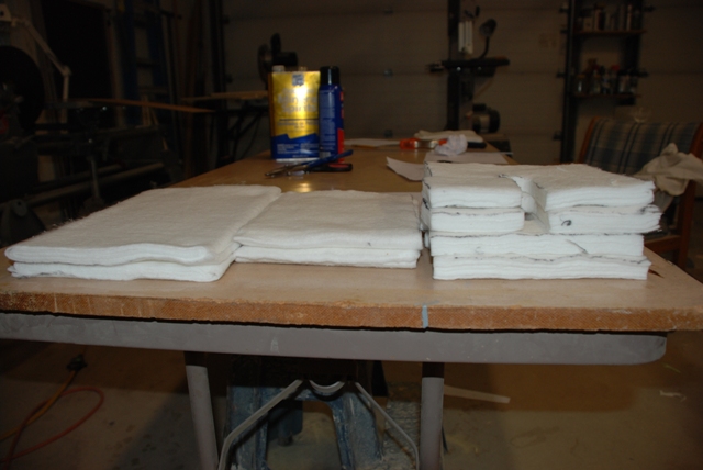

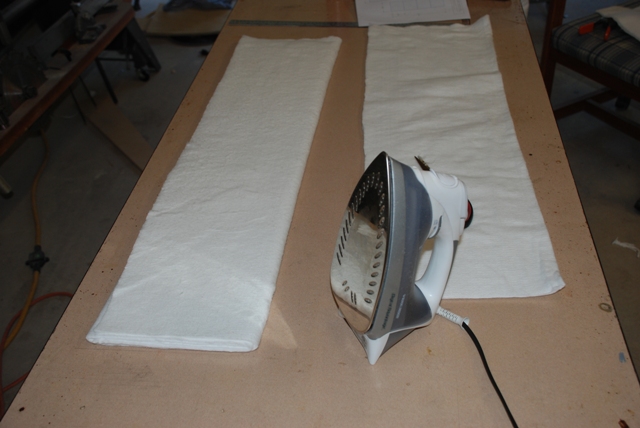

Making felt from cotton batting
Making ½ in felt from cotton batten.
Tools and materials
a. Iron
b. Tin shears
c. Tape measure
d. Cotton batting - I bought 90% cotton 10% binder from WalMart it came in 90 inch width and I bought
2 yards. About 6 folded layers is approx. ½ inch thick.
e. Spray adhesive, use in well ventilated area and wear long sleeve shirt and gloves. I used Loctite high
performance adhesive also from Walmart.
1. Cut one length at 38 inches then fold for the 8inch width until you get approx. ½ thickness then cut off
extra.
2. Iron the 8 inch wide folded up batting on both sides to form creases and compress batting.
3. Spray adhesive between folded batting.
4. Cut to size, then spray adhesive into loose folds and press batting to form felt.
5. Repeat for remainder of required felt.

I have the plans for FHXL, the problem was obtaining 1/2 inch cotton or wool felt. The post was to show how I used cotton batting to make a 1/2 in type of felt, the pieces are cut per the plan. The diy felt is denser than ultra bluejeans and probably less dense than wool, but I think it should work for what is intended. Thanks for the reply.

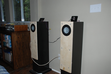

Can someone tell me the effects of more or less stuffing (below the driver) on low frequency response. I have looked at fh3 and this thread but have not found a answer.
Jim
Jim
to Jim M I put the same amount in the front , below the driver, as I did the V part and the bass is wonderful , but might have lessened the upper mids and high frequencies !!!I didn't play with it at all ... 30 grams each. I have the FHMK3 and am building the FHXL's
Since the enclosure only affects frequencies below circa 300hz, the loss in upper mids and highs cannot be due to stuffing, those are purely driver dependent...
What you might have experienced is too much boost in the lower frequencies (due to too little stuffing beow the driver), giving you the inpression that the mids and highs were affected....
