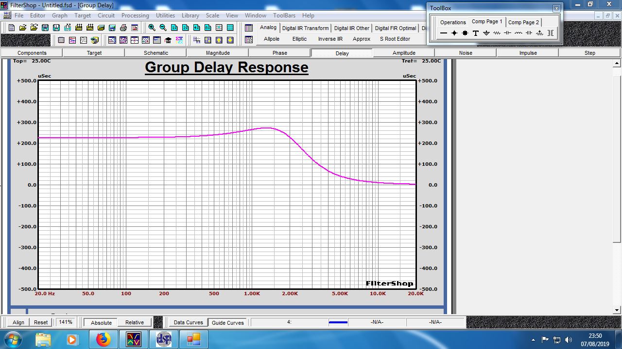

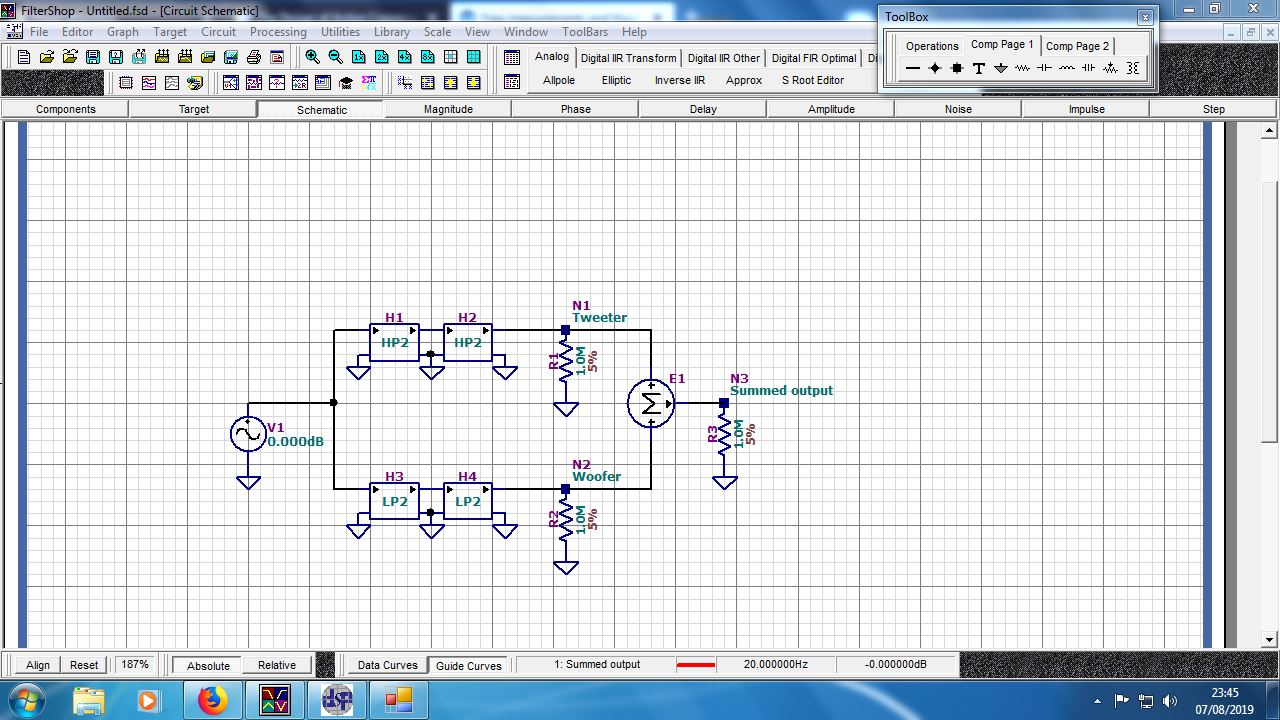

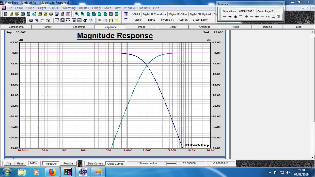

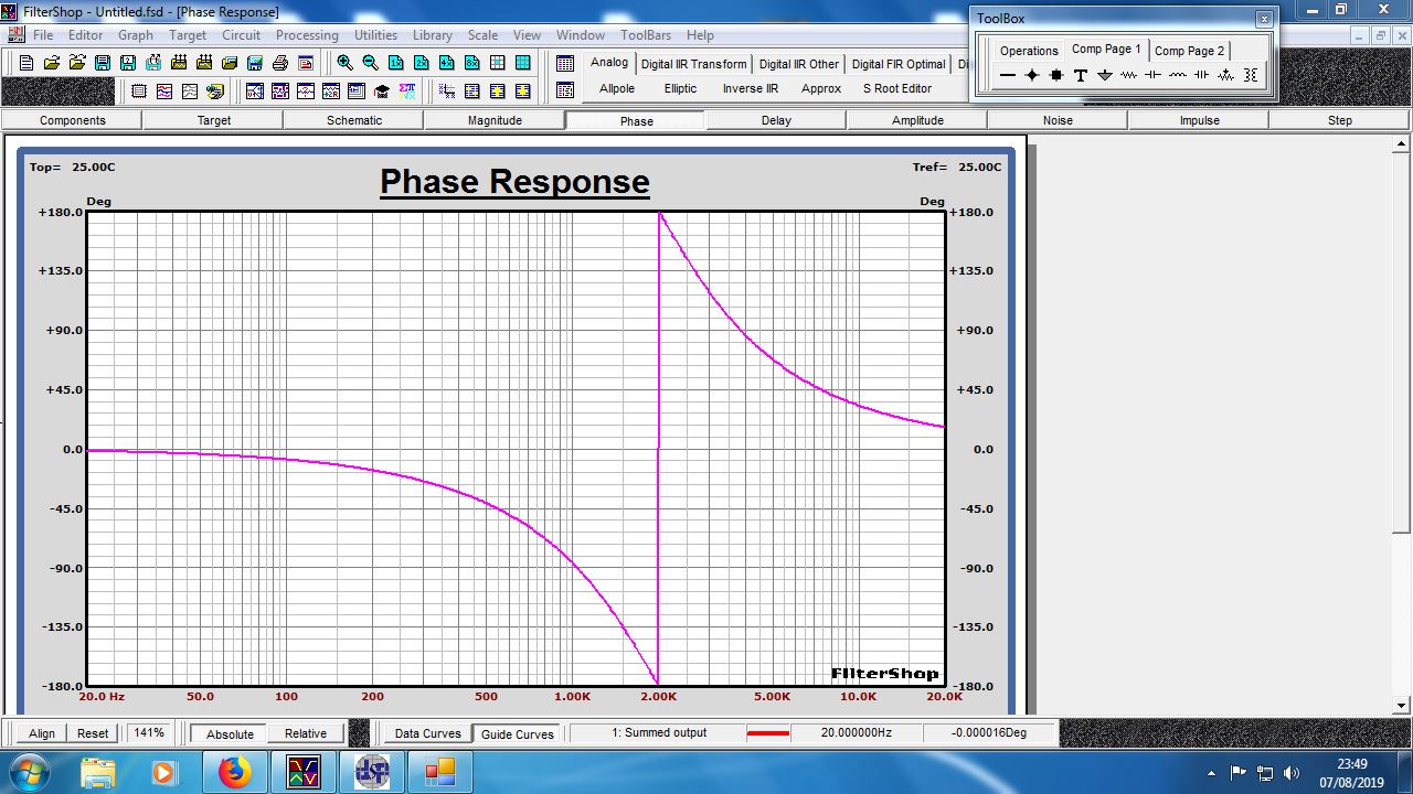

Hi Alan,
Please see attached sim of LR4 crossover. Note that all three phase resonses and group delay responses from LPF, HPF and Summed output, overlap each other.
Since the group delay and phase response of the summed output are not flat, but the summed output magnitude is, the response is therefore not minimum phase.
Peter
Hi Peter,
Thanks for the simulatuion, it's very useful to see what's happenening.
Can you please delay the high-passed driver's response with one cycle (360 degree, 1/2000=0.5 ms or 500 us) like Steve asked?
If all is true, then we'll see why crossover delay compensation doesn't work that way.

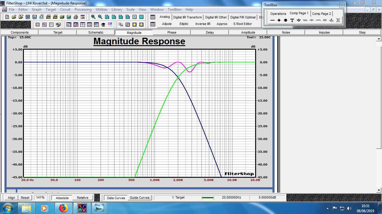

Hi Denibeni,
Here are the sims with a 500uS delay added to the HP section. I think these results clearly show that the phase tracking between the HP and LP through the crossover region is completely chaotic, resulting in the magnitude and group delay response irregularities through this region as shown. What this does highlight though is the need to compensate for the difference in acoustic centers between the various drivers.
Hope this helps.
Peter

Thanks Peter!
That's what I thought. As we can see, the phases are overlaps only at 2kHz, anywhere else the condition is chaotic.
This is why the delay is only used to compensate for acoustic center distances with symmetrical slopes or to provide minimal correction when the crossover curves are asymmetric and the phases do not overlaps at xo frequency.

You can't eliminate the 360 degree phase shift but you can't hear it either, so don't worry.
Peter's simulations shows what happens in the real world, i tried with my speakers.
