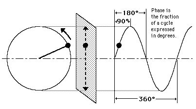

Can anyone explain how to read the Phase graph I attached Post Nº 48? It is all zig zag whereas I presumed it should be a straight Line?
I recommended before to you that you show minimum phase when using ARTA. What you are showing now is the total phase.
Delay is the same thing as phase lag/rotation. So when you measure the output of a driver from some distance away, the phase includes both the phase changes from the driver's own response PLUS the phase lag from the delay that results from the small amount of time it takes for sound to travel from the driver to the mic.
If you only want to see the phase from the driver itself, you can:
A. Select "minimum phase" from the menu in ARTA that determines what is shown on the screen
B. In ARTA, there is a way to manually enter an estimated "group delay", which is then subtracted out. You can play with the amount of group delay that is subtracted until all the "zig zags" are eliminated, or most of them at least

What you see as a "zig zag" is just the requirement to represent the total phase lag within the boundaries of -180deg to +180deg. When the phase "falls" (lags) below -180deg, 360 degrees are added on and the line appears again at the top of the plot. In reality the phase is continually decreasing, or "running downhill".
It's convention to only plot phase within these boundaries. You can also think of the phase angle in this way:
Think of a circle.
Now envision that you are looking at the end of a perfectly straight pipe or tube end-on. In this perspective it looks like a circle.
Envision that, with time, a dot is moving into the pipe, away from the end. Instead of traveling straight down the middle of the pipe, it is moving in a helical path along the wall of the pipe, like this:
The position in time of such a movement, as viewed from the end of the pipe where the pipe looks like a circle, is a point moving around the circle. You cannot see the "distance away" because of your perspective.
How would you describe the location around the circle? Maybe by "1 o'clock", etc.? Another way is to define the location of a "zero" point (it's arbitrary, but let's say it is where 3'oclock is) and then describe any point away from this in degrees, where 360 degrees are a full rotation around the circle.
As long as the movement continues clockwise, after one full rotation you might want to start counting the degrees over again at zero degrees. This is similar to the "phase wrapping" into the interval of -180 to 180 degrees on most plots. It's the same 360 degrees, just starting at the value of -180 instead of zero.
When I think of a sine wave propagating through space I like to envision the "helix" analogy I gave above. It is a way to explain phase and amplitude of a propagating wave.
