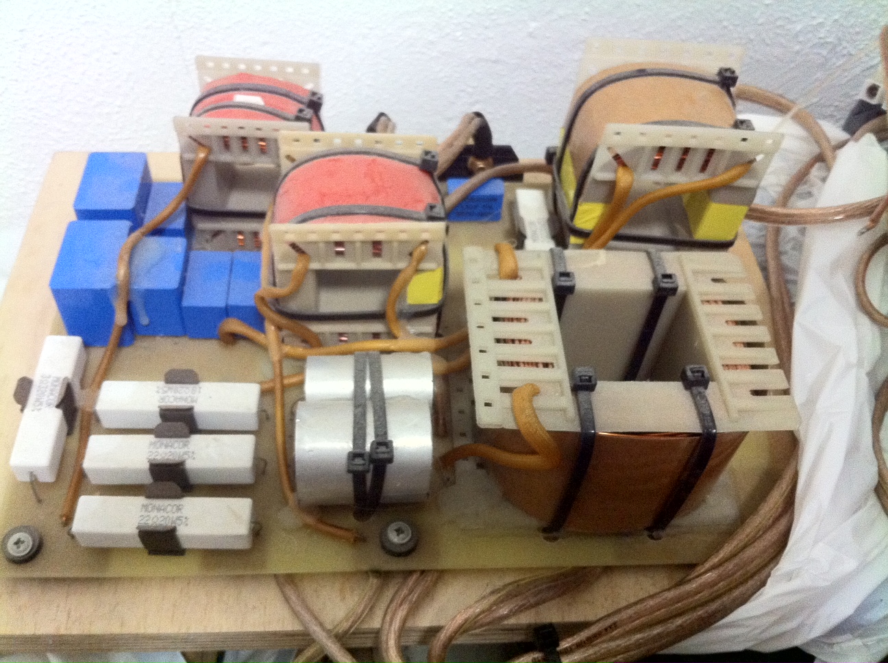

My question was whether a Passive XO can do everything a DSP can? I didn't think that a passive could do what a DSP can. I attach a photo of the passive XO that was designed for me. You may not be able to appreciate how large it is. At the moment (with one stereo amp) it still sounds better than my DSP with 6 amps. I do not have the circuit diagram and the person who designed it for me is now ill, so I don't want to bother him.
I still hope that my DSP solution will sound better when configured correctly.

The short answer is no. A passive xo cannot do everything what a DSP can, and the passive network can easily become too complicated if we try to copy the response of a DSP xo.
The biggest drawbacks of the passive xo is that the endresult depends on the driver's impedance and the xo network sits between the amp and the drivers.
The high impedance created by the xo network flushes the driver's Qes to the toilet and that's audible i think.

For good reason I wrote that the short answer is "cannot". Yes the long answer would be that you can do all the things passively, but i don't think it's worth the effort.
For example, please make us an LR4 curve from an LR2 in a few clicks and then set the timings of the drives with microsecond accuracy to each other in a minute and in a way that it only takes time. Sure, you can approach it passively, but it won't work the same way, i'm sorry.

If you think that a high impedance network (like a passive crossover) between the amp and the drivers is not spoil the driver's Qes, then i don't know what to say.

Sorry, the high impedance designation can be misleading as a very small (e.g. 0.1 Ohm) serial resistance (like an inductor's series resistance) may be sufficient to cause a measurable degradation of a driver's Qes.

0.1 ohms may seem comparable to the output impedance of an amplifier. In fact the most significant resistance in the damping current path is neither of those. It is the voice coil resistance, by an order of magnitude.
It does not matter what is the most significant resistance, the additional resistance is always evil because if it is in the circuit, it worsens the Qes. On the other side, the voice coil cannot be subtracted from the equation because without voice coil the driver cannot move and the Qes is measured with the voice coil in the circuit anyway.Neither do I. It just seems that the crossovers that were made for Steve are probably a good thing. I'm sure this won't sway Steve from experimenting for himself
