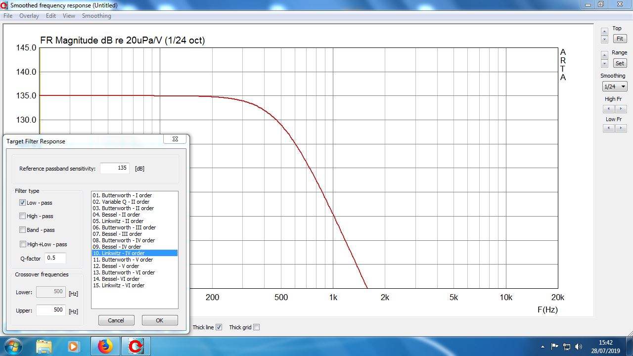

Hi Steve,
In one of the posts further back I think someone mentioned about the use of a target response. It is at this point that I think a target response would be of most benefit to you, since it will not only highlight the types of filters required, but also indicates the magnitude of some of the parameters of the filters. It is important to remember that the shape of the target curve determines its phase response, so if the acoustic responses don't accurately match the shape of the targets, then the summed acoustic response of the bass and mid-range will not be flat. It is not just a question of getting the crossover at –6dB, it is also necessary to get the phase response correct as well.
In practice, you may also have to apply a delay in the mid-range to account for the acoustic offsets between the two drivers.
To generate a target, just select “Generate Target Response” from the Overlay menu in the FR window as shown attached. It only takes two shakes of a Lamb’s tail and it’s done. Hope this helps.

Hi Steve,
The low pass filter section of an LR4 crossover is made from two Butterworth second order (BW2) low pass filter sections. The Butterworth filter has a Q = 1/sqr(2), so when 2 of them are connected in cascade to form an LR4, the combined Q = 1/sqr(2) x 1/sqr(2) = 0.5.
Please note that the Q of a 2nd order filter uniquely defines its magnitude and phase relationship and therefore an LR4 crossover cannot be constructed from a Q combination of 1 x 0.5 for example, because the unique magnitude/phase relationship will not be maintained. Hope this helps.

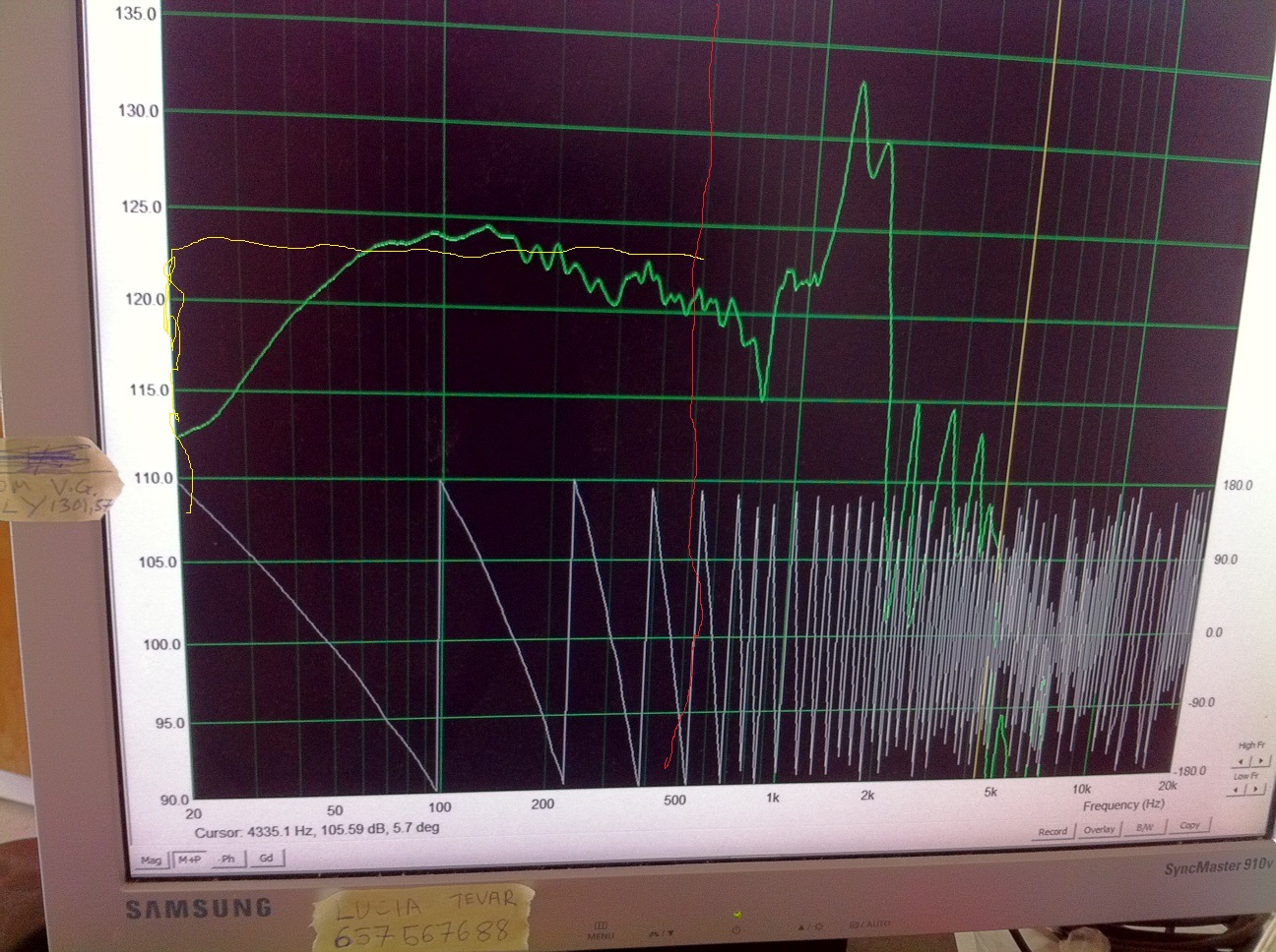

I seem to be more confused as this "progresses". I'm concerned about phase which I have ignored upto now.

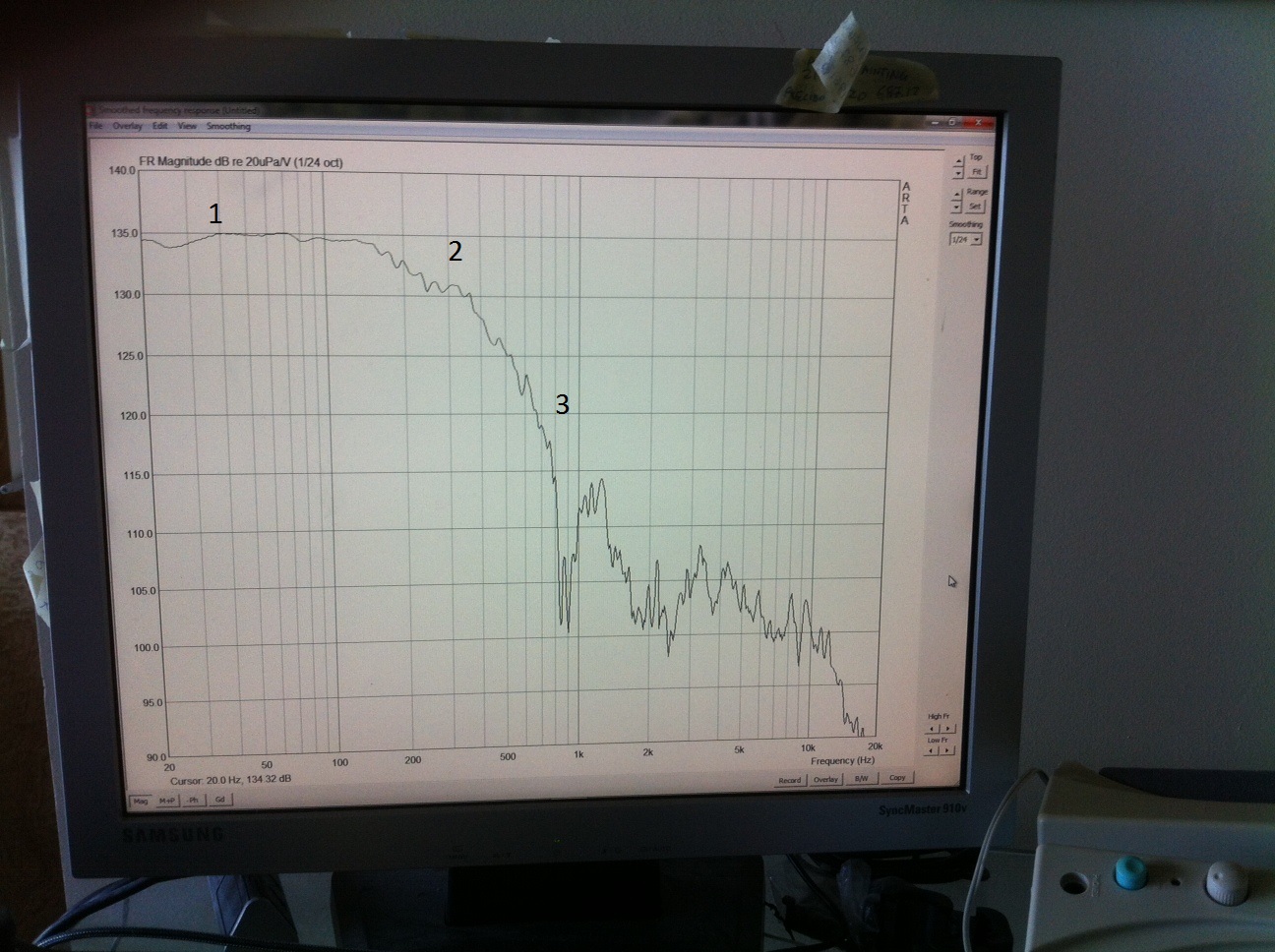

Going back to measurements:
In my post Nº56 I included some measurements ( which look nothing like the manufacturer's ). Could it be my mic, Dayton emm6 or interface Focusrite Scarlett Solo? Or me?
The woofer measurement was nearfield, no xo's no filters, other speaker channels muted
The Mid measurement was nearfield, no filters etc. others muted.
The Tweeter measurement was farfield, xo's were applied. Other speaker channels were not muted. The tweeter channel had LR4 Highpass at 2KHz
Are these measurements for Woofer, Mid and Tweeter enough? Or should I do Tweeter (near or farfield) with other channels muted?

If your woofer, midrange and tweeter responses are follows the desired slopes (now LR4 for easy understanding) then you have a good phase relationship between your drivers, you only need to adjust the timing (delay) of the drivers from here if needed.
So you need a tweeter only measurement too, to ensure it follows the LR4 slope.

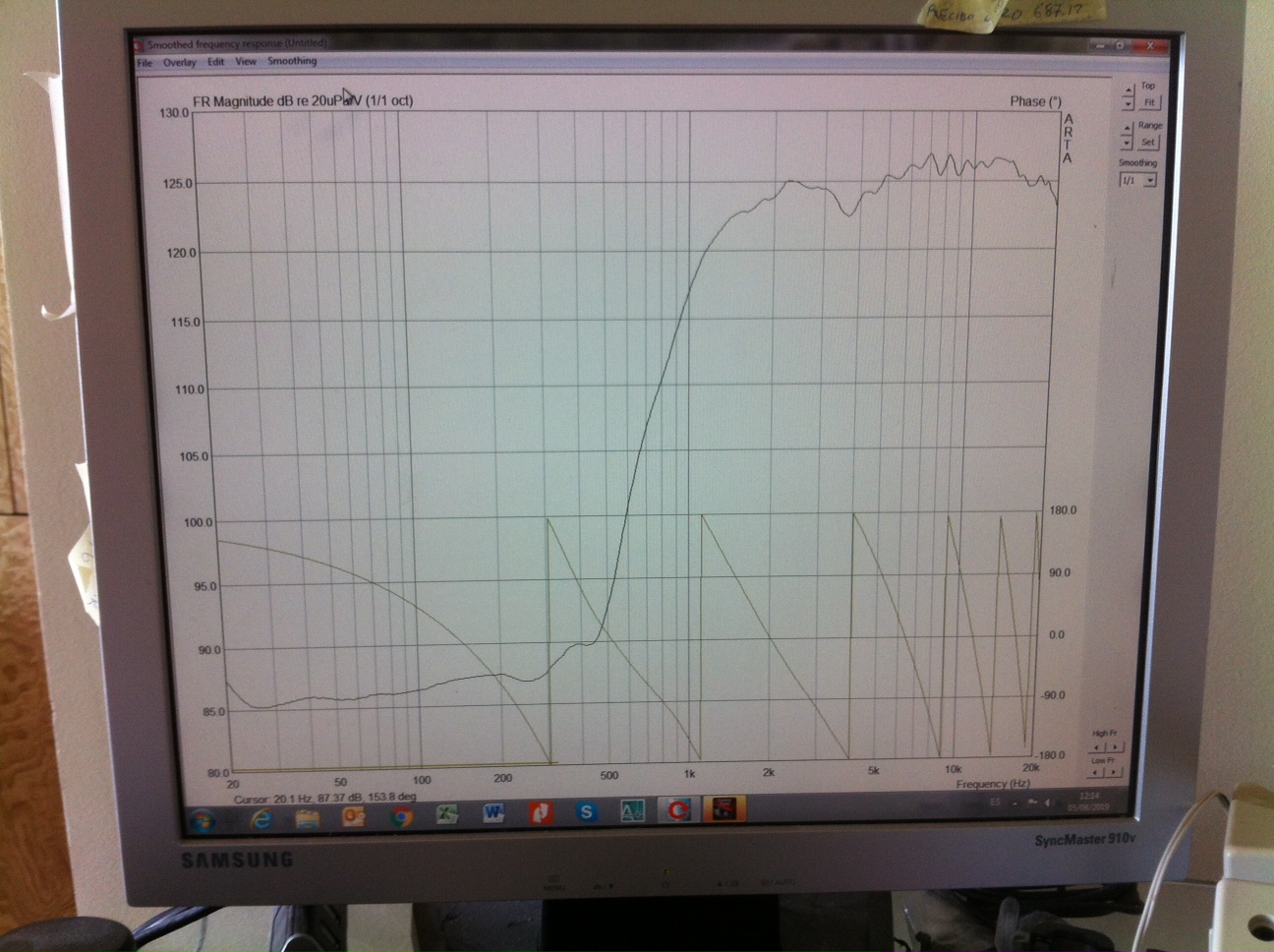

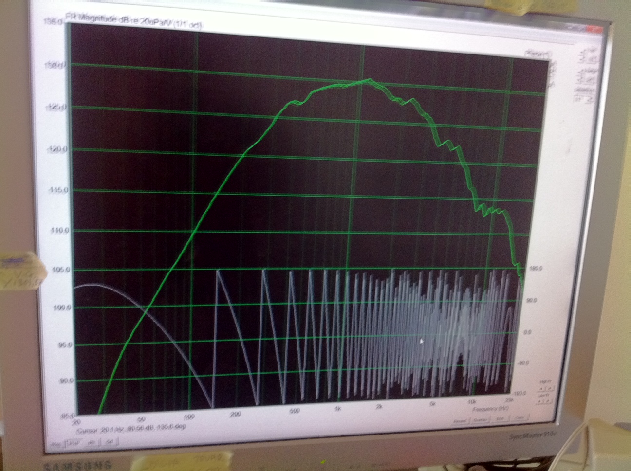

Done Tweeter Farfield Gated no filters except LR4 HighPass
Also attach previously posted Woofer only, no filters Nearfiels
And Mid only, no filters Nearfield

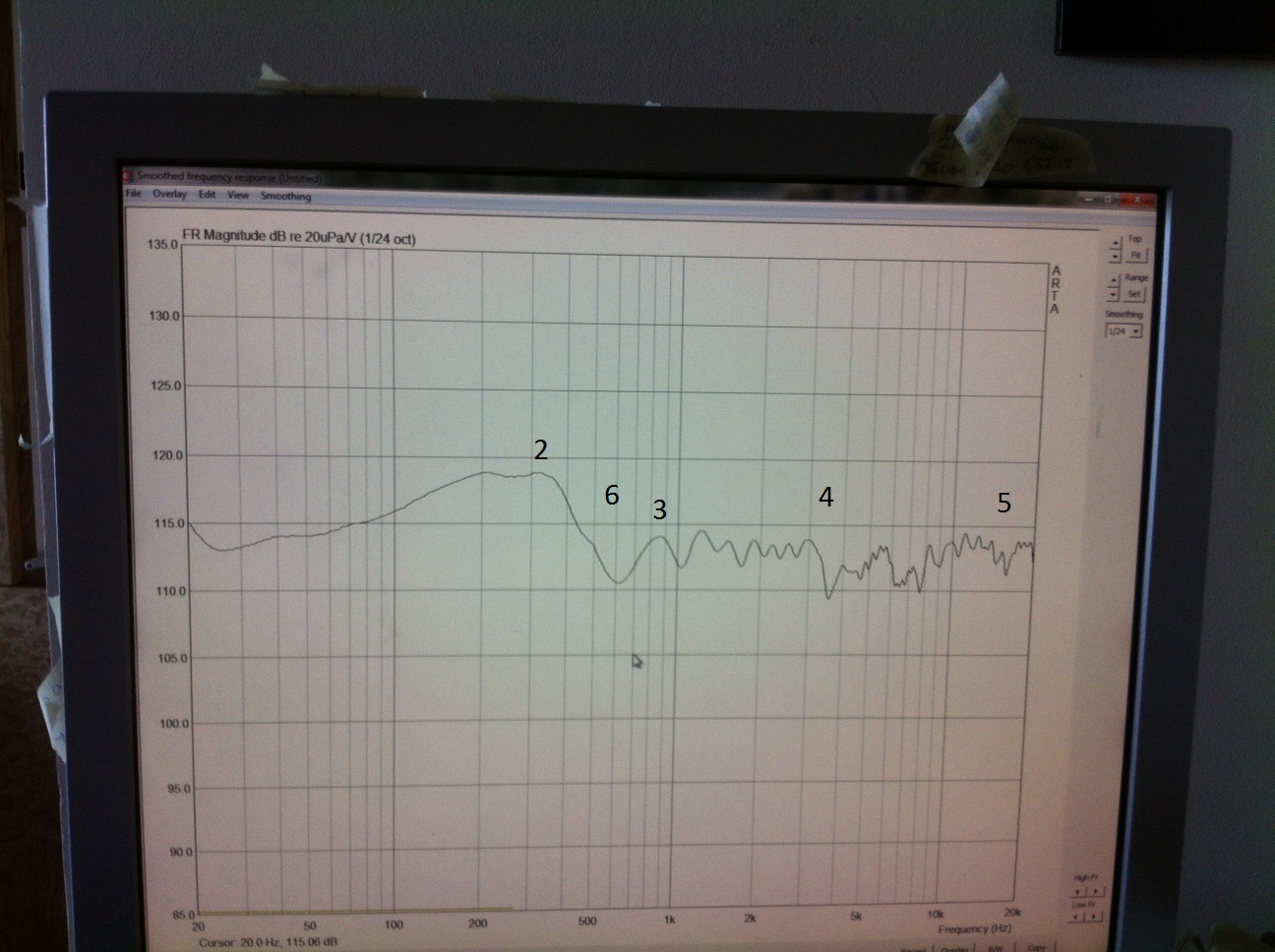

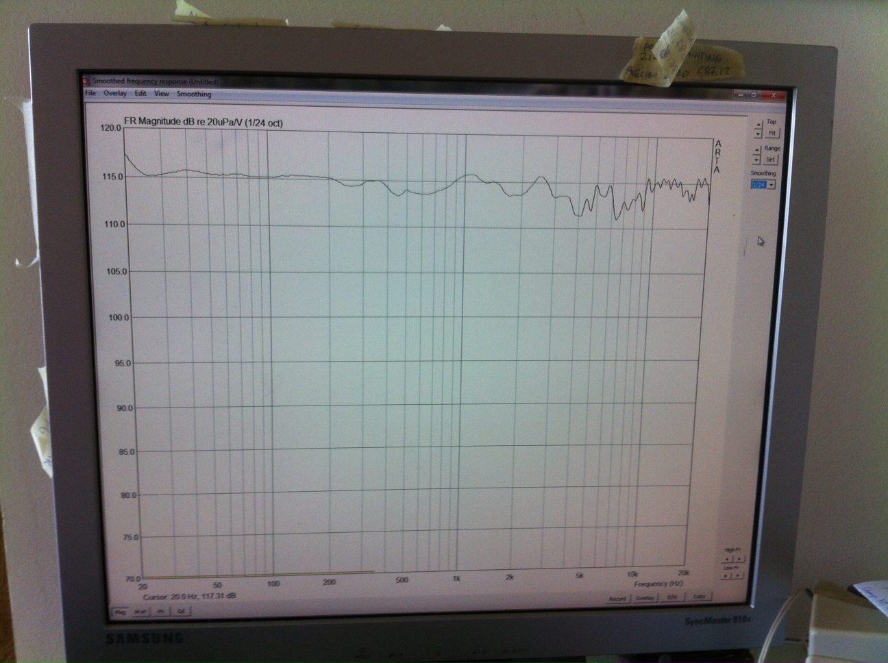

Then previously posted Farfield Gated Woofer, Mid, Tweeter with tweeter and woofer shelves
And today's Farfield all drivers with XOs and shelves but reduced Woofer gain

Ok, that tweeter response is clearly not looks like a 2kHz LR4 curve. A target response overlay would be very helpful here.
For example: 2kHz LR4 is -6dB at 2kHz and -24dB at 1kHz. You have around -4dB at 2kHz and -10dB at 1kHz, but the overlay can show the exact response you need.
Without overlay, good luck to create a 2kHz LR4 response from this, especially if you don't want to run the tweeter without xo filter (flattening-first method).
A farfield gated measurement for the midrange would be more useful than a nearfield response in my opinion, because of the high frequency limit of the nearfield measurement.
