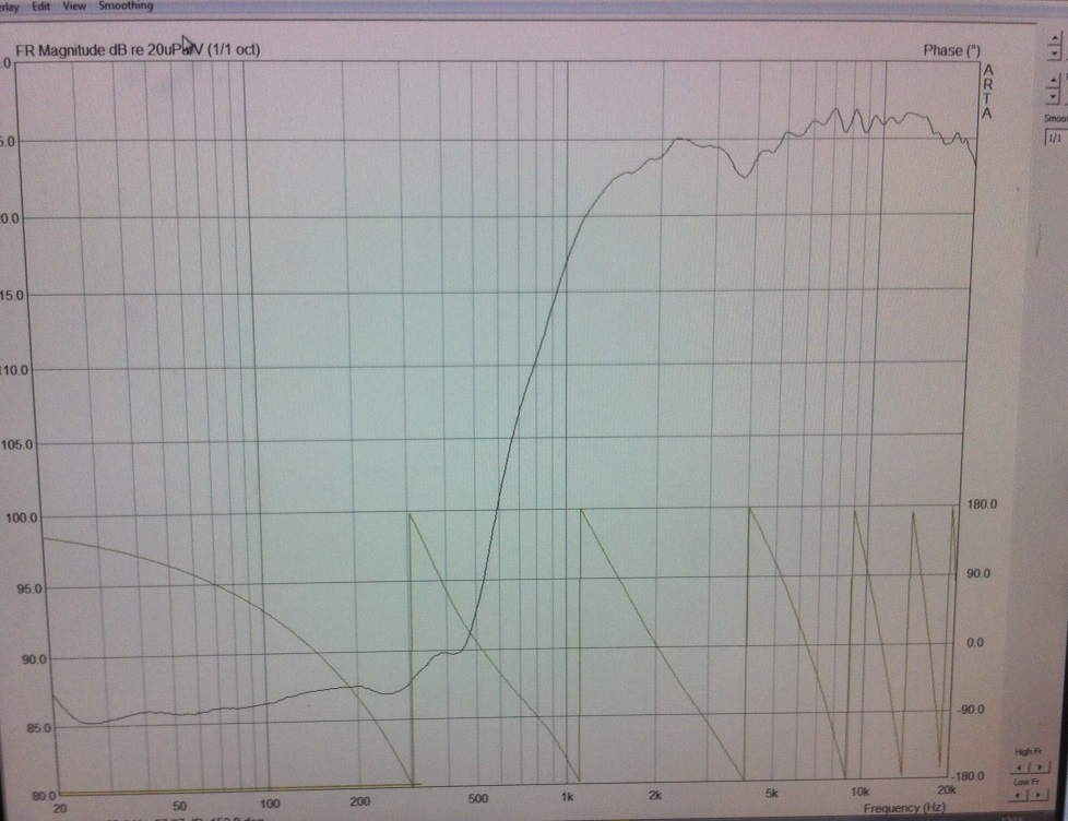

Attached farfield Tweeter HighPass LR4 at 1KHz. Still not good enough if the final XO at 2.5KHz? Does begin to slope down around 2KHz

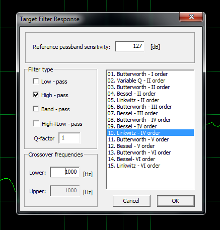

If you saved that measurement then please generate a target response overlay to it, like be seen in the following picture, and you can check yourself or post that overlayed response. Optimally, the target response and your tweeter's response would be exactly the same.
I cannot overlay but can note down curves.
By the way, with target curve high pass, I didn't think that lower crossover freq would make a difference. Only high crossover freq. It actually does affect the curve if you enter a different lower crossover freq???? For the purposes of this exercise I entered high crossover freq 1000 and lower crossover freq 1000 too

Target curve with LR4 at 1KHz (though final XO will be at 2.5KHz)
Starts sloping at 2 to 3KHz
at 800Hz = -10dB
at 600Hz = -20dB

Measured is a bit steeper than Target and natural, I suppose because natural and crossover are summed?

So we still do not know what is your tweeter's natural response in your situation. It looks different than in the published datasheet, even if we consider your 1kHz LR4 highpass filter.
If you want "better" crossover than your previous passive, it would be great to know your tweeter's response, or you need to learn how to generate target response in ARTA. In HFD you need to flatten the response first (without crossover) because it doesn't have target response generator.

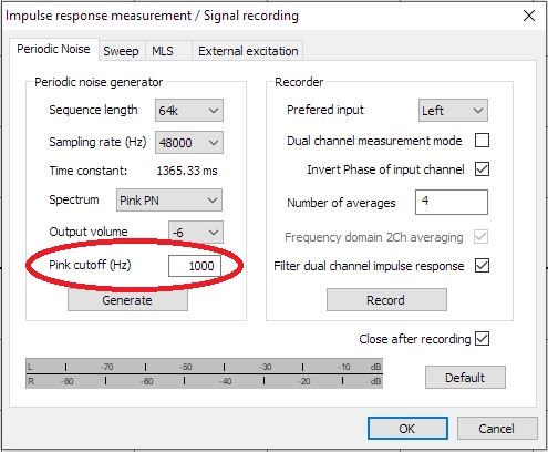

Are you aware of the "Pink Cutoff(Hz) function in ARTA that has a selectable HP filter used for making measurements on tweeters?
When a measurement is made with this function set to say 1KHz, the inverse of this function is then applied to the data after aquisition. This provides you with a frequency response of the speaker without the response of the 1KHz filter!
So you don't need to apply a 1KHz crossover to the tweeter in order to protect it from excesive low frequency excursion.

No was not aware. But I see that it is not available under "Sweep"?
Not used Pink Noise for measurement before

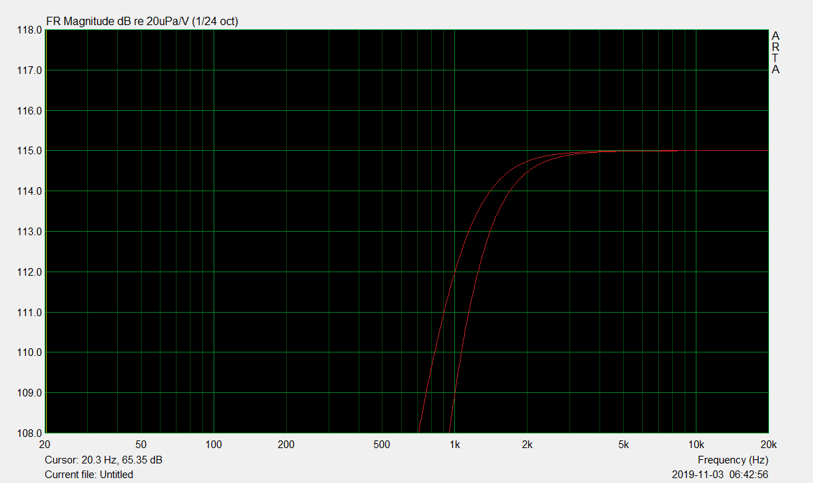

Yes, 1kHz highpass is usable for measurements for 2kHz and up, 2.5kHz and up is even better imo. My advice for xo point is still somewhere 2.5-3kHz.
Here is two 1kHz highpass response, one with BW2 (2nd order Q=0.71) and one with LR4 (two cascaded 2nd order BW2) for help.
As we an see even the LR4 is only around 0.5dB down at 2kHz. You can create these target responses in ARTA with ease, and it's useful.

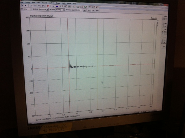

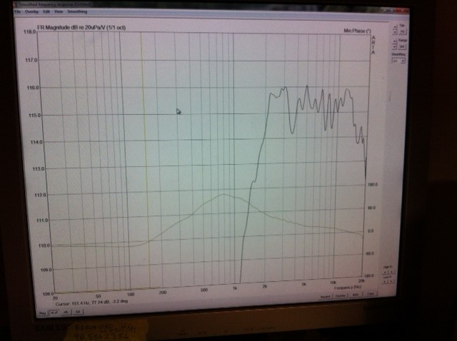

Just some questions on ARTA

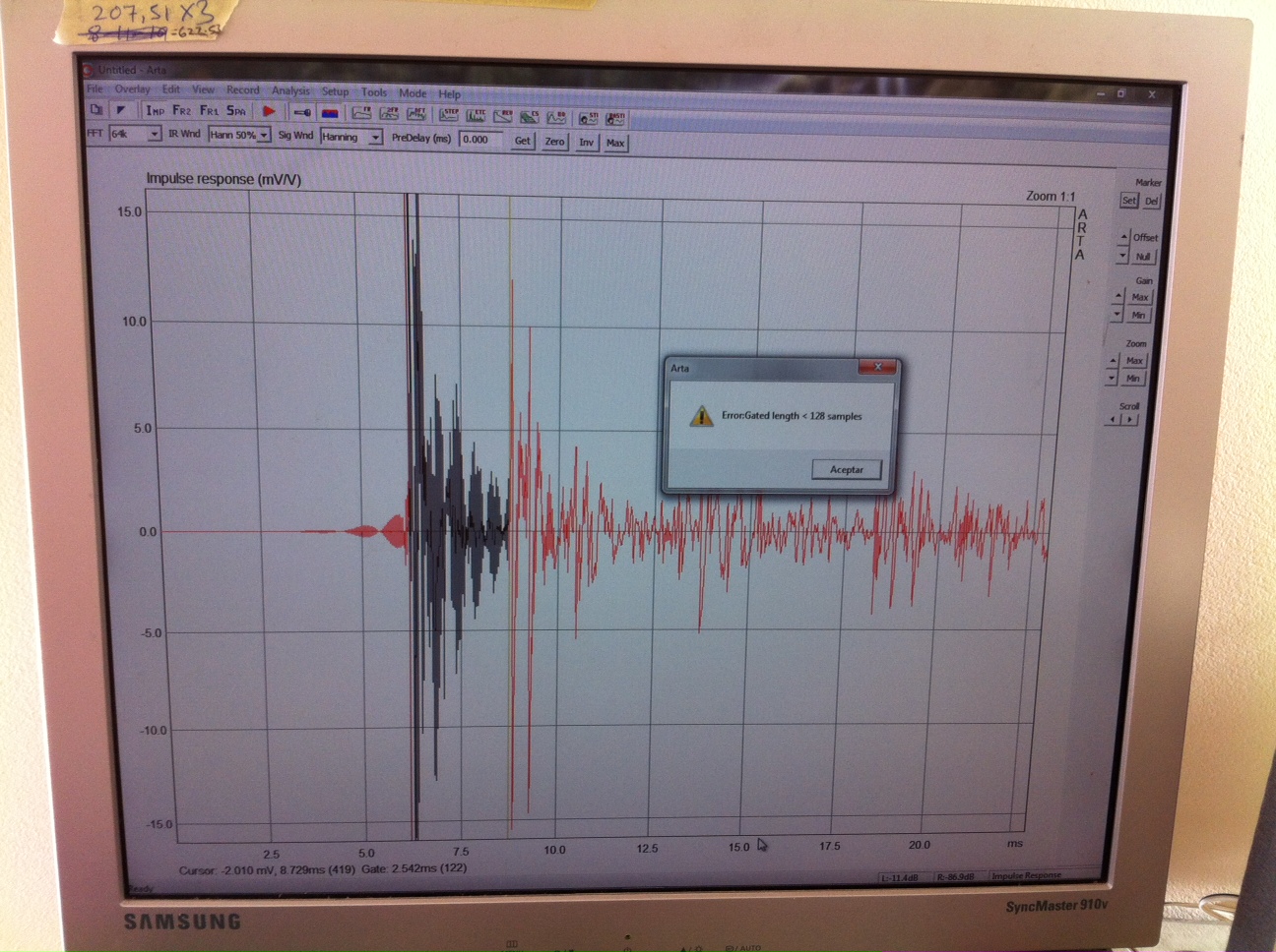

When try to truncate impulse measurement get:
Error:Gated length < 128samples
Need to go beyond 1st reflection in order to not get that message. See attached Trunc.jpg

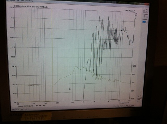

Then with smoothing 1/1 get approx +/- 1dB see smooth1-1.jpg
with smoothing 1/24 get approx +/- 7dB of the same measurement See 1-24.jpg
64k Sequence length is enough, but your impulse response looks strange to me. Please add little more gain in ARTA for better visualization.
