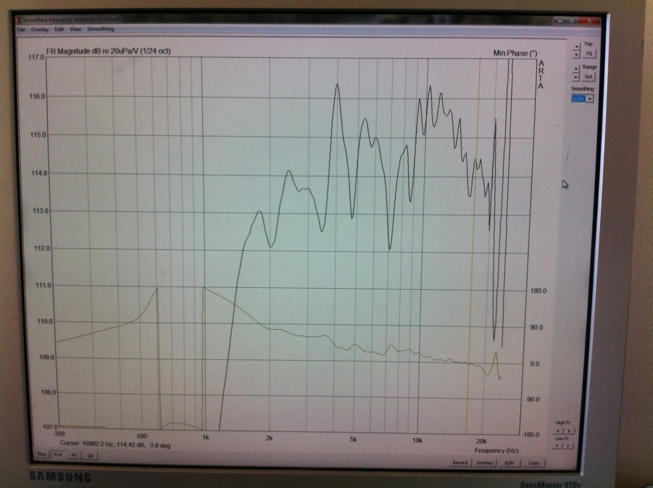

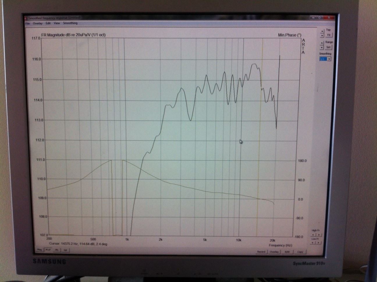

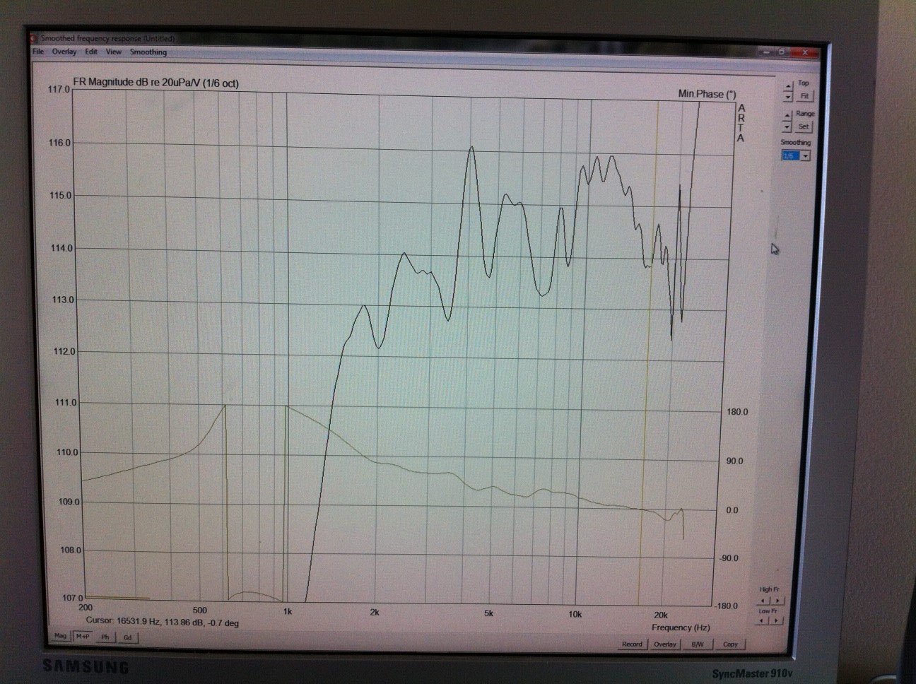

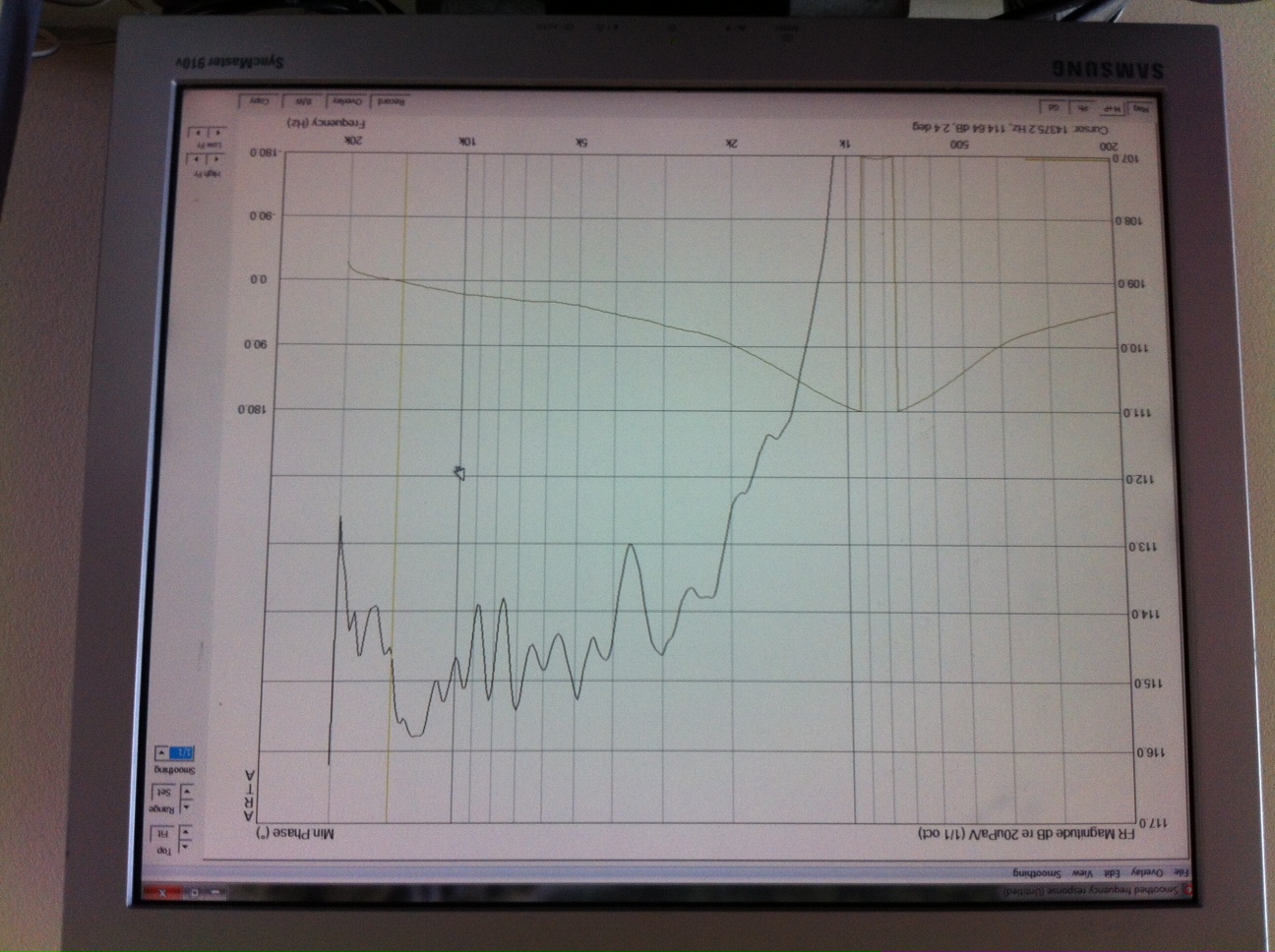

Freq measurements and Hypex Filter Design adjustments
I appear to have gotten better results now?
These are tweeter only measurements
The tweeter was protected with LR4 HighPass at 1KHz
This appears to influence the response at what will most probably be the final XO freq around 2.5KHz But will check with future Target Curve overlay.
The Filters added to this trial are:
BoostCut 7KHz Q=7.02 Gain -3dB
BoostCut 3.5KHz Q=3 Gain + 2.5dB
HighShelf 2 at 20KHz Q=0.7 gain +6dB
The smoothing has me baffled. 1/1 smoothing gives fluctuation of about +/- 1dB and 1/24 about 7dB
If I'm to flatten the response to about +/- 1dB, i'm fine with 1/1 but way out with 1/24?? What smoothing do I use for freq response flattening?
I presume 1/24 has more resolution?
Returning to the Filters, the 1st BoostCut seems to have overshot taming a peak. The second boostcut could do with some more gain taming the dip and the Highshelf2 doesn't appear to have flattened the slope down. So perhaps change to HighShelf2 at 15KHz Q=1.2 Gain 5dB?

Steve, you don't want to flatten every wrinkle and the 1dB scaling is disturbing visually, 5dB scaling would be enough imo. There is a copy button at the bottom right corner on the frequency response screen, you can save the measurements as pictures instead of photo shots, just a hint.

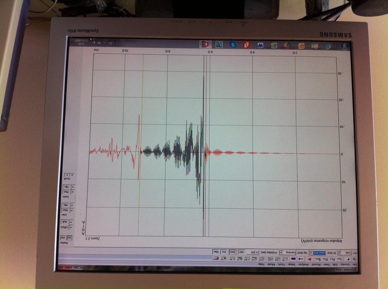

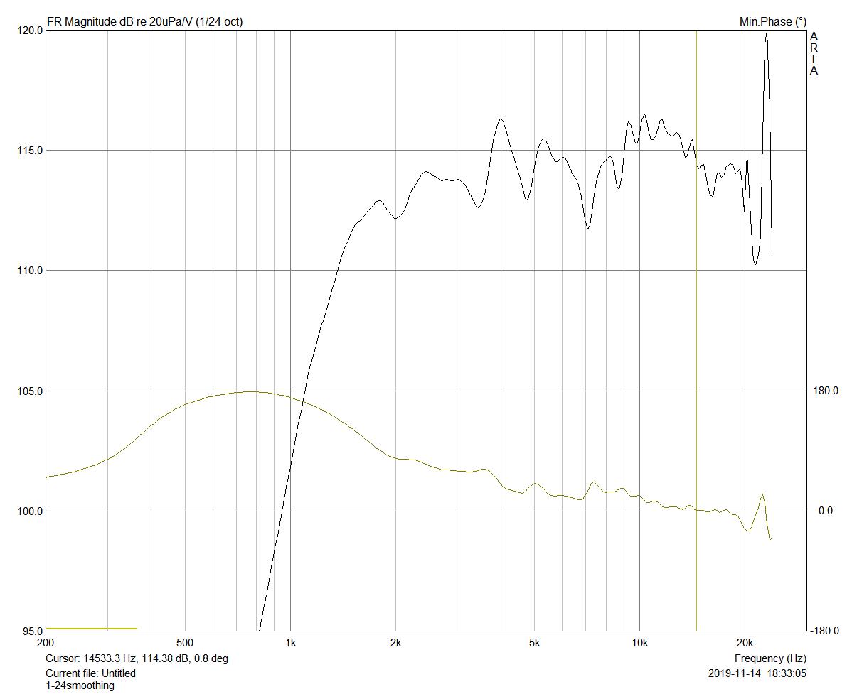

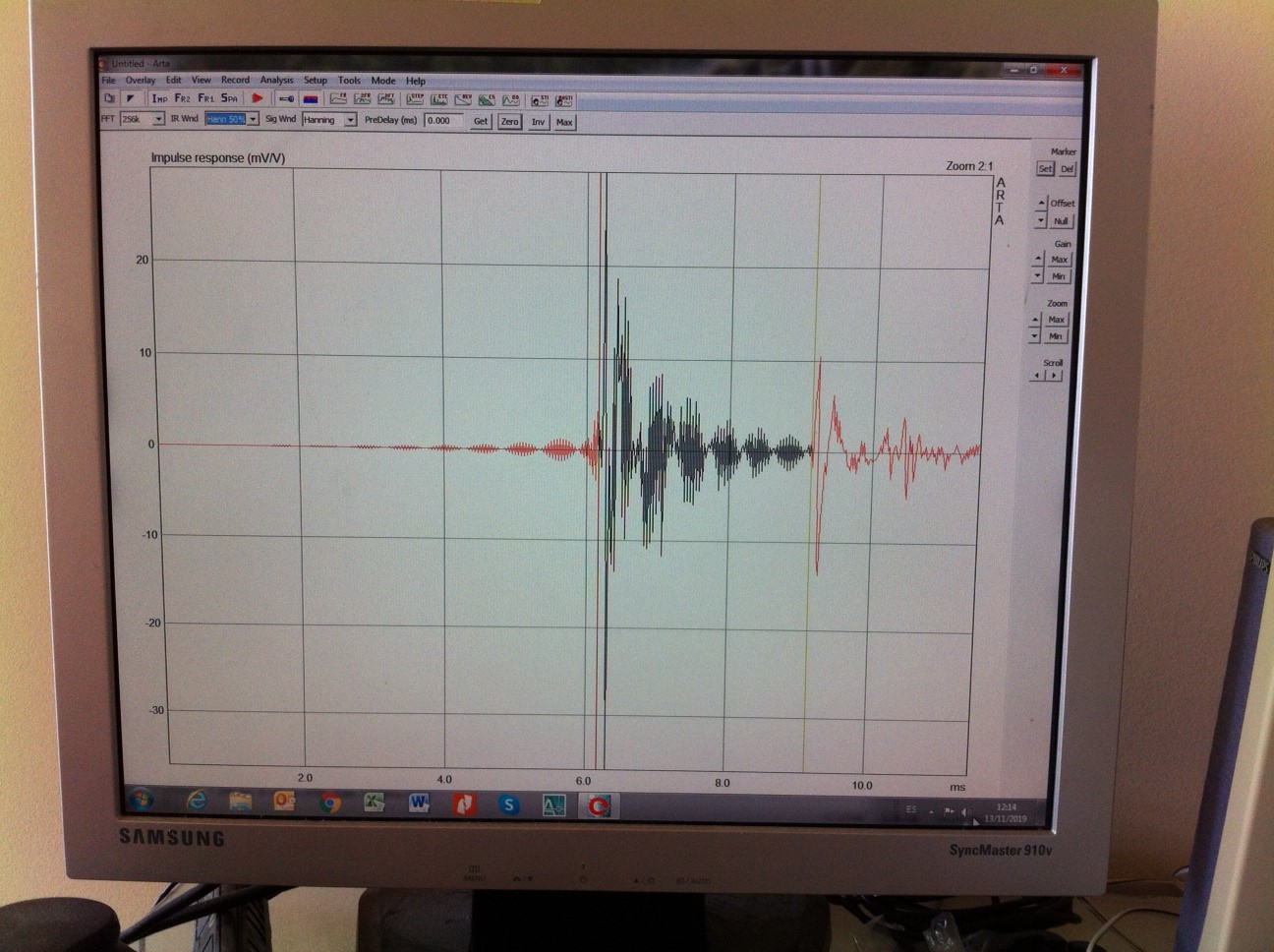

Attached are Impulse with gating
And measurements with correcting filters applied and with 1/1, 1/6 and 1/24 smoothing. These filters were meant to flatten the response of graph of Post 201 which unfortunatel was only shown at 1/1 smoothing.
Anyway the filters on today's graphs are (apart from the protecting LR4 HighPass at 1KHz):
At 3.5KHz BoostCut Q=3 Gain +3dB was to cure dip of approx 2.5dB. Only slightly improved
At 7KHz BoostCut Q=7.02 Gain -3dB was to cure Peak of approx 2dB. Now has become a Dip of -2dB with 1/6 smoothing. Still a small Peak with 1/1 smoothing. Perhaps remove this one?
Slope down from approx 15KHz not really cured with HighShelf2 at 20KHz Q=0.7 Gain +6dB
Perhaps better HighShelf2 at 15KHz Q=1.2 Gain +5dB

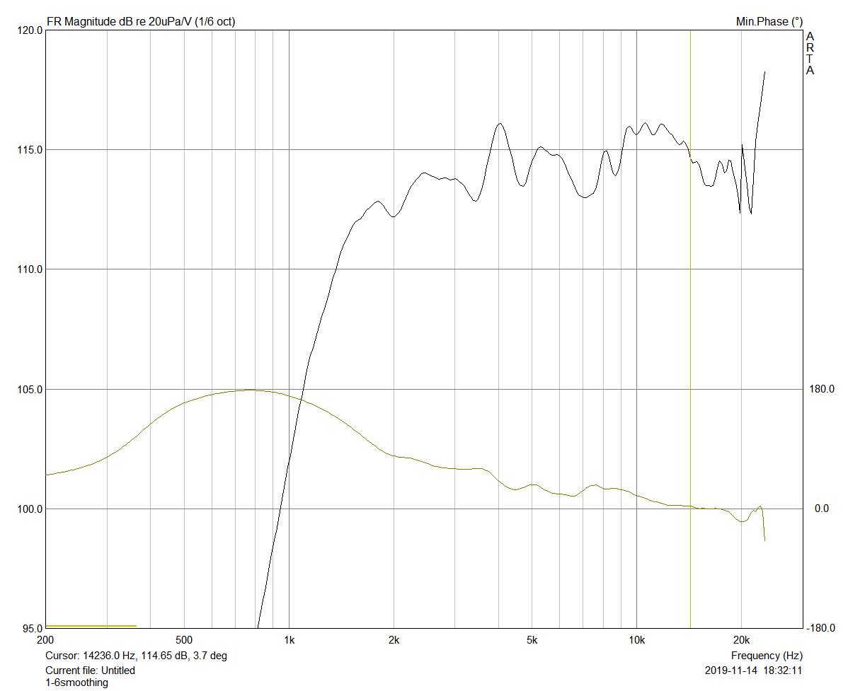

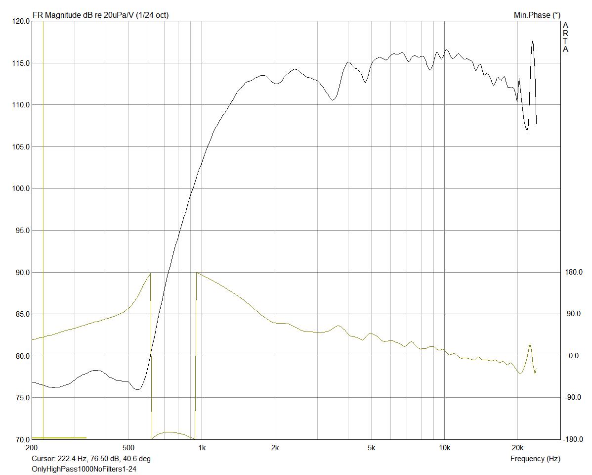

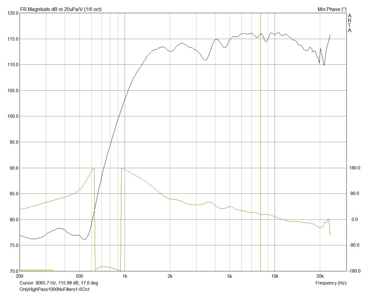

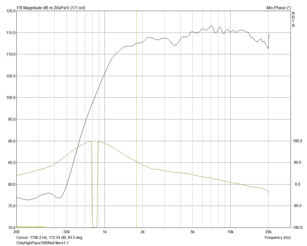

Just done measurement of Tweeter but with 1KHz HighPass, no other filters.
With 1/1, 1/6 and 1/24 smoothing.
Haven't quite got to grips with this smoothing. These measurement are to guide me to where to flatten and by how much. But what may be a Peak in 1/1 turns out to be a Dip in 1/24, making it difficult to decide whether to flatten?
I don't know what the problem is, but 1/1 octave smoothing shouldn't look like that, I think.
By the way, the response without the filters does not looks bad at all. I suggest to try a Q=2 boostcut -2dB at 6700Hz, plus a Q=3 boostcut -2dB at 10000Hz only.

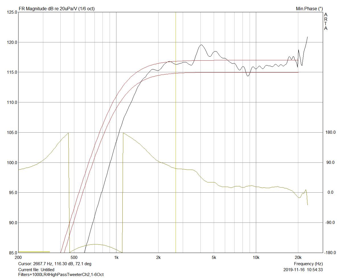

I attach plots of Tweeter measurements. Both with HighPass (protection), but the first without any other filters and the second with filters that I thought would flatten the response.
So the second has the following "flattening" filters:
BoostCut, Freq 2041Hz Q=3 Gain 2dB Hasn't really done much
BoostCut, Freq 3450Hz Q=3 Gain 4dB Seems to have decreased the dip.
BoostCut, Freq 4725Hz Q=3 Gain 3dB Hasn't really done much
HighShelf2, Freq 15000Hz Q=1.2 Gain 5dB This seems to have countered the slope down that started at around 13000Hz. Perhaps overdone and next time have a Gain of 4dB or change the Q??
What sticks out from the "flattened" response compared to no filter response, is the increased peak at approx 4000Hz. No filter was applied at this frequency, which leads me to believe that it has been affected by the filters on either side (at 3450 & 4725). And this leads me to believe that the Q's applied to these adjacent filters are wrong??
Does anyone know of rules/guidelines on how to apply Q's?
