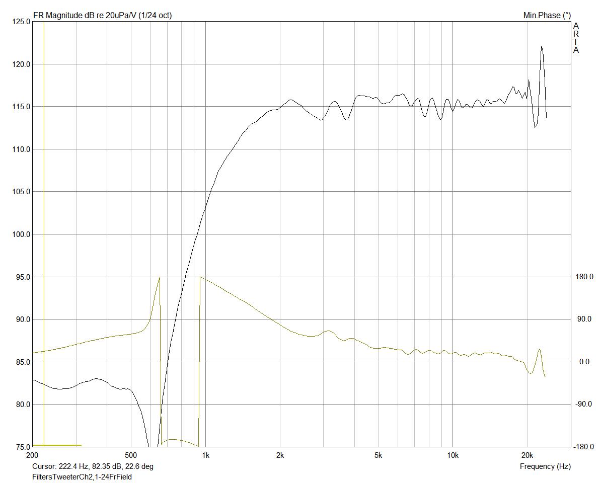

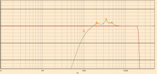

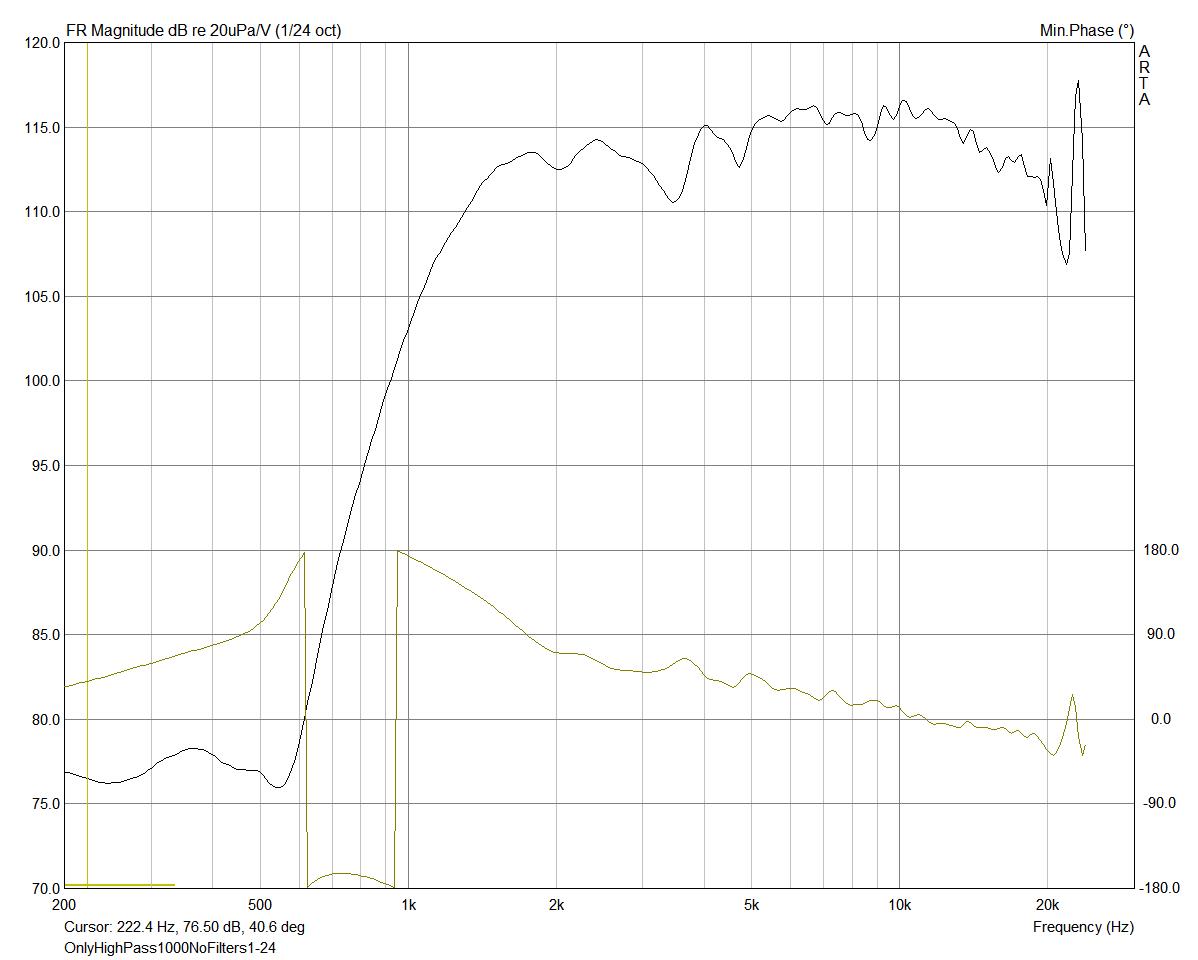

I would appreciate some help with my BQs especially Qs.
Attached HighPassed Tweeter response with no other filters and Highpassed Tweeter response with "Flattening" Filters applied. They seem to have worked except around the 2K to 4K region. I presume it's my Q's?? as I have guessed them.

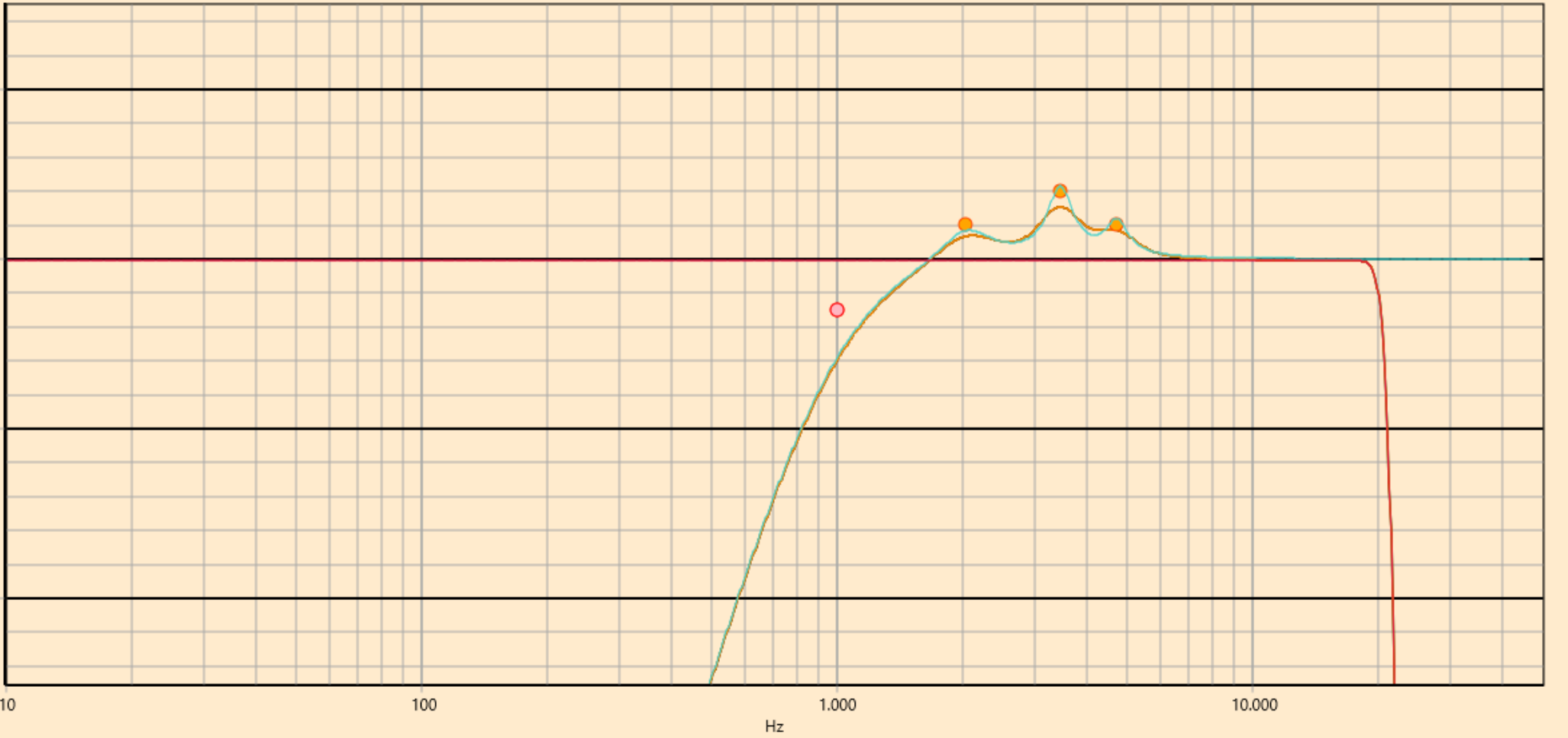

At 2,041Hz BoostCut Q=3 Gain+2dB, seems to have worked
At 3,450Hz BoostCut Q=7 Gain+4dB, seems to have created 2 new dips at approx 3K & 3.7K
At 4,725Hz BoostCut Q=7 Gain+2dB, seems to have worked
Any idea what has created the 2 new dips at 3K & 3.7K?

For Tweeter measurement 1m then gated to leave out reflectionsIs the mic distance to the tweeter exactly the same (mm?) as the previous ones - different distance, different results...
How far away are you measuring distance 10cm = mostly the tweeter, 1,5meter alot of room included?
Looking at the filters and Q's the dips are not caused by the filters. Also the frequency response >10K seems to be different from the first measurement which is strange if you've only applied these 3 boostcut filters.
Well spotted!!!!!
As I was only concerned about the effect of these BoostCuts, I did not tell you that I had HighShelf2 Freq 15000Hz Q=1.2 Gain +5dB to get rid of slope down.
Well spotted!!!!!

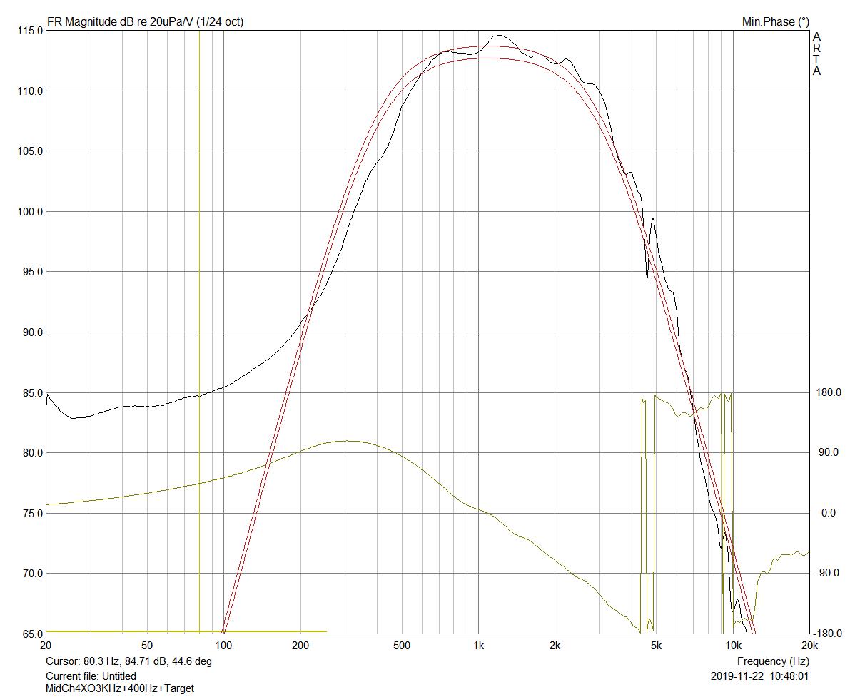

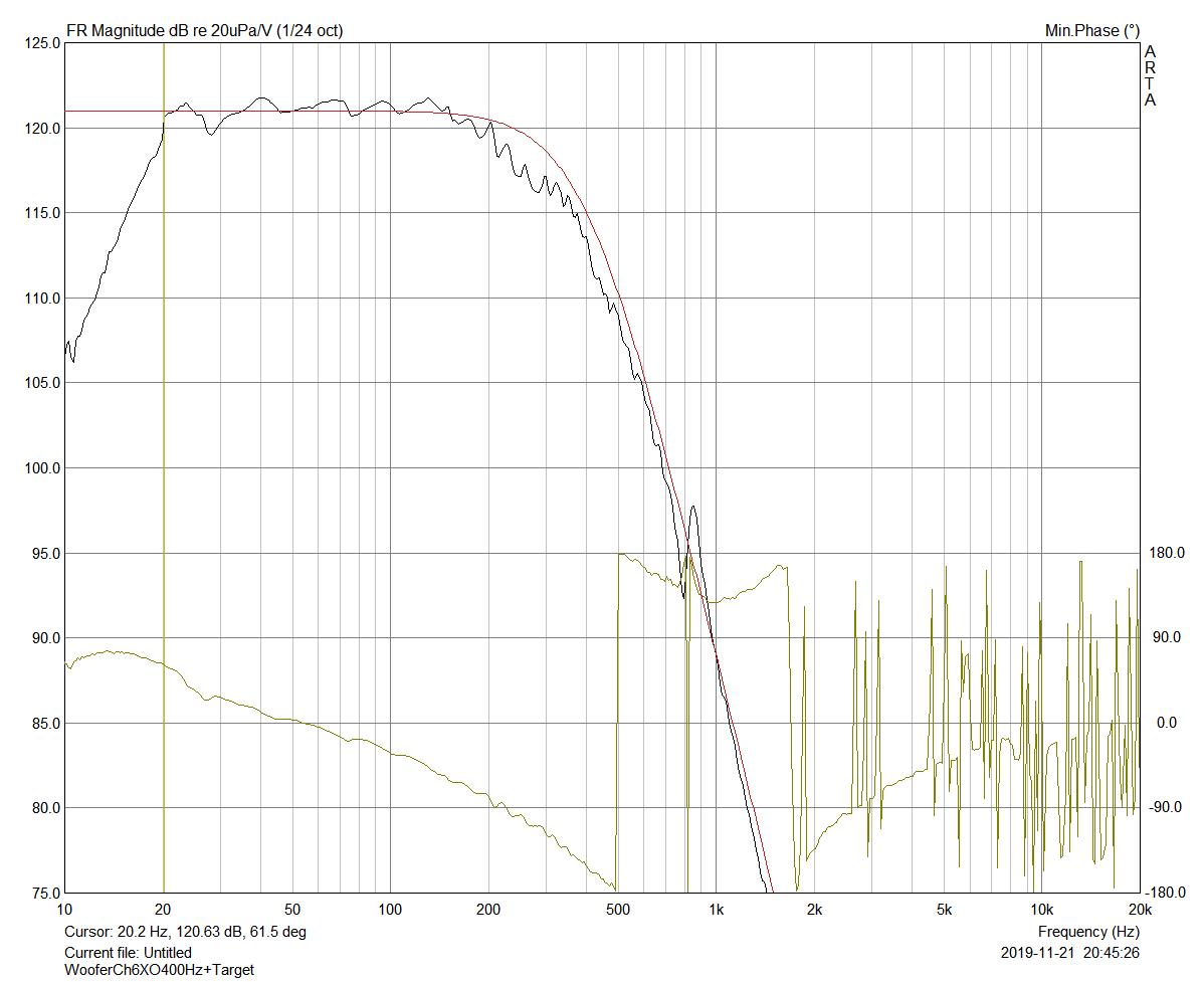

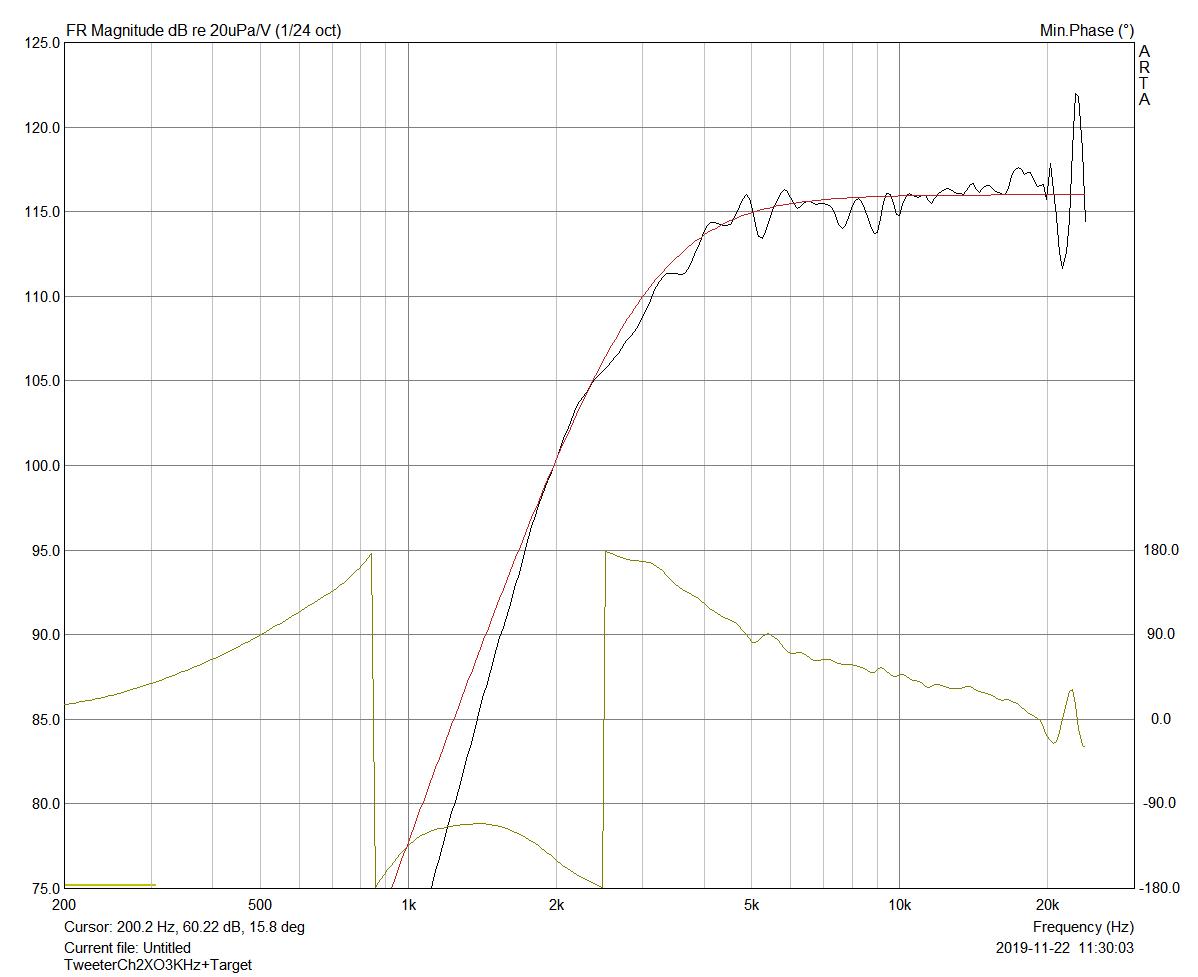

I have "flattened" the individual driver responses, 1 to 1.5 Octaves from XO freq, with my limited knowledge of Q's
I have included the phase plots and Target curves

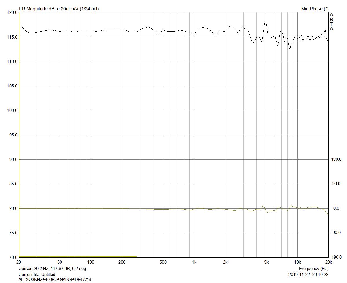

The final plot with all drivers, best I could do. Plotted at 1/24 Octave smoothing. Looks a lot better at 1/1
If anyone can see improvements, would much appreciate.
The Mid only, looks strange as with to 2 XOs dosen't seem to have a chance to be flat
The plot of all drivers together, the tweeter develops a peak at around 5K which wasn't so large when tweeter measured by itself.
Added the definitive XOs Gains and Delays
