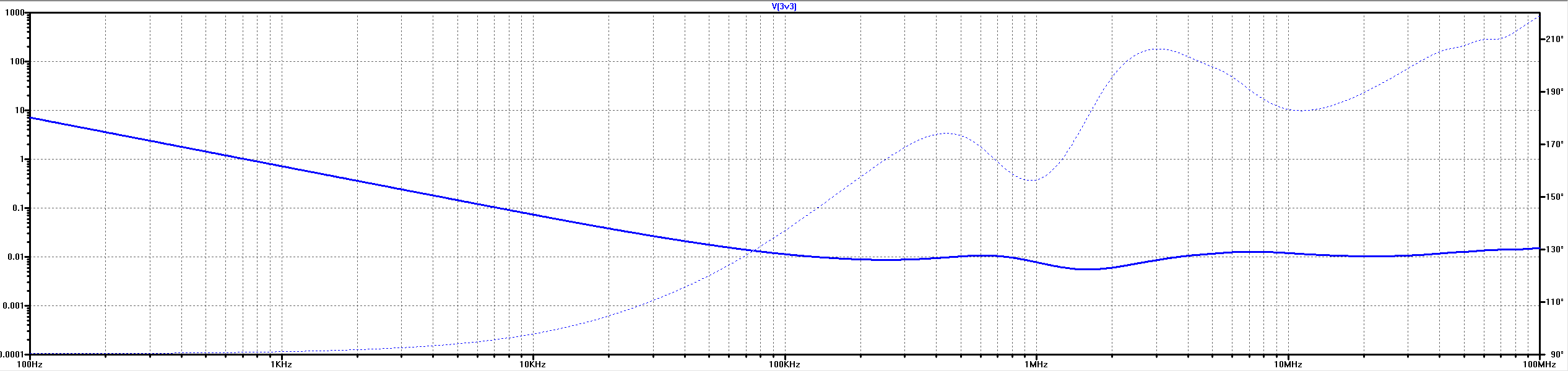

So new regulators are TPS54292 and TPS54360. I've tweaked the PDN impedance a bit(simulation does not include mounting inductance), fixed more bugs, and unified some component values for smaller BOM. New footprint for ADAU is also underway - with longer pads for easier soldering.

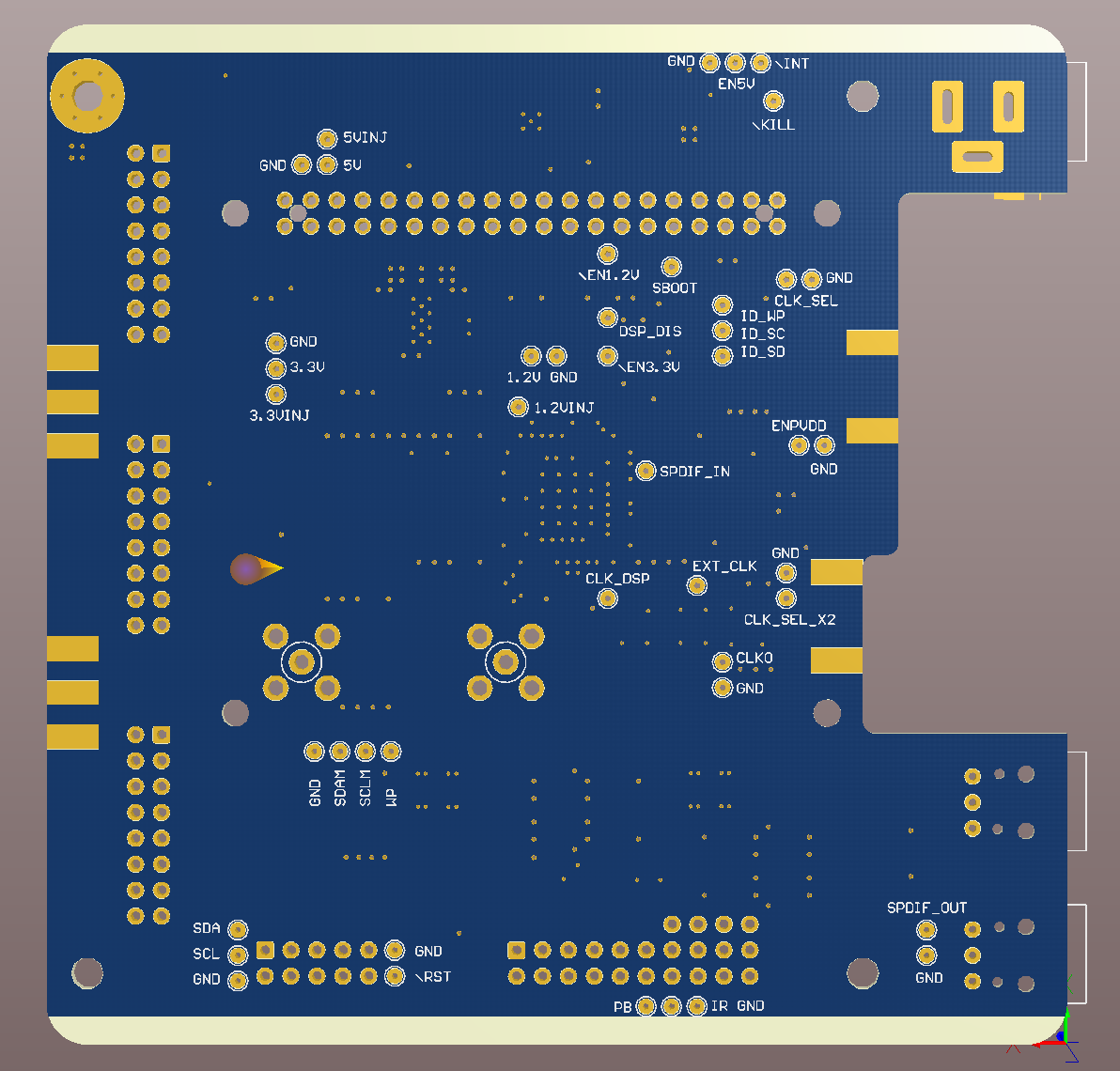

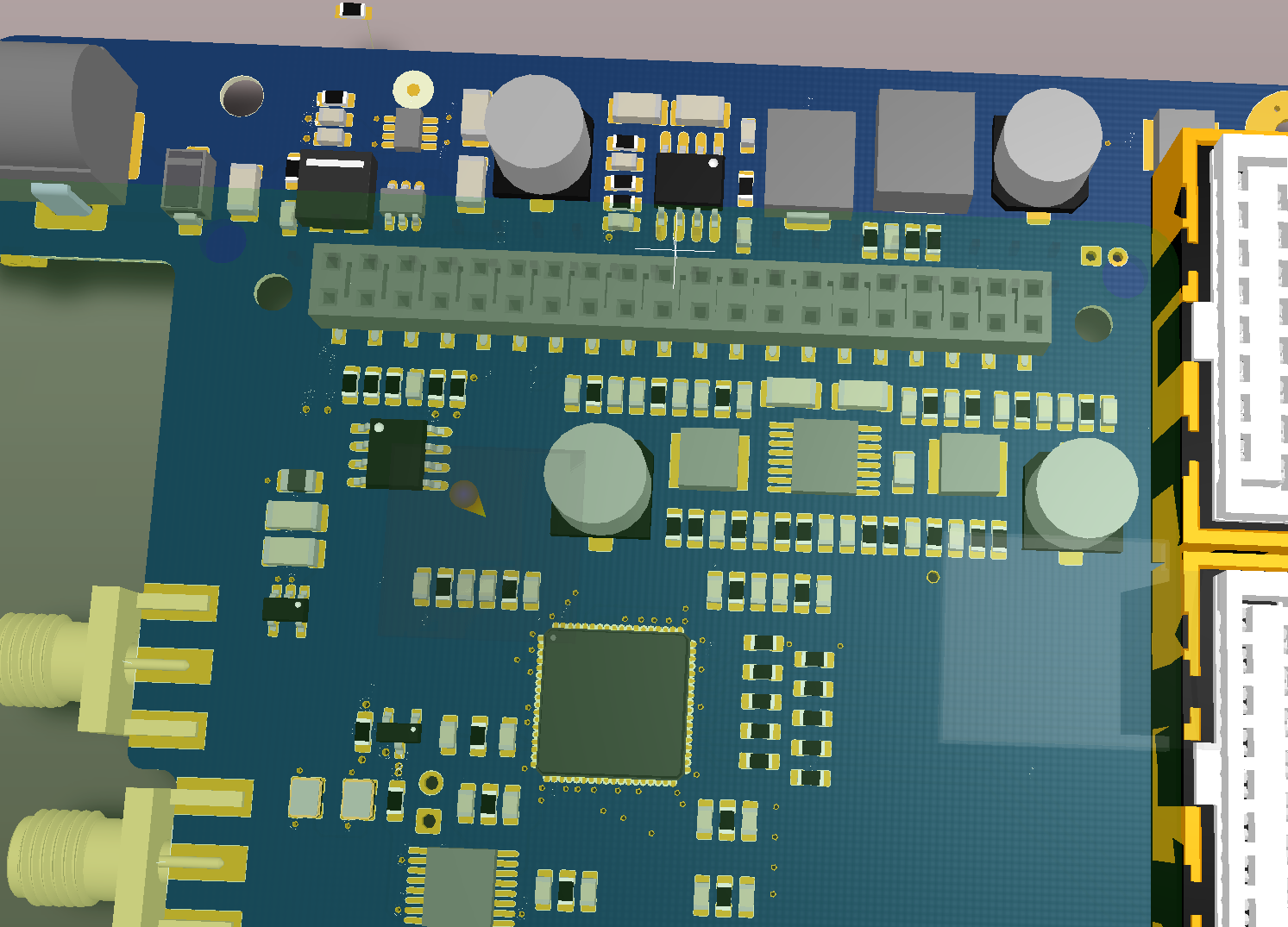

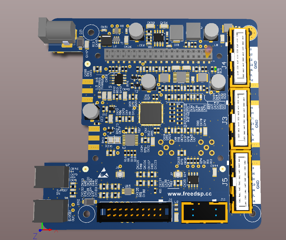

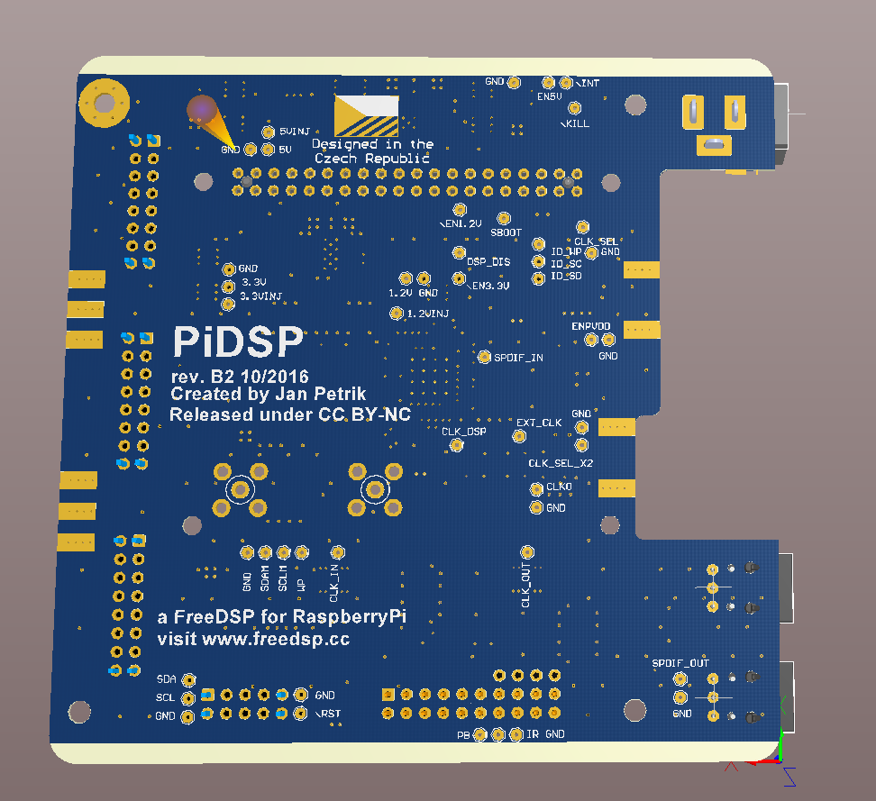

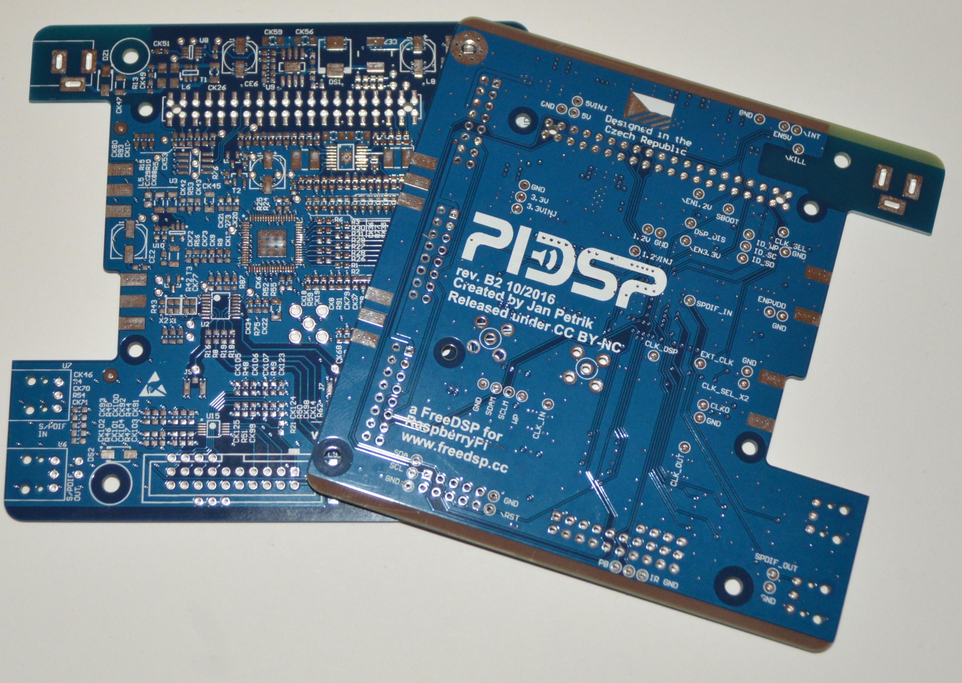

Hi, DRC is clear. Sebastian has created a very nice logo for my board - thank you Sebastian!. I'll check the board one more time tomorrow, add new logo and I'll order the boards :drink: .
Next in line will be cleanup of the components(lot of them are missing PN), and release of the source files(the board is going to be released under CC BY-NC. ). The idea is to release source files within next week or two, so you can order your board and have it on hand before Xmas. For a perfect Xmas time with soldering iron in your hands 😉. All components with exception of xtal are available from mouser/farnell. Oscillators are available on ebay or on various DIY stores.

@camelator - please see this thread for discussion about clocks. In short, I'm going to use only one, Mjjg and others were interested in second one and ability to switch them. So I added support for 2nd oscillator. You can join them with the driver effort if you'd like. It's same here, you can switch oscillator with GPIO, or select external clock source.
Programing from RPI - self boot eeprom is connected only to ADAU i2c master bus. ADAU i2c slave bus is connected to RPI. boot select and reset are connected to RPI GPIO. You should be able to program the EEPROM from RPI(write through).

gerbers
I've ordered the boards. For those who can't wait, see the attachment for gerber files - you can order your own board. To my knowledge the board is ready to go, but I haven't had a chance to test it. Rest of the documentation - Altium project, BOM, documentation will follow. I'm leaving for a 10 day hiking trip to Georgia :trapper:. I'll get back to PiDSP when I'm back.
