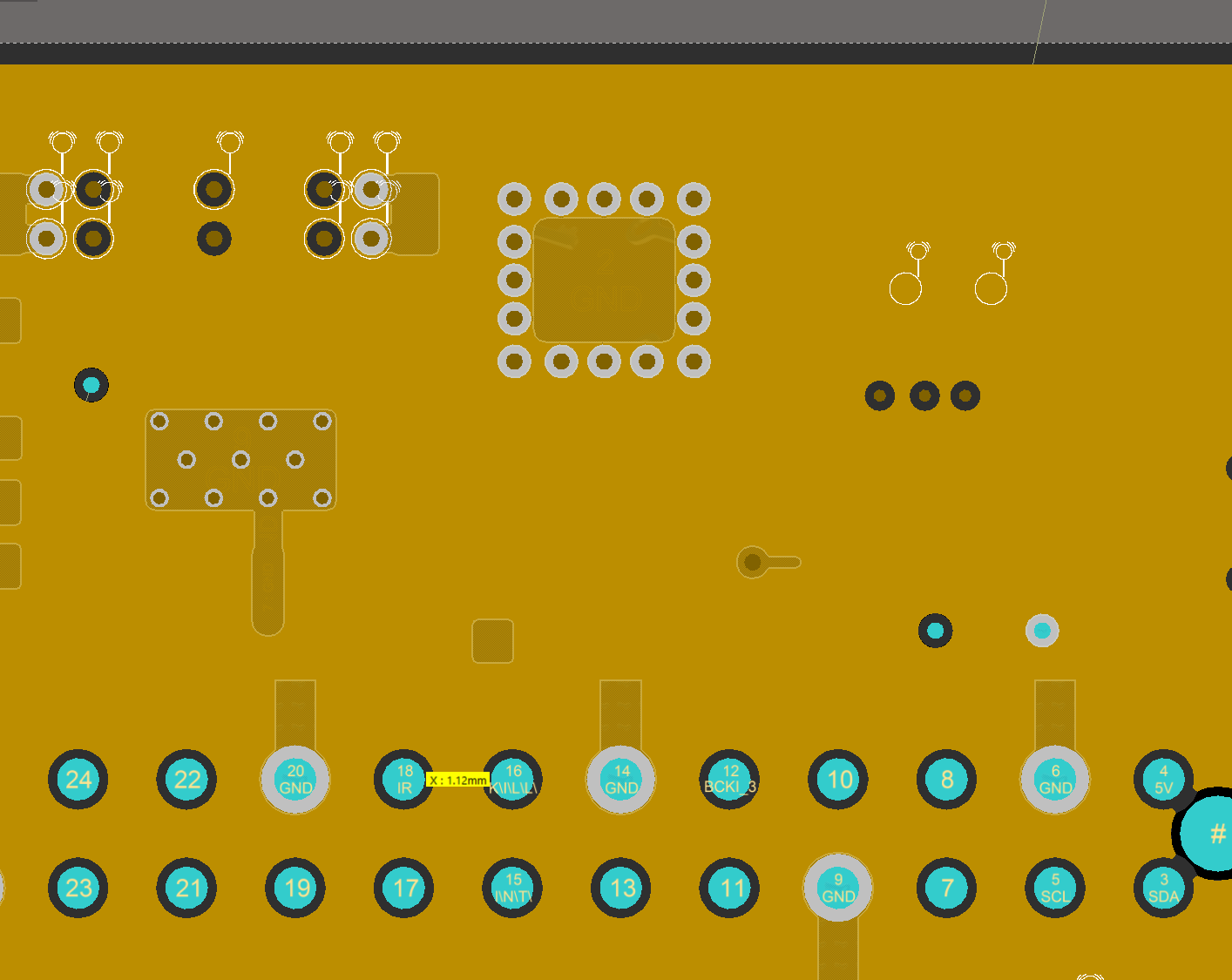

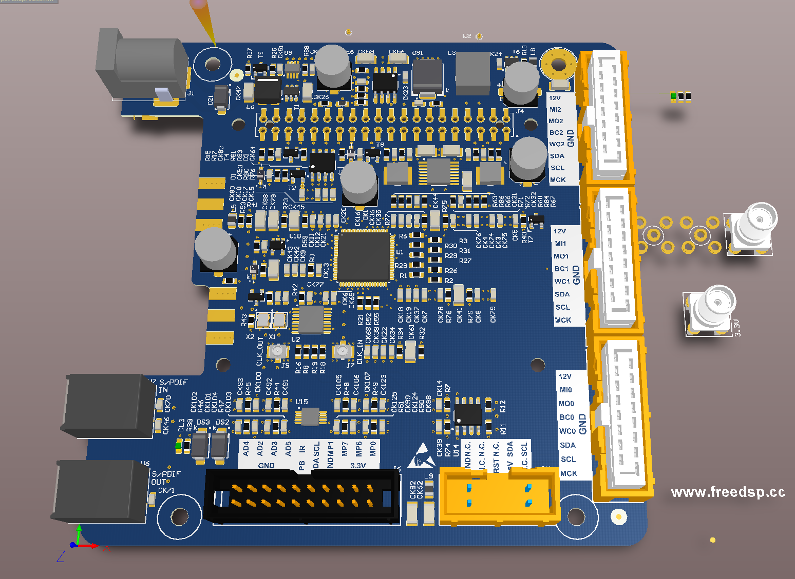

Still some stuff to clean-up, but PCB is starting to look quite all-right 🙂
Very nice work!
I know how much effort is behind a layout like that, very well done 🙂

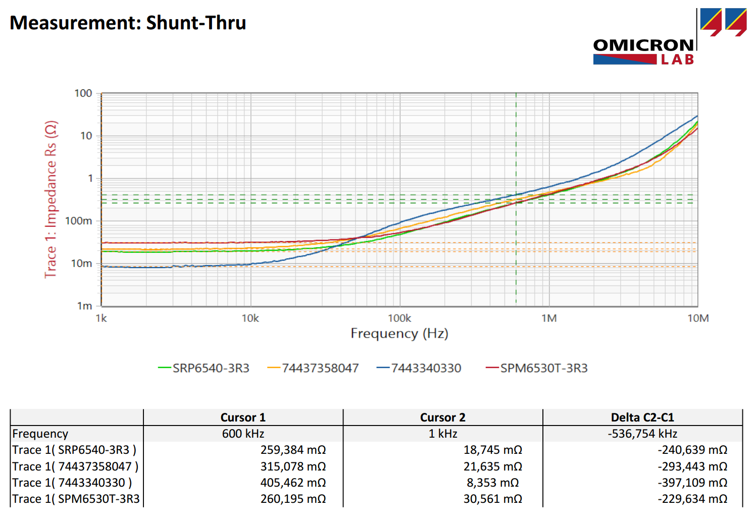

New inductors arrived today, I should have impedance measurements tomorrow.

It turned out that new inductors are not really better than old one(SRP6540-3R3). At least comparing real part of impedance (the part that is responsible for losses). One of the WE part is 4.7uH instead of 3.3uH. WE design tool was quite certain that I can get away with it. We'll see 🙂. They may be cooler than the original part, due to having bigger size/better cooling ability. Measuring C/W is next on the list + in circuit testing.
