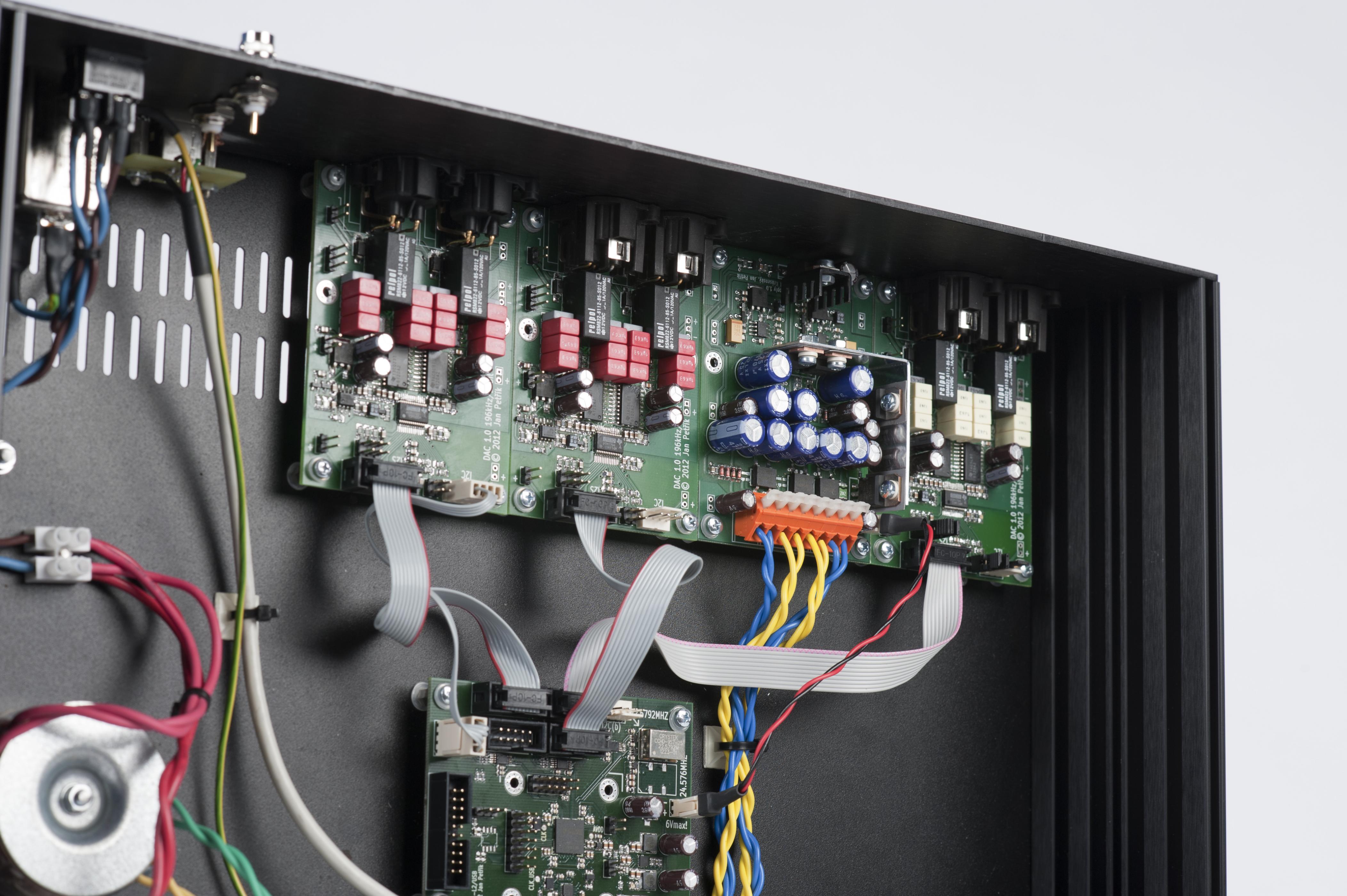

Hello everybody 🙂,
few weeks ago I've discovered the freedsp project and found it to be very interesting... but the ADAU1452 seems so much more potent dsp.
So I got in touch with the creators and joined the team with focus on new version with ADAU1452. I've been pondering about it for some time now, reading datasheets, researching, playing with possibilities etc.
Now it's time to open development thread and ask you about your opinion, feedback, and ideas, so we can make the next version as good as we can.
Flood of questions and ideas follows..
The general idea:
DSP, DAC, PSU - each on its own separate board, connected via wires, maybe backplane. ADC is not in my scope at this moment
PCB width 100mm - enclosures available, length 80mm(half eurocard) or 100mm, we will see.
Smaller builds could fit into extruded enclosure (hammond,fischer), bigger in rack
PSU board:
talema 70000K +- 15v for opamps and 48V(via voltage doubler) for phantom - no reason not to add it. will be useful with possible ADC board
Another transformer for digital part, maybe with double secondary - second winding for analog circuitry - PLL, DAC ref. etc.
I haven't made my mind about it yet. Any suggestions?

Since everybody have their own DAC preference, I'll suggest to split the boards into two (or three with ADC input), then you can have different DAC options and even do boards with XLR connectors for those with 1U 19" cases....
And I could do an expensive discrete R-2R DAC board to fit 🙂
I'm a little interested in the ADAU1452, even go an AD eval board, although I'm not convinced that it's the best fit for the really highend....
To minimise the wires between the boards the DSP board could possible be the backplane as well allowing any DAC/ADC boards to plug in, this would avoid taking clocks and I2S via connectors and wires, never a good idea with these signals.
At the moment I'm inclined to modular approach. One board for dac, one for psu, one for DSP.
"Best fit for the really highend" - let's say that the aim of the project is to be as good as possible, within some reasonable bounds - money and complexity/accessibility wise. That is one of the point of using SigmaDSP - the "programing" doesn't seems hard at all. I haven't heard it yet, so I'll take your word for it. Thank you for the input 🙂. Btw. congratz on your DAC:cheers:

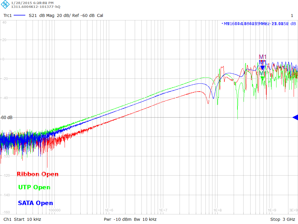

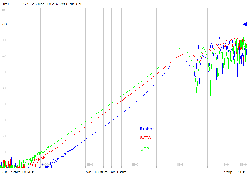

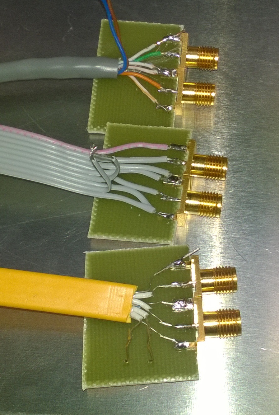

Cable measurements
Hi everybody,
due to my curiosity regarding cable performance, I've stayed a little later in my day-job today. For a quick comparison I've created improvised test fixtures for SATA cable, UTP/LAN cable(Didn have STP on hand) and ribbon cable. I've calibrated VNA(3Ghz made by RS) with through measurement, then plugged one port in cable, second port into the other cable and measured S21.
Sata Cable - only two wires used, all shielding connected to ground
UTP cable - only two pairs used, half of other pairs connected to ground
Ribbon - only two wires used, every other wire connected to ground. G,S,G,S,G,F,G,F,G - F= left to float
First graph is comparison with the other end of cables left open, second is sata cable with various termination - both cables terminated, only one (S21 and S12 were practically the same). The termination was of questionable quality - two 0207 tht 100R resistors in parallel, soldered to the end of cable.
That's all I've been able to measure today, Ribbon and UTP with termination some other time. Sorry for overlapping markers/quality of graphs, I'll try to do better next time.

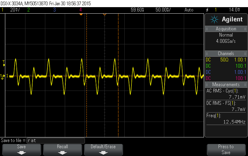

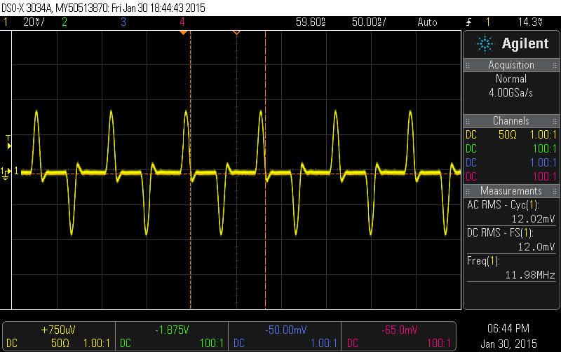

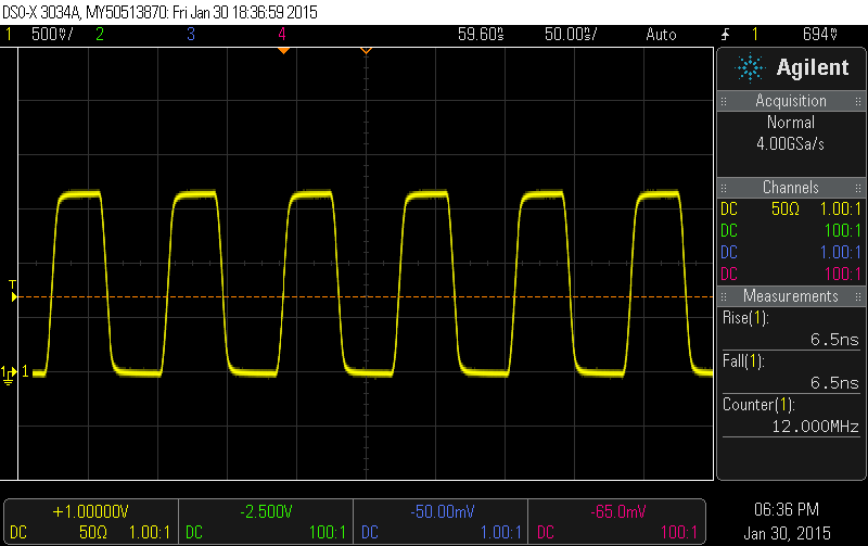

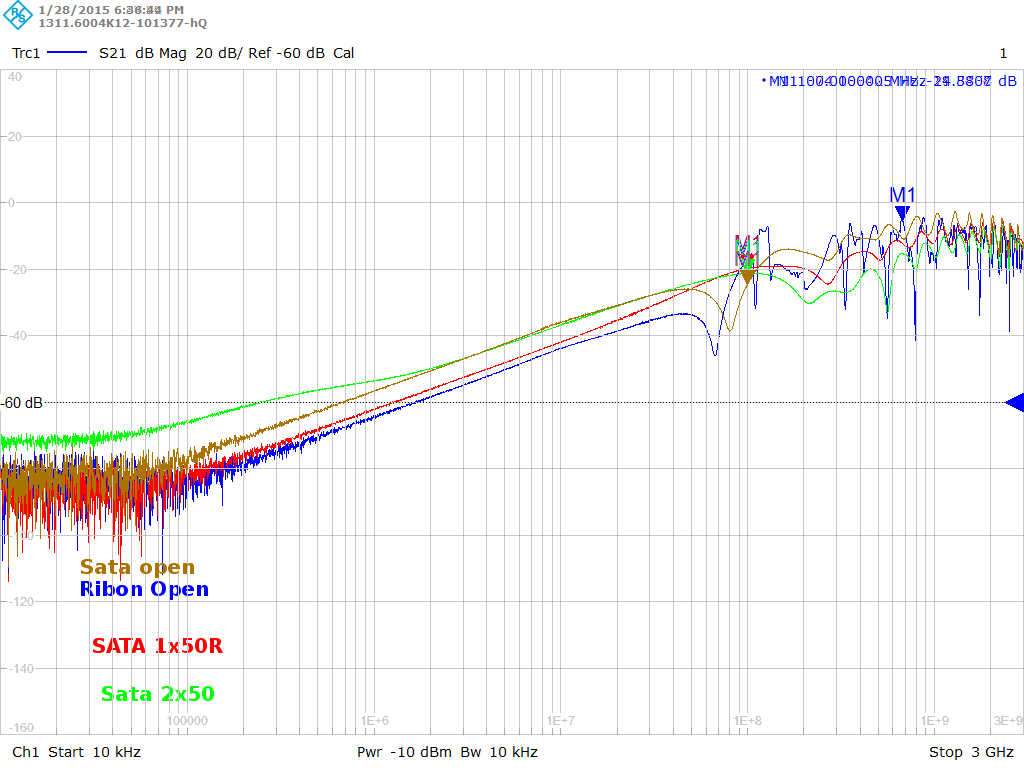

Cable measurements, take two
Last night it occurred to me that leaving other end of cables open might not have been good idea(if for nothing else, it's not realistic). So I tied ground on the other end together on small copper plane and retested everything. I've attached results for one wire terminated, other left floating. Results worsened when I terminated both ends. I suspect this has something to do with ground/return sharing between the two wires. I measured both wires at the same end, all wires were cca. 47cm long(length of SATA cable).
I got even more curious and decided to test cables for crosstalk in time domain. Set generator for 50Ohm output, 12MHz and output voltage 3.3V(which means half of it at 50Ohm load). You can see the well behaved trace in attachment (connected to 50R input of scope). Rise time is 6.5ns. I connected generator to one cable and 350MHz scope to the other wire and measured RMS voltage over few periods. Please note that bandwidth was severely limited compared to to VNA measurement, also the cable is probably unrealistically long for my application.
Results:
Sata:
ends of both wires open - 16mV
50R termination on wire connected to the signal generator - 12mV
Scope connected to the other end of cable - so generator is on one side and scope on the other - 10mV
Ribbon:
ends of both wires open - 7.7mV
50R termination on wire connected to the signal generator - 7.7mV
I did not bothered with connecting scope to the other end, It was late and I wanted to go home. Anyway, I already knew everything I needed to know.
So... If you misuse SATA cable for single ended connection it ain't that bad. It will work OK. If you decide to use it properly with LVDS drivers, you will get probably way better performance (I haven't measured it - I got access only to 2 port VNA and no suitable blaun at hand). LVDS drivers aren't that expensive, but it will add up in the end and you will slowly start to loose benefits SATA - price, simplicity, elegance.Twice the connectors, cables + drives... but you could use rally long calbes 😀

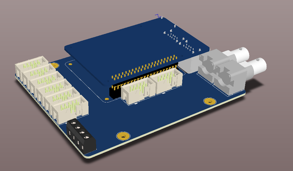

Just a small update...
Tps eval board has arrived, haven't played with it yet.
I've spent quite some time on I2S/Output connectors. I ended with the configuration in attachment(it does not represent pin-out, just which signals are presented).
With this arrangement, you have a choice between 1x4 or 2x2 or 4x1 - inputs and outputs. OUT3/IN3 connector will be shared with RPI. You can connect 8ch usb streamer, or 8ch BBB, or rpi and wolfson SPDIF and still have some inputs left. Or 8ch BB and wolfson SPDIF(if you decrease Fs of BBB)... this is the most versatile arrangement of the connector I've been able to come up with.
I've stumbled upon an interesting IC - TPS65131. If I use it(with post regulation), I could power whole thing from a single 5v adapter. A smaller, more streamlined design.
I'm thinking about using toslink instead of BNC. Why? If you are interested in audio, chances are that you are already using USB to I2S, or using clock sync, so vanilla SPDIF is not really interesting for you. On the other hand, it seems that everything has toslink nowdays - cheap pc motherboards, gaming consoles, even some laptops...
Comments are welcome.

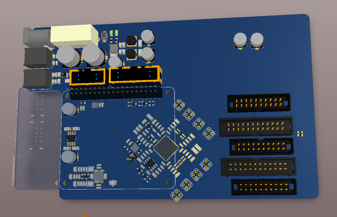

About the board:
This will be a first and not the final version of the board. The aim is to test and evaluate the stuff. So there is a lot of connectors, jumpers, etc.
Generally the idea is to make this board as universal as possible (within reasonable bounds). This will change with next version, which will be more streamlined and polished. This brings me to another point - ATM BBB is quasi supported. What does it mean? I've connected I2s 3 header after buffer for RPI.So connection is buffered and can be disabled. Unoftrunatelly, I don't know weather BBB uses bclk and lrck as inputs or outputs.
Since my primariy interest is RPi(yay for quad core Pi 🙂 ), I don't file like searching 100+ long thread to discover the connection.
If there is someone interested in running ADAU1452 with BBB please check wather my connection is right or wrong. Thank You.
At the moment, I2c from MCU header is not isolated, so for safe operation with BBB one would need to add I2C buffer with enable - so rise your hands who is interested in this feature 🙂.
If there's a PCB space, I might add the buffer(and change the other one to model which supports daisychaining).

Master is connected either via RPI connector or USBi/BBB/MCU connector
Second I2S bus contains DSP as a master and AD/DA converters as a slave, and the bridge. I've decided not to include I2C fan-out buffers for AD/DA converters
I've included screenshot of work done on PCB and schematics. Neither is complete(both are rough drafts), and there are probably some mistakes. It's work in progress on all fronts, but now you have a better idea about the project. I hope You like it.
